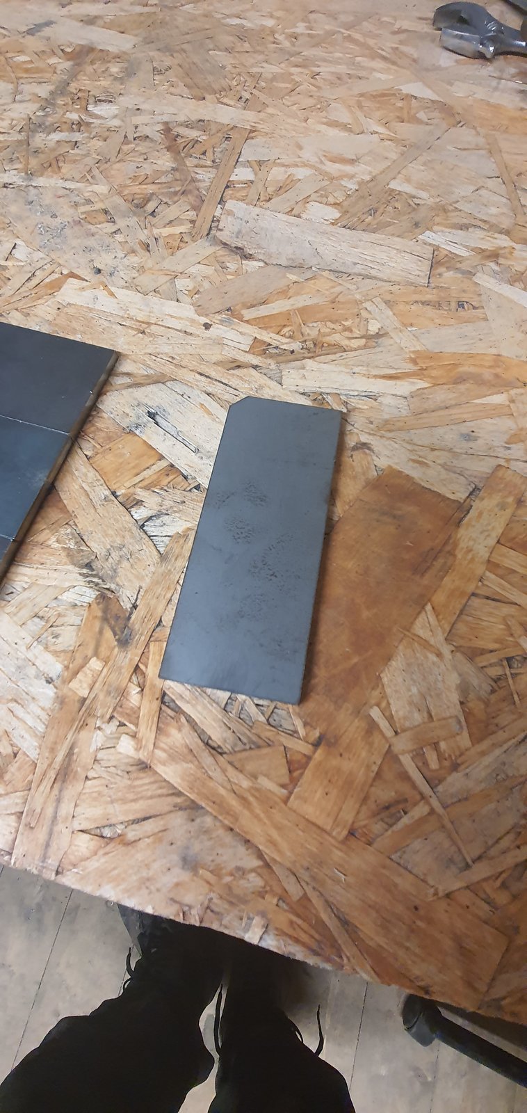

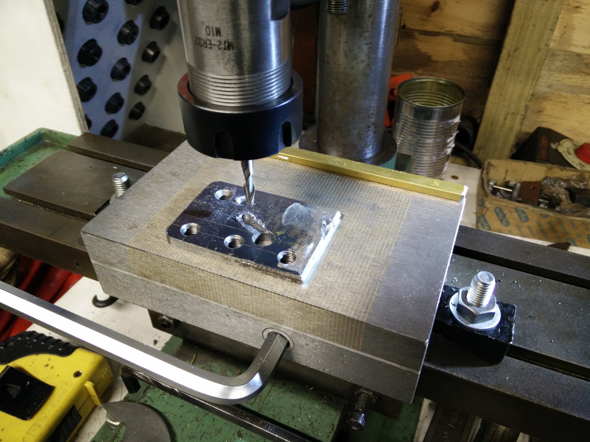

], the work-piece slid along the chuck.
. It's a mystery #scratching head
...a piece of scrap 6mm steel... The chuck def holds lumps of metal [V-block etc]
I was only trying to cut at 2-3mm depth and had cleaned the chuck surface [Acetone]. I'll have another go tomorrow, other 'stuff' permitting, and try a different cutter and experiment with spindle speed [I wasn't feeding fast]. The chuck def holds lumps of metal [V-block etc] to the extent that you can't lift them off...... It's a mystery #scratching head

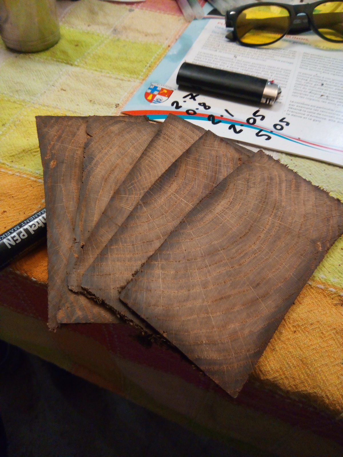

Got a new blade for my évolution chopsaw, decided to see how fine it would cut Oak, got to .8 mm, just for fun.

2-3mm DOC might be a bit ambitious and also the cutter looks like it may be meant for aluminium, not that that should matter too much.
You could try blocking the work piece in with larger bits of steel at the edges. BTW is it definitely steel and not some kind of ferritic stainless?
. Scrap bit I'm pretty sure is ordinary steel & not stainless of any kind - I seem to recall drilling & tapping it for practise ages ago. Might try bigger 'blocks', but if I wanted to mill off the edge I'd be snookered?How smooth and flat is the underside of the piece you are holding? Generally V-blocks, etc. will be ground, so very smooth and flat. If the 6mm stuff has burrs or is only touching at one or two places, the adhesion will be poor.
