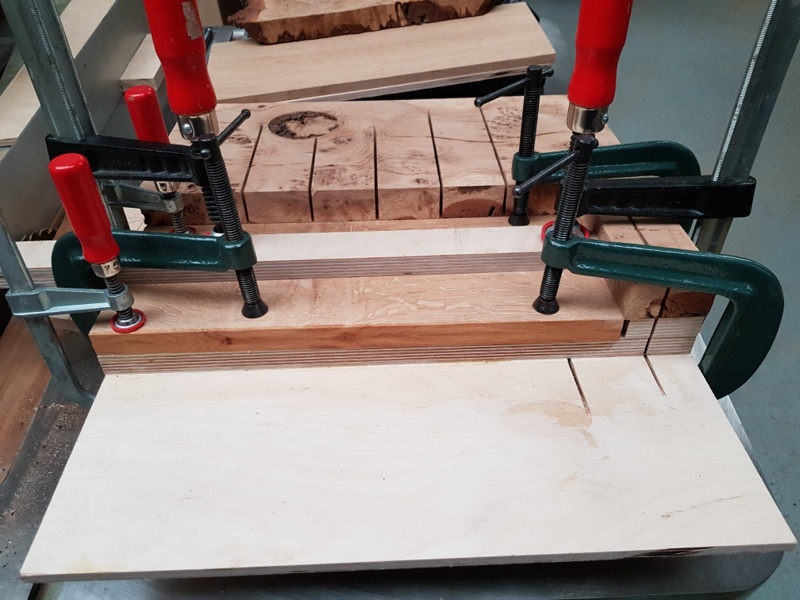

What size t slot stuff do you use? I was looking at buying some to make a mini router table.Made myself an oak (ridiculous I know, but it's what I've got) back-to-front overdesigned bench hook:

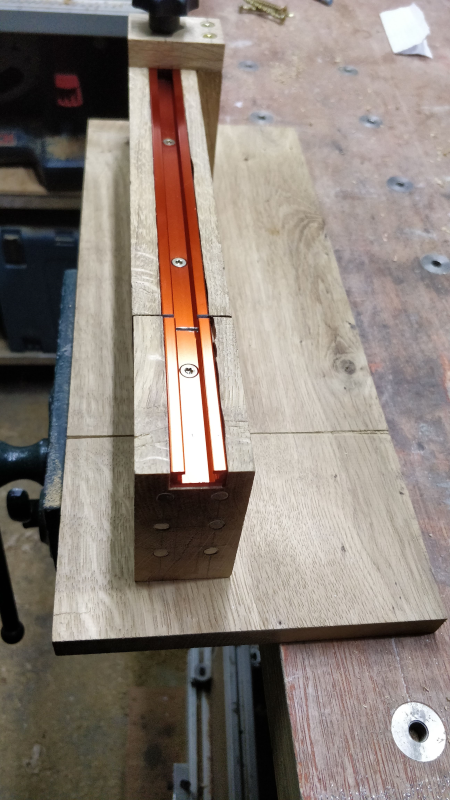

The right-hand end is use with backless Japanese (pull) saws - either in the slot, which is the width of my Japanese saw's kerf or on the end (which has magnets glued into it to keep the saw running true):
The other end also has magnets set into it but has a slightly lower top: this can be used (with the jig the other way round) with a western saw. The relieved end is to account for the back of the western tenon saw.
The T-track in the top allows me to use a stop if I want to cut multiple pieces to the same length. Probably a bit pointless; I installed the T-track as an easy way to hang it underneath my bench so it's immediately available and figured while I was at it I'd make a stop.

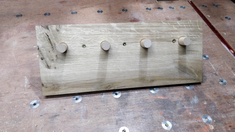

As with my shooting board, the "cleat/hook" on the bottom isn't actually a cleat, it's four 20 mm dowels:
Three of them go in the jaws of the vice under normal use (the vice doesn't have to be tightened) so the moving jaw of the vice counters the pulling action of the saw. Using dowels means I can put it in a different place (or turn through 90°) if I want by putting the dowels into the dog holes on the bench.
