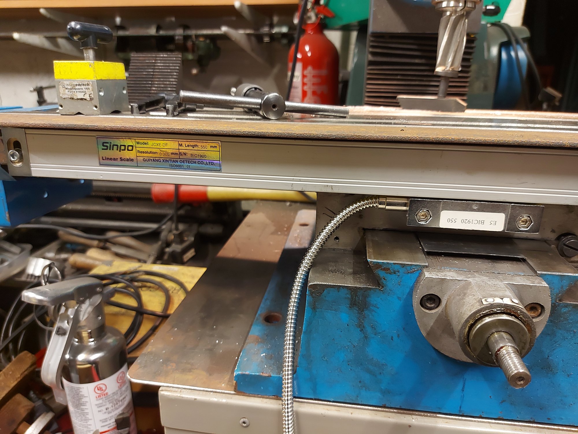

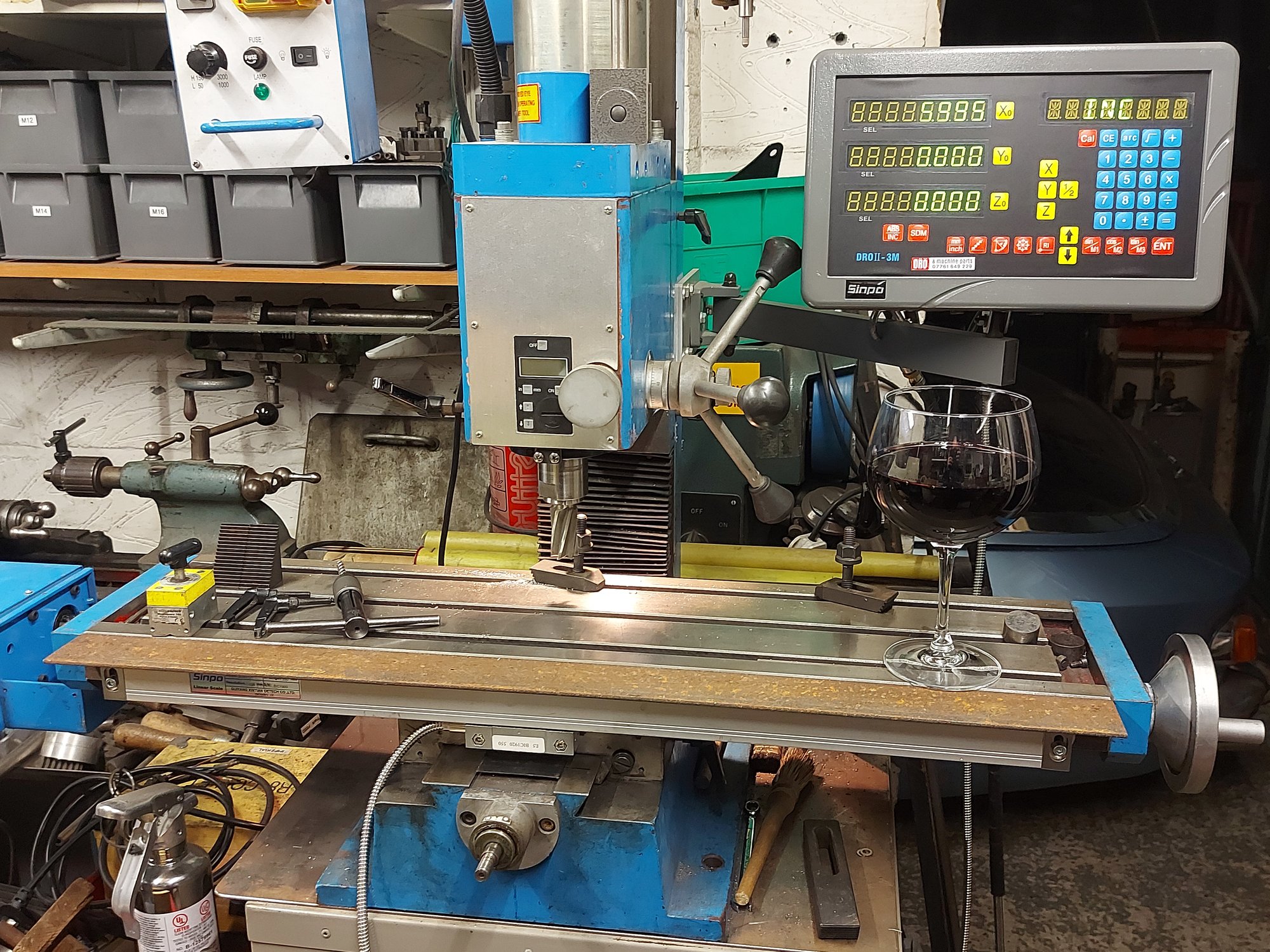

I like the DRO, and the glass of wine, and the mill, hell, I like it all !Phase two of fitting the Sinpo DRO bought back in the lockdown to my POS milling machine, first fit up and trial of the X axis. This has spurred me on to get the other two axis done.

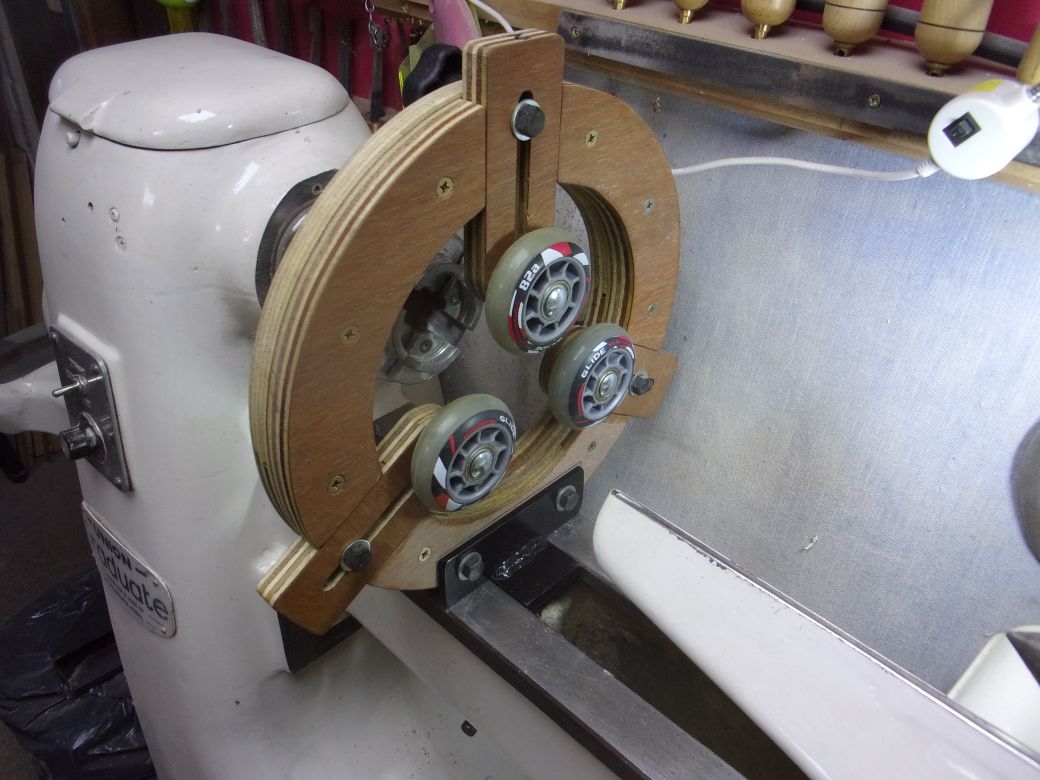

Nice steady idea, I hadn't thought of that line of attack, I like ++Hi,

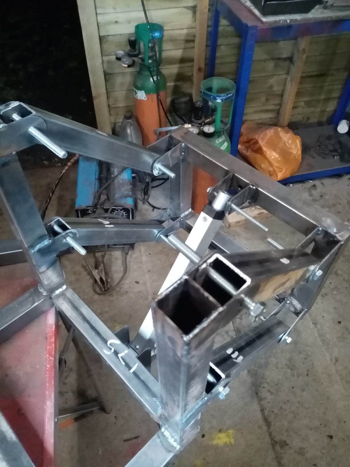

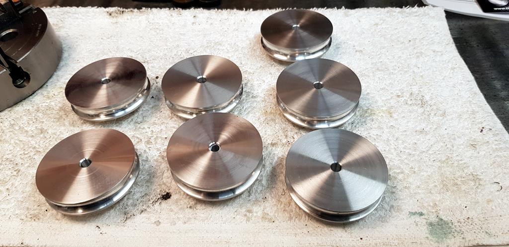

I've just made a woodturning lathe center steady whilst it's poured with rain and been perishing outside; what a change to spend a few quality hours in the workshop hiding from the world's problems.
Kind regards, Colin.

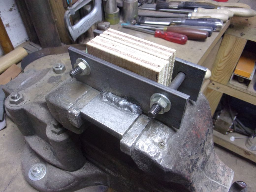

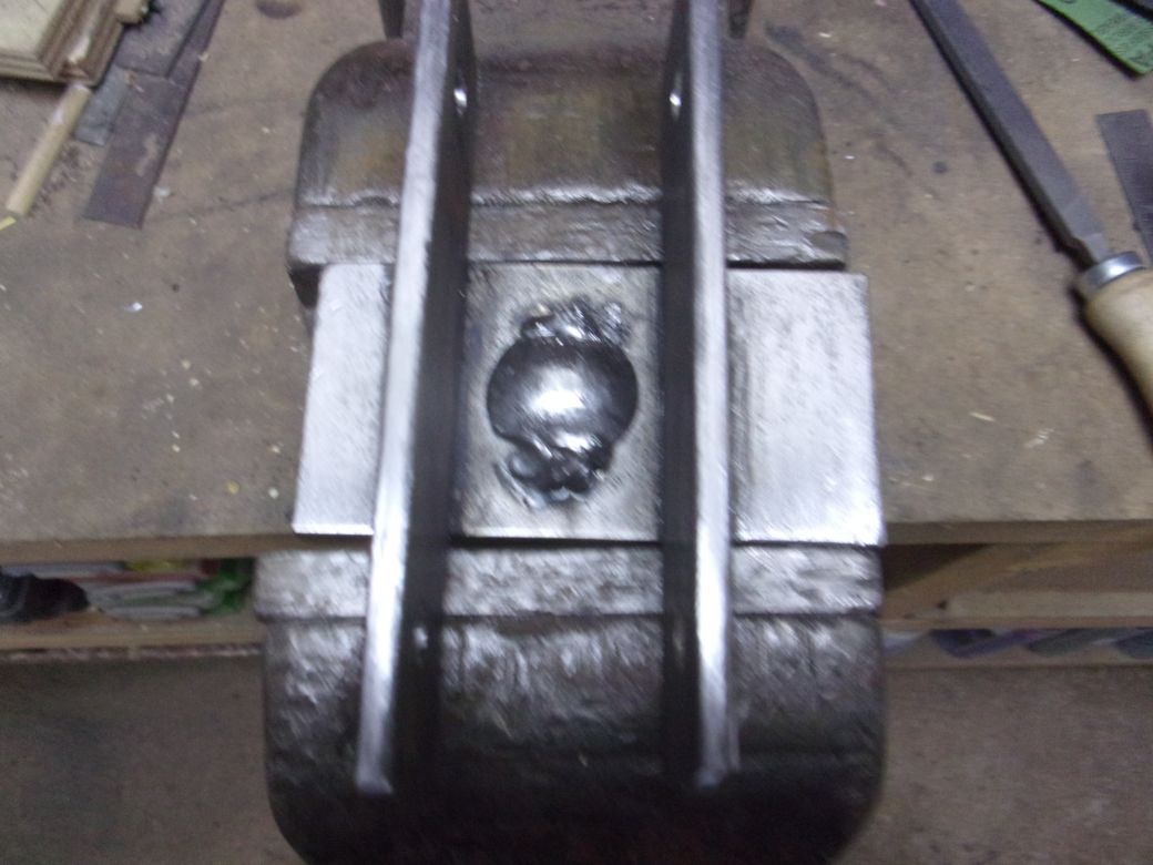

Any excuse to do a bit of welding. I'm out of practice.
It's been wonderful playing with my toys.

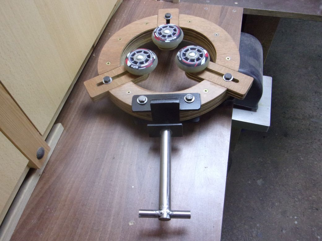

The completed steady; skateboard wheels used. Long clamping handle and clamp make a decent mounting.
A bit of arc welding using my Pickhill Bantam; Not the best of welds but it's ages since I did any welding.

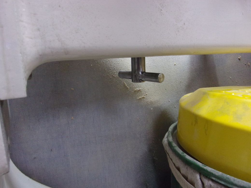

A neat out of the way clamp.
This should making turning things like goblets easier whilst hollowing; it's a perfect sliding fit between ways ensuring accurate alignment. Just a nice project with something useful at the end costing very little in monetary terms.

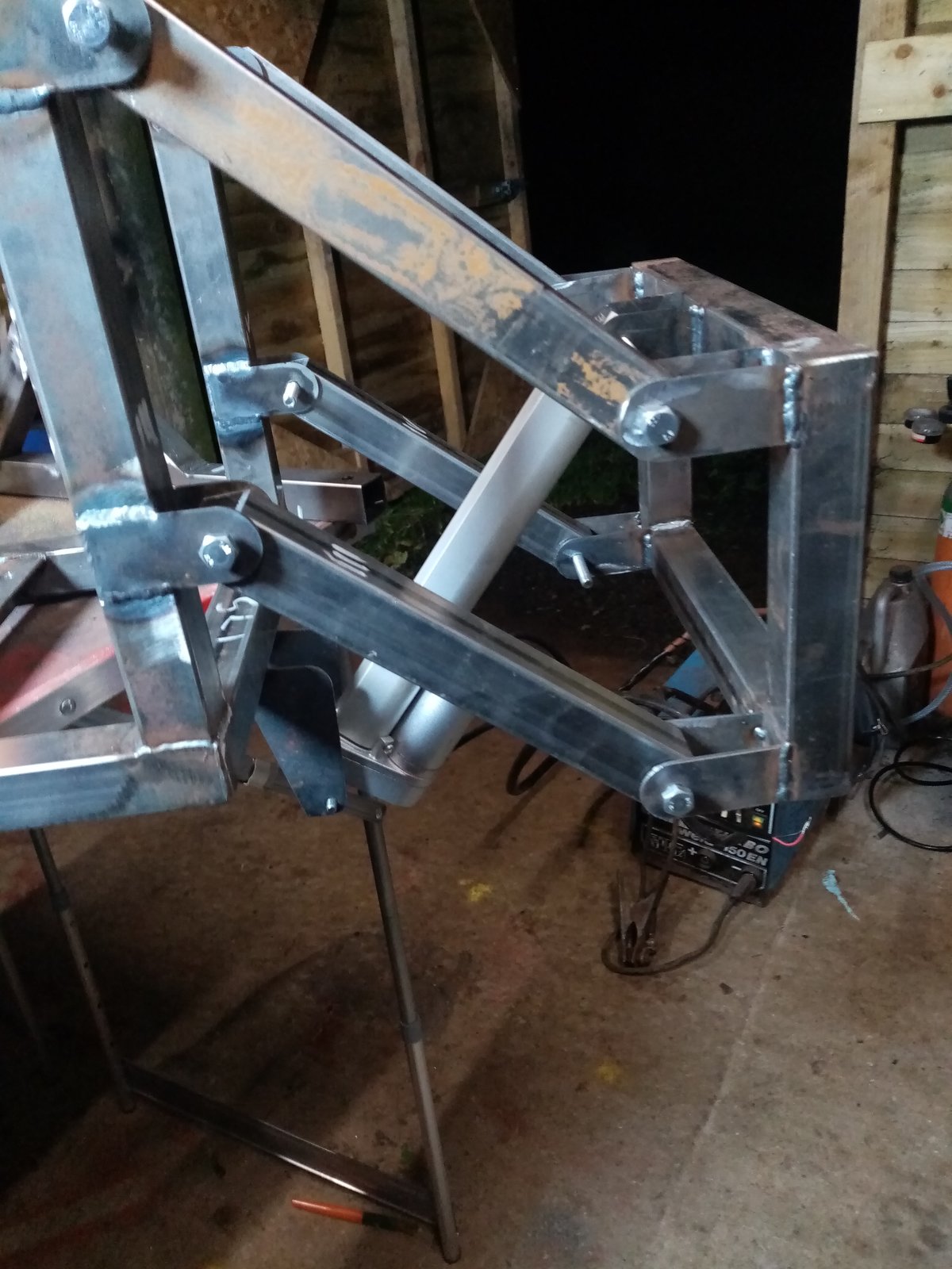

Looks suitably articulated.
