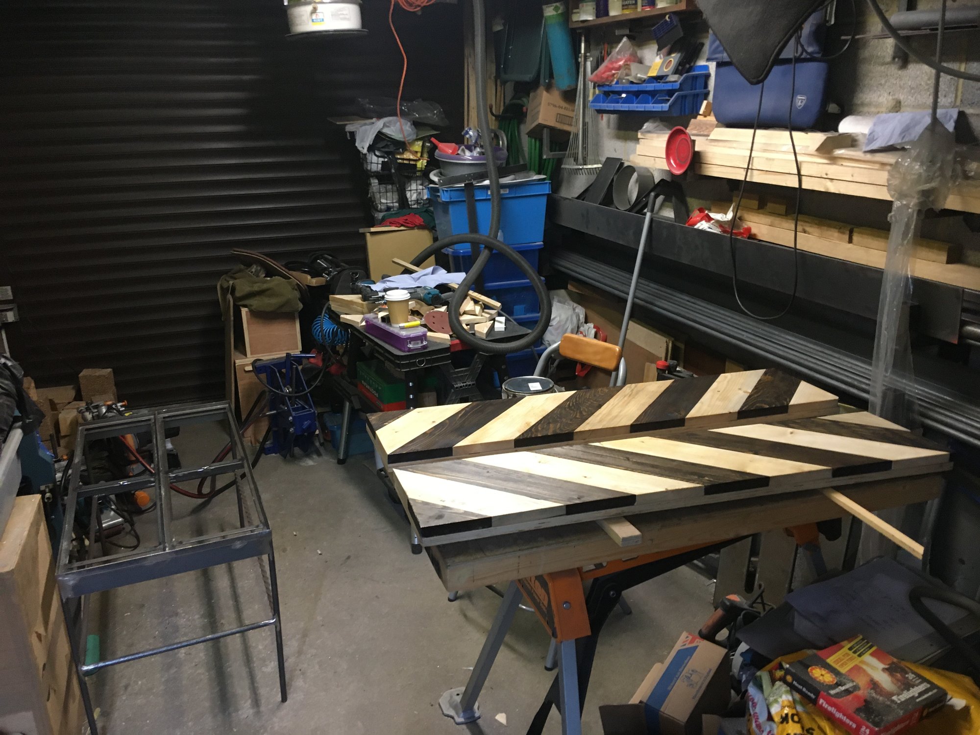

That gap would look good filled with stainless or bright steel or brass.Saw a small pile of pallets dumped somewhere nearby, so liberated them.
I sanded a few up, and thought they'd sit nicely in a steel frame.
Eventually the pile was just in the way, so it had to be used up, and made into something - anything!
I can't remember why, but somehow the frame ended up divided into two halves - so the pallet wood went into each half, but with each half going in different directions.

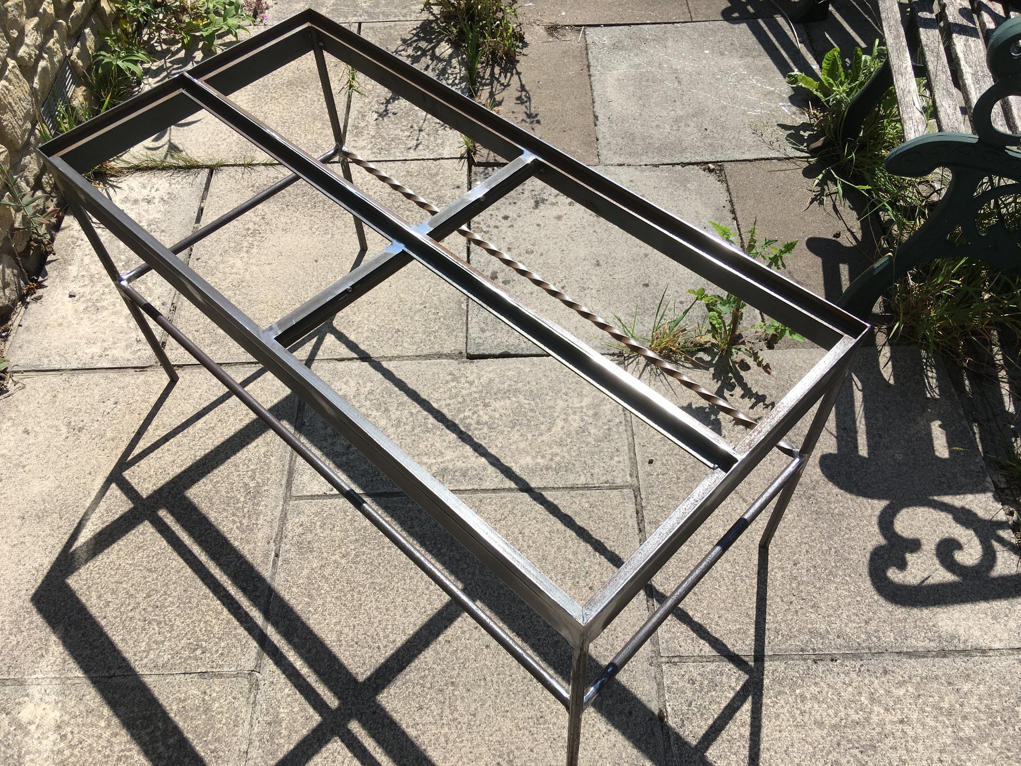

The frame itself is fairly sturdy - the top strip is 50 X 5mm, with 20 X 2 angle around the inside of it, to support the top.
The legs (and the other inter-connecting round pieces) are 20mm round bar, and the centre cross piece underneath the angle-iron support frame is 1'' square box section with a 3 mm wall.
The slats were stuck onto pieces of 18mm ply, partly to raise it up slightly so as to be able to see the end-grain, and also just to keep the damned slats still!
There's obviously a gap in the centre, as there are 2 pieces of angle-iron back-to-back, to make an up-side-down "T" shape, that the ply & pallet wood are located in - and resting on.

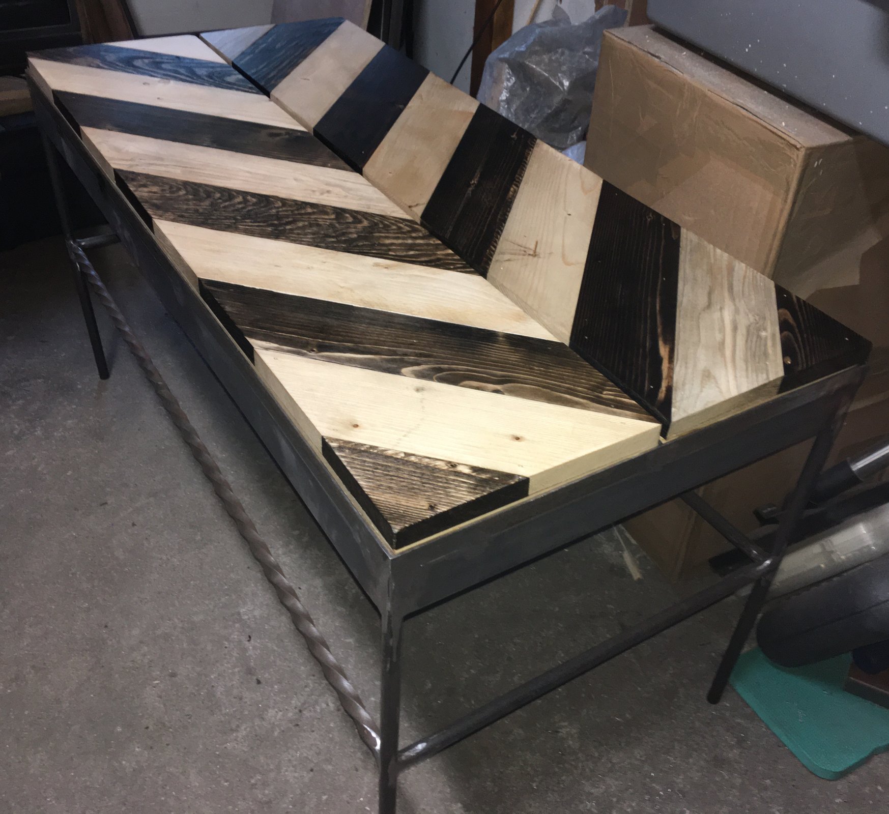

A bit of varnish:-
It might need feet too, as the bar-ends seem a bit severe.
From above:-
I might even get it powder-coated - to save me from doing any painting - maybe in clear - or does that just go misty and cloudy with the UV effects?
Top pieces in place:-
I don't even need a table either - so after all that, it's still in the way!

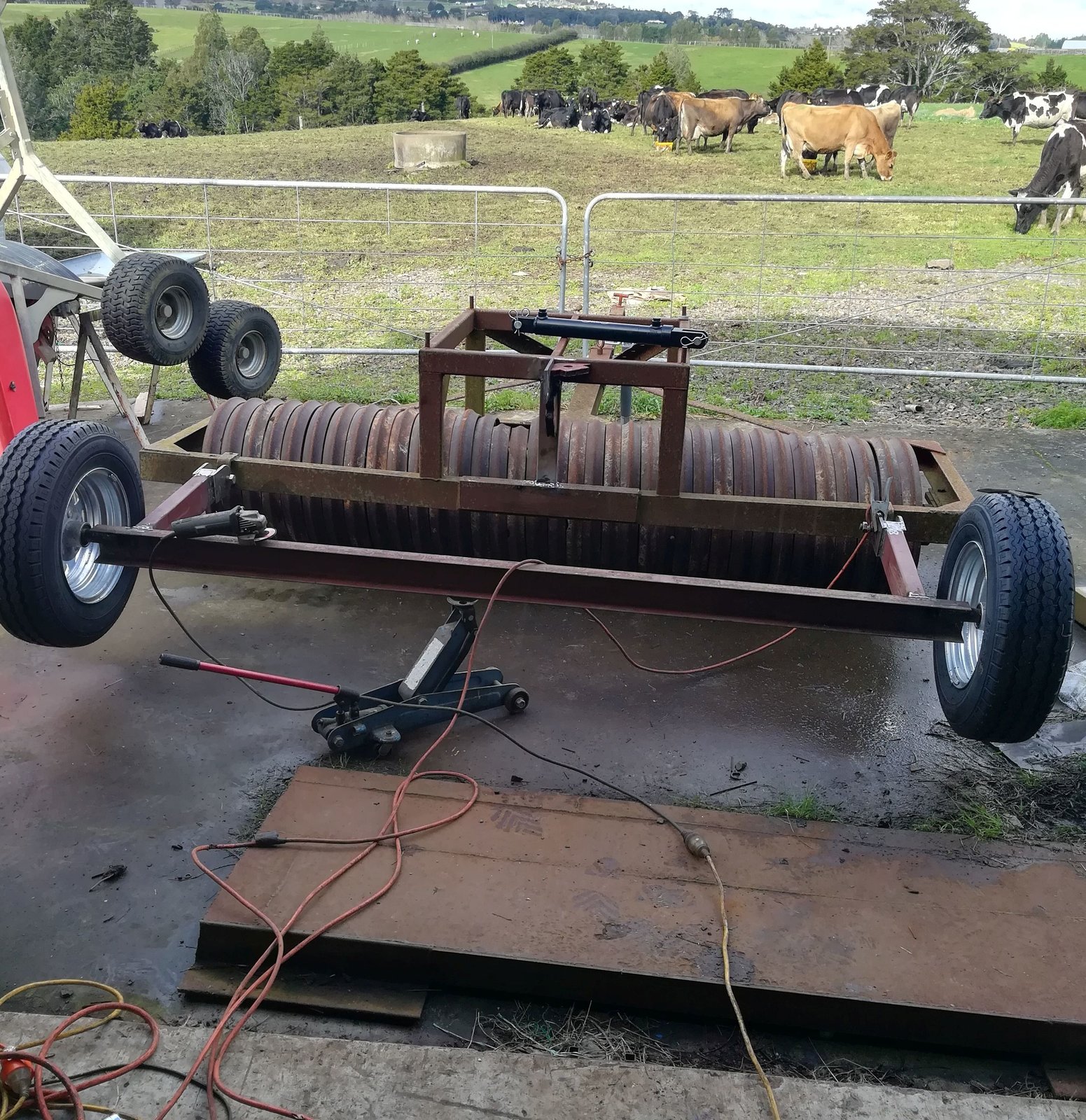

Just a thought . Why not use old scrapped car wheels possibly c/w hubs & tyres as the rollers so they are sealed bearing'd , fill them with water for more weight before you put them on the axle , Use the wheel bearings with spacers as part of the build & you'll only need to preload the while roller from one end plus you could tow it on tarmac perhaps . you'd be able to have a small gap between the wheels engineered in the roller build .

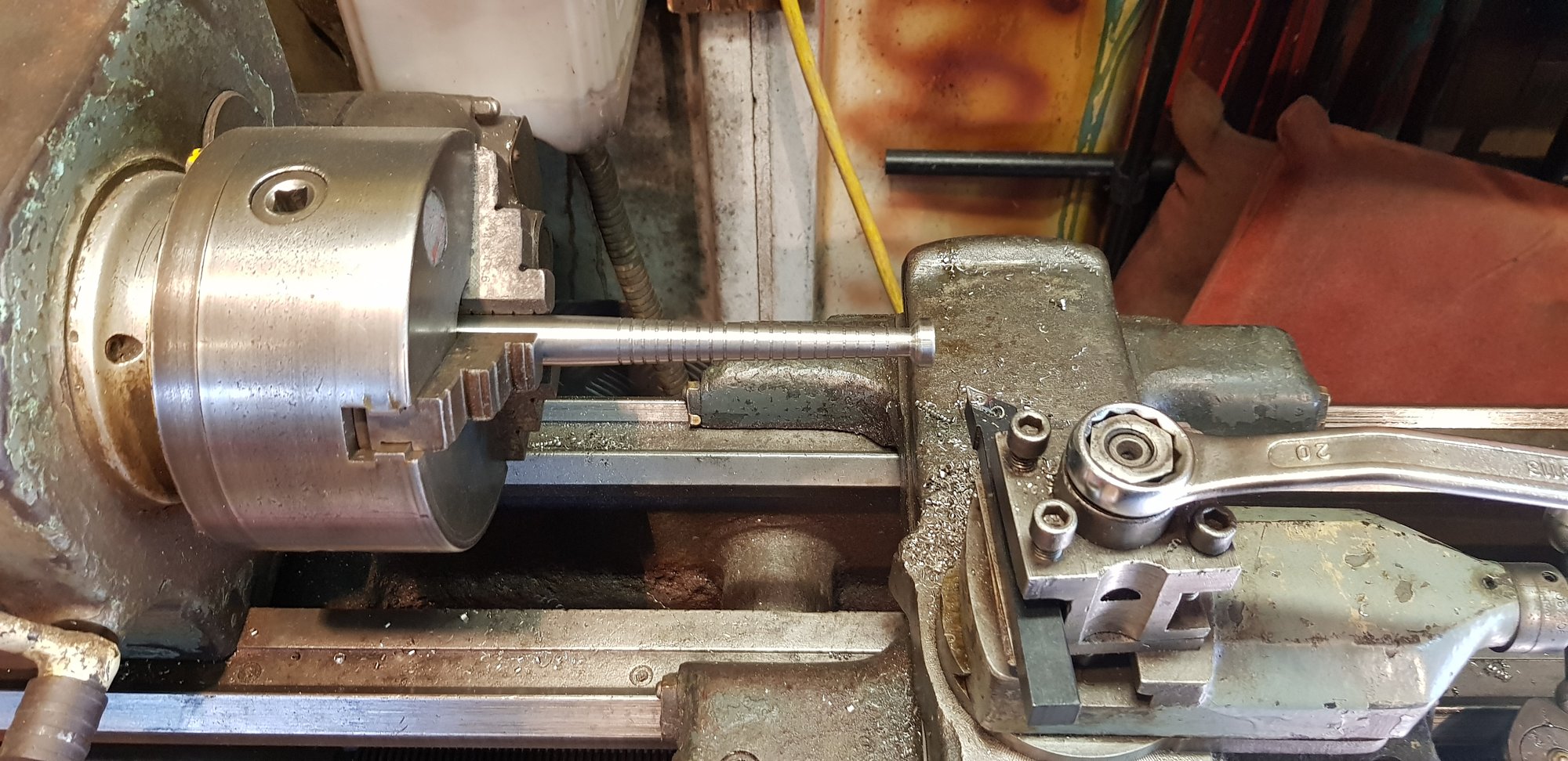

Just knocked this out while I’m still waiting for my steel delivery.
They’ve got 15° slope, I done another with 30° slope and it was too extreme. . Just going in a drawer these lot, I was fed up searching for the right spanner when I need to do one bolt on the lathe.they would be better with a slope on them brad more so when hanging them on wall
then at least they wont fall out of the thing
