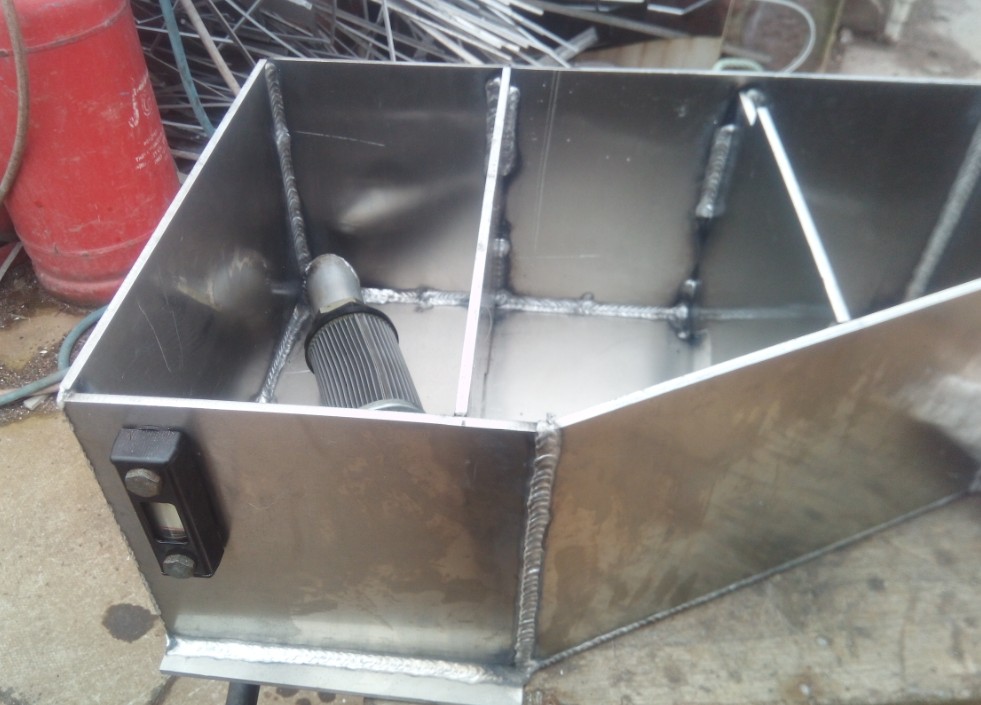

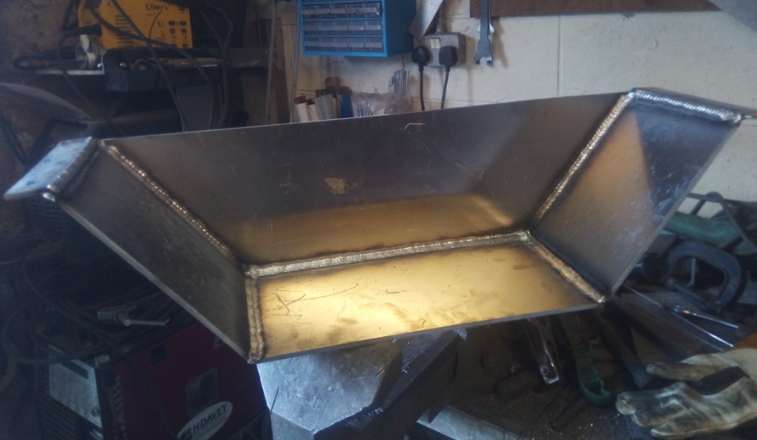

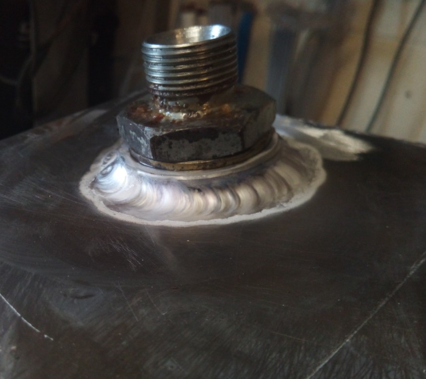

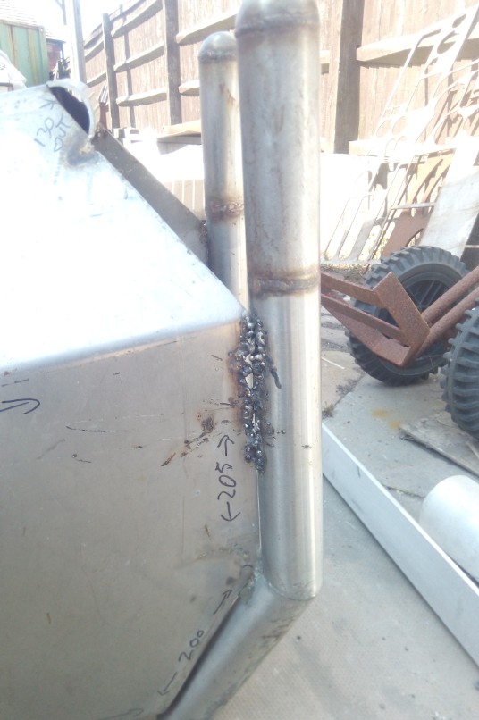

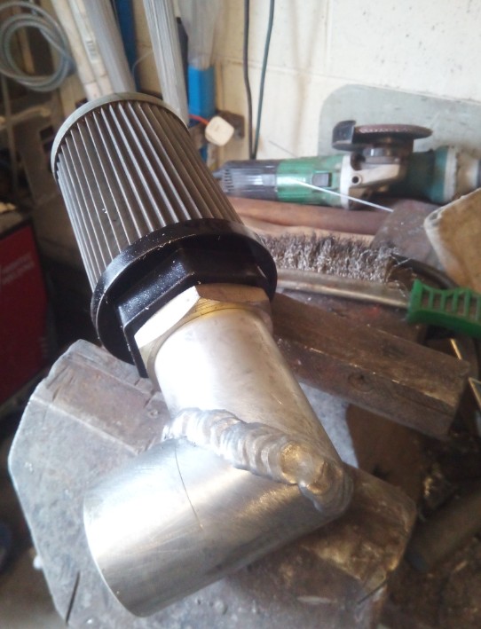

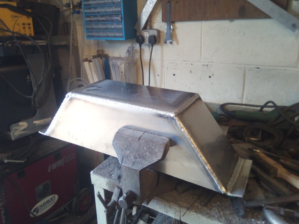

Made a right angle fitting for the hydraulic filter. The first side I bored out then seeing as how it was Aluminium I thought I would just tap it 1"BSP, bad mistake, tap isn't the sharpest (a bit like myself) and it nearly killed me
Next side was single pointed on the lathe, took half the time and no effort required

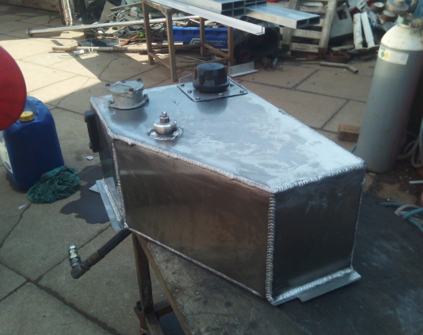

It was then welded into the tank, used the Tig for this one.
Fitted a drain plug and a sight glass, you can also see the filter in situ
Next was to bore/tap the top for the filler and return/vent and the 1/4" BSP fitting (not sure what that is for) and then the top got welded on and that was the tank finished.
Next up was to make a couple of mudguards for a small trailer.

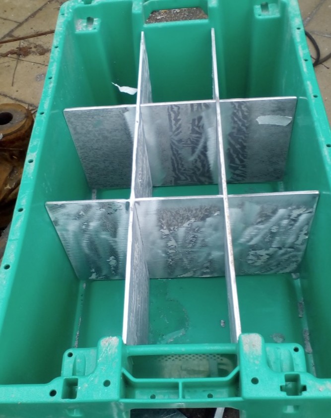

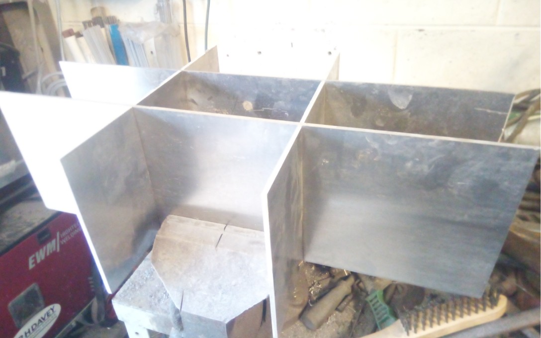

Then cut some more Alu up to make lobster separator for a fish box.
fitted together.
It will slip into a fish box like this one I made a few years ago, it stops the lobsters fighting until the can be banded.
