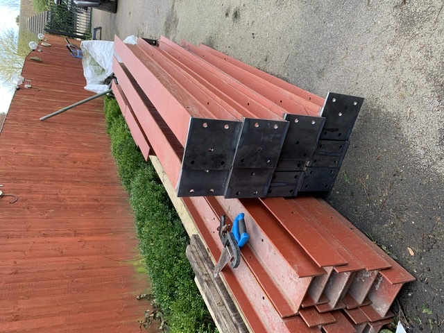

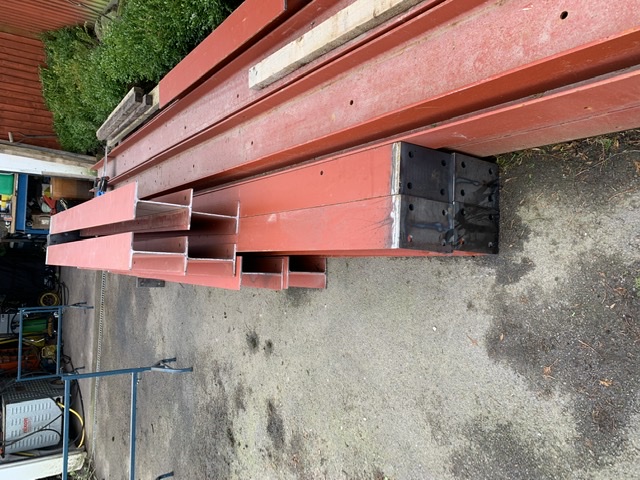

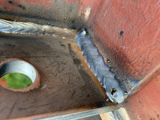

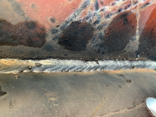

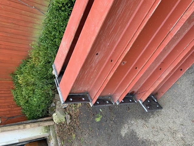

Did you made the holes using the plasma cutter?Made a start on the garage frames today, well yesterday technically. Finished one of them this morning, just some red lead to dab on. Making 2 frames, one for the guy nextdoor and one for me. All done with the R-Tech 50 amp plasma cutter and Pro Mig 250.
I was going to stick weld them but either I’ve lost my touch or I have the wrong rods. Just couldn’t get the penetration right. Anyway the MIG just worked, 1.0mm wire, 220 amps and plenty of gas as I was outside. The wind, rain, hail and snow yesterday wasn’t exactly helpful but did give ample opportunities to stick the kettle on.
Comments / critique welcome.
View attachment 215035 View attachment 215036 View attachment 215037 View attachment 215038 View attachment 215039

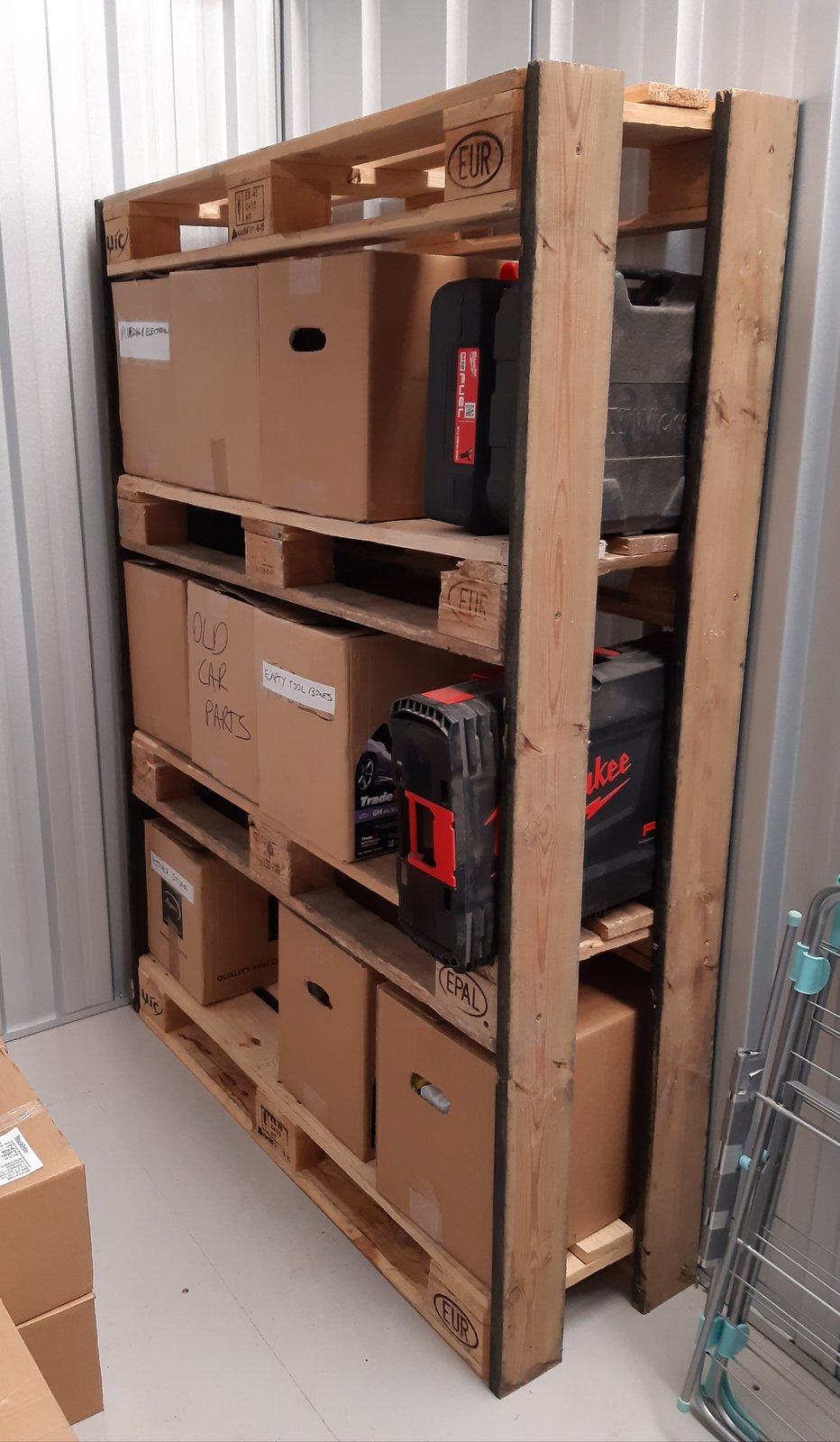

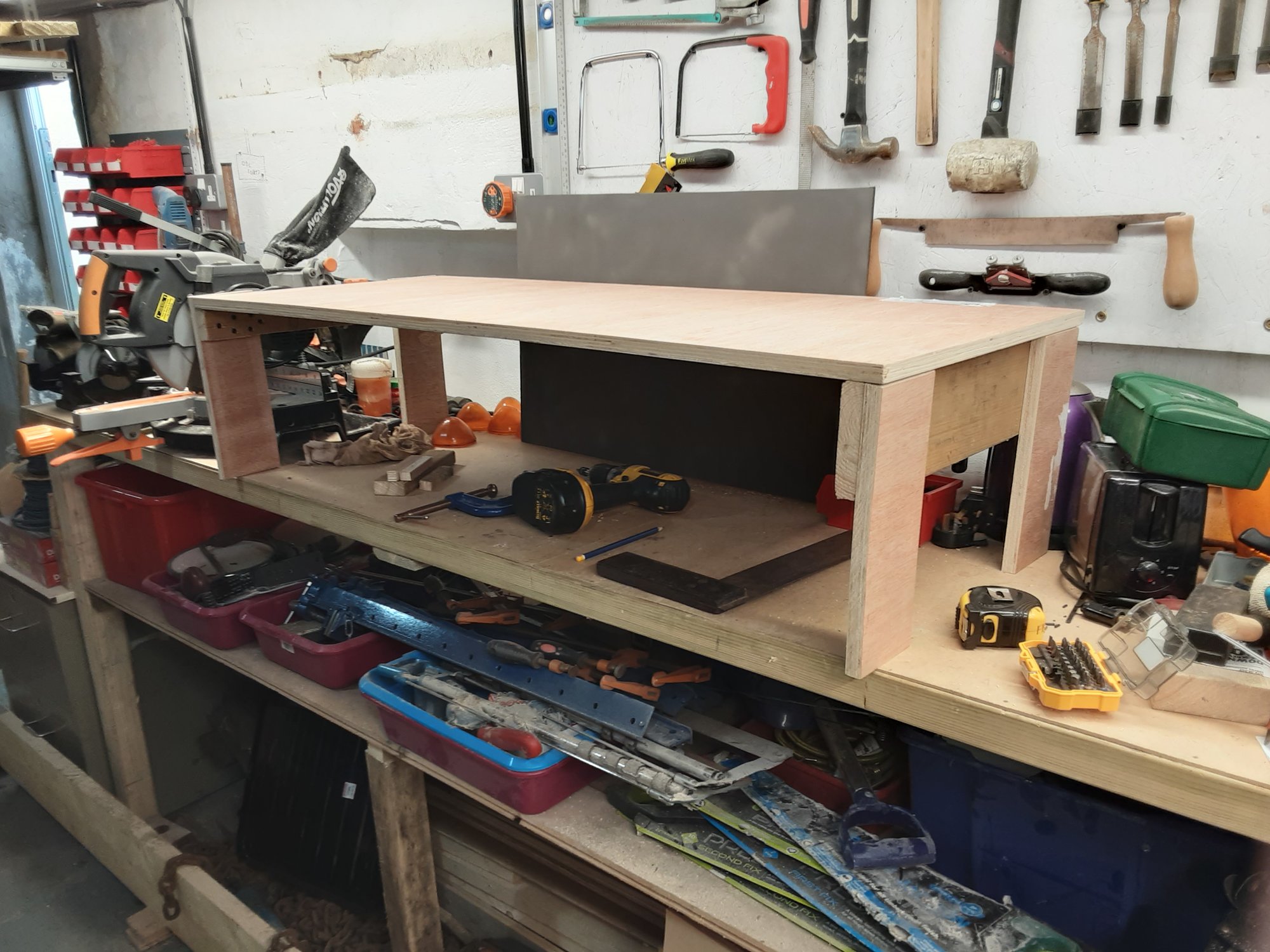

Lost 360mm odd of storage there. Exc top shelf.Made some more pallet shelving, This time for my storage unit. Used a couple of old decking boards on the side supports. Cost me only time & do the job required
I think that the torch and the air quality makes an hudge partNot the plasma, the beams were pre drilled when I got them. The end plates were laser cut including holes, local fab shop place did them from my drawing. But the plasma would have done the same, can’t believe how much more powerful the 50 amp one is over the 30 amp machines.
I know what your saying mate, But it's a quick throw together jobLost 360mm odd of storage there. Exc top shelf.
