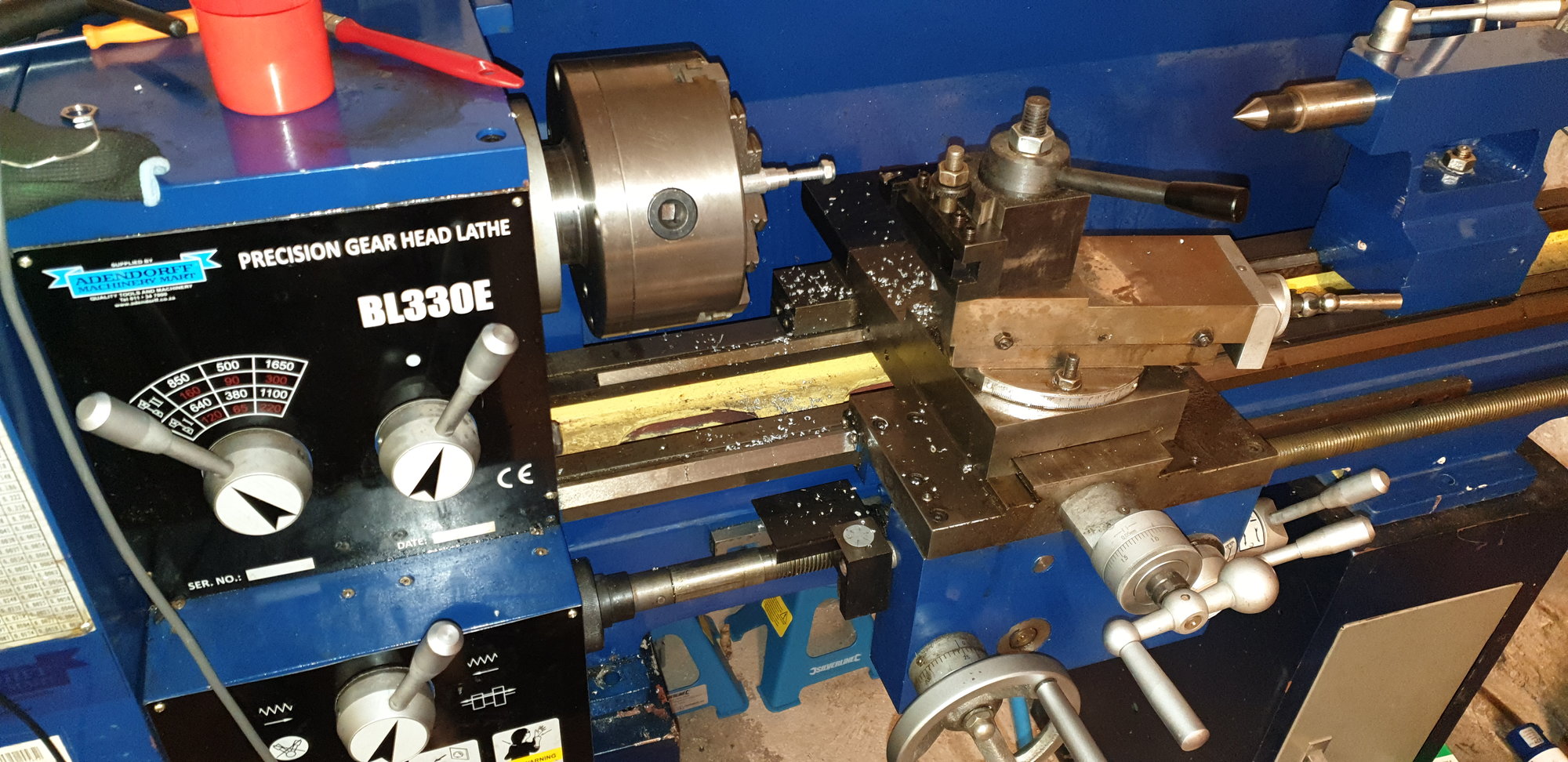

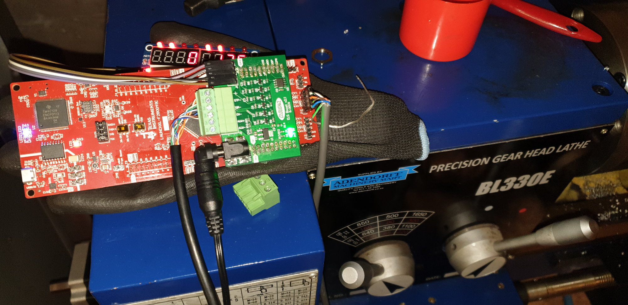

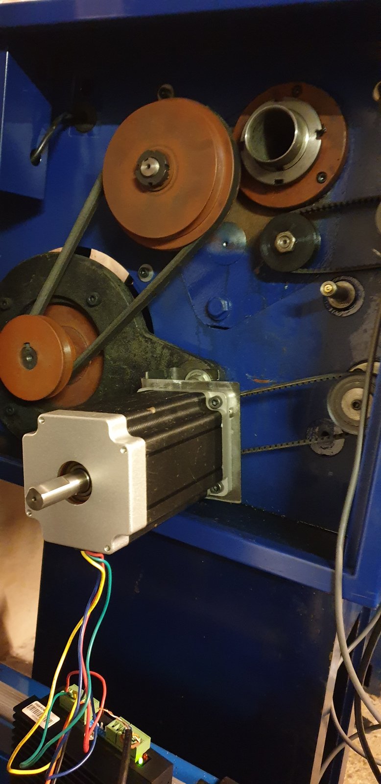

Turned my Lathe into electronic screw - it works need to now make it all nice looking
View attachment 211238 View attachment 211239 View attachment 211240

I just leave the half nut engaged and reverse the stepper motor after backing out the cutterNice job.
How will you sync it for screw cutting?
The electronics has an encoder which is run off the head stock in the back of the lathe which then calculates the stepper motor speed based on the gear ration and stepper micro steps setup on the Stepper driver and in the controller. this is not my design but rather https://github.com/clough42/electronic-leadscrew/wiki - I just followed alongHow do you sync the tool travel speed with the rotation of the workpiece for a given thread pitch?
