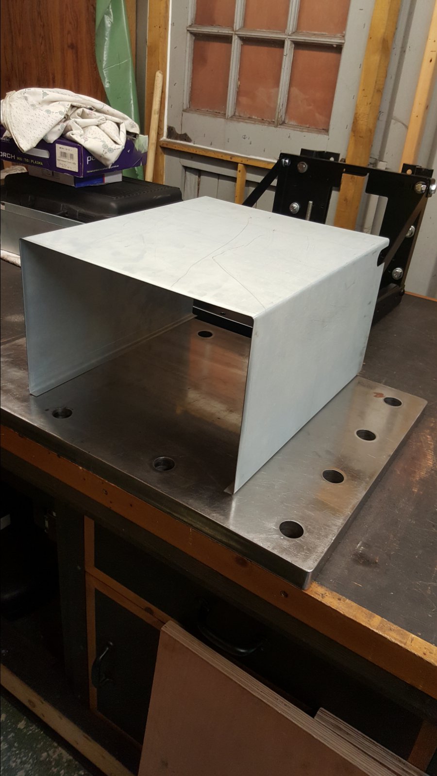

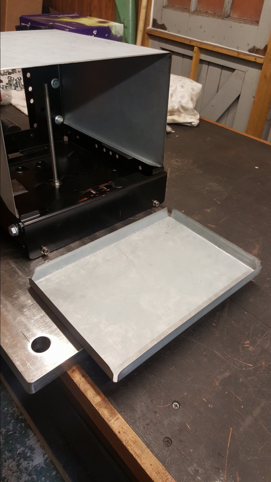

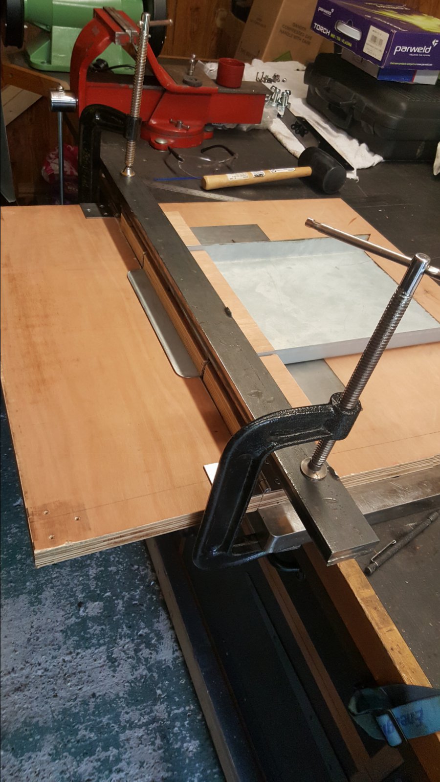

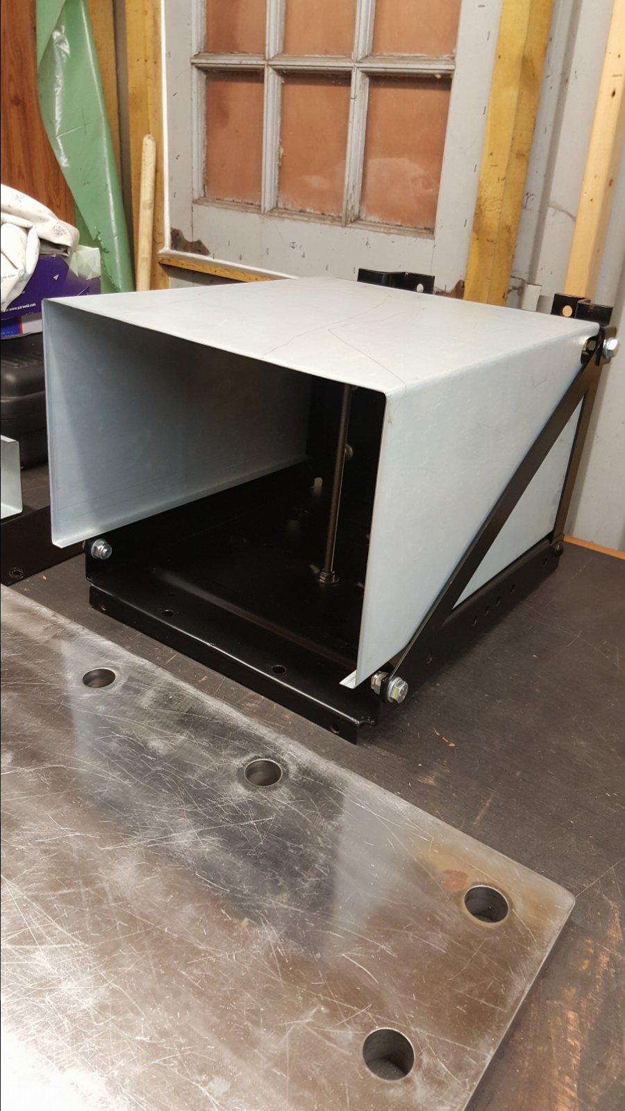

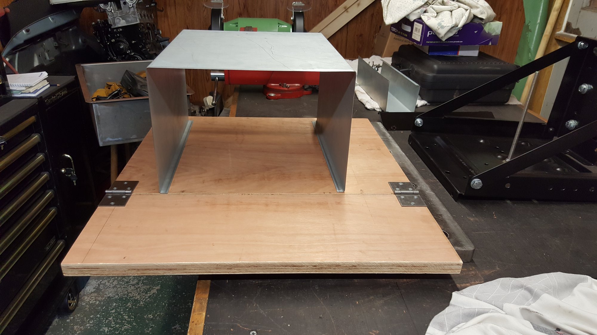

I made all sorts today...started making the top/lid for my lorry battery tray....got to make the front part yet and some other bits..but as I haven't made my metal folder yet I had to improvise....a couple of lumps of 25mm ply wood...two hinges and 12 screws and job done..this simple thing took 10 Mins to make and will bend 1.5mm mild steel..and does an OK job.
