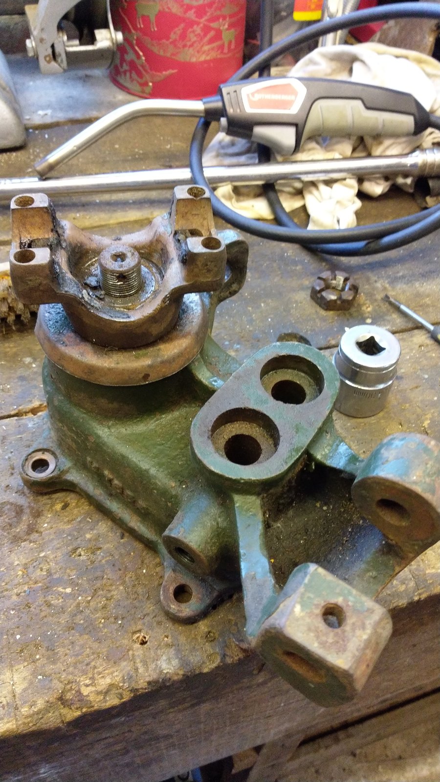

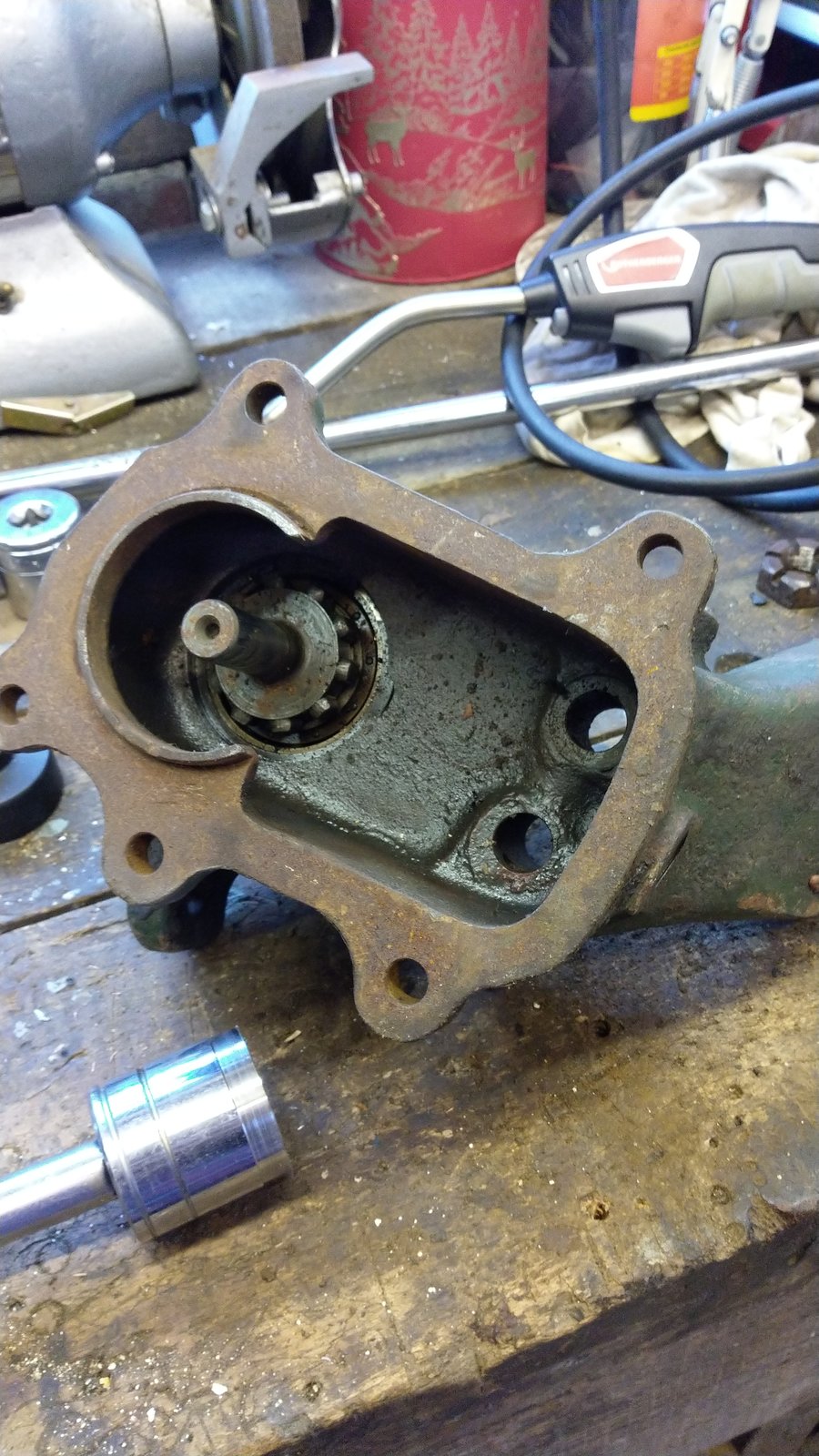

Made my brother in law happy today helping him with his Willy's Jeep transfer box.
The castllated nut on the shaft wouldn't budge and he ripped the vice off his bench abusing it with a breaker bar!I've got a bigger vice and bench!
The original casing was cracked and badly welded in a couple of places so the green one above was bought to repair it.

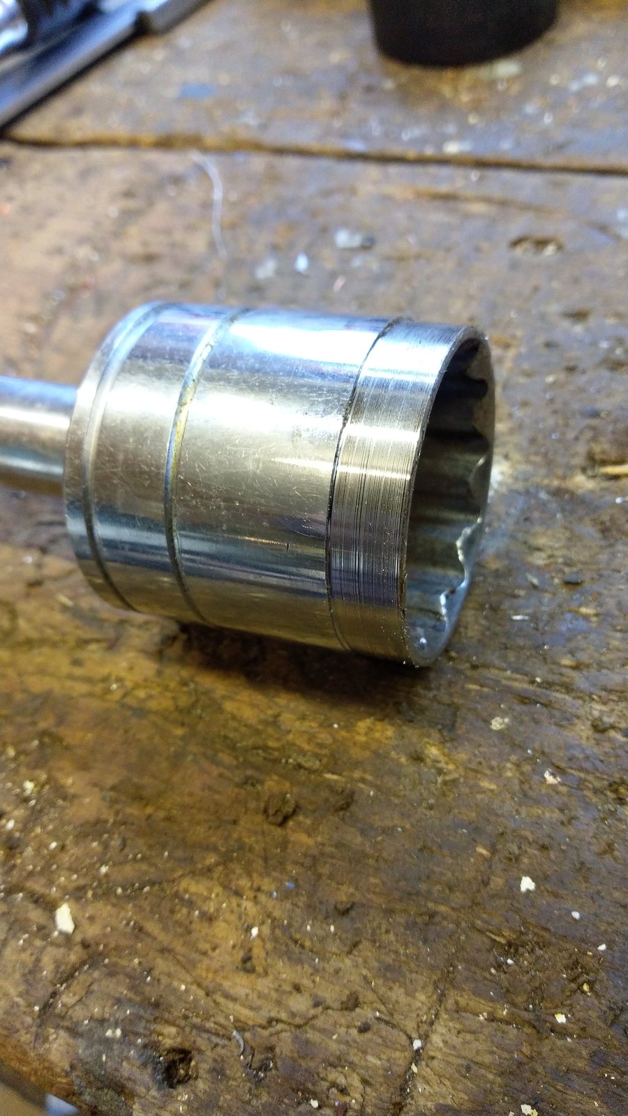

He didn't bring the right socket with him so I had to modify a 33mm one on the lathe to fit in the yoke. Yes I know it should be an "American" size but it's all we had.View attachment 203930
Got the nut hot with the MAPP gas and gave it a rattling with the air wrench but it wouldn't budge so got it hotter and tried the breaker bar and it moved!!!
We then pressed the shaft out with my 12 ton press that I haven't used in over 2 years
Here's the other side.
We then stripped down the old one to keep some of the parts as it's an original MB Jeep so quite rare.
He was very happy and promised me beer in the near future!

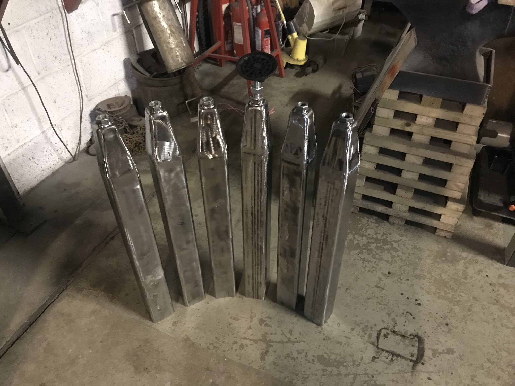

kids are not going to be very happy with you when they realise you pinched the giant jenga to use as an anvil standI had a chance to cut the rest of my welding tabes legs cut, capped and fitted with M20 captive nuts.

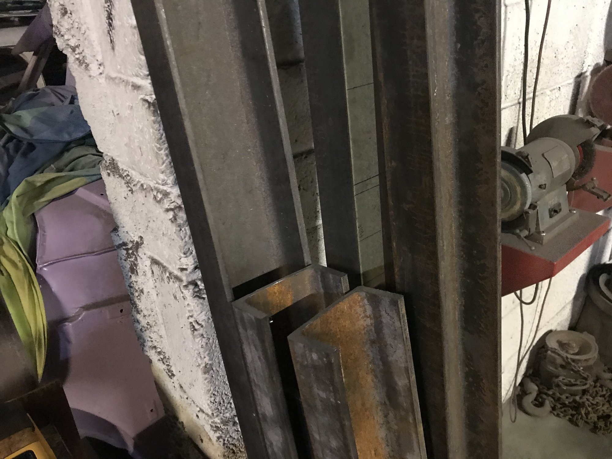

I also got the 100x50x10mm chopped up for the frame of the table. It’s going to be very heavy.
I do prefer also for esthetic reason a dead three carcassAnvils are more important than jenga but I do need to pull a couple layers out as it’s a bit tall for me at the moment.
