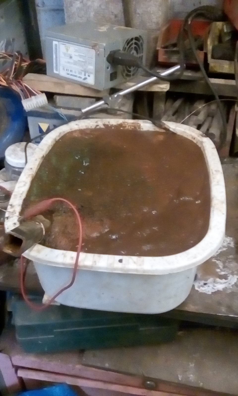

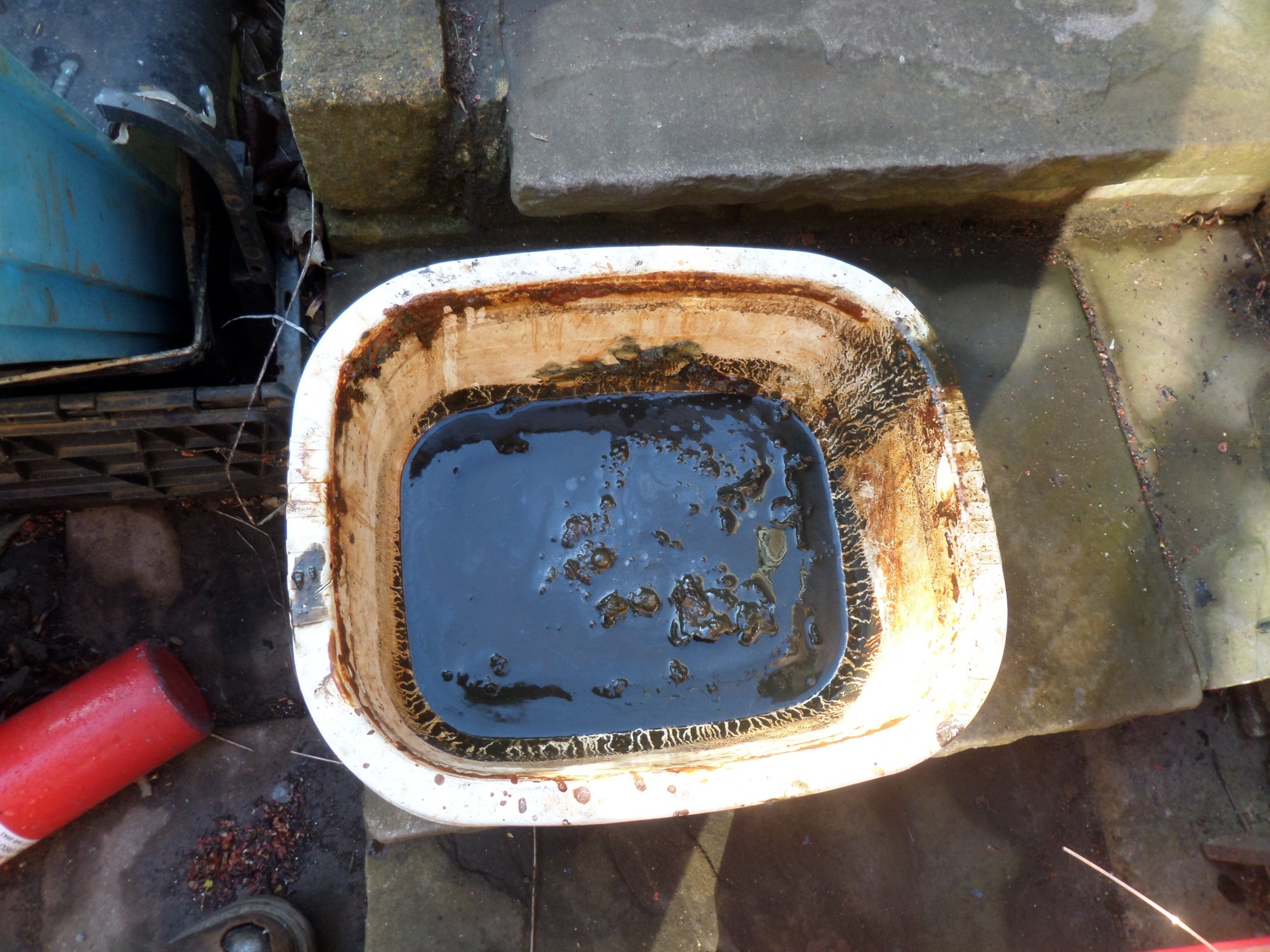

Any details on here of the bath? D'you use it for de-rusting?

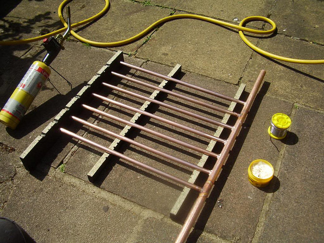

So are those cans empty? with just the copper pipe going straight threw ,or are the pipes soldered to the cans..and full of water?Or you make solar thermal panels out of them...

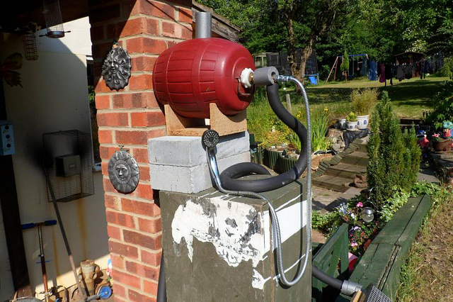

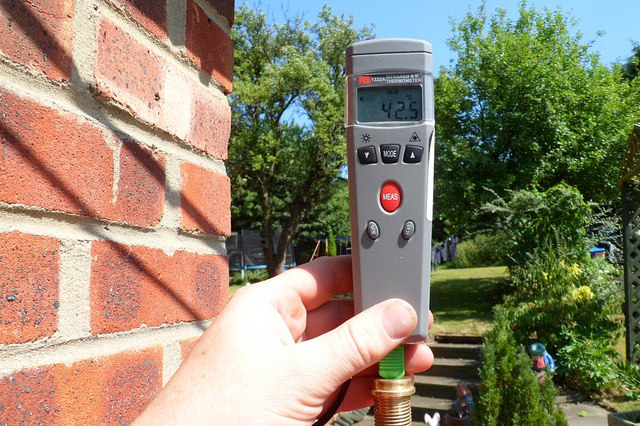

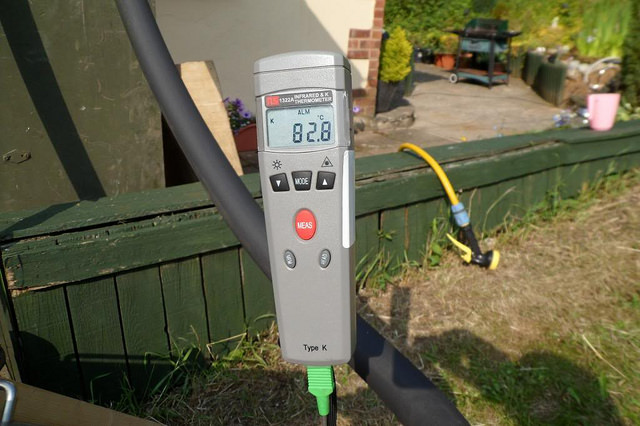

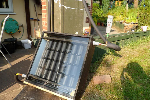

At the panel outflow:
The old brew keg is a bit lossy as uninsulated:
But (more than) hot enough for an al fresco shower. (Good for car washes too):

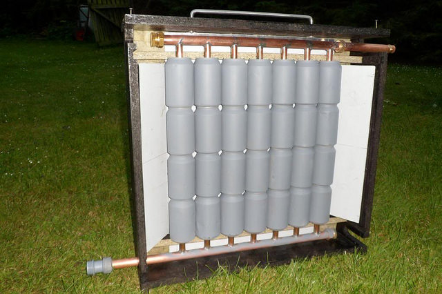

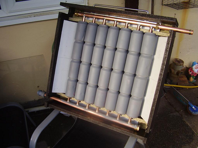

thanks that makes sence, if sun reflects of rear board would it be better to have a gap between each stack of cans so sun can actually get at board?Cans are empty with the tops and bottoms taken out. The cans do not touch the copper pipe matrix. The cans simply stack but at each end are set into grooves in the boards. The 15mm pipe passes thru a 16mm hole in the board.
The other half of the board gets slid in with a good slug of silicon to try and seal where the pipe goes thru the board. Cans get painted matt black. The idea is the Sun heats outside the can and because of the semi reflective back plate you get some sort of 360deg heating of the can stack. That gets transferred to the air inside the can and into the copper pipe. Sort of Pseudo Evacuated Tubes!
