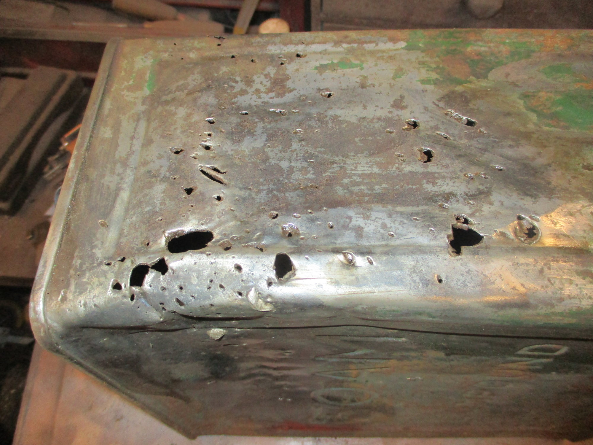

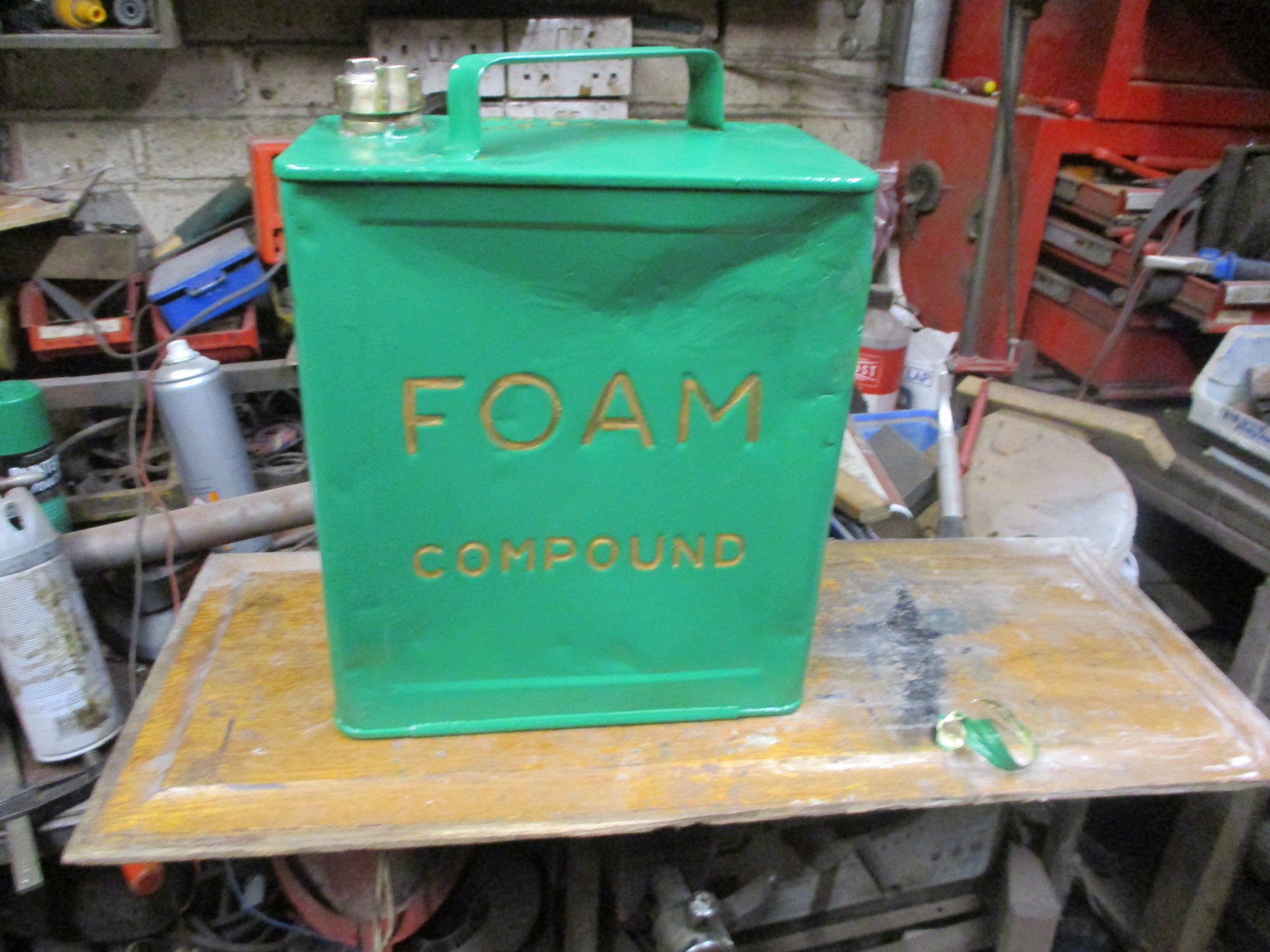

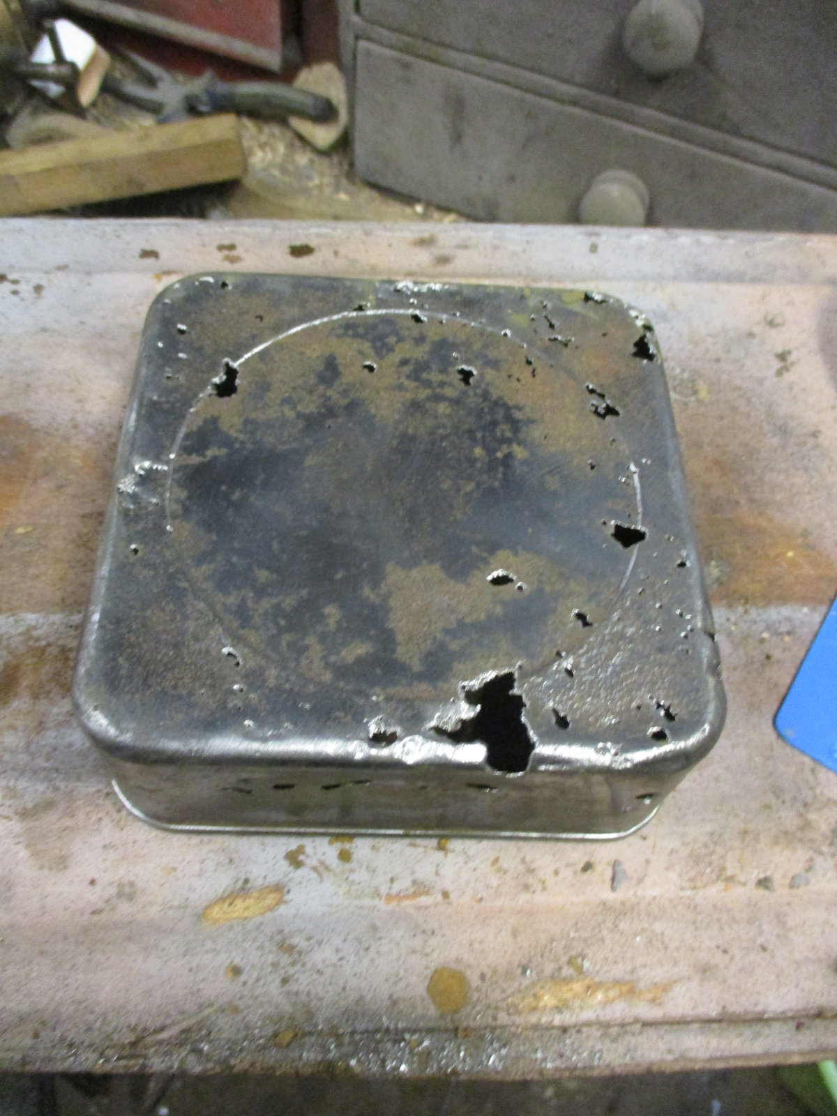

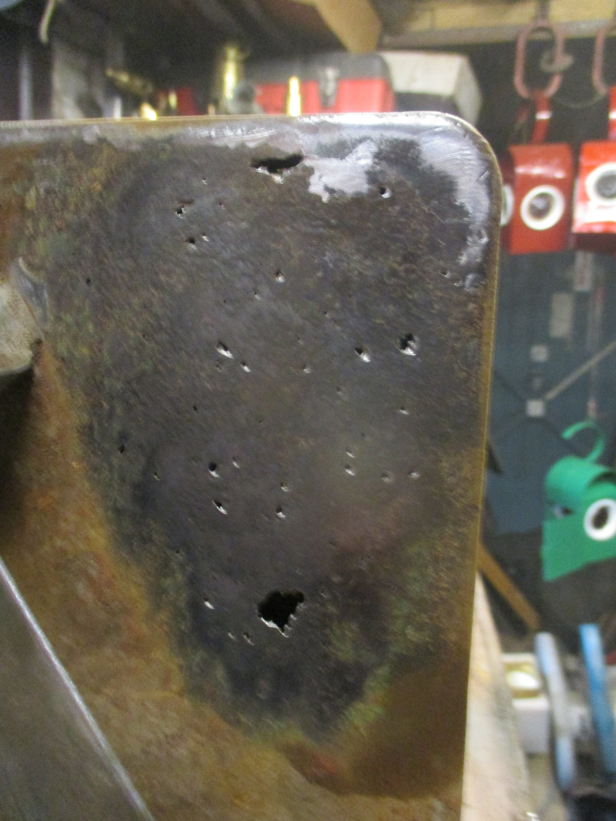

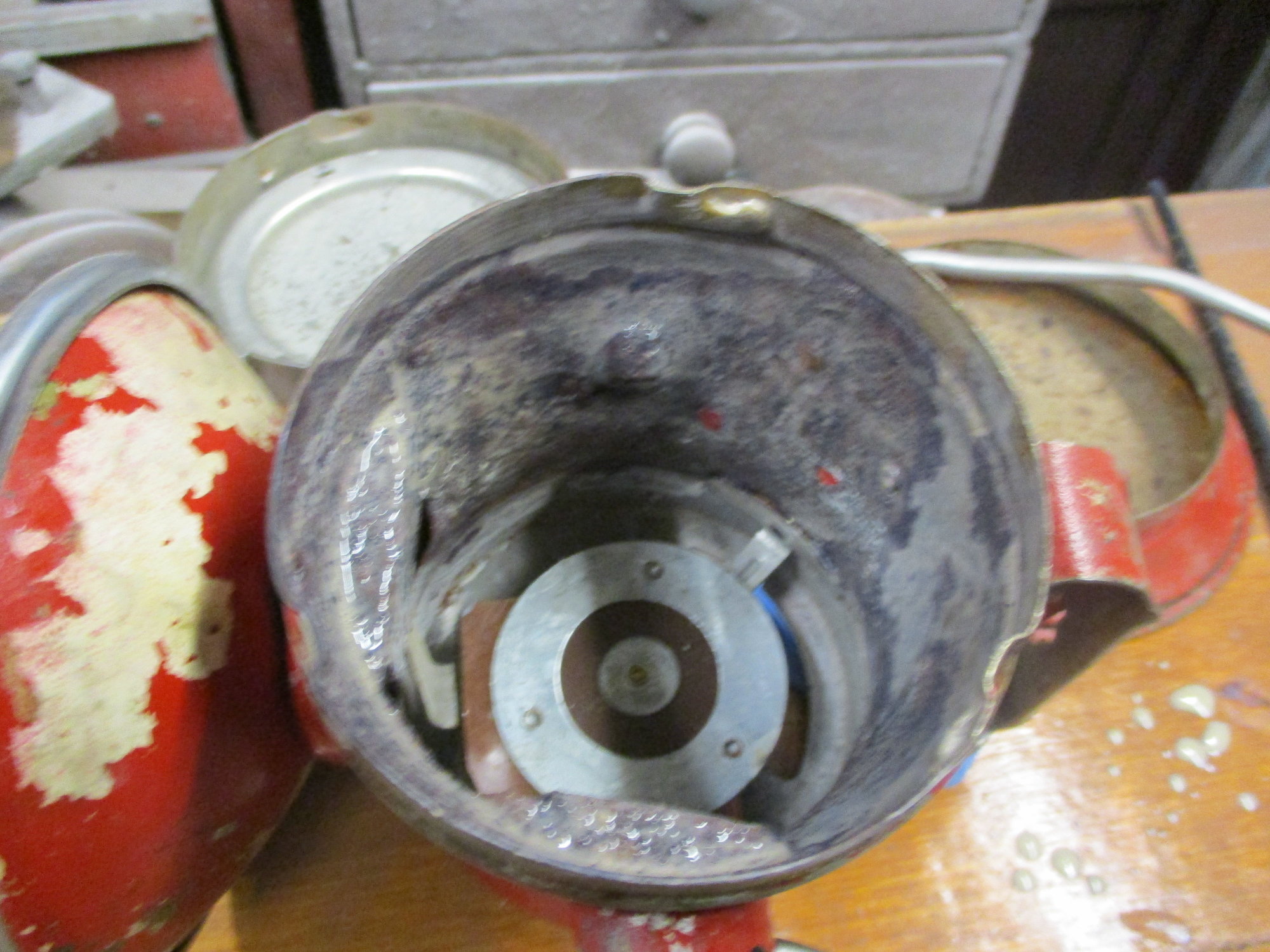

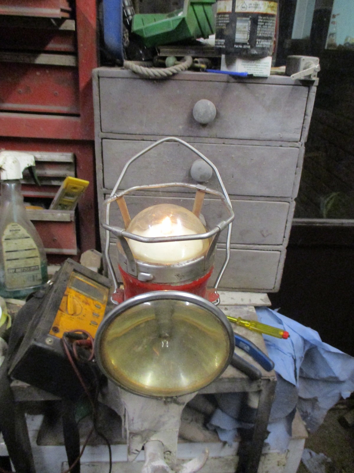

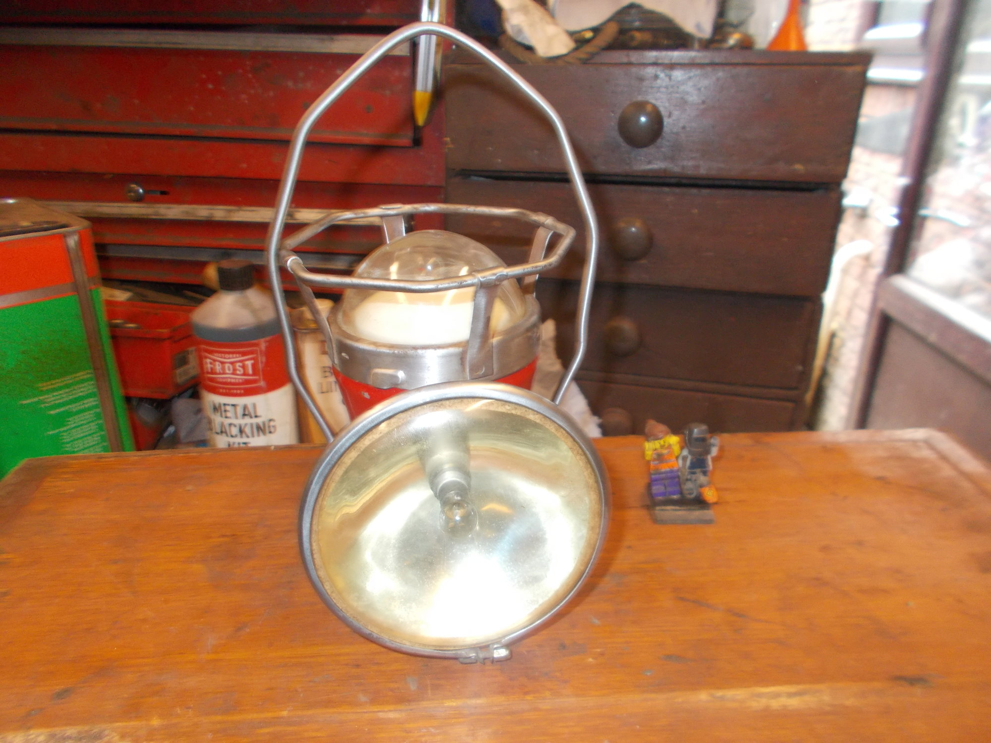

I got this Paraffin Road lamp tank.
It came with extra/minus bits.

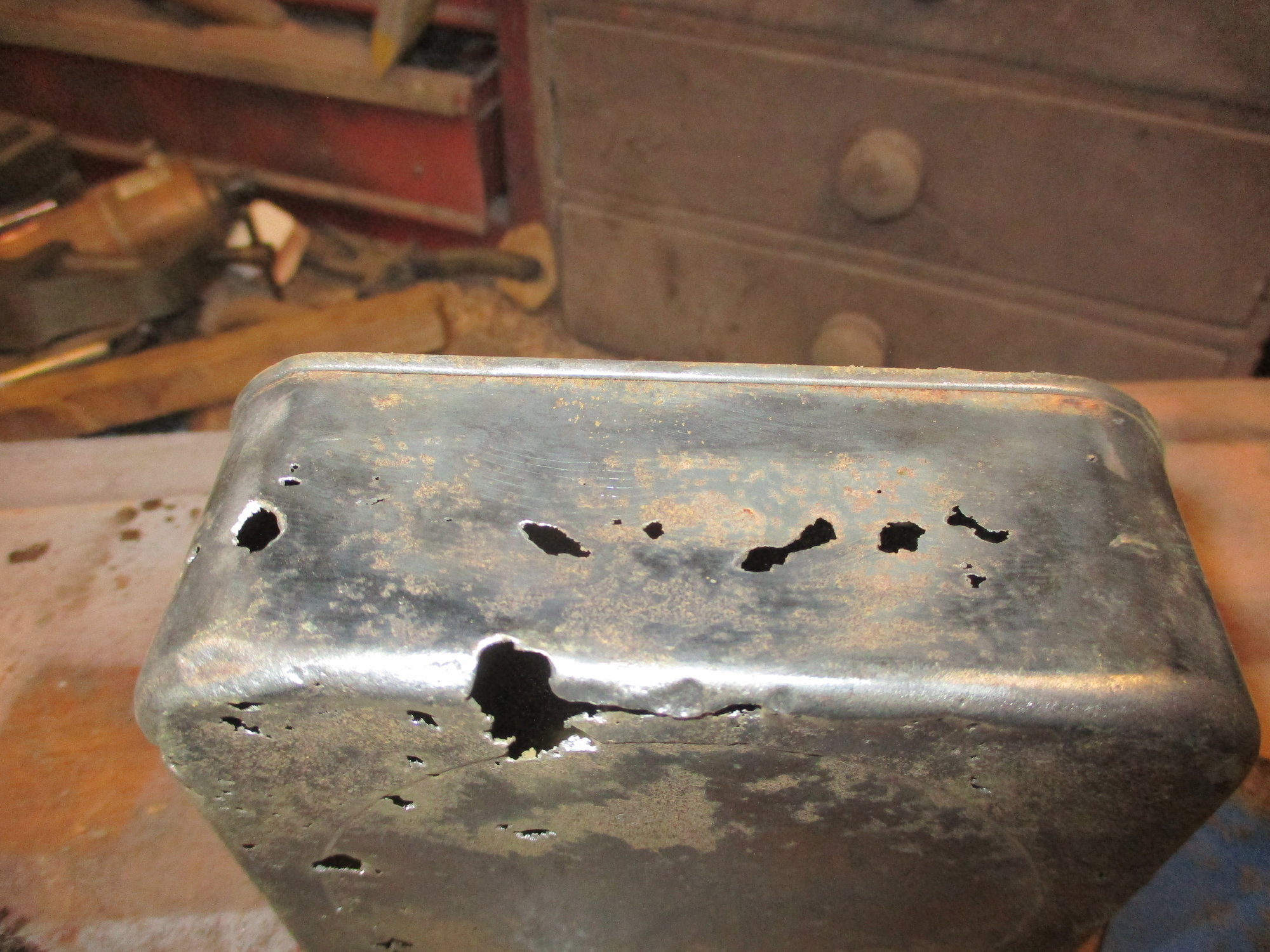

Holes. Lots off them.
The line of holes goes equally round the 4 sides.. Clearly were the fuel sat on the water.
How to fix it?
Patch it!!

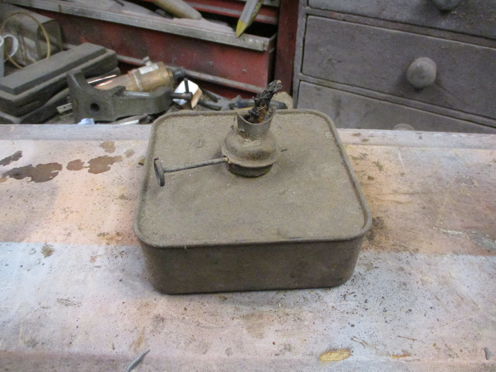

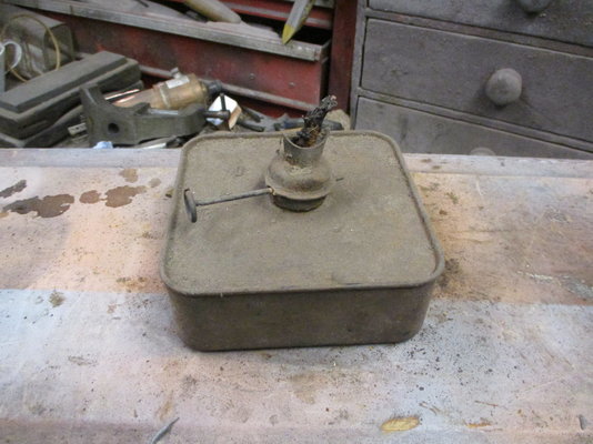

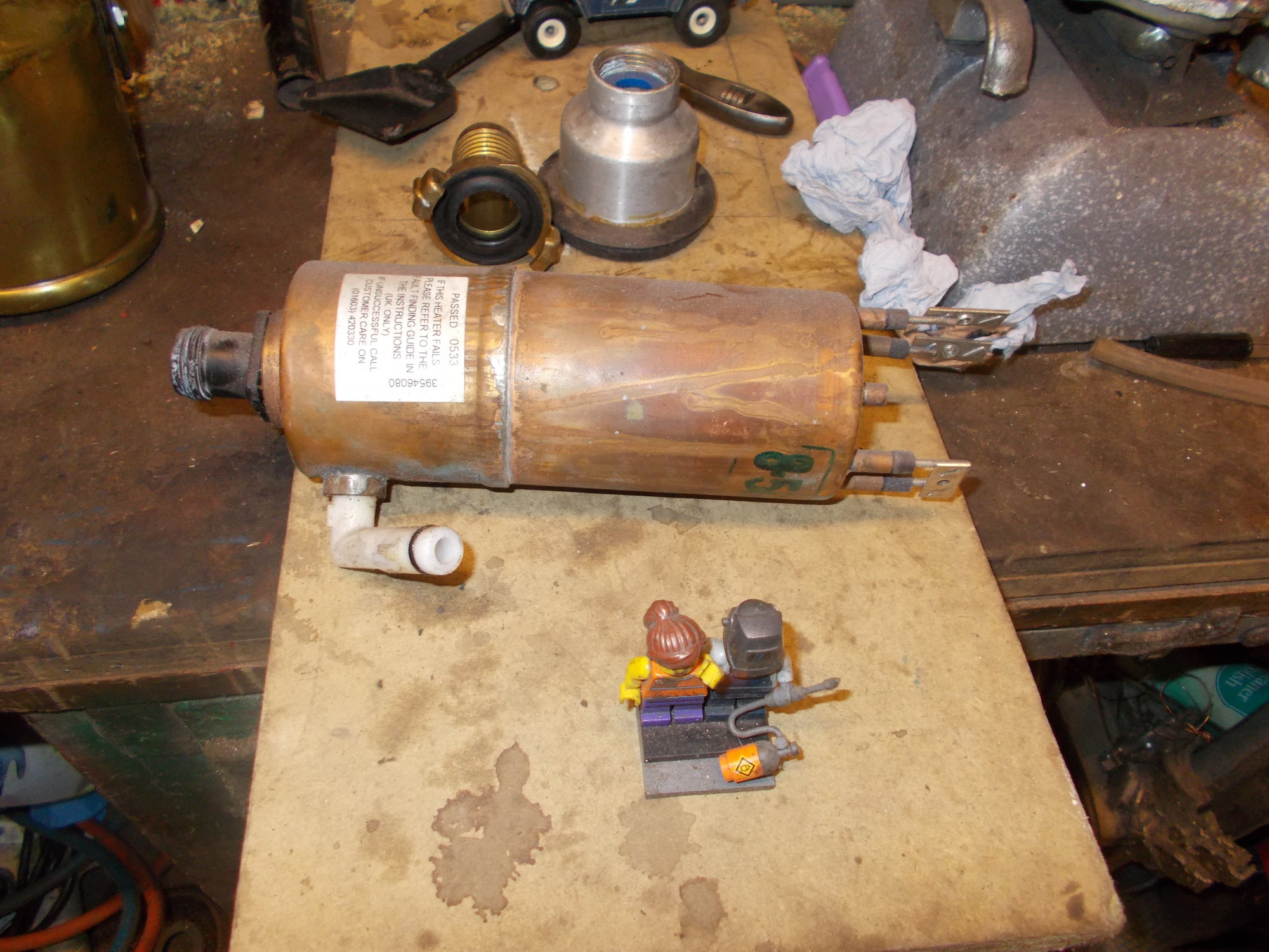

This is a copper hot water heater. It was no good as a heater for a plan I had. So it donated the copper as patches.

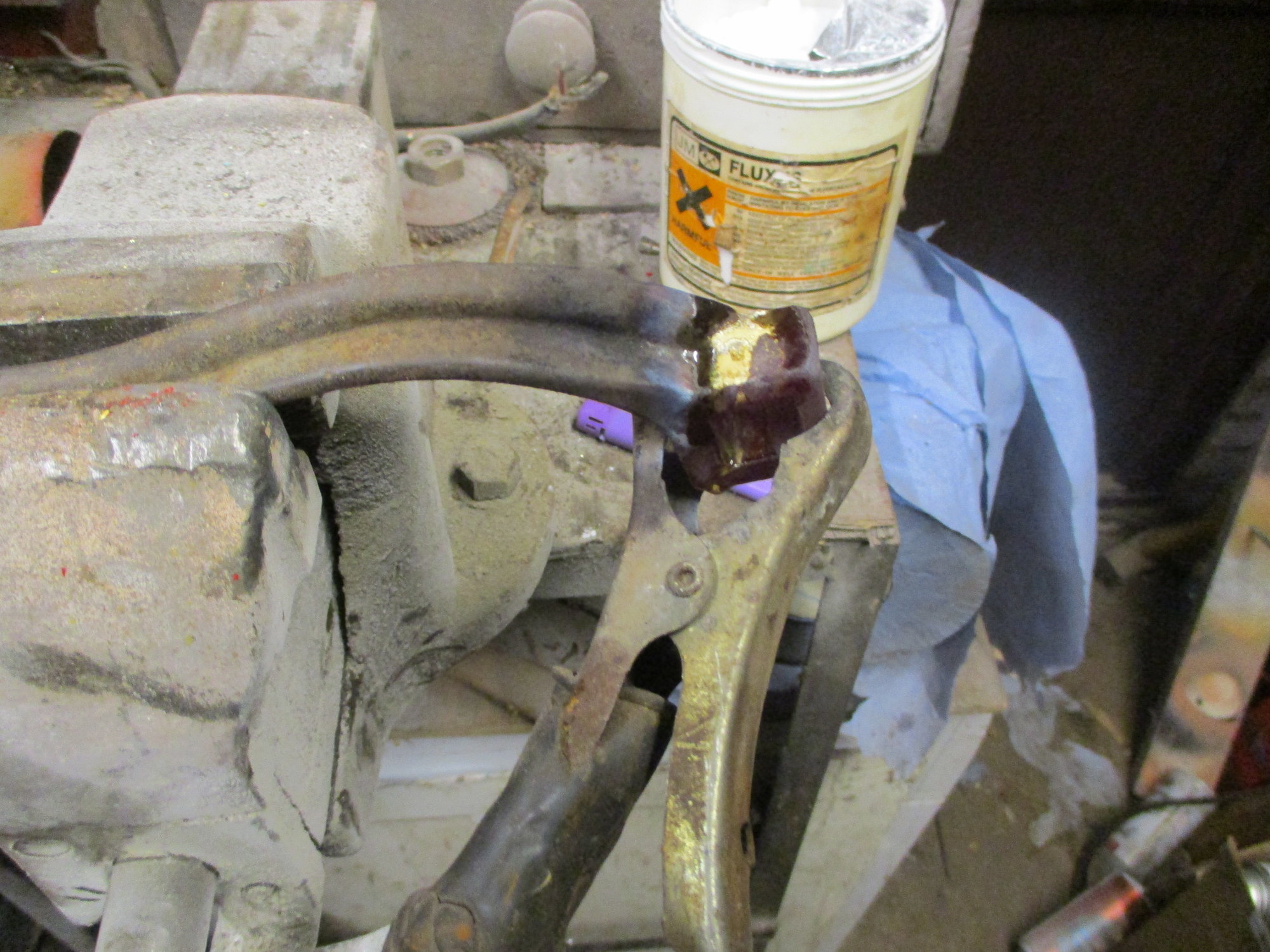

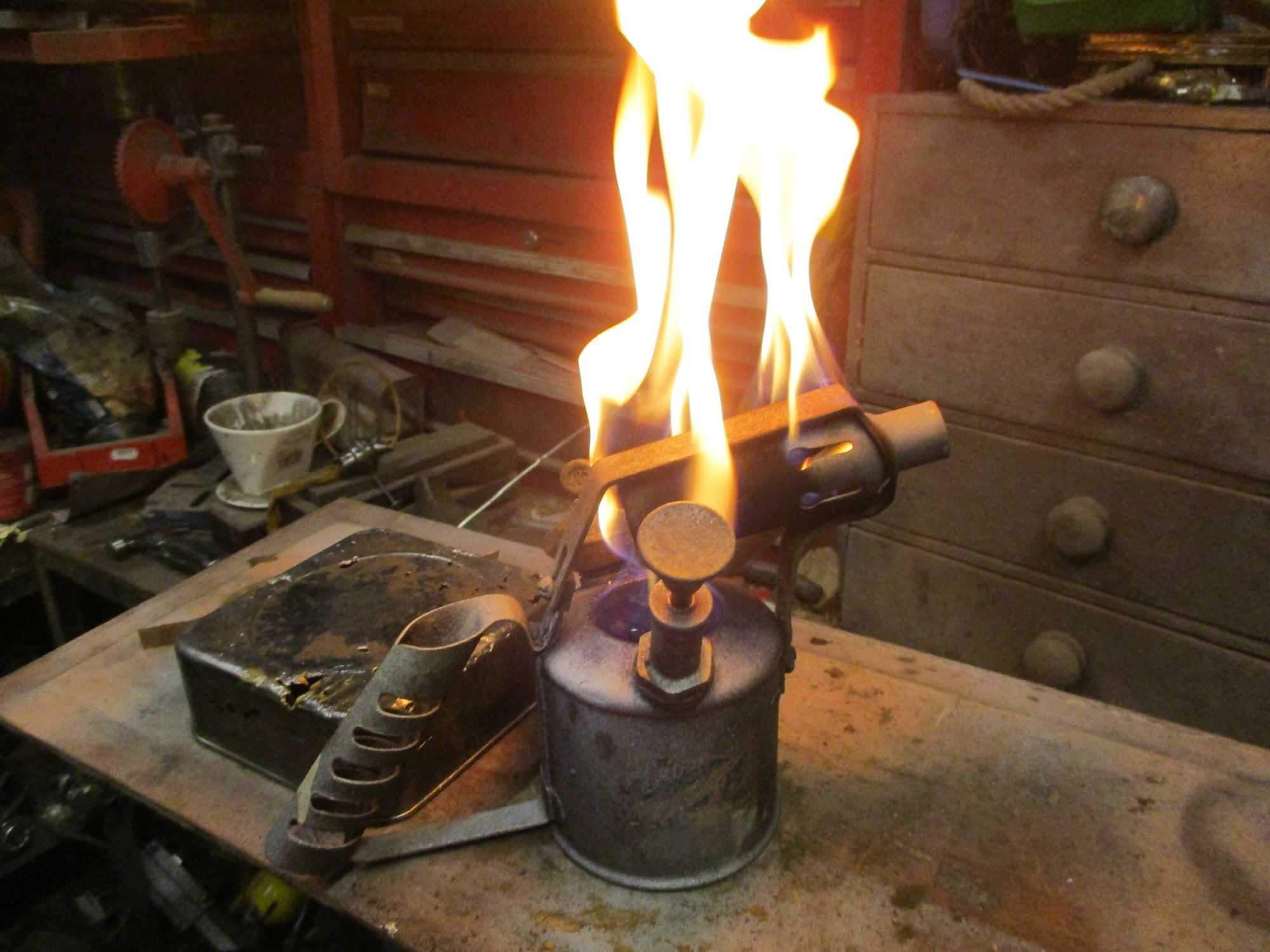

Warming up the torch.

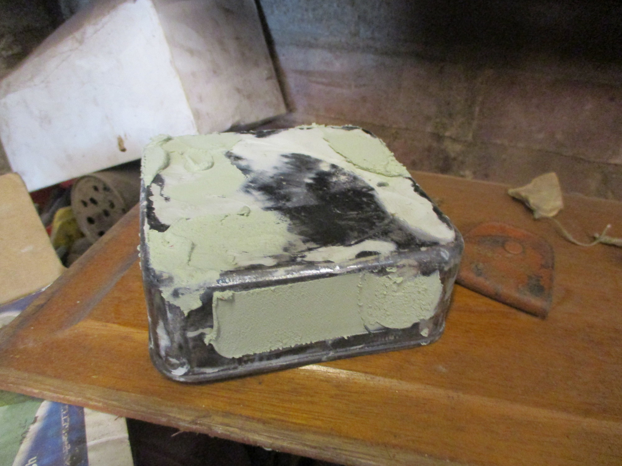

Water proof 2 pack filler to hide the terrible repairs and fill any pin prick size holes the sanding will have made.

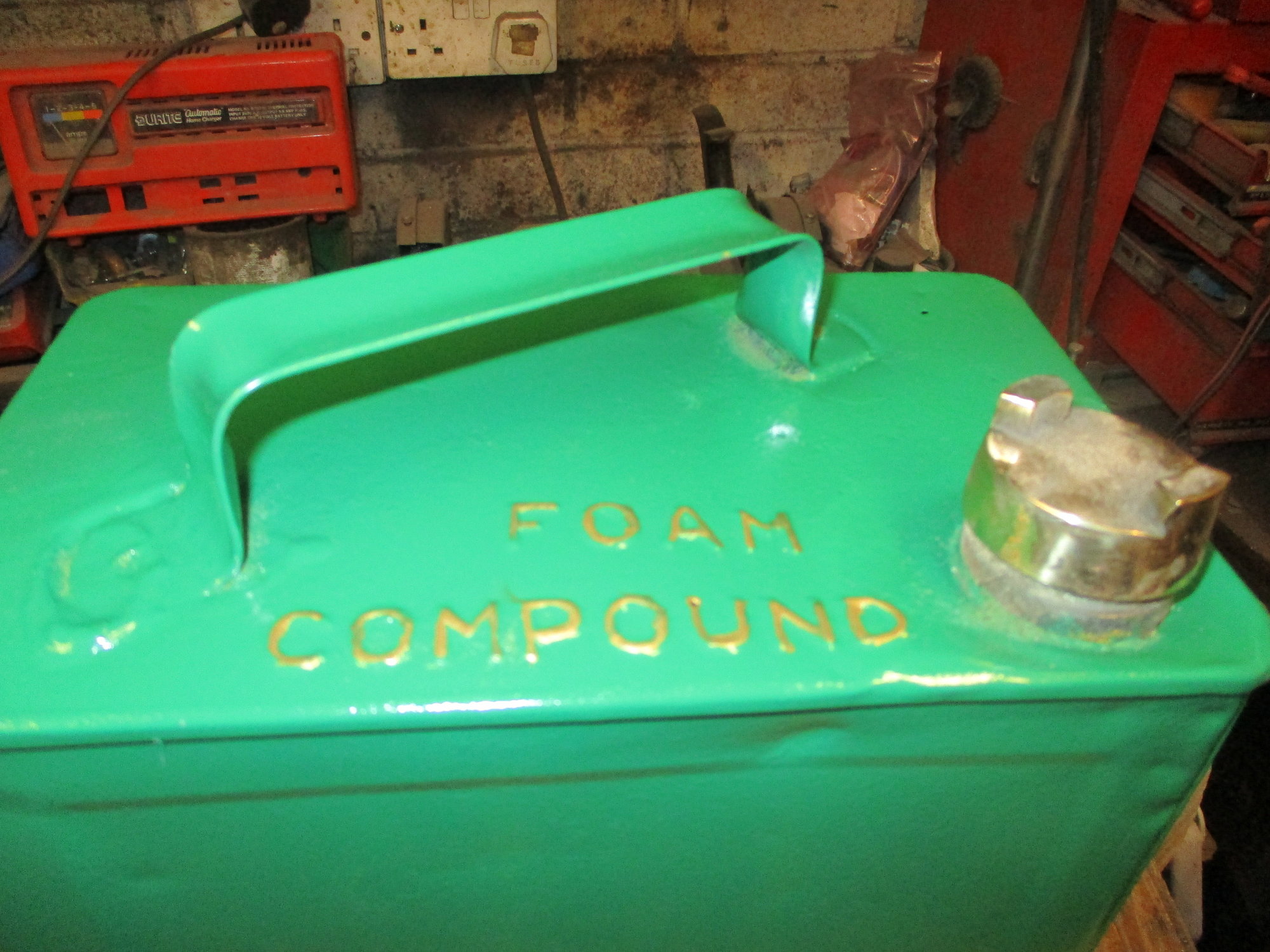

In paint, second coat off filler primmer.

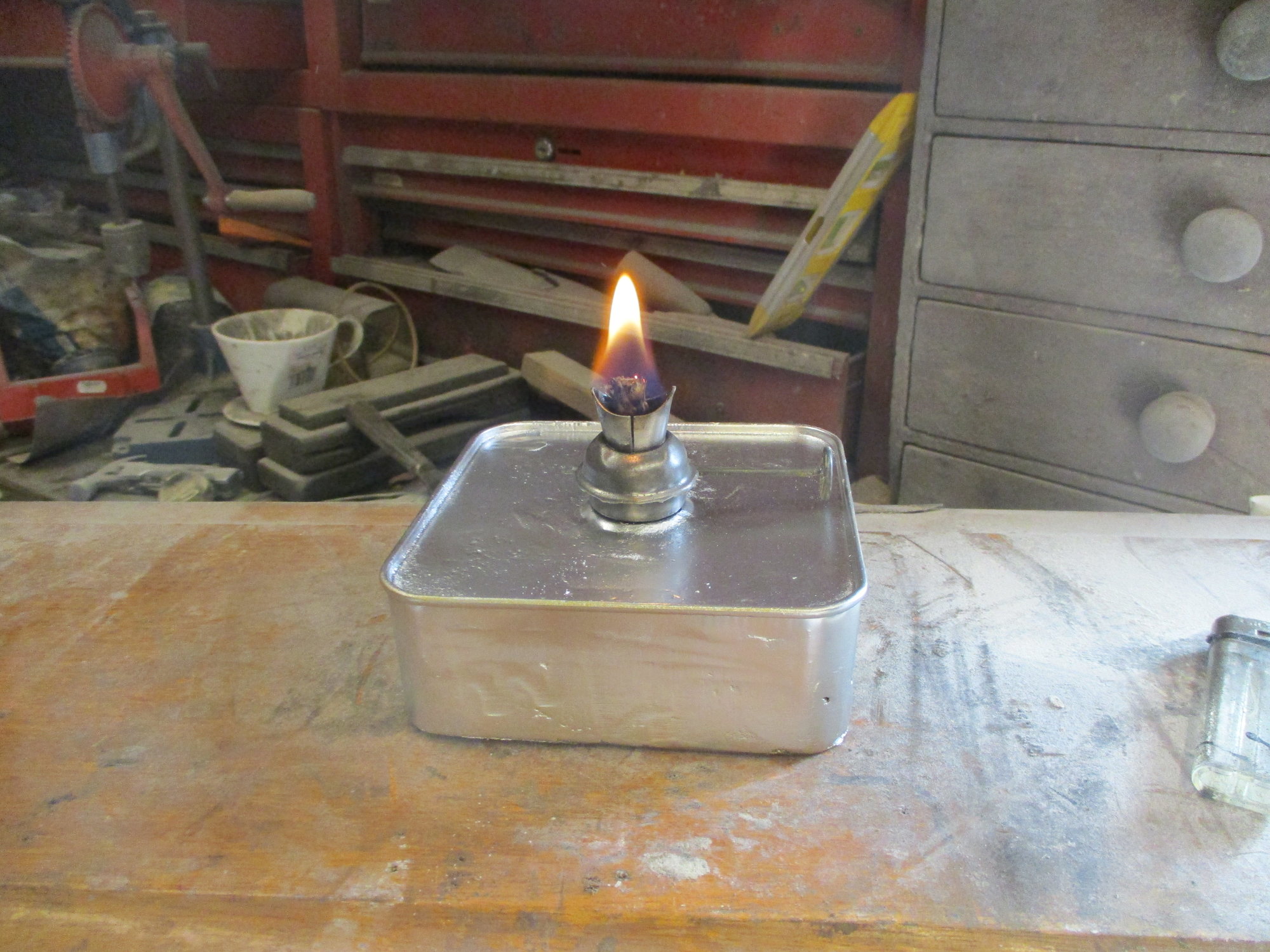

Silver paint and on a dusty surface, no leaks.

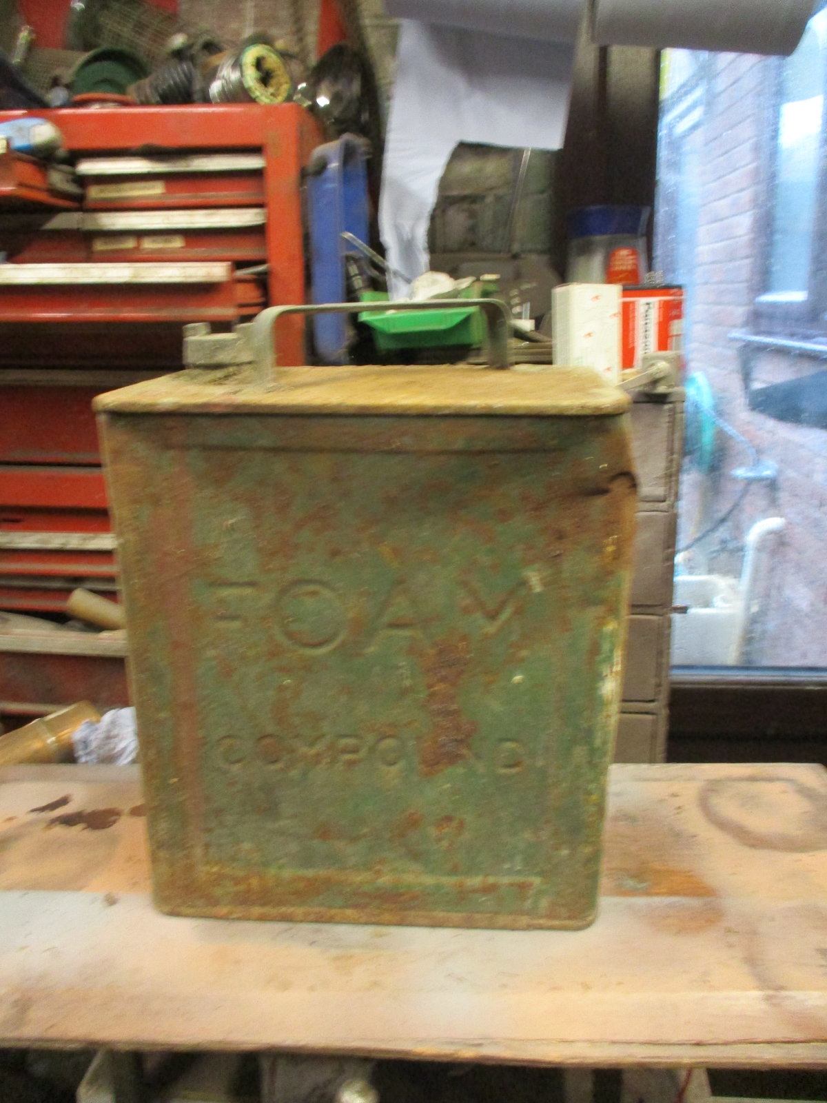

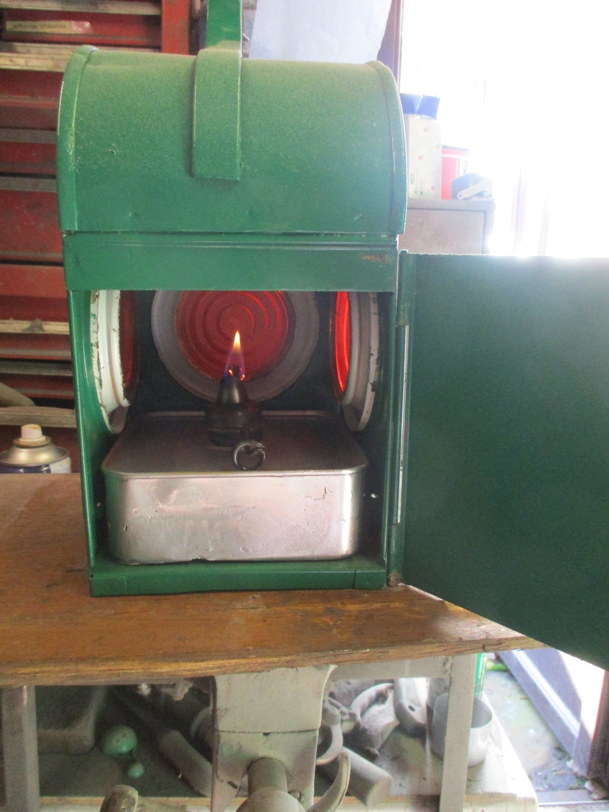

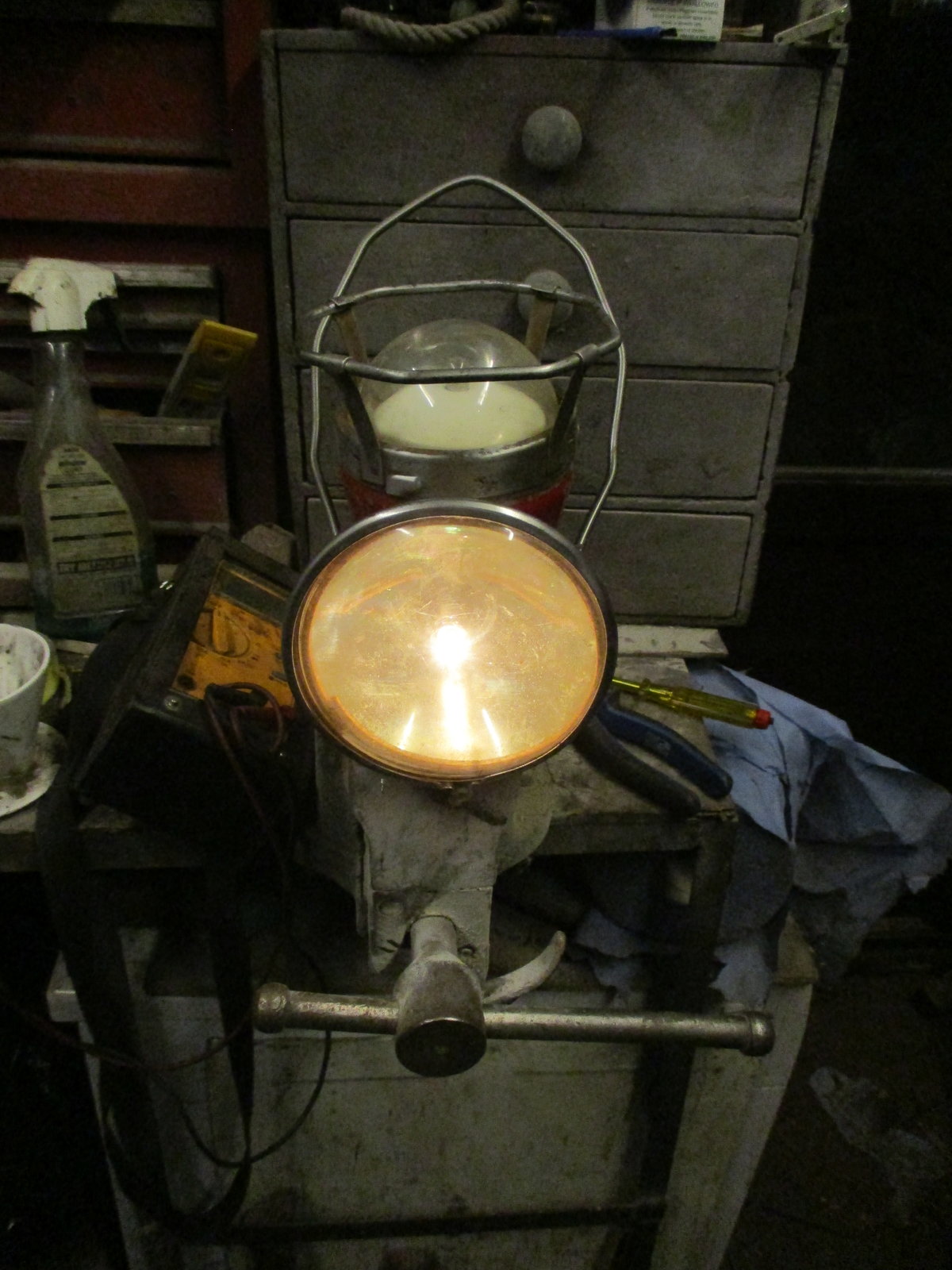

Will now go with the Green Road lamp.
Not a bad repair.
Was it worth it?
No.
The time to cut, tin solder and tin the body to make it leak proof was more than I could get a new /replacement for.
Would I do it again?
Yes.
The fun of doing it, the fun of using lead/tin solder the seal and fill holes was a good fun. That I think out weighs the cost of the parts.
