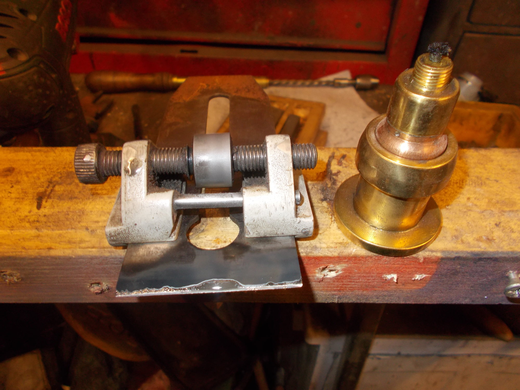

Woke up at an ungodly hour this morning, it was clear I was not going to get any more sleep.
This Davey Lamp needed some attention. I new the fuel tank came off, but the filler/wick holder was seized.
The glass was loose, as the witness marks from the Brasso gives it away.
As it was early hours no power tools or such.
It did come to bits.
The locking ring, second in from the left, held the internals in the top body. Peace of oak cut down on a taper was used to unscrew it.
Dust mask on as I did not know if the gaskets were harmful. They will be disposed of correctly.
New ones made from a modern suitable material.
Cleaned by hand. Brasso and wire wool at first, a tooth brush used in the difficult bits.
Then sealed with rattle can clear coat.
The wick holder was seized by wax, Brasso and some sort of thread sealer..
Warmed with a gentle flame and using a bit of leather offcut and slip jaws had it free.
The wick was cleaned with washing up liquid, 4 marbles and a plastic bottle. Shaken hard and when cleaned iron dried.
Lamp oil and we were away.
The glass is badly scratched but a lot better when cleaned and dried with newspaper.

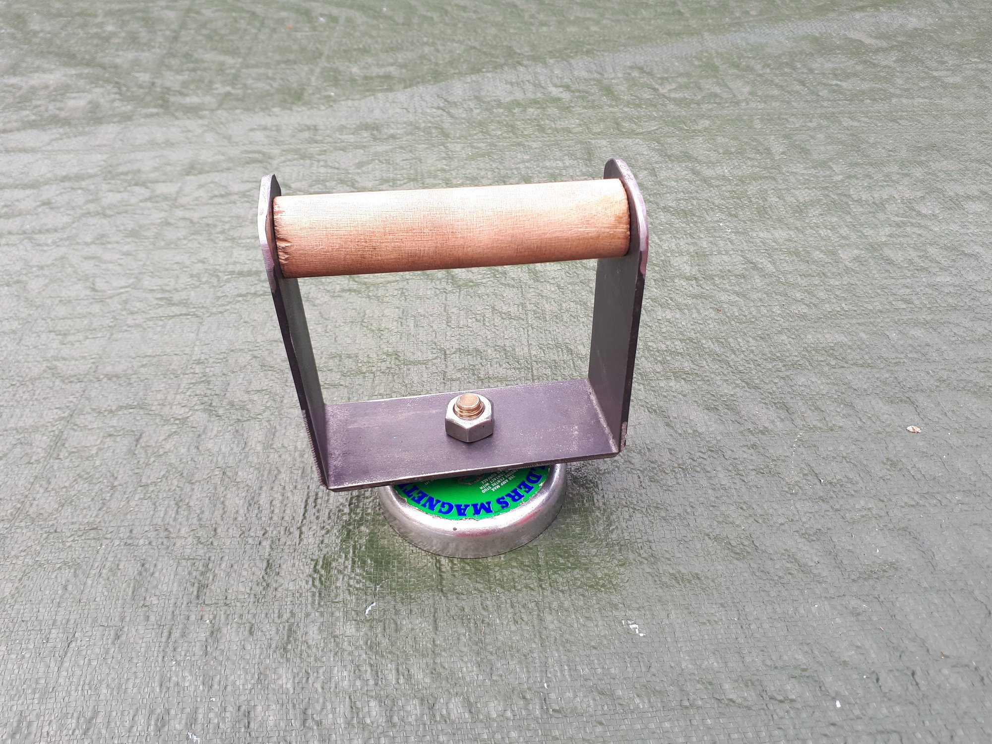

i'll use it to help pickup steel pieces from under the table.
