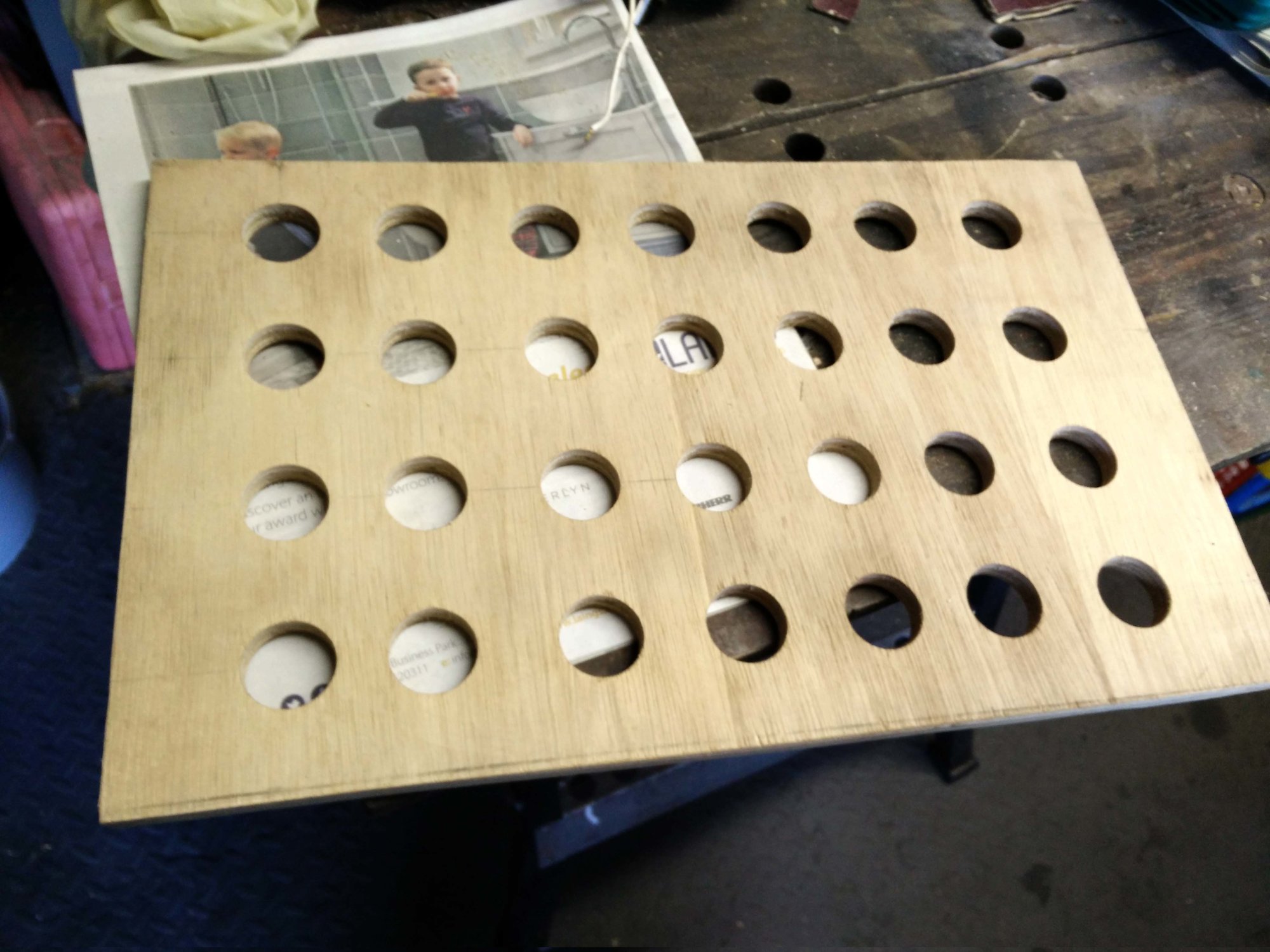

Today, because I'm 'allowed' after the eye op, I made a lot of holes -
A job I’ve been threatening to do for twenty years!Today, because I'm 'allowed' after the eye op, I made a lot of holes - a holder for the milling collets. The edges aren't parallel but I'm waiting for a pal to return my power file just to trim them.
Not finished, sides/uprights to make, but progress is progress![]()
How is the eye now Slim?

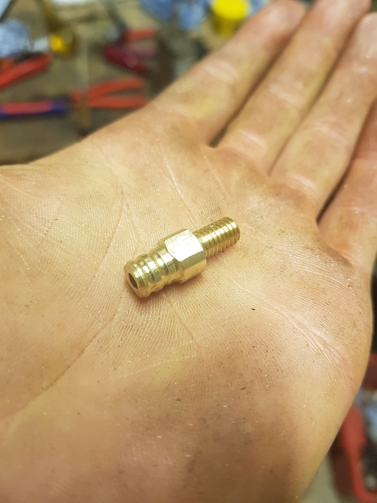

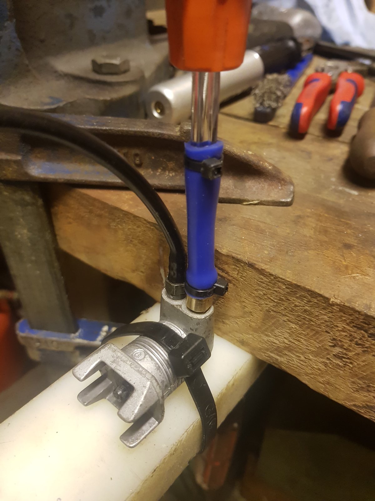

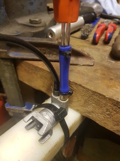

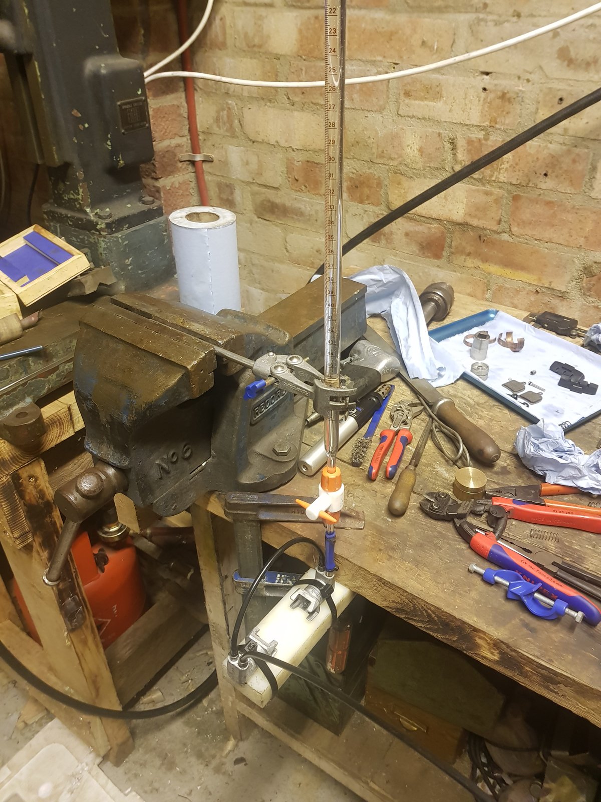

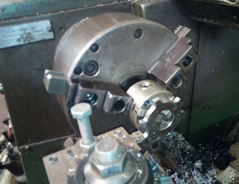

A bleed tool for Magura HS33s (Hydraulic rim brakes);
I make a new one every time I bleed them, usually just an M6 bolt with a 3mm hole drilled down it, I thought this time I'd try to make it a bit nicer and try not to lose it.
The thread screws into the slave cylinder and the barb accepts a bit of hose that would ordinarily have a syringe on it.
I don't have a syringe so I used a burette.
I was looking on eBay and there’s a HS33 bleed kit for £13 delivered was going to order it for mine
