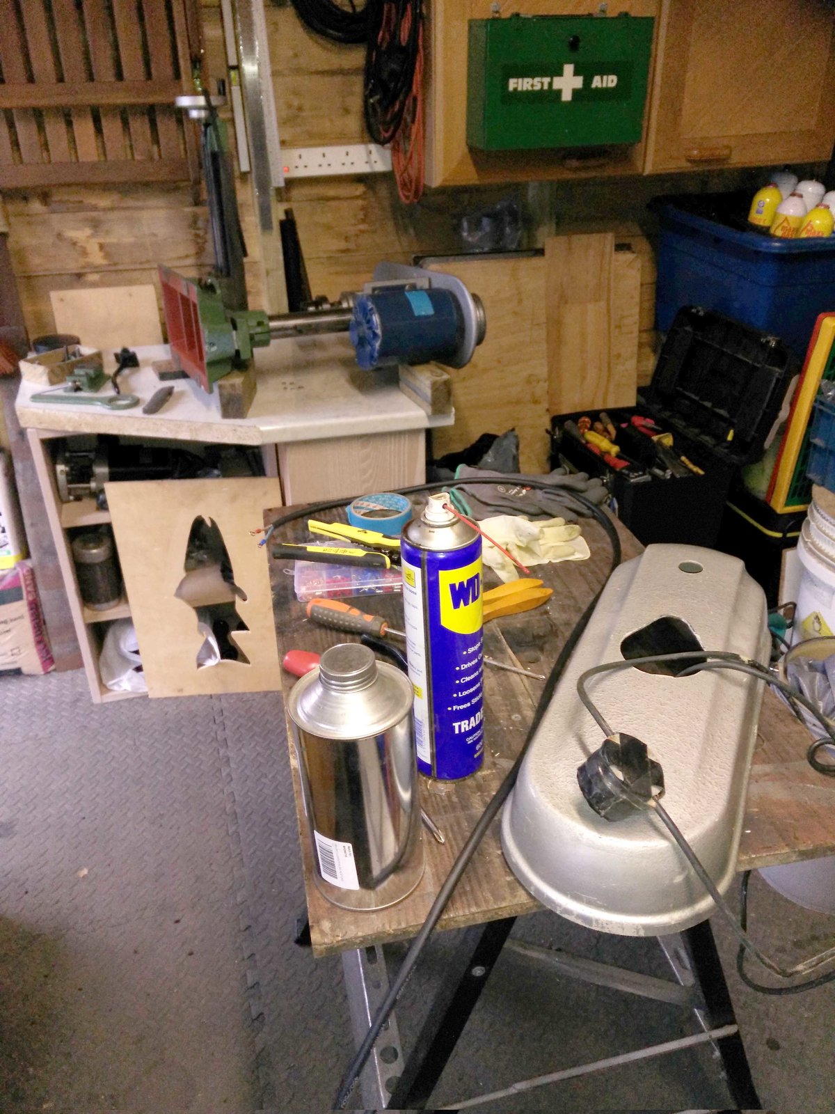

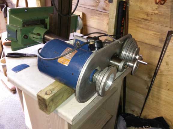

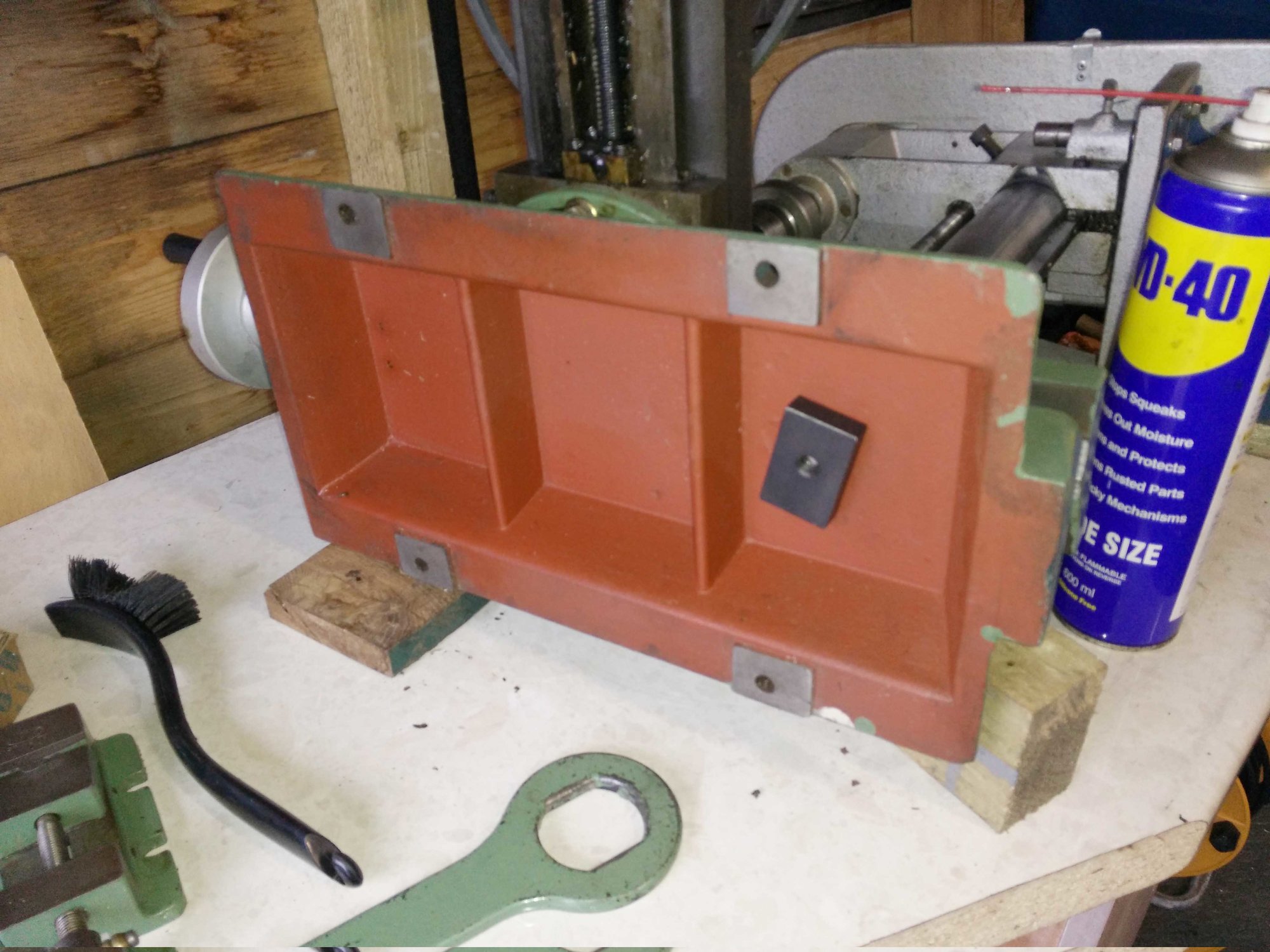

The cover is a close fit past the handwheel for the Z axis and has to be turned through 90 deg with the head at its max to remove. Done & will be sorted
Anyway, today I went on the prove I'm not safe to be left on my own.
I know I posted that I wasn't going to do much, but it won't be as in-depth as the Myford got a) New belt ordered for the princely sum of £2.99 [already on its way], since the present one [the original afa the Seller knew] was stretched according to the 'bit of string' test.
b) Cue some general cleaning while I was in there.
c) Fitted one of the tapped blocks where it ought to have been.

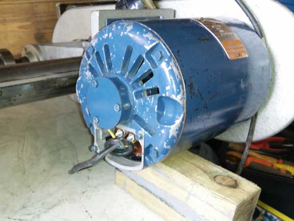

d)Decided to make a start on the motor rewiring, despite not having yet chosen the type or location for an NVR. For 'demonstration purposes' [my mate is coming next week to play
] I'll have 2 x metres of new cable with a plug on the end
. I hate with a passion the 'twist a loop in the wire & hope the nut gets enough of a proper hold on them' for electrical connections, so crimped on ring ends.I think the motor will get a quick change of colour, but since I've not got a match for the green of the base it's likely to be rattle can matt black - still undecided on that one.
e) Cleaned up the table ways which were covered in old/hardened grease.
f) Removed the Clarkson Autolok chuck to see if by chance [fat chance] the thread on the drawbar was the same as on the ER32 taper......as I thought, Imperial v Metric ain't gonna work
. so I'm still on the hunt for 10mm threaded bar with a tpi to match the ER32. Standard 10mm thread won't do it, neither will fine 1.00 so I suppose 1.25 will be the next in line.Here's where I am atm as I stopped 'cos I was tiring, but I ought to get the wiring & motor colour done tomorrow all things being equal.
I know this needs realigning
Looks like a fragmentation grenade went off in the shed...
