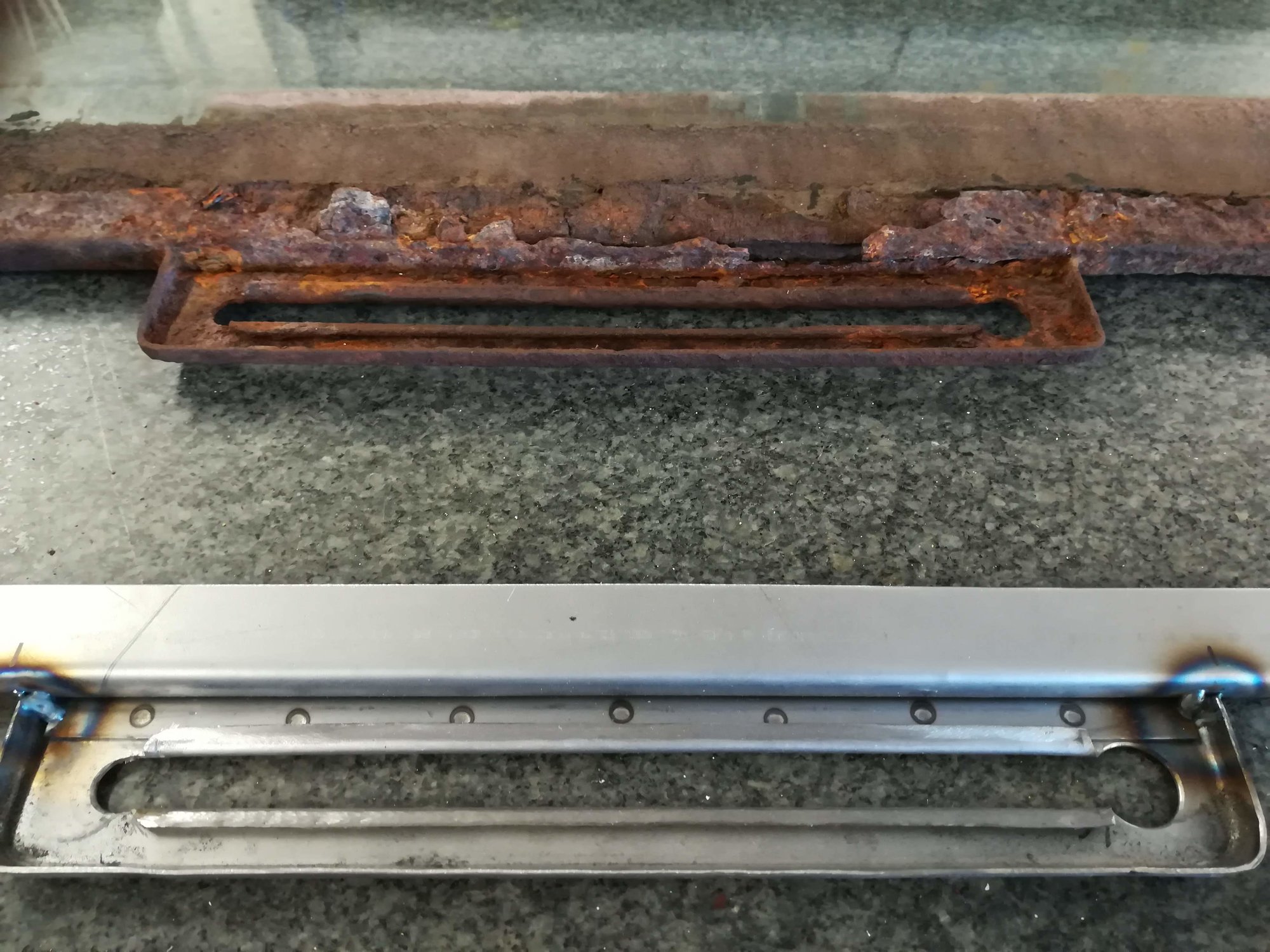

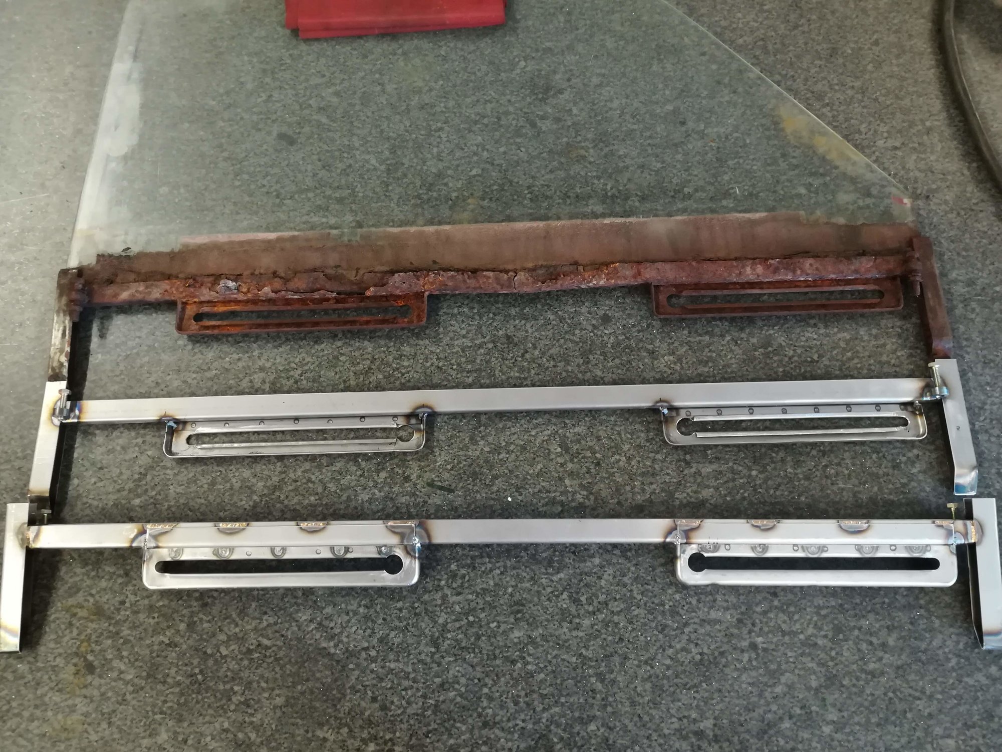

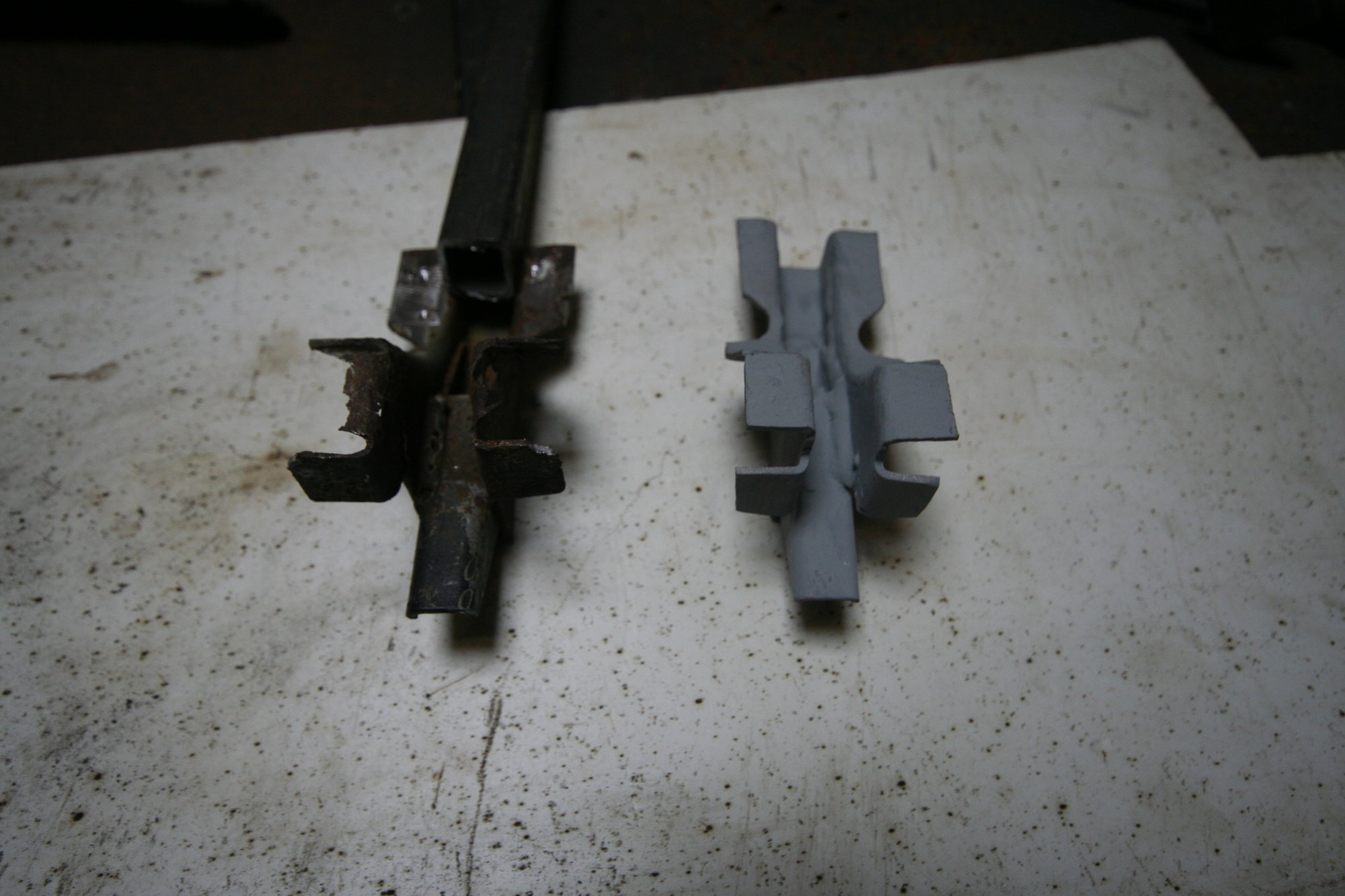

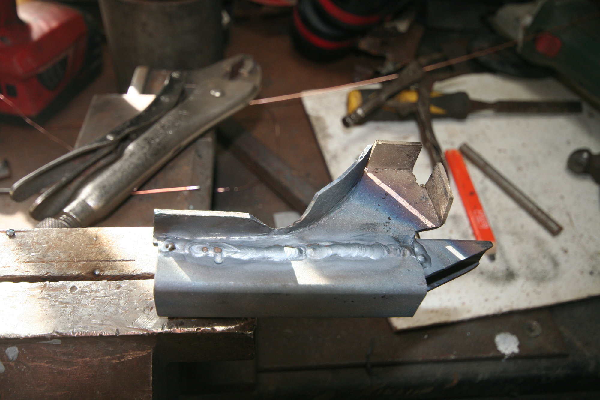

Made these Alfa window winder runners this week
Hi D.Hi PC, What Alfa is that for?

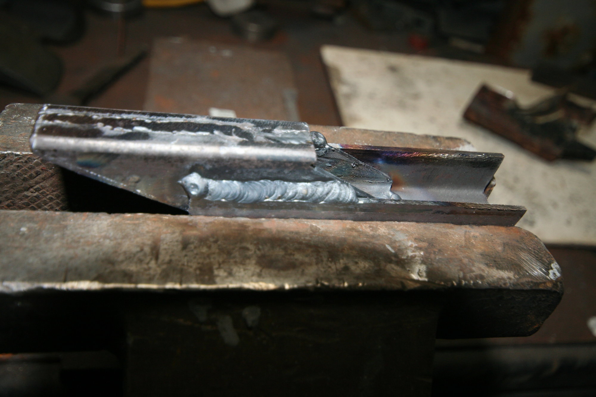

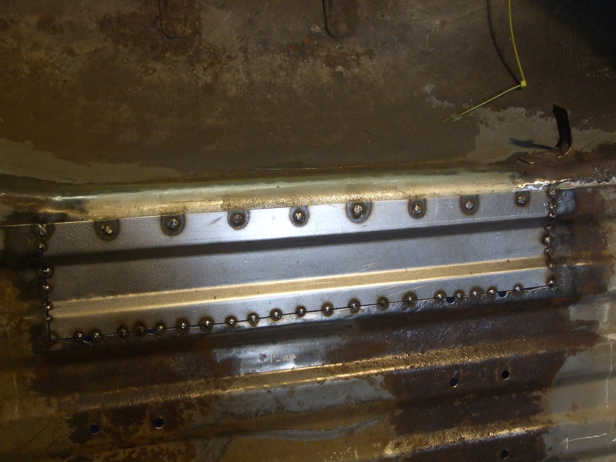

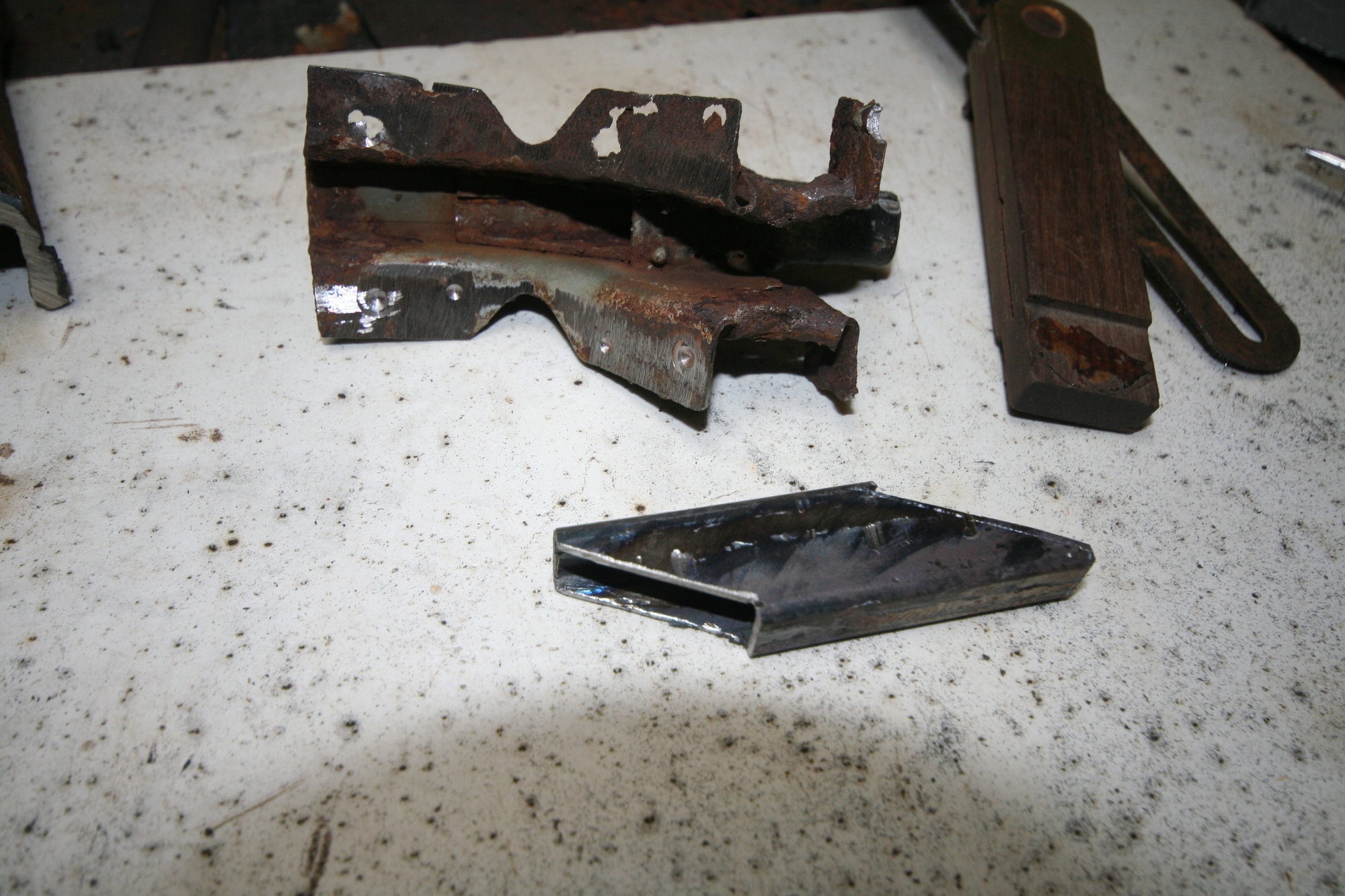

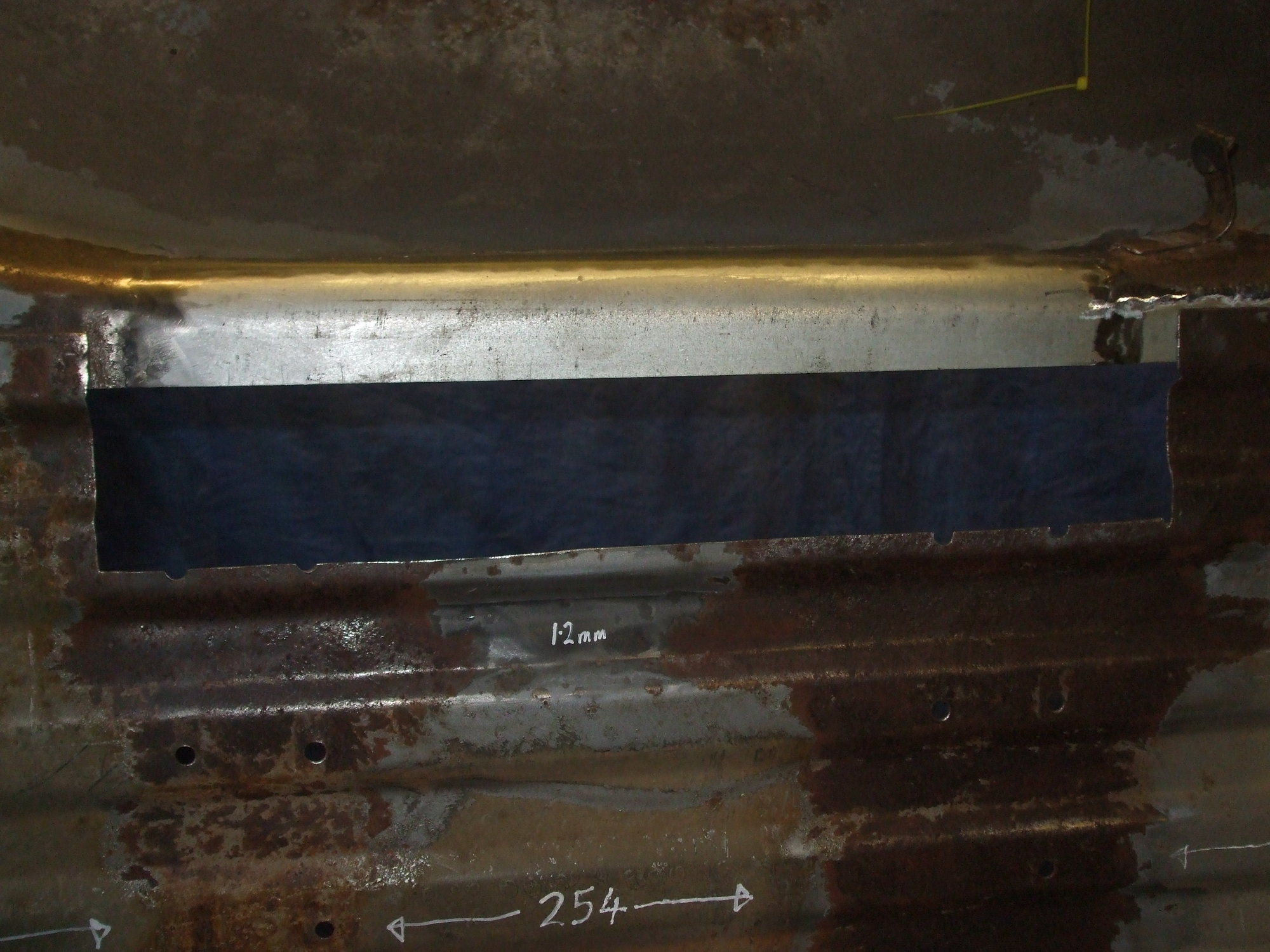

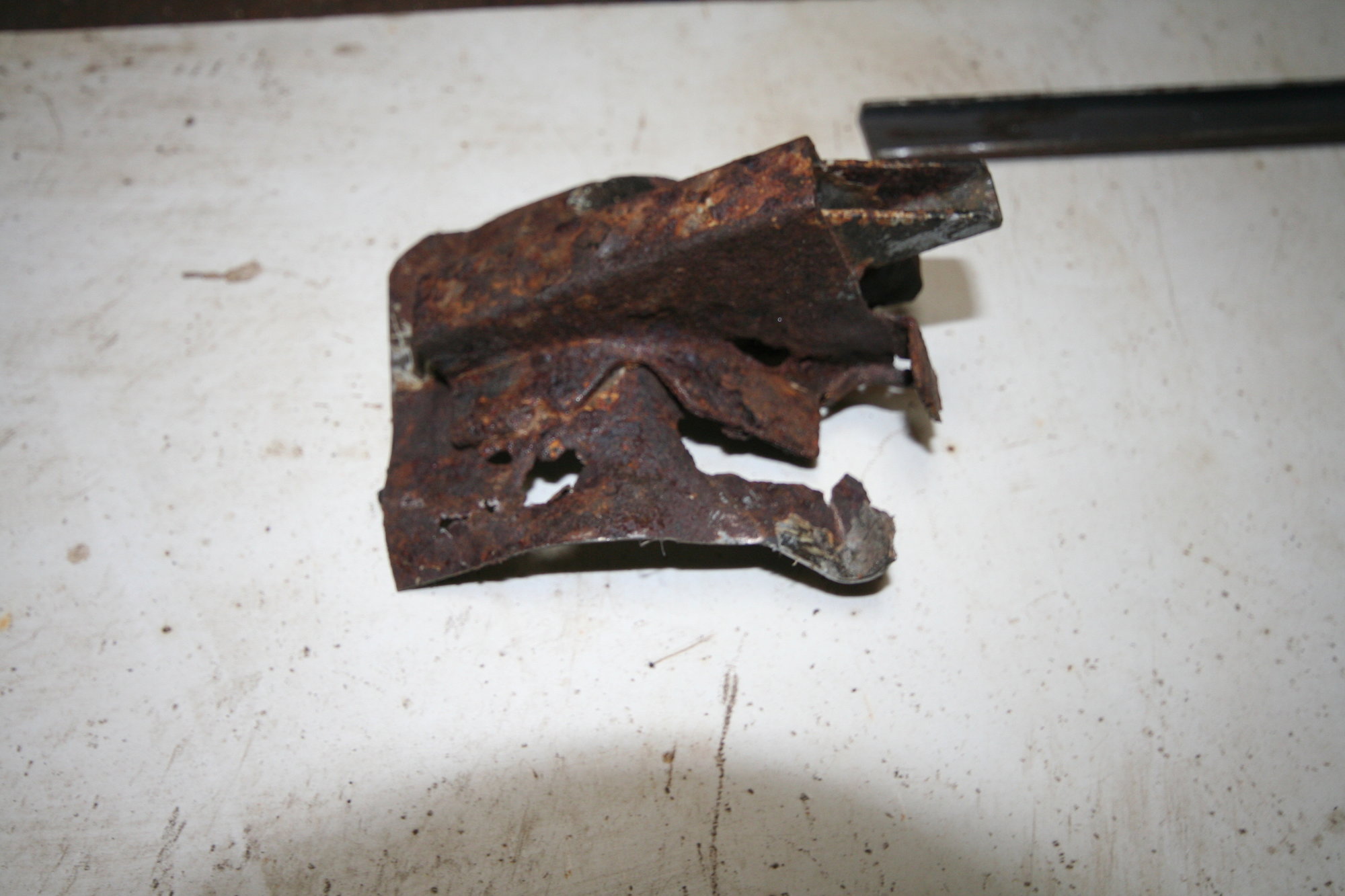

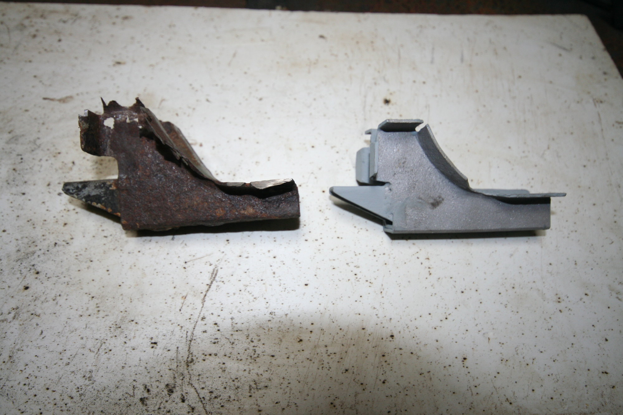

By coincidence today I made a front jacking point for an Alfa 75.
Maybe not that much of a coincidence as I seem to be making something for it most days.
Surprising how much work goes into something like this

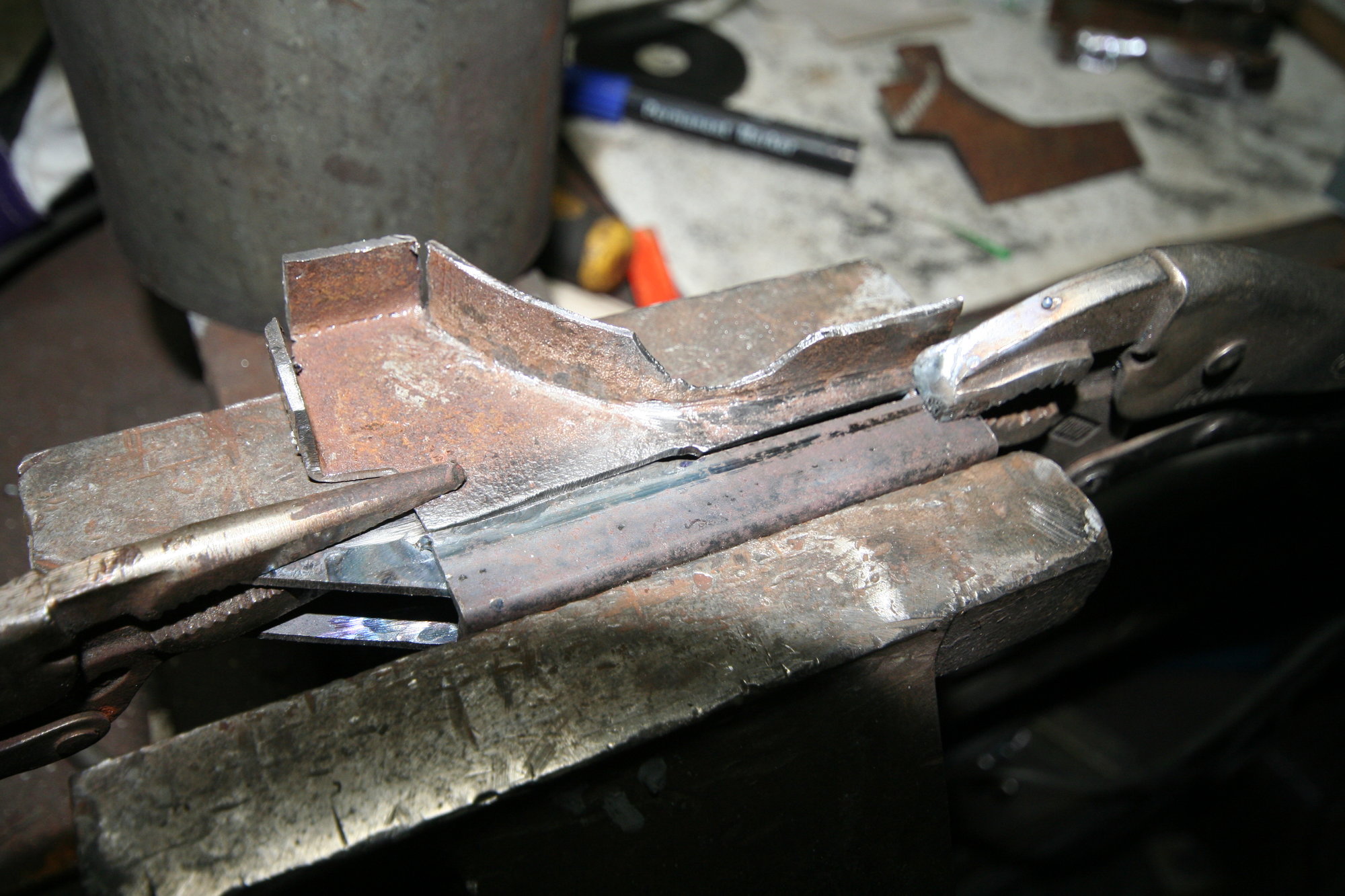

Started off by making a 25 x 16mm box out of 19mm box by cutting and shortening / extending the sides before cutting it to shape.

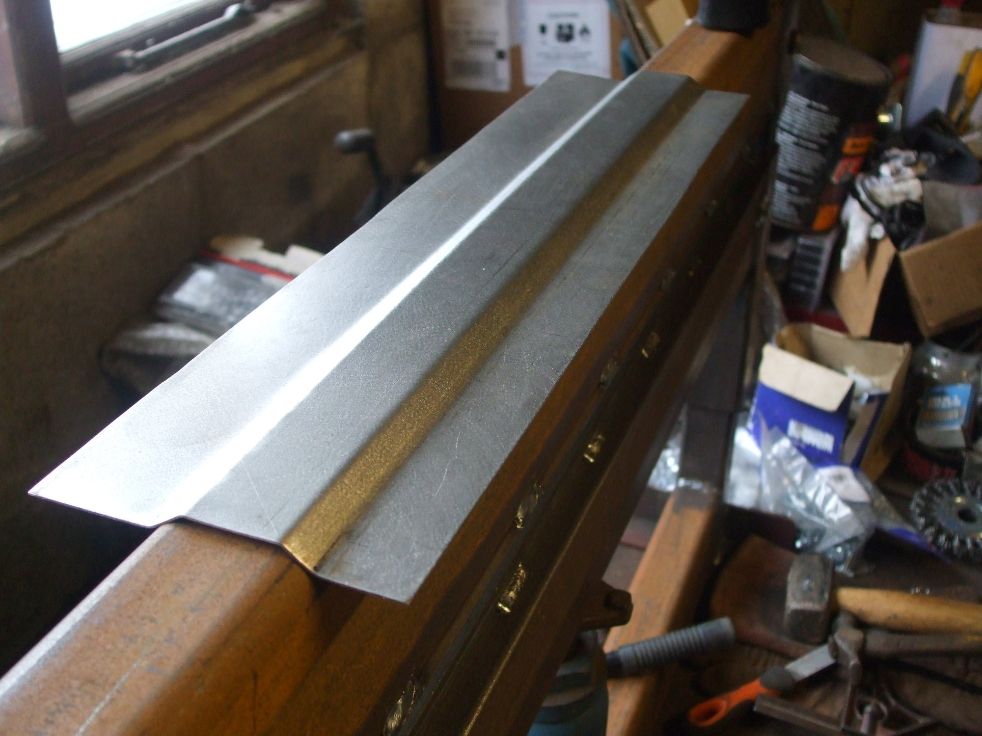

Next make the bottom out of the same 19mm box
Then make the rest of the sides out of 2mm plate form the scrap bin

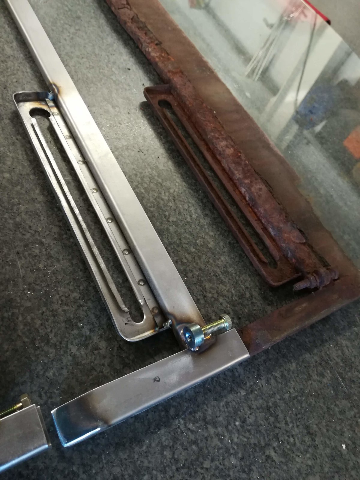

Then blast it before welding it all up
Finally a quick tidy up before another quick blast again and paint the inside with galvafroid.
