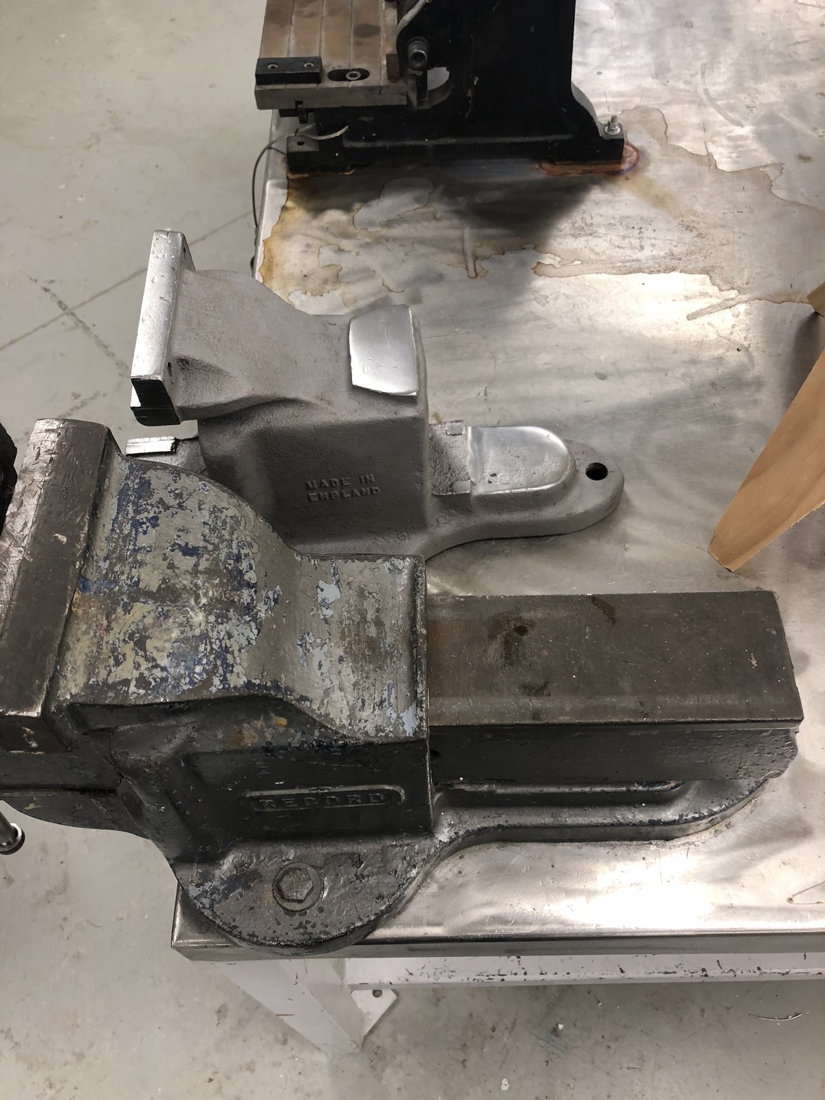

@The_Yellow_Ardvark did I ever show you this? 1930s era Spearior S&J shovel
Covered with concrete, but I can chip that off quite easily. A nice piece.

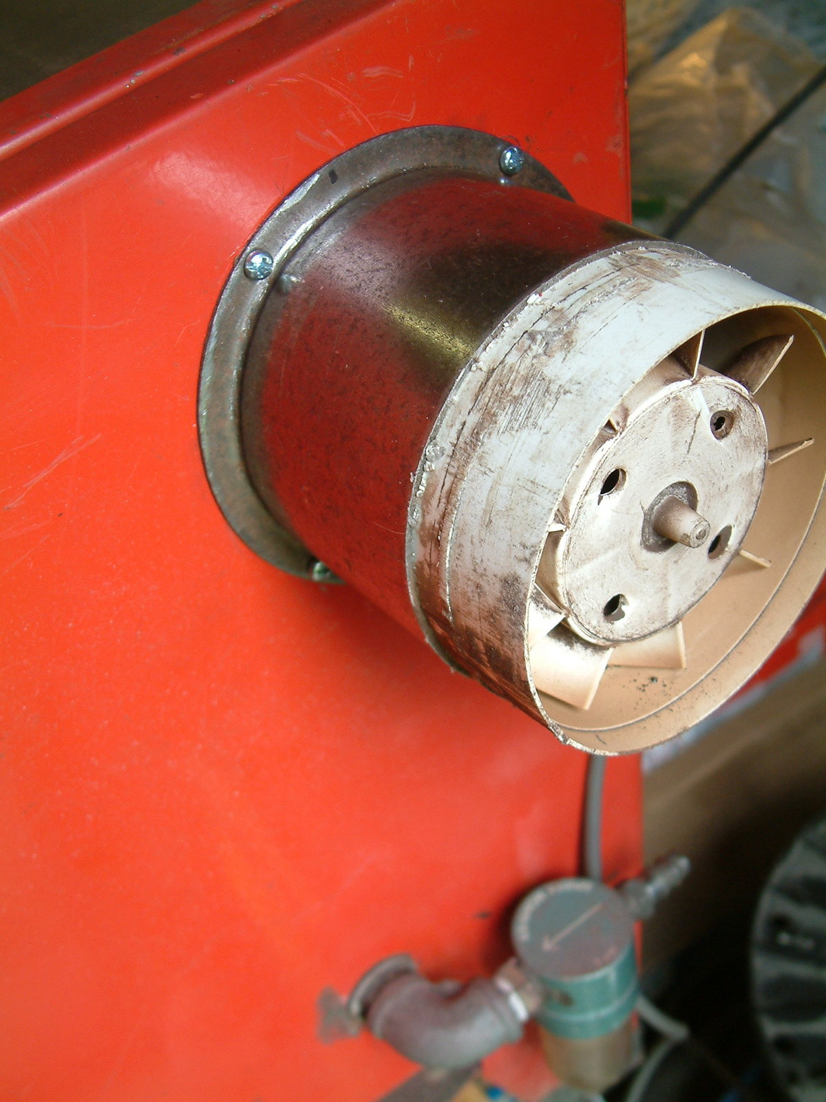

Today I made this to mount a spare bathroom extractor fan on my blast cabinet, stick a length of flexy duct on it and dangle the end out of a window, now I can actually see what I'm blastinghow the tiny vent with a piece of sponge in it was supposed to work is beyond me.

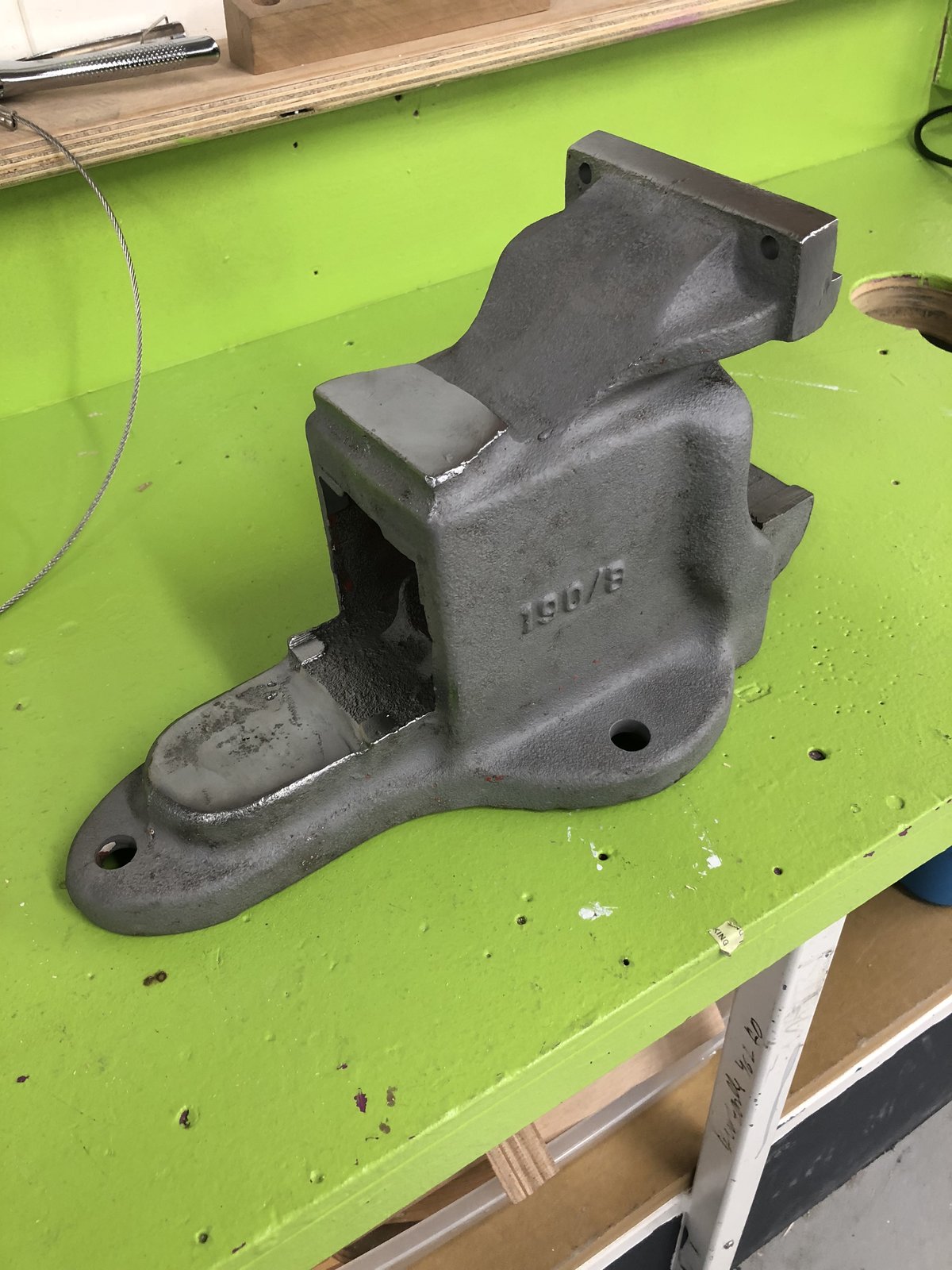

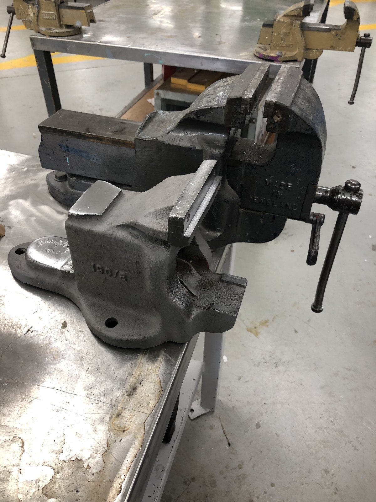

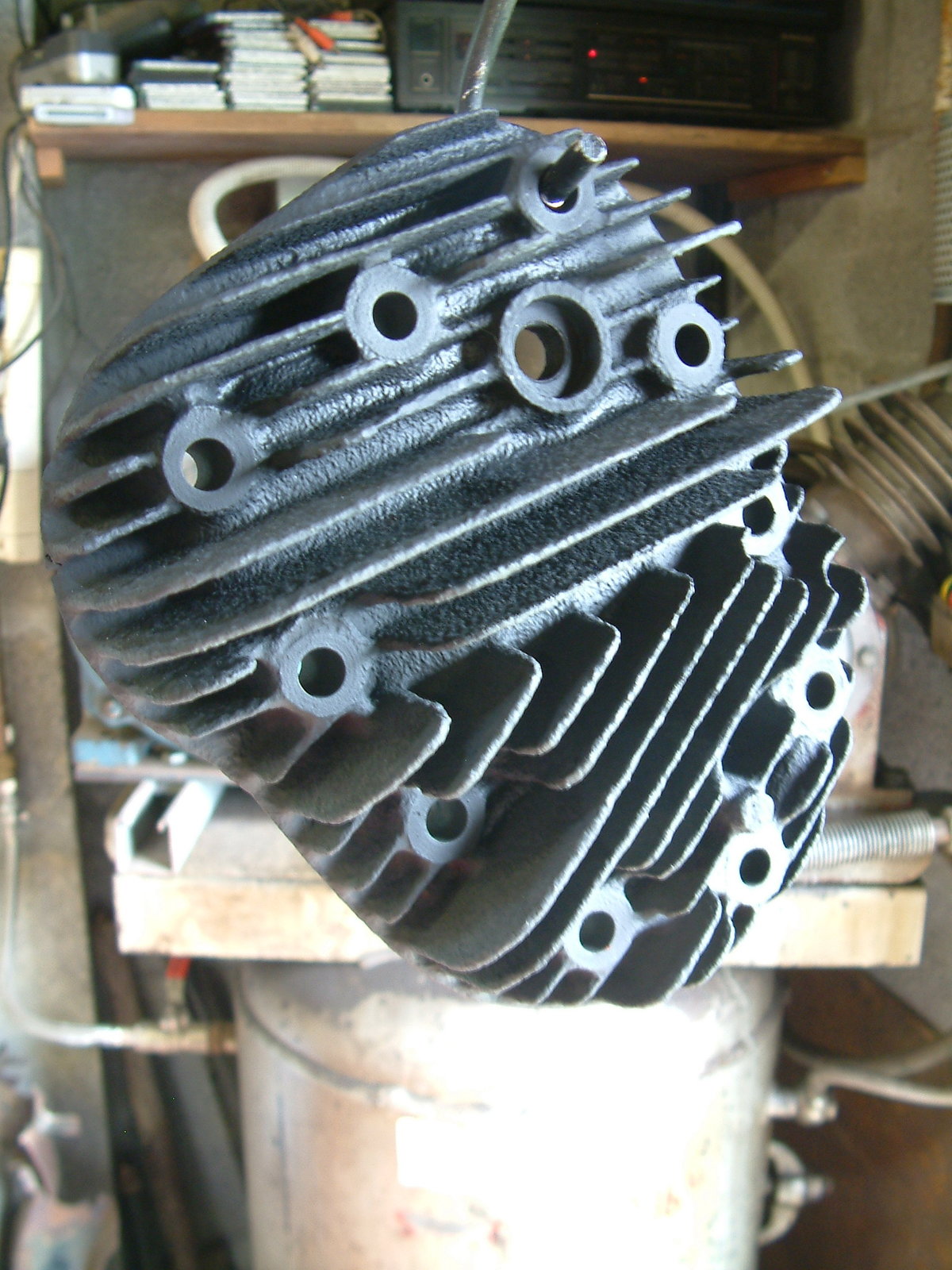

Then I used the cabinet to blast this and then painted it.
I did try putting the fan at the other end of the duct so by the time it's sucked the air the length of the duct most of the heavier material will have fallen out of the air flow to give it an easier life but it works better blowing down the duct. If the fan dies I have a couple of spares so I'm not too worried about it.It’s a pants setup as standard, a vacuum cleaner works well provided you add a bigger inlet air filter. The extractor you have fitted will suffer wear from the media passing over it and might get in the bearings, a cyclone filter in line might help.![]()

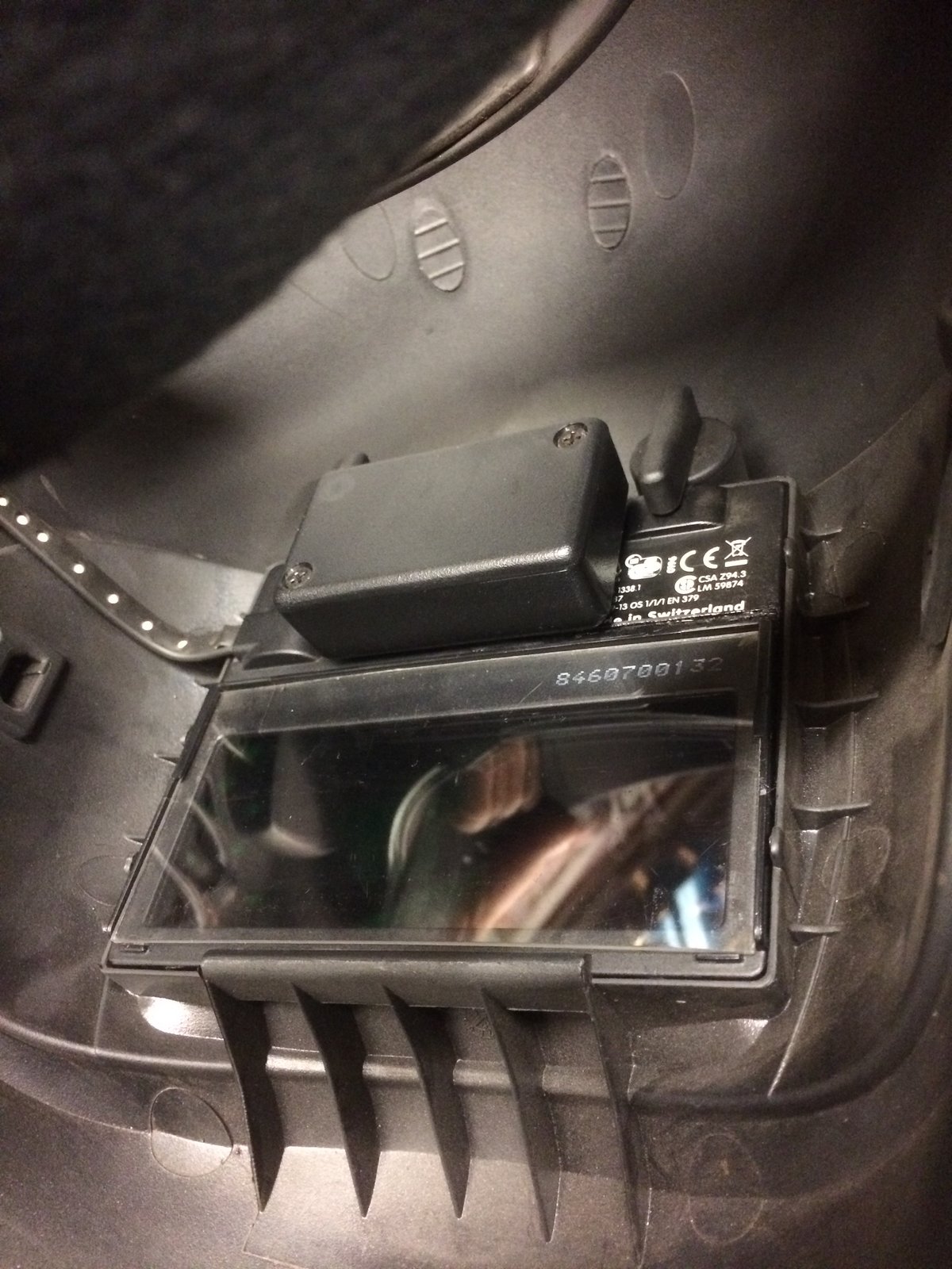

I will SOB for your predicament!Fitted an external battery box to my BOC Optrel mask at last, original button cells are soldered to the PCB and sealed in an ultrasonic welded plastic case filled with potting compound.

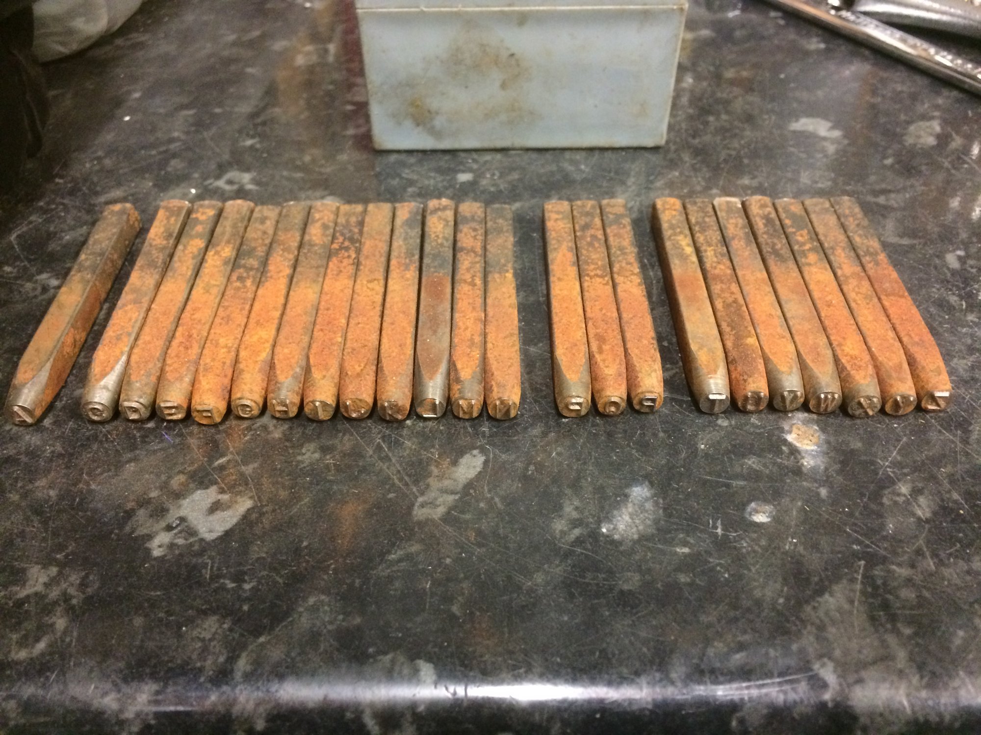

And during a clearout I found my number stamps with three letters missing. LLCK doesn’t have the same ring to it!

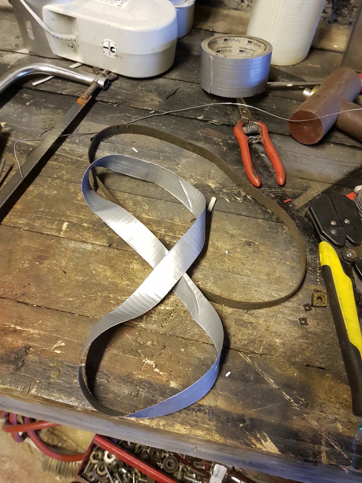

Your belt looks like a Mobius strip, you will be able to drill holes around bends.

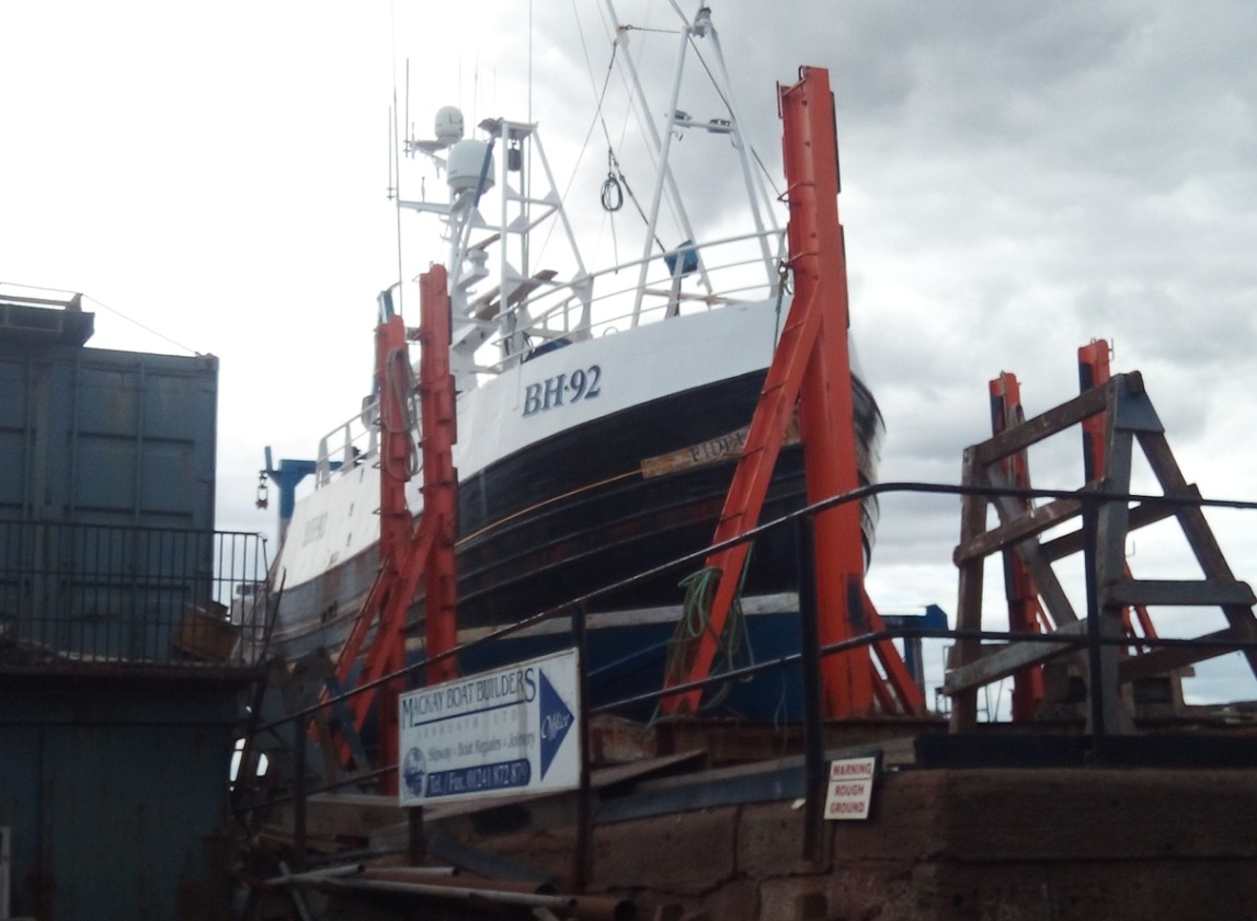

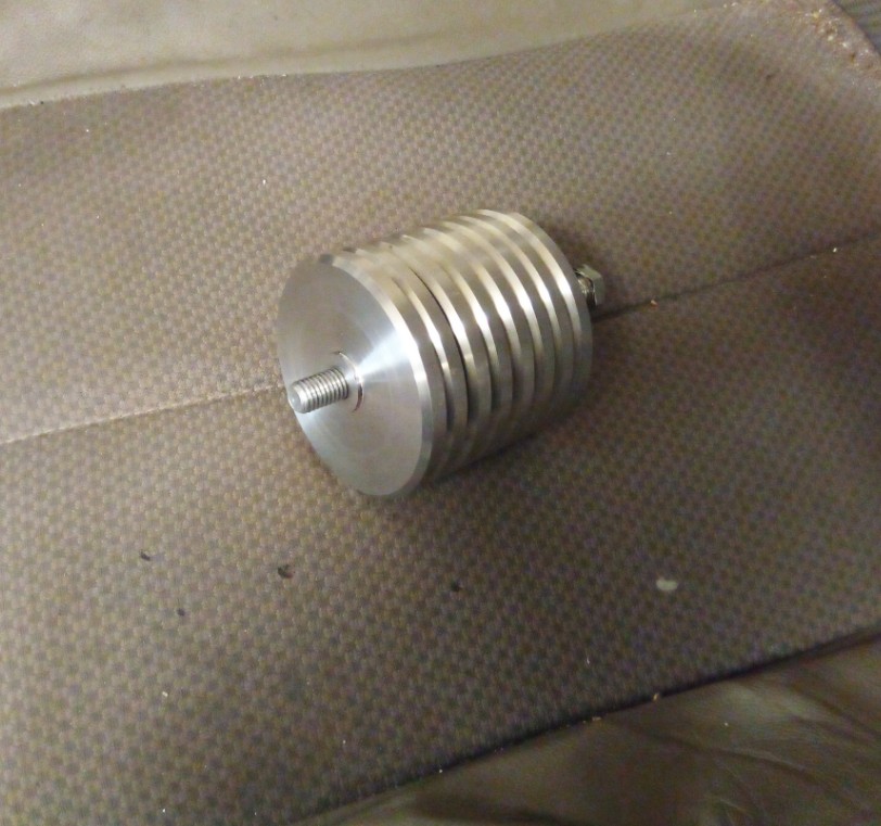

I like the Cheetah, they are good looking work boat. Got a job to do on one soon, fit a 12" plotter, Radar, a pair of sonar transducers and some other stuff I just can't remember at the moment.It is raining so I have just done 8x 90mm dia 8mm thick handrail pads that will be for a Cheetah which should be arriving next month.
I have fitted out about 9 so far from 7m to 10m, have another 10m to do as mentioned then Dec/Jan there should be another coming, it is the very latest design one that they are just finishing the mould for at the moment.I like the Cheetah, they are good looking work boat. Got a job to do on one soon, fit a 12" plotter, Radar, a pair of sonar transducers and some other stuff I just can't remember at the moment.
