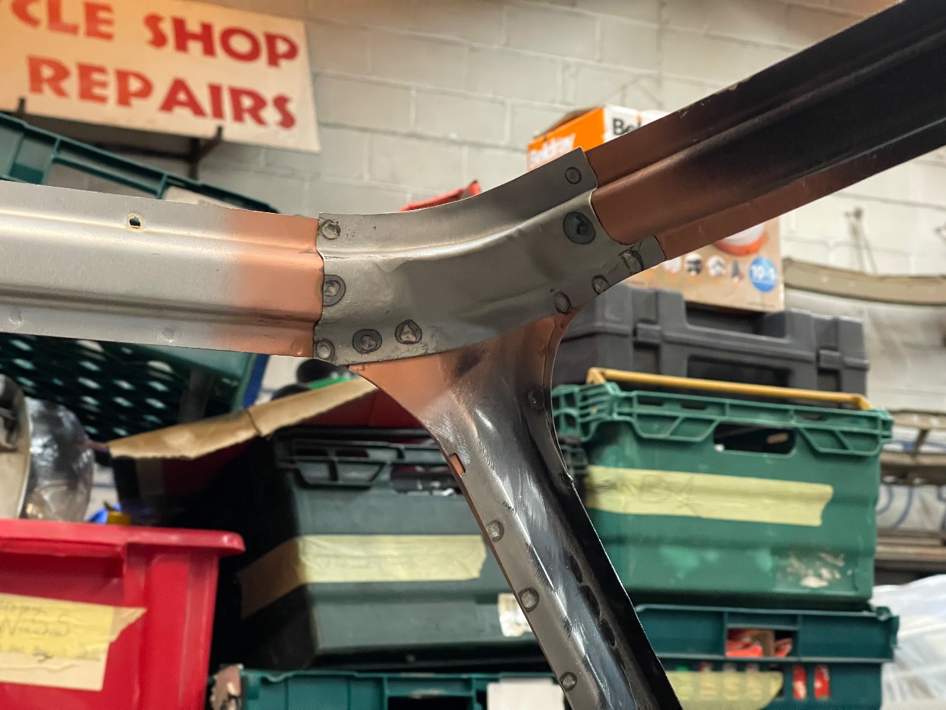

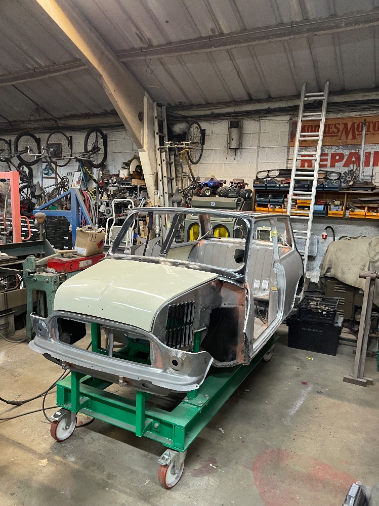

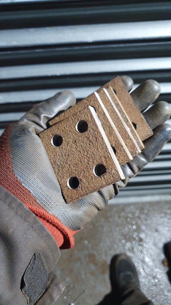

Is the copper colour a weld through primer? If so, what is it?Well done that man.

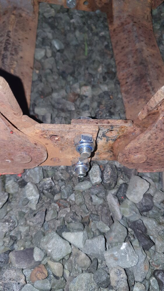

They’re the corner pieces that join the front and side cant rails.
Isn't it this stuff? https://www.kenteurope.com/en/produkt/copper-weldprimer/Is the copper colour a weld through primer? If so, what is it?
Yes it’s Upol weld2 copper.Is the copper colour a weld through primer? If so, what is it?
So did you rescue them and swap over? Something to do with the different visor mounts on the mk1?Well done that man.
Yeah these style corners started in ‘64 with the flat spot to mount swivelling sun visors. In ‘66 they went back to normally hinged visors but didn’t get rid of the flat spot.So did you rescue them and swap over? Something to do with the different visor mounts on the mk1?

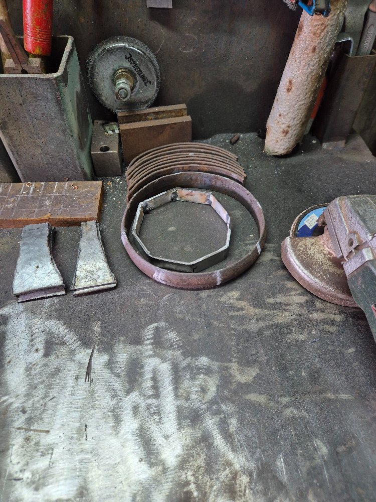

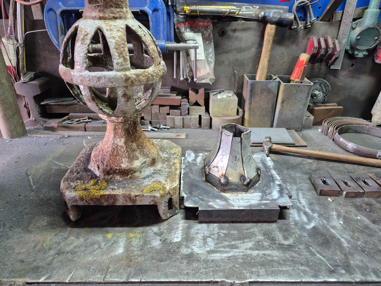

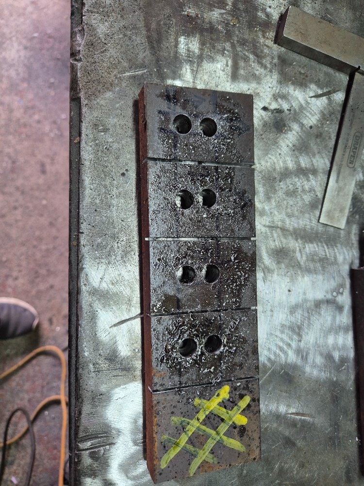

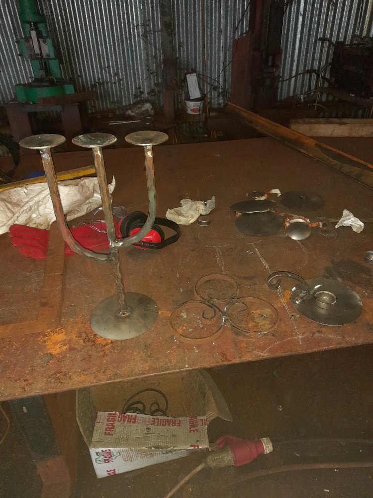

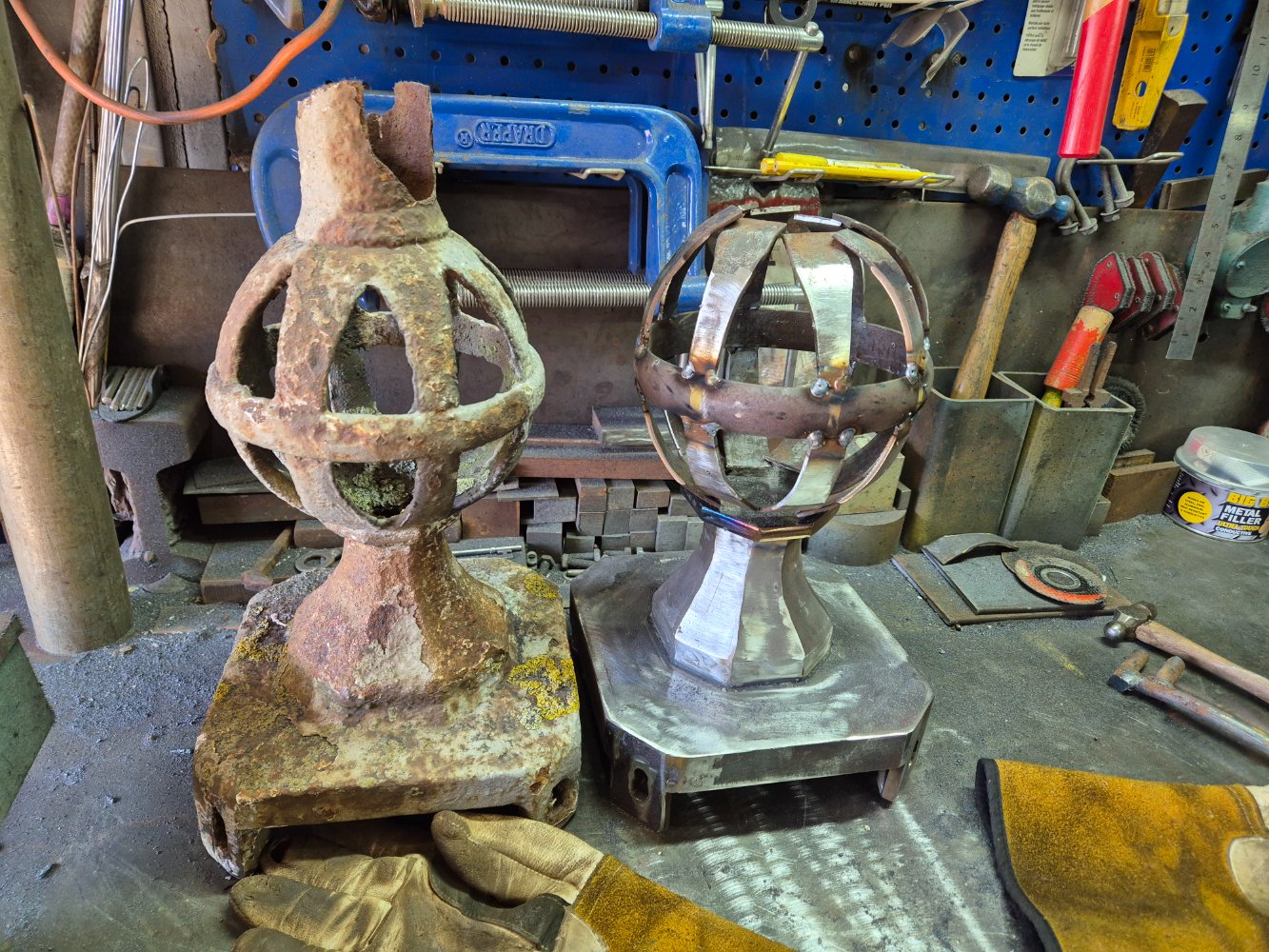

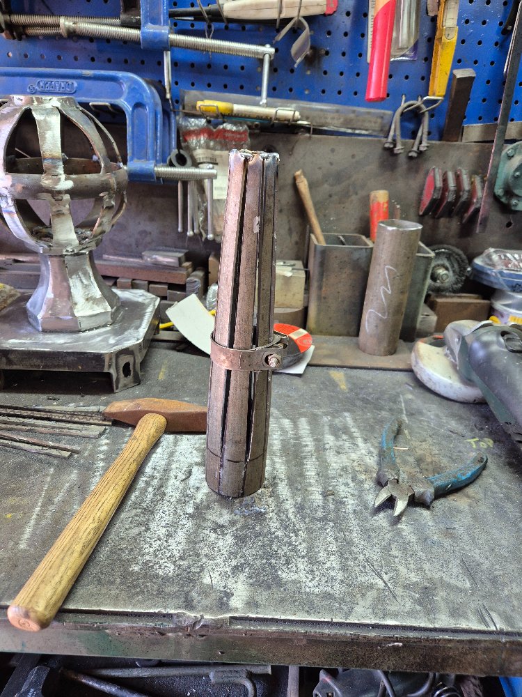

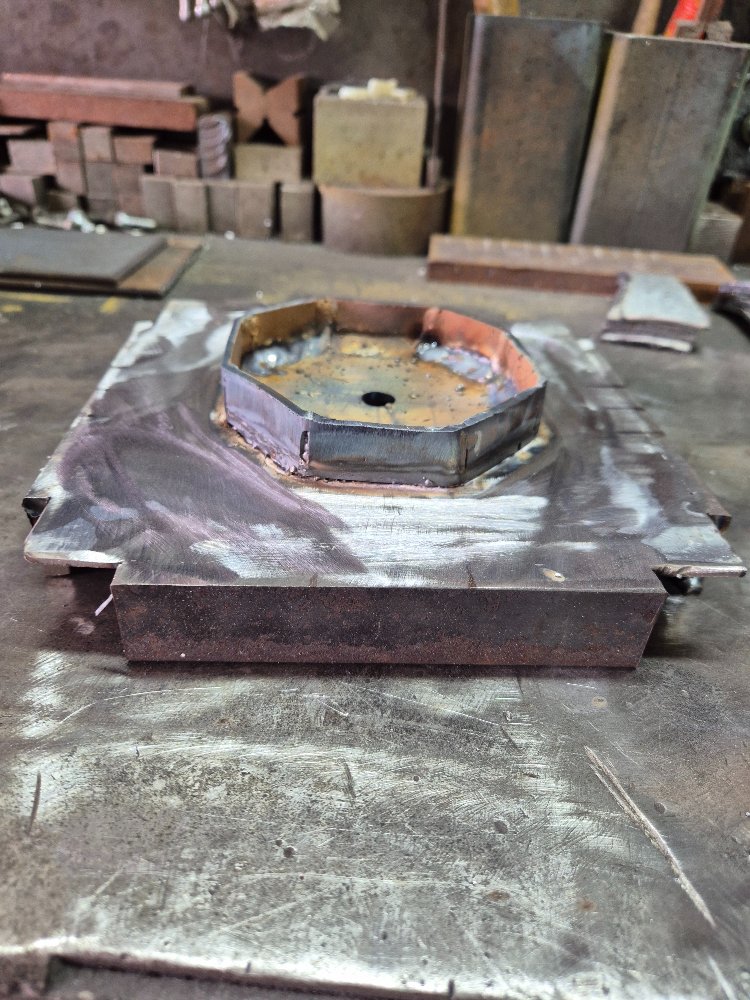

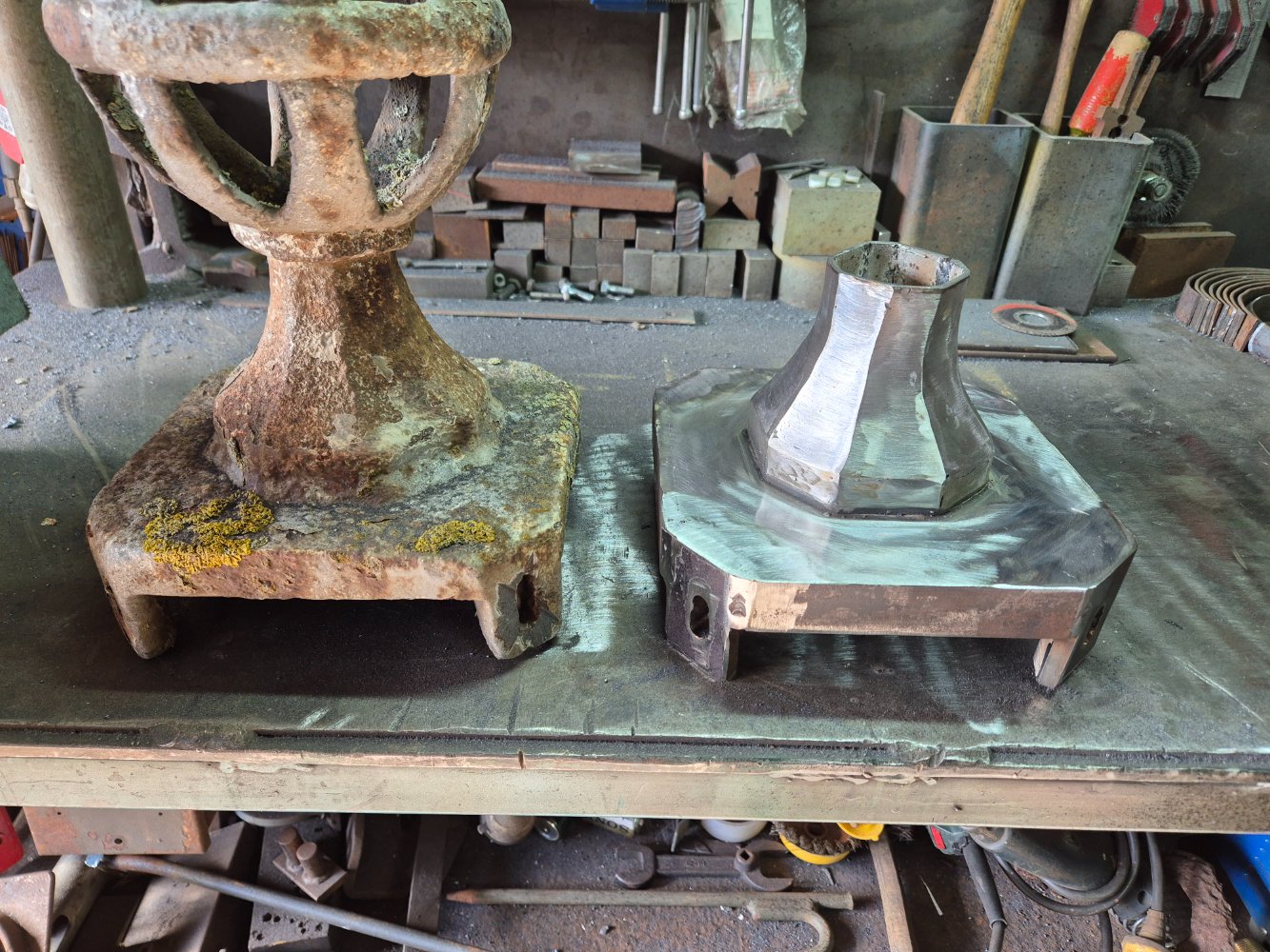

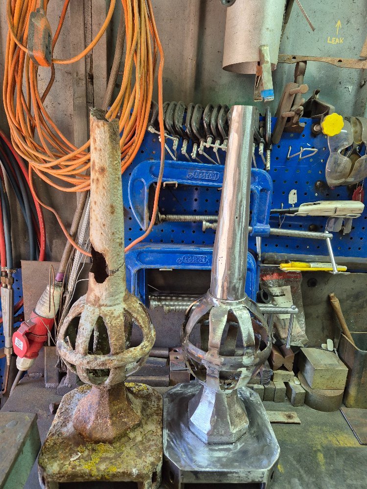

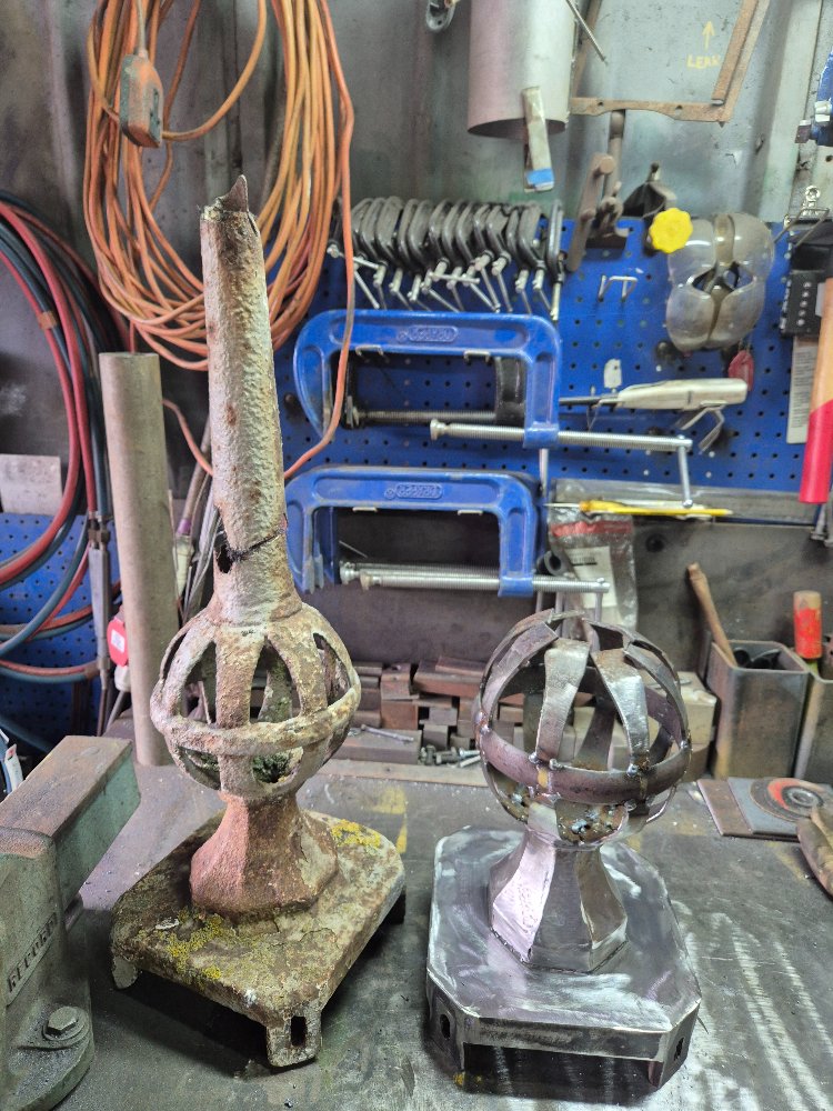

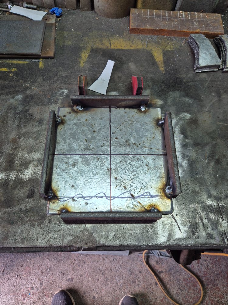

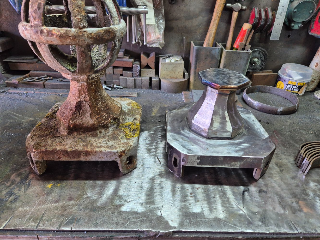

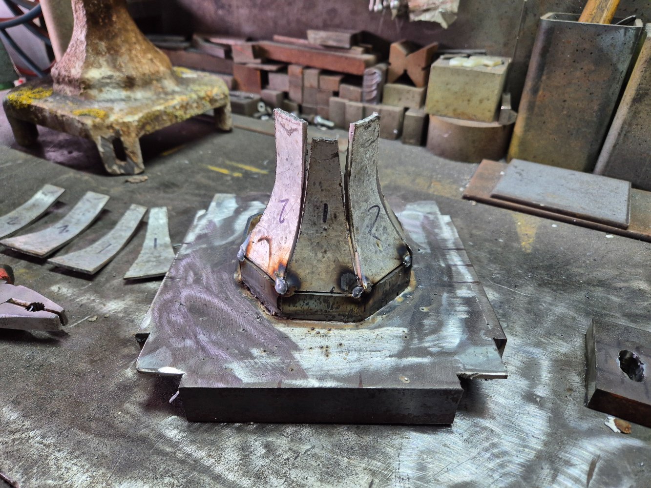

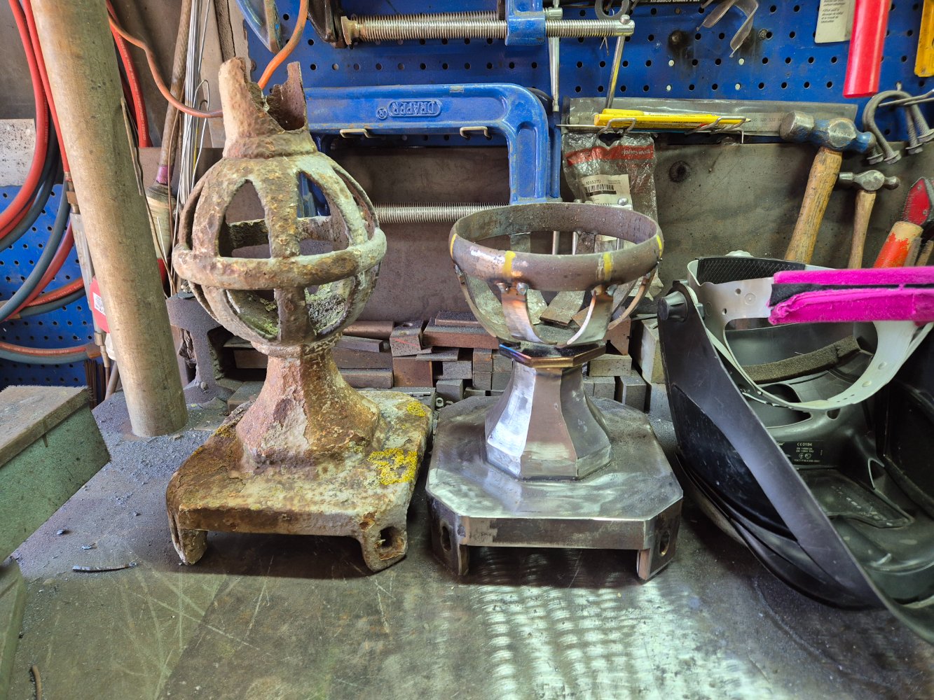

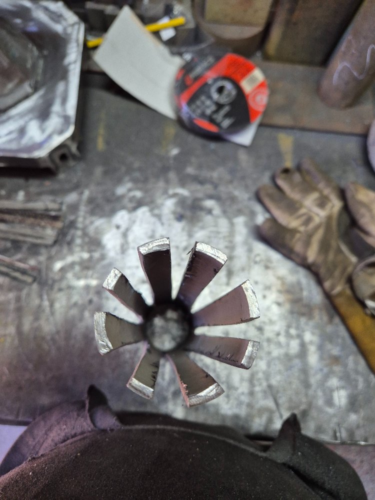

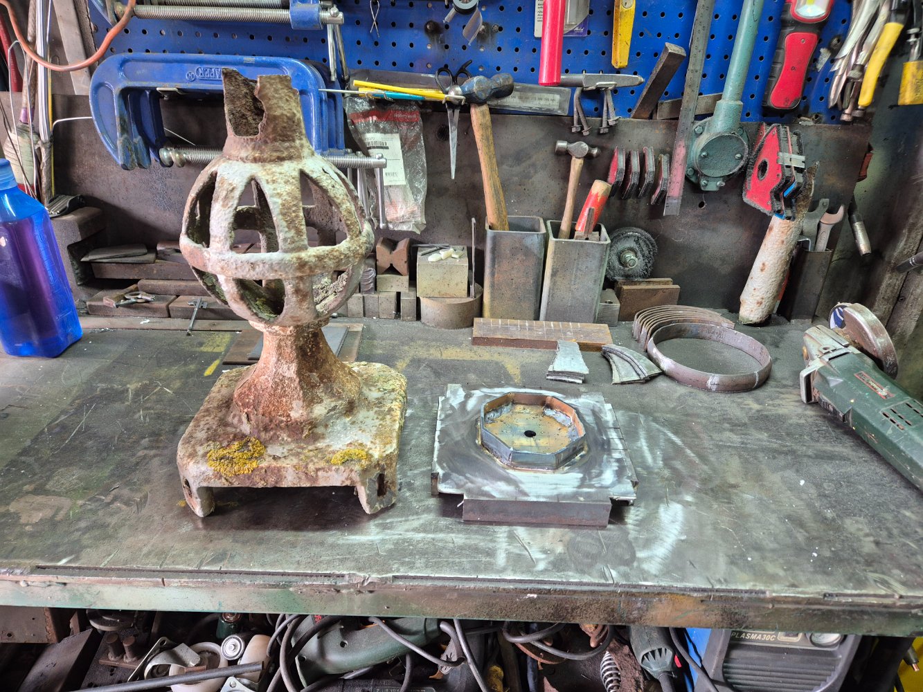

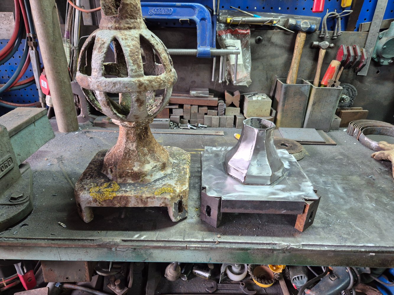

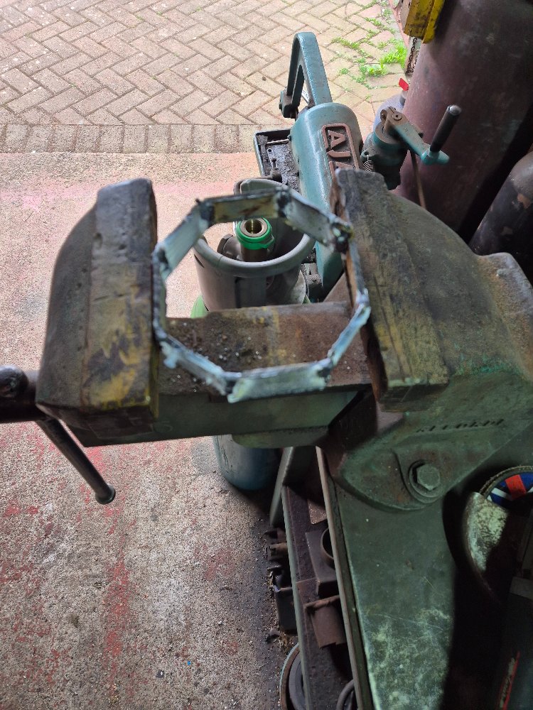

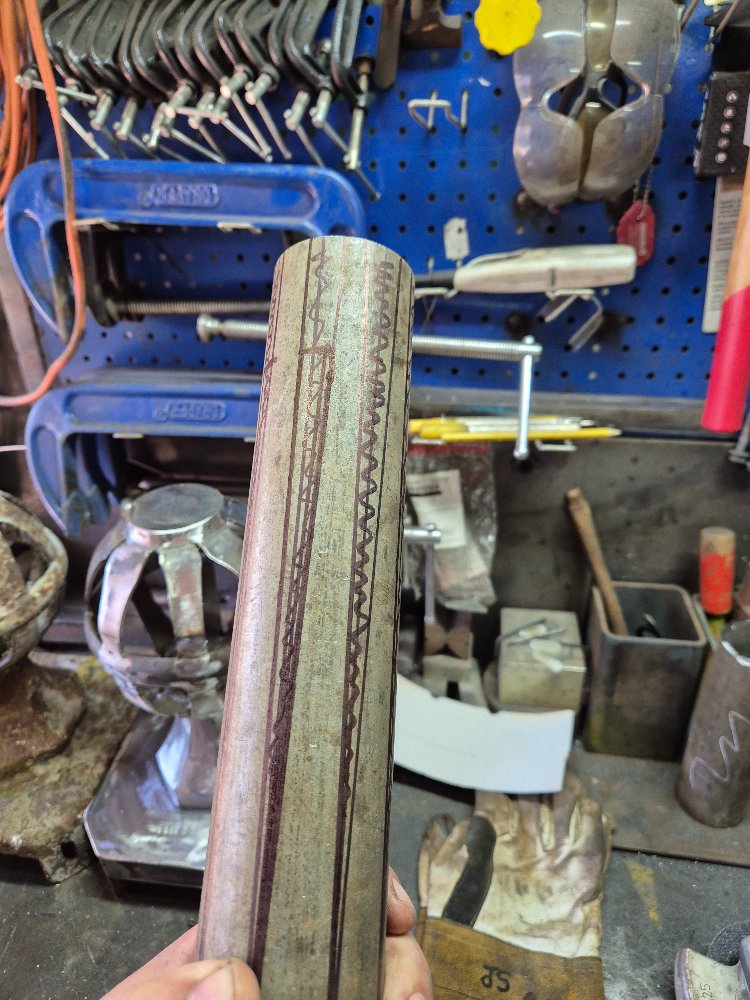

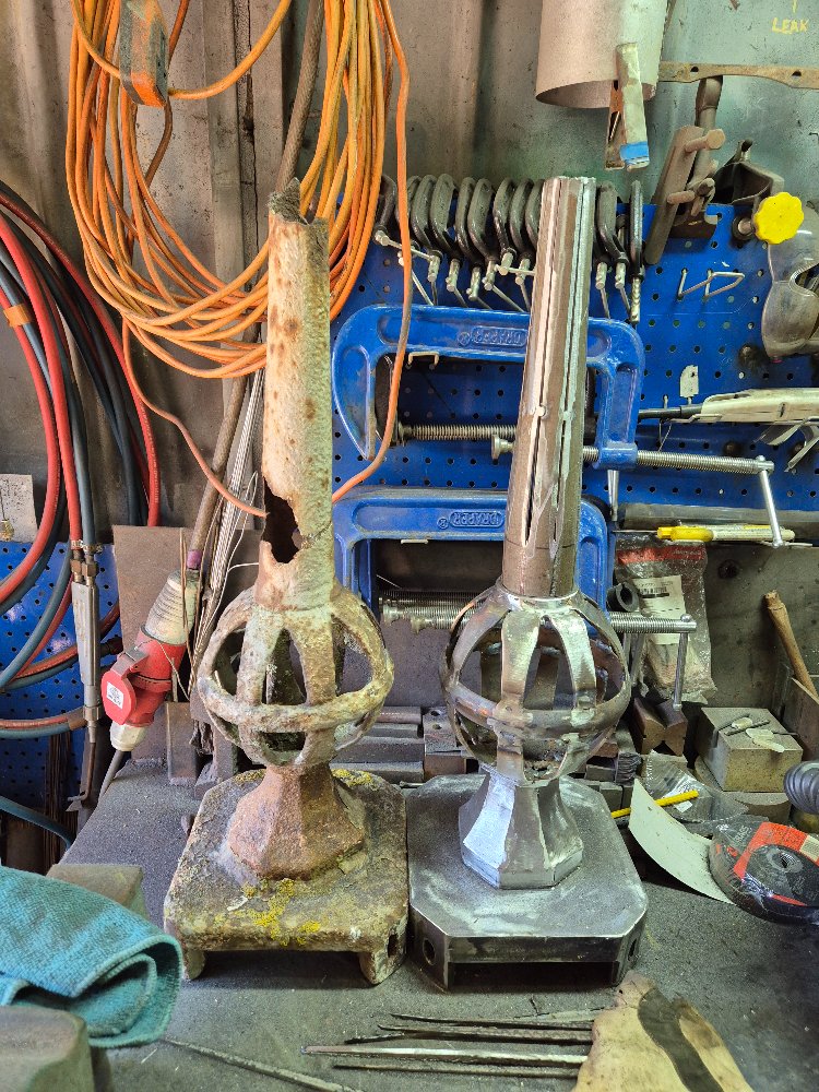

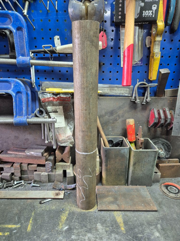

had a go at making a copy of a 100+ year old finial for atop a lattice signal post, wont add all the pics but this is the jist of it.

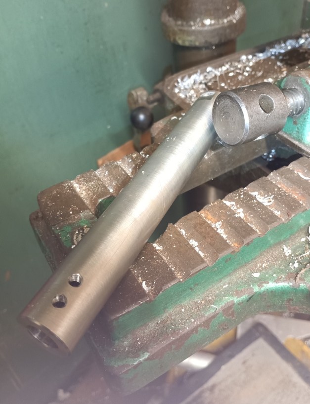

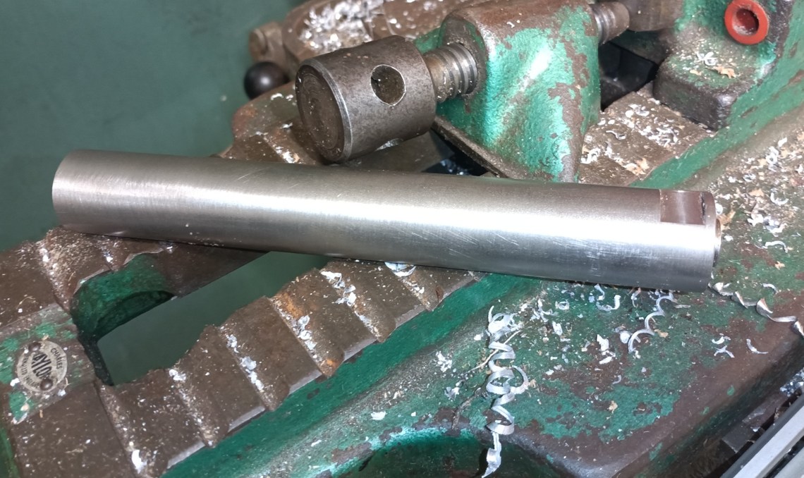

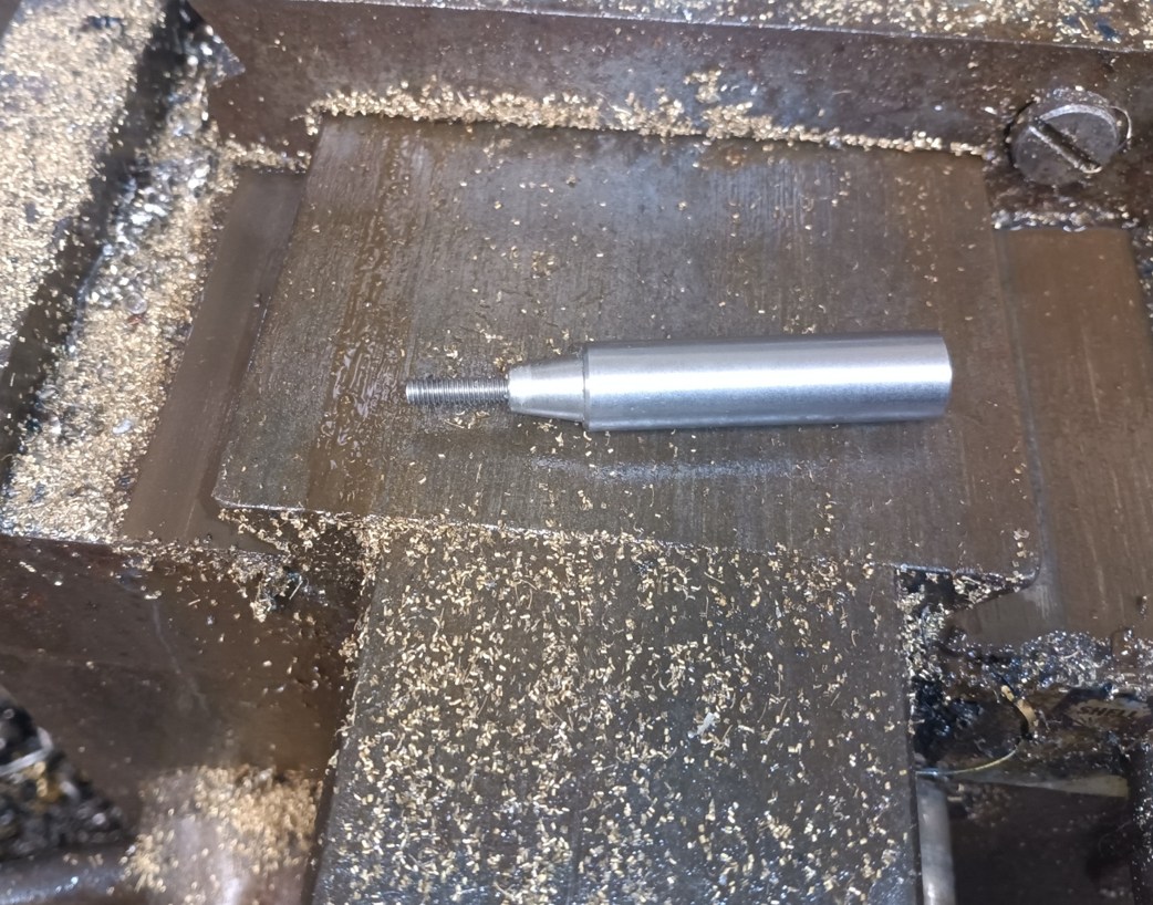

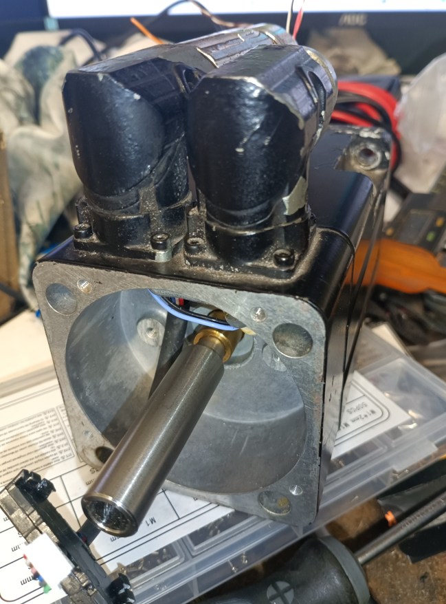

an extension shaft so that I can hopefully fit a different encoder onto a servo as the Hiperface one was playing up.
It fitted to the motor.

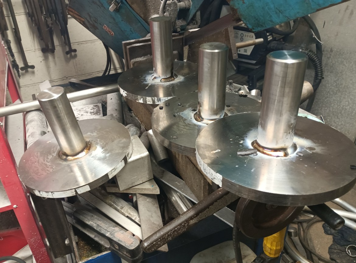

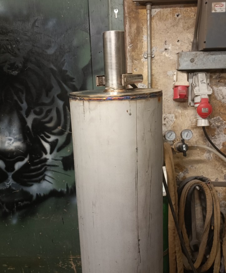

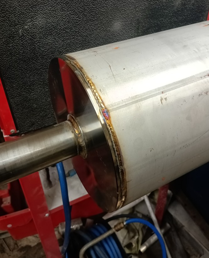

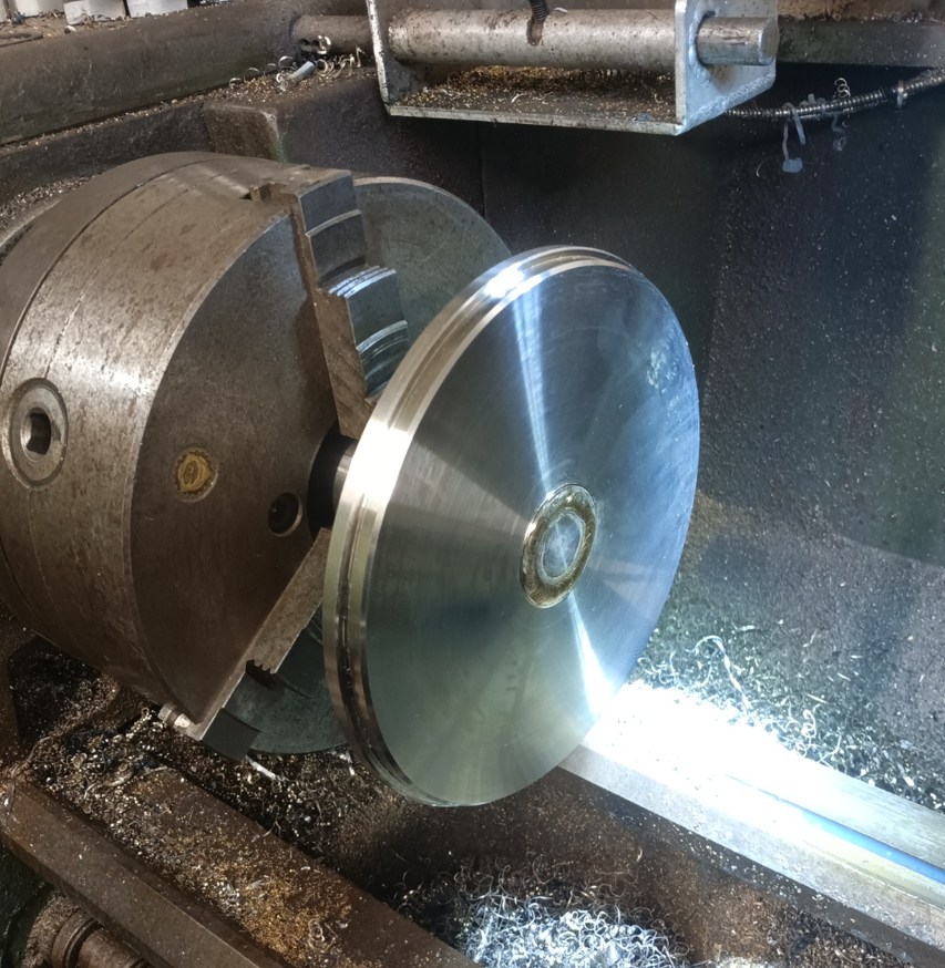

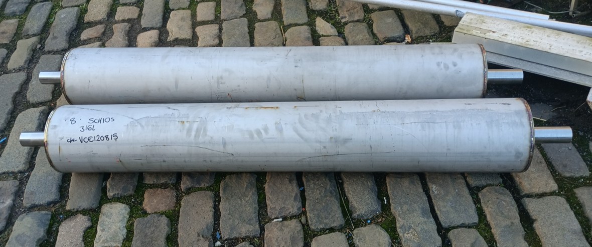

And then some ends for a pair of gunwale rollers I am making. I have Magmaweld 316 rods, they are ok but not as nice as the Esab ones I used to be able to get locally.

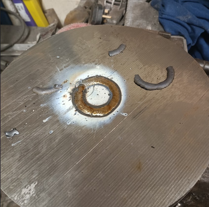

Got one turned fully.

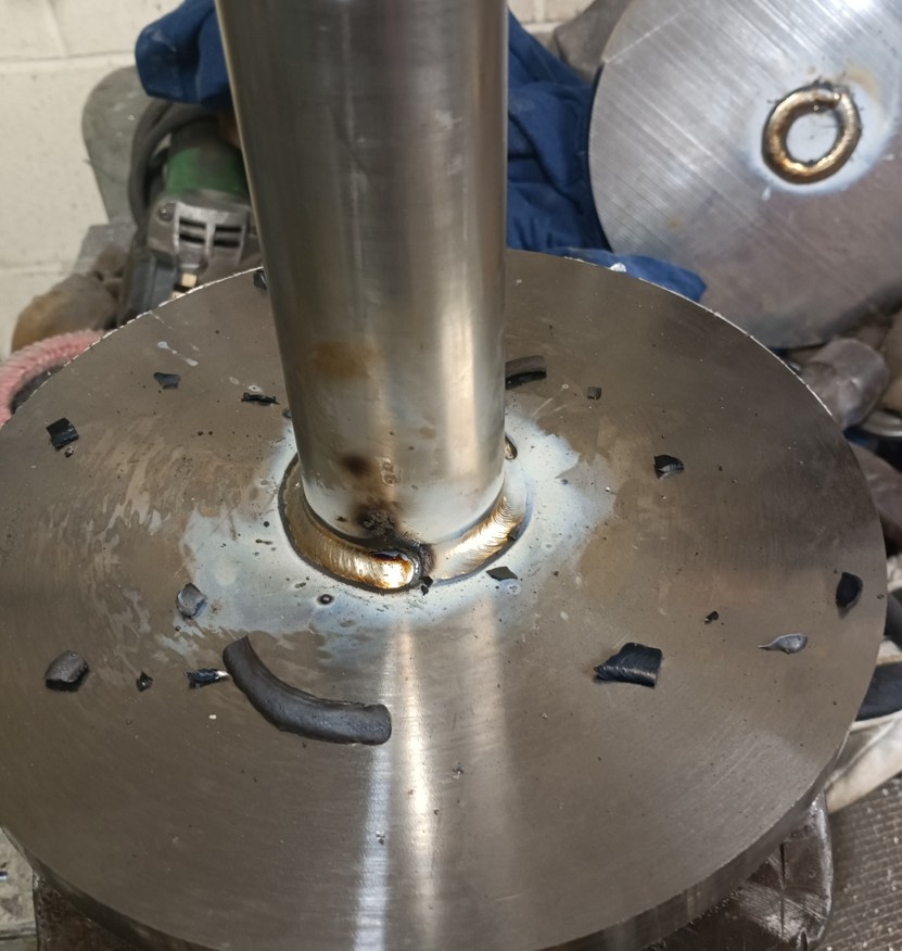

And welded into the pipe, the others I will turn and weld tomorrow as well as rebuild the finning machine if the new seals and motor arrive.
I find stick welding around a stub/pipe/pole easy, mig or tig not so much.That’s what I call a lovely weld. Back in the day I occasionally needed to weld a shaft to an industrial bakery oven fan but always found welding around a shaft difficult.
