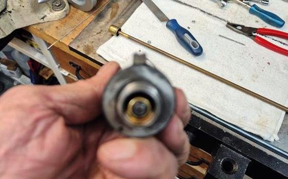

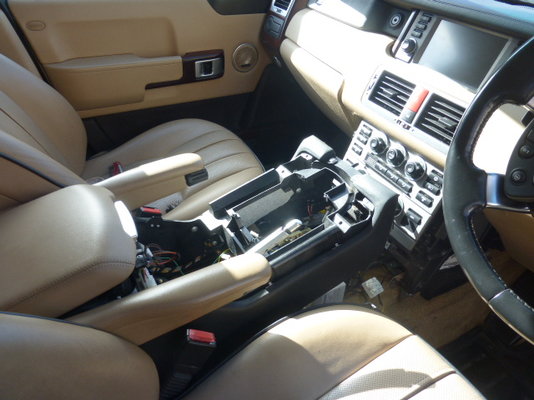

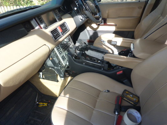

yesterday actually I made a start on solving the no cranking issue with the range rover !
similar issues to either a duff battery or starter but then wouldn't crank at all , so battery is good put a power probe to stater and starters good so a bit of metering and the 12v to starter is only getting 6 or 7v a bit of YTing and it's all pointing to the switch block on the bottom of the barrel well , an hour so of finding hidden fixings and it's out

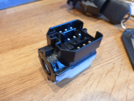

and the offending article
high resistance across the pins which supply the starter motor so new switch block on order and hopefully she'll be up and running again . Apparently a common issue on older vehicle ,well it is twenty this year .
