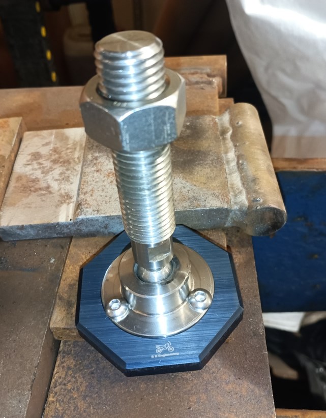

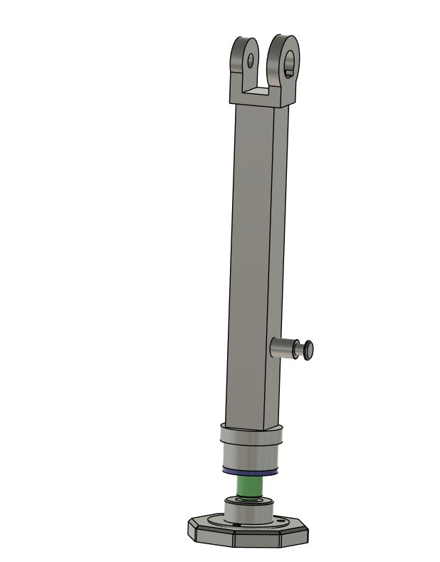

EasilyThe button head slightly overhangs the chamfer on the stainless part, how could you ever put up with that?![]()

.... cheaper than a new set of forks or a new bike! I have no plans for selling...Got some button heads this morning and turned the head down slightly to fit. Much happier with them than the black stainless cap screws.
I was thinking why not make the pivot base out of aluminium, just think of the weight saving.The button head slightly overhangs the chamfer on the stainless part, how could you ever put up with that?![]()
Agreed, and either move to four fasteners, or make the foot hexagonal, the three screws on an eight sided part clashes visually. And I think I'd DA or gritblast the ally, the straight grained finish doesn't work with the rotational symmetry eitherI was thinking why not make the pivot base out of aluminium, just think of the weight saving
Boy they are pulling this apart!Agreed, and either move to four fasteners, or make the foot hexagonal, the three screws on an eight sided part clashes visually. And I think I'd DA or gritblast the ally, the straight grained finish doesn't work with the rotational symmetry either

My next idea for a stand is in the works (design stage) so they will have loads more to moan about if I ever get that one done
I quite like the adjustment mechanism actually.My next idea for a stand is in the works (design stage) so they will have loads more to moan about if I ever get that one done![]()

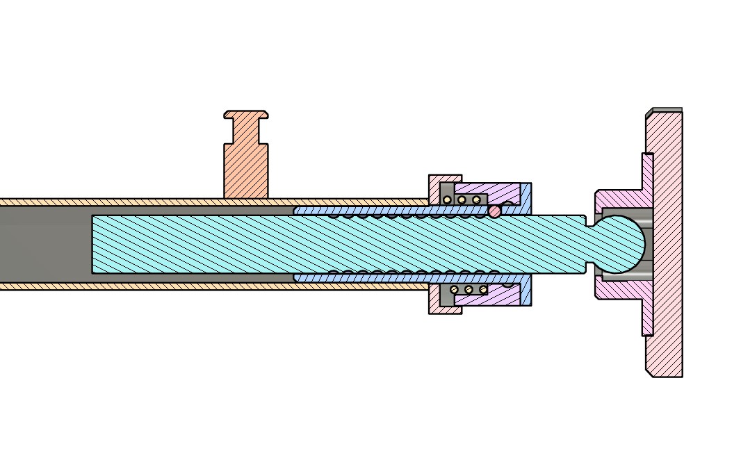

Only problem is it will, at least at this stage of thoughts, have to be cable operated. Not a big deal as 90% of the time it will just be in normal position, the other 10% will be when on farm/dirt roads where the ground is uneven. Sadly I am too old, stiff jointed and a short erse to boot so I mostly need to have the bike on the side stand to get on/off as it is not only tall but heavy.I quite like the adjustment mechanism actually.![]()
I had been thinking along these lines a year or so back but concluded it was not safe enough. Imagine deploying the stand, then coming back a while later and the gas shock has leaked and the bike is having a nap.Wouldn't a system akin to an office chair stem be easier?
So thought of the current design and having it cable operated and probably more robust than a gas strut.Harry Enfield "you don't want to do that, no no no"Bloody troublemakers
Constructive criticism please!Bloody troublemakers
My next idea for a stand is in the works (design stage) so they will have loads more to moan about.
