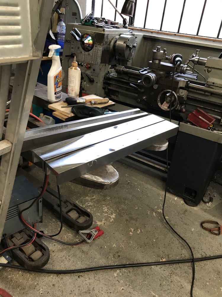

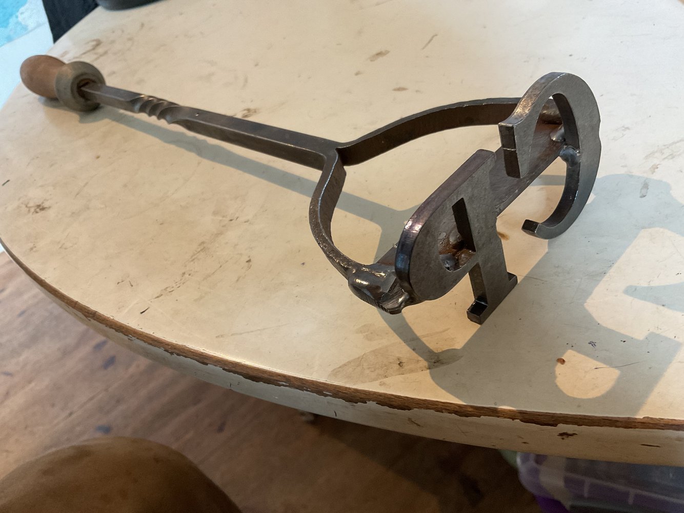

One last question, is the 'work piece' positive or negative from the power supply?I saw the method on Youtube and was surprised how effective it was when I tried it.
Plus jokers!Only another 51 to go?
PositiveOne last question, is the 'work piece' positive or negative from the power supply?
Here's my thread about etching.How did you do the letters etc? They are very crisp, great work.
Thanks for the links, they make interesting reading! I will have to try it now.Here's my thread about etching.
Experiments in Etching.
Todays project. A piece of zintec. Rough copper plated by dipping in HCL + Copper sulphate. Vinyl stencil applied. (Silhouette cameo cutter + cheapest t'bay vinyl) Weeded. Etched by reversing the electrodes in my electrolysis rust remover tank. (10 mins with a 13.8v /2A CB power...www.mig-welding.co.uk

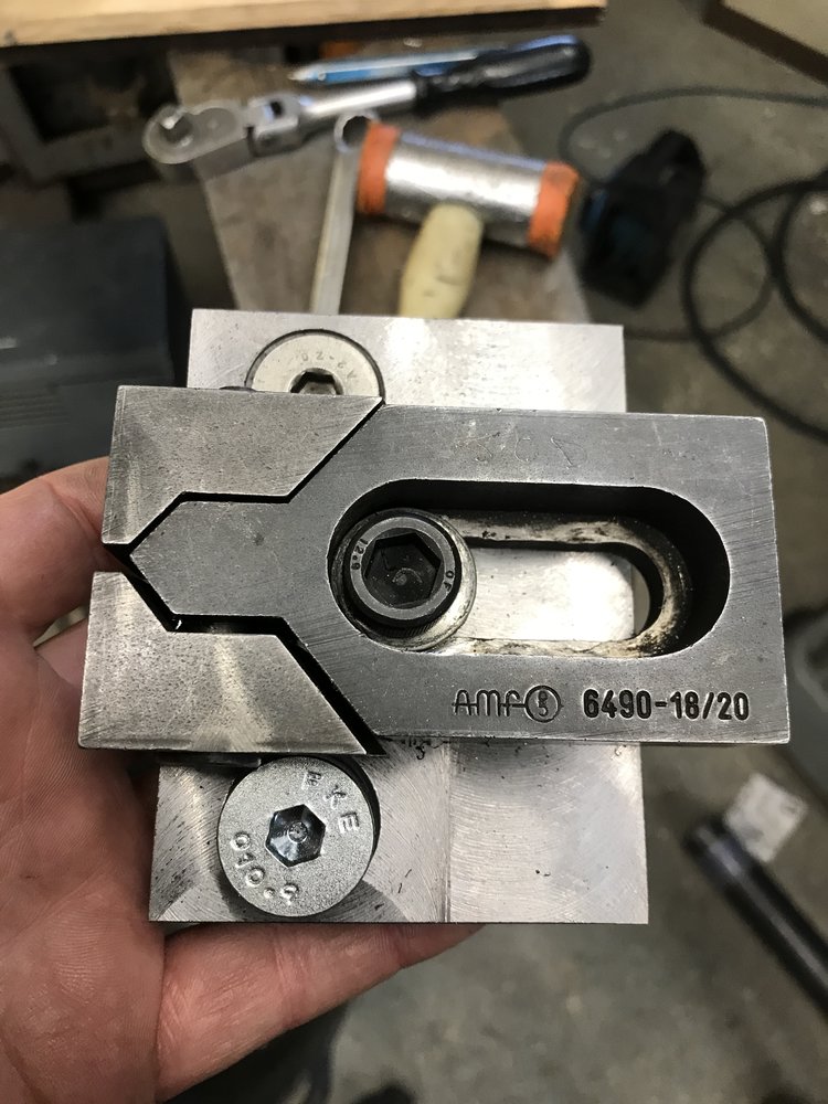

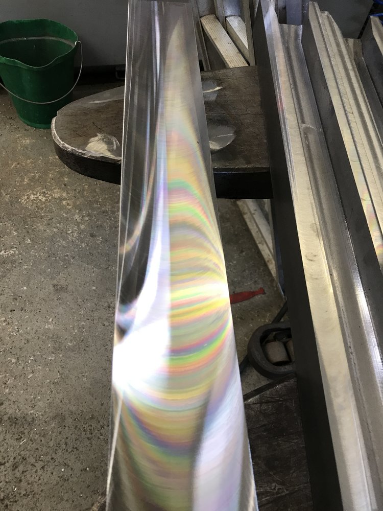

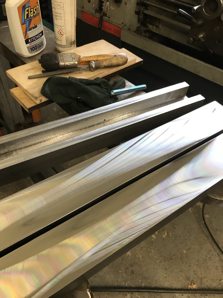

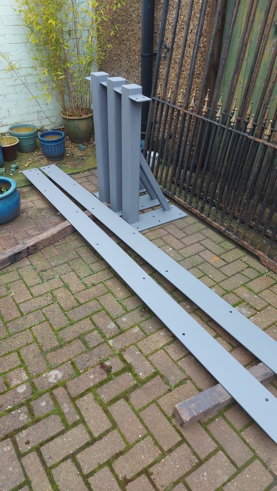

That's a nice design for a clamp. I see a new project coming on.Had three pieces of 3”x2” En8 bar to machine down, 700mm long. . Hacked the guts out of it in the small Cnc mill to turn it into a channel, then put it on the old mill for a lick to get it flat again. Evidently haven’t lost my touch on a manual mill
View attachment 472608 View attachment 472609 View attachment 472610 View attachment 472611
Clamps are made by a German company, they push forward and down.That's a nice design for a clamp. I see a new project coming on.
Nice mill finish. What are they for?
Hetzer, I was hoping so, please keep us updated as they progress.Clamps are made by a German company, they push forward and down.

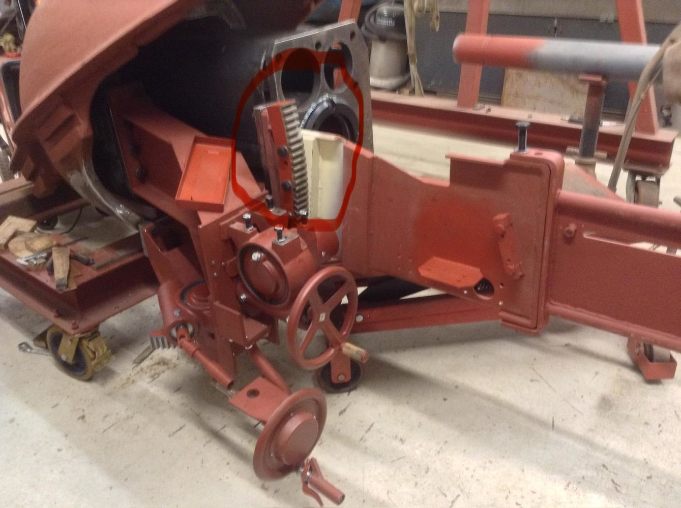

Parts are for the recoil slides for the guns on 3 Hetzer tanks I am involved with restoring . Currently working through making three of everything in Red in the photo
View attachment 472658 View attachment 472659
Flycut?Clamps are made by a German company, they push forward and down.
