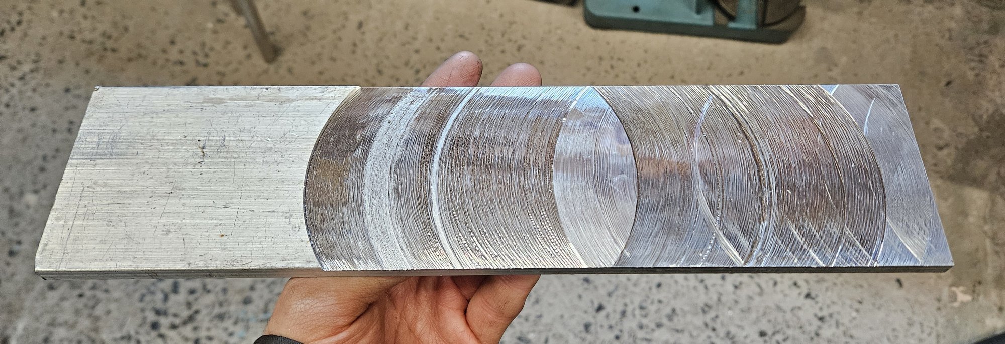

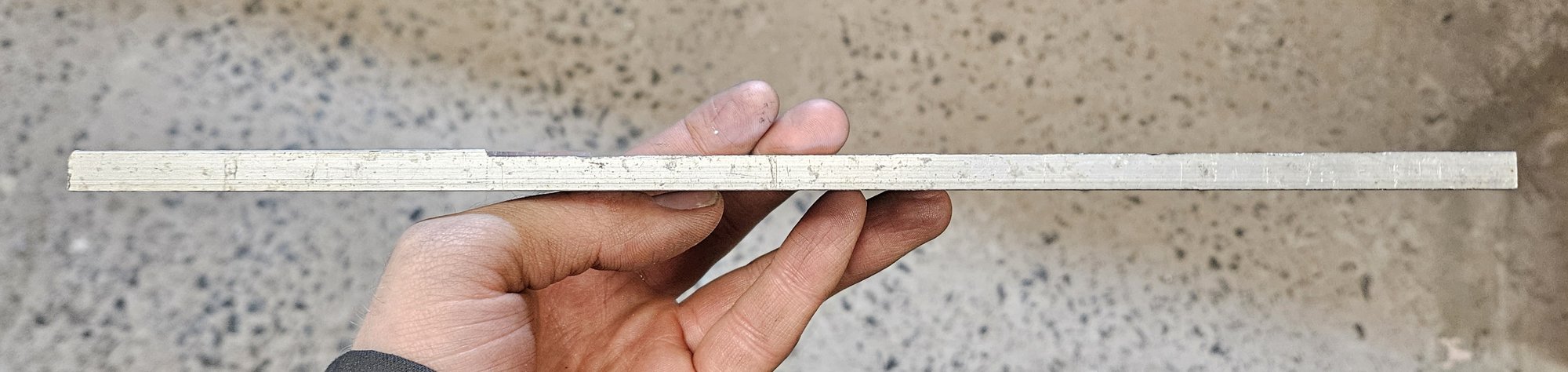

That looks like a very 'optimistic' depth of cut and feed rate for a flycutter on something X1 sized!A piece of 3/8" to ~8mm as though why not give it a go with my diy fly cutter (aka lathe boring bar clamped in a crude piece) and save £15 on ebay and not fussed about finish as have other side for mounting surface...
Now paid double what the right size piece would have cost me![]()
View attachment 468590View attachment 468591
Yea I could have done a much better job but I had no motivation to spend hours slowly going back and forth especially without power feed lol so just set it to a deep cut and very slowly went across it.That looks like a very 'optimistic' depth of cut and feed rate for a flycutter on something X1 sized!
Flycutters are handy, but looking at that pic, more spindle speed, less depth of cut, and lower feedrate.
I wouldn't worry about any theoretical spindle speed when flycutting on aluminium. Just run the spindle as fast as possible (usually the lack of balance will be the limiting factor on small mills), err on the side of caution for depth of cut/feedrate, and give it the occasional squirt of WD40/<insert light maintenance spray/release oil of choice> to stop swarf sticking to the cutter (plus a blast of air, if available, to keep the surface clear will also help with the finish).
