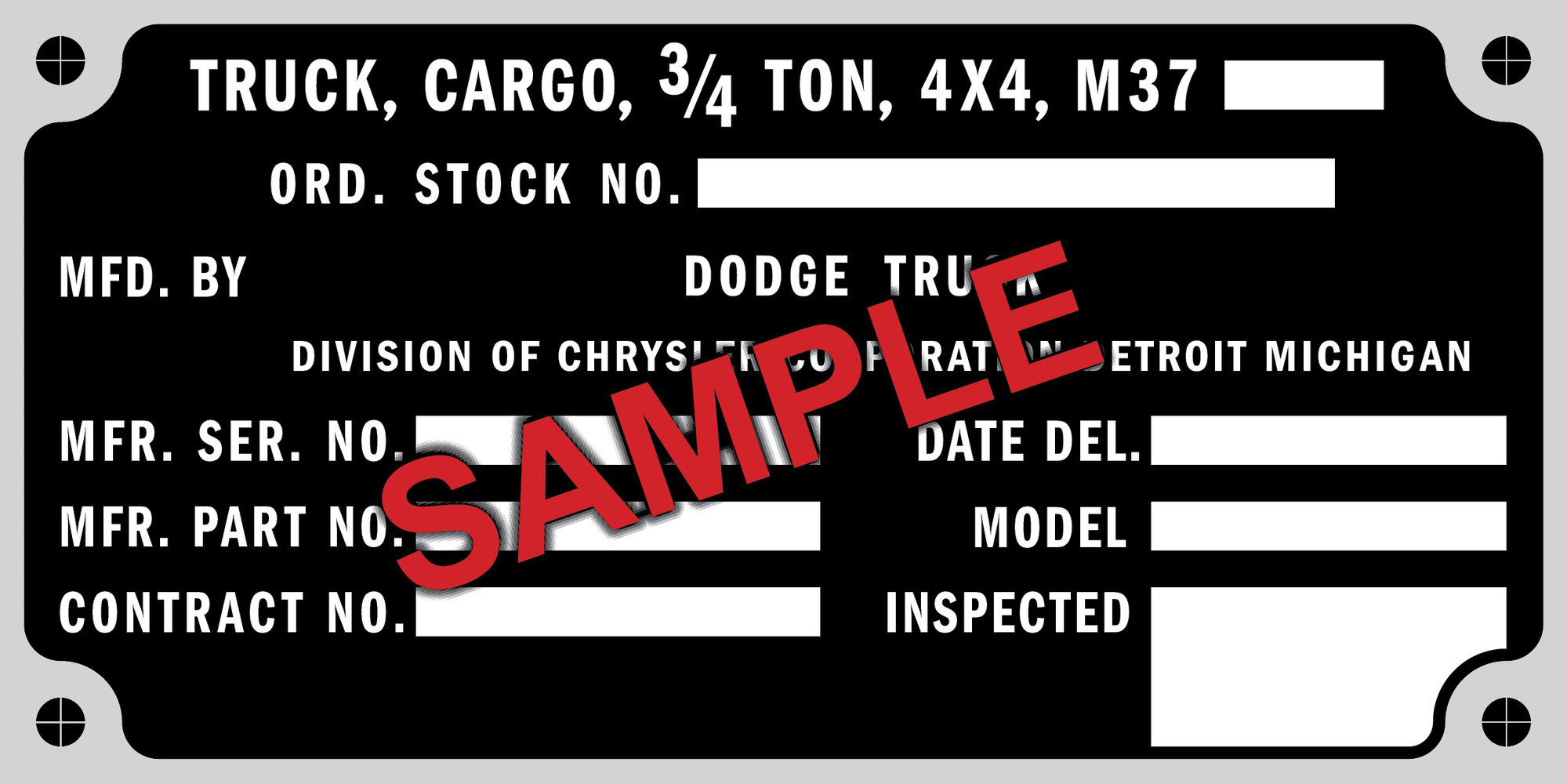

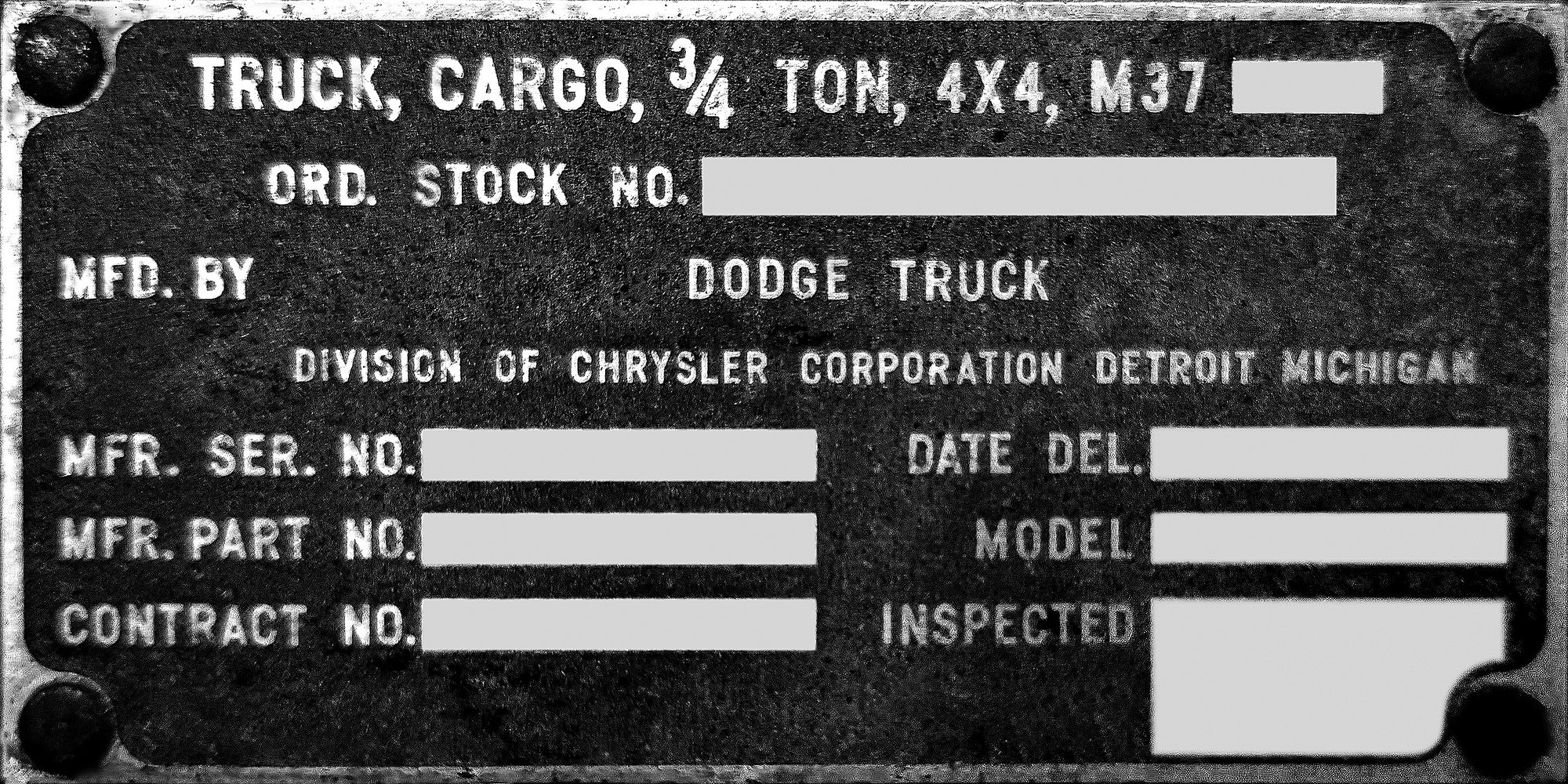

The ID data plate for my 1954 M37 was missing, and I could not find a proper reproduction plate, so I thought I'd try my hand at making an etched-aluminium facsimile that was as near as possible to the original plate.
To start, I found a photo of an original data plate that would be correct for my truck and squared it up with Photoshop so that it could serve as a model: The plate is 4" wide and 2" high.
Then I made a facsimile of the plate from scratch in Adobe InDesign. That took a while, as I had to modify some characters to come up with a pretty close match to the original fonts.

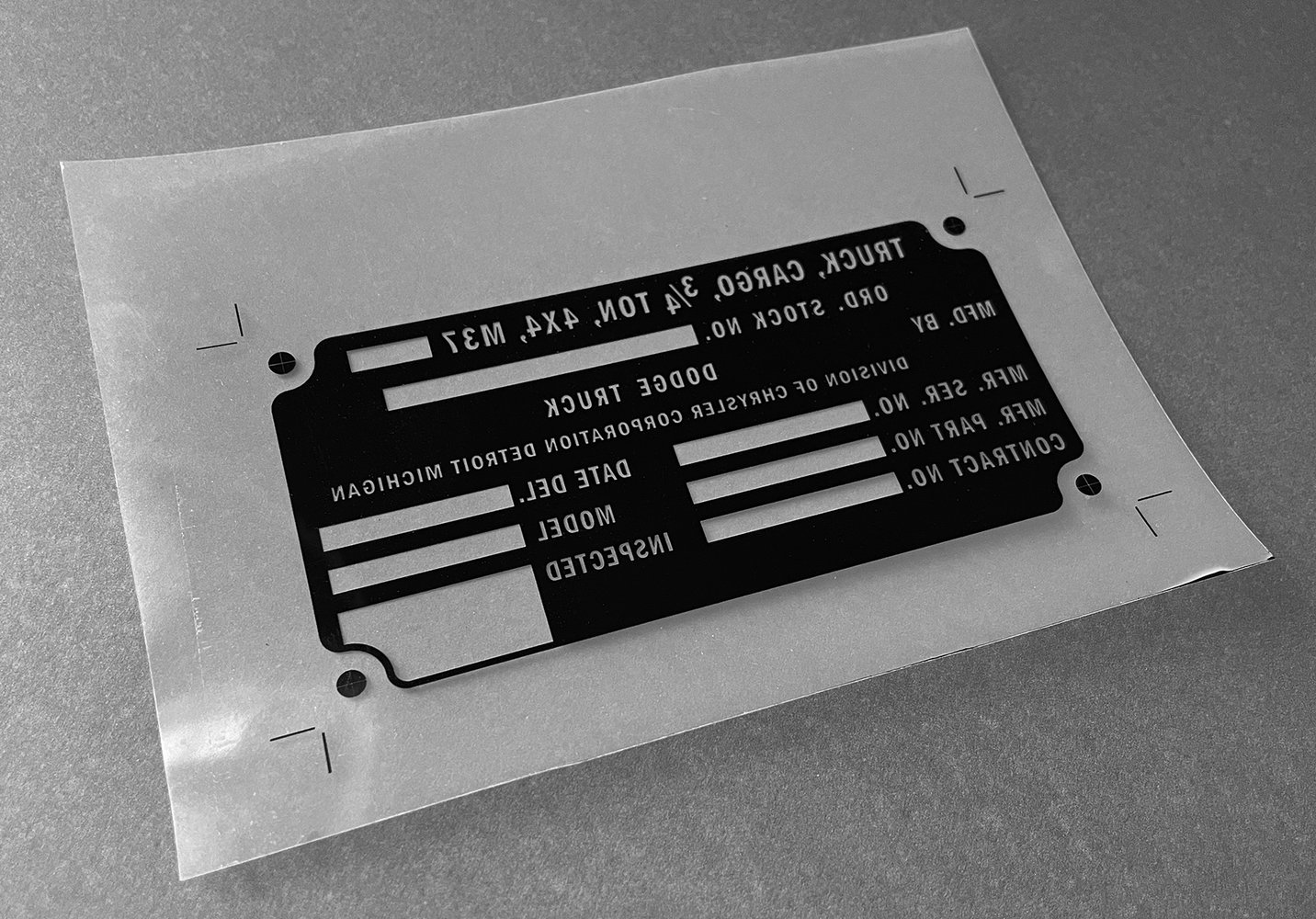

Next, I printed a mirror image of the design on special inkjet transparency film. The film has a slightly frosted coating on one side, which apparently allows it to accept more ink than an ordinary transparency film. I maxed out the CMYK channels for the black areas in InDesign and set the ink density higher in the printer control app in order to achieve pretty decent opacity.

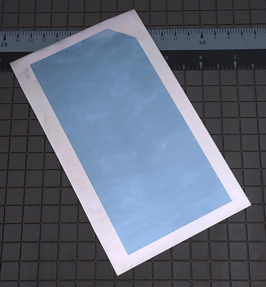

I then adhered a sheet of photoresist film to a carefully cleaned aluminium sheet, working under subdued incandescent light (the film is UV sensitive). It's hard to get this stuff on without trapping bubbles. There is a way of doing it with water, but I tried it and didn't like that method, so I just had to refine my pressing and rolling technique on some practice pieces until I managed to adhere a few sheets without bubbles. Here's one of them:

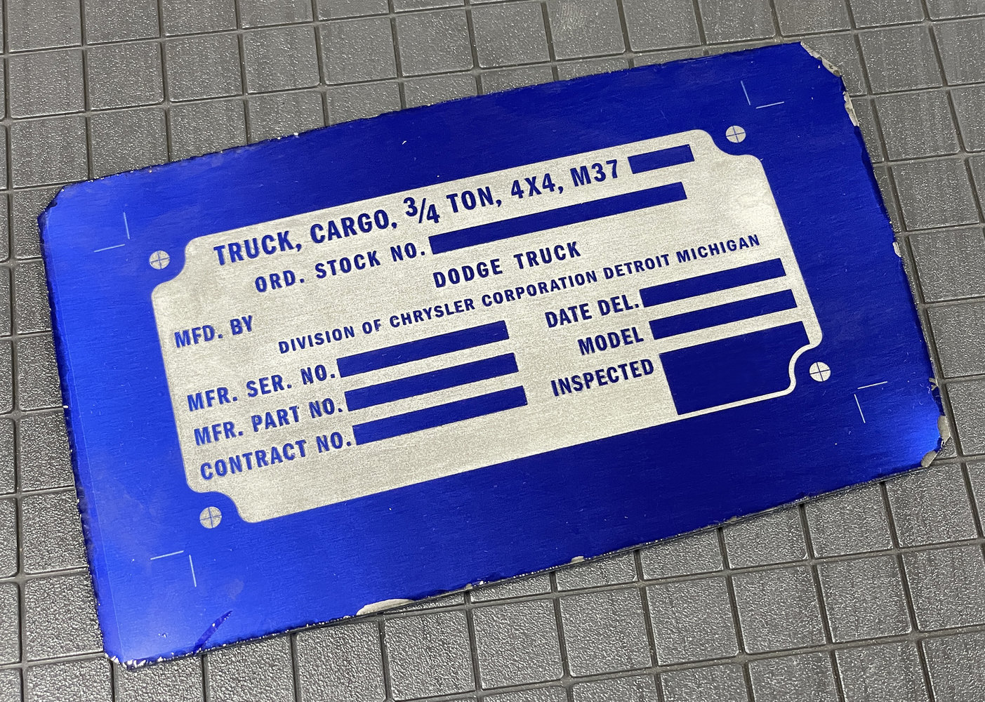

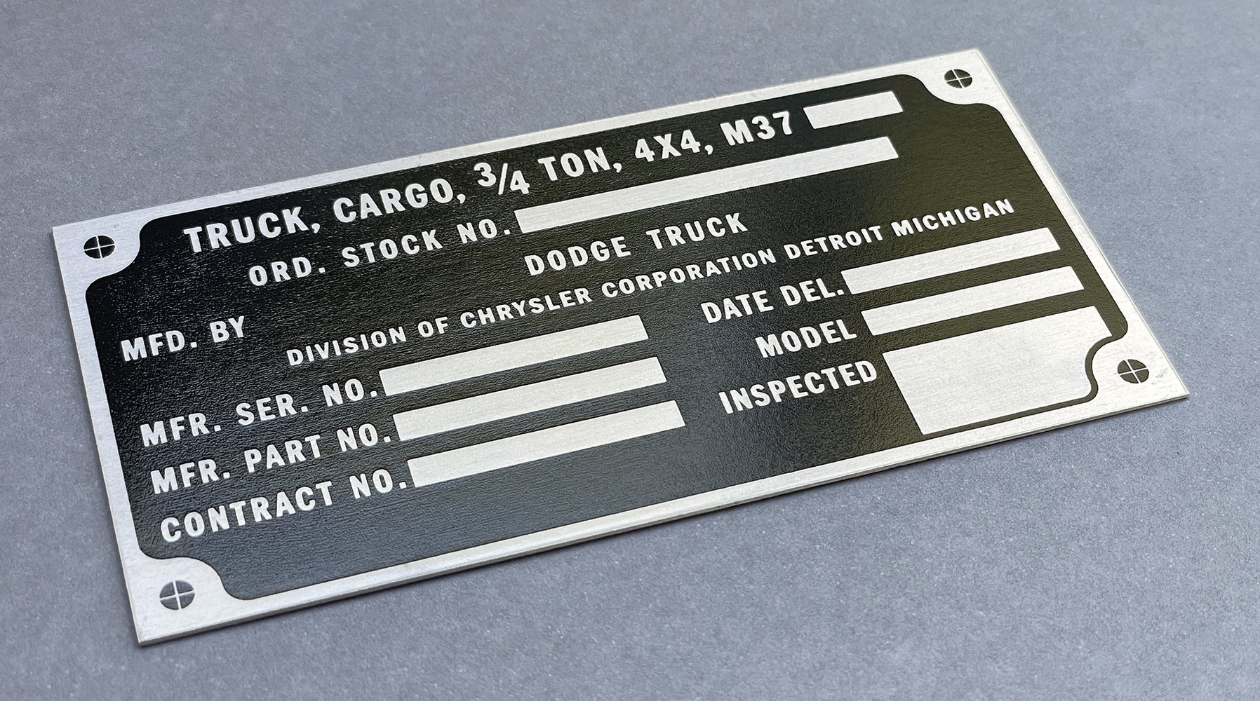

I placed the printed film image emulsion side down on the photoresist film, placed a sheet of plain window glass over it, with a piece of foam rubber behind it to keep it pressed tightly against the glass, and exposed it to direct noon sunlight for about 30 seconds. After exposure I removed the thin plastic protective layer from the photoresist film and 'developed' the photoresist in a mild solution of washing soda, which removed the unexposed (unhardened) portions of the photoresist. I then etched the aluminium with an acid solution (I'm still working on figuring out the optimum formulation, so I won't list it here yet). I had a few trial and error (mostly error) runs before I got a couple of decent results. Here's one of them:

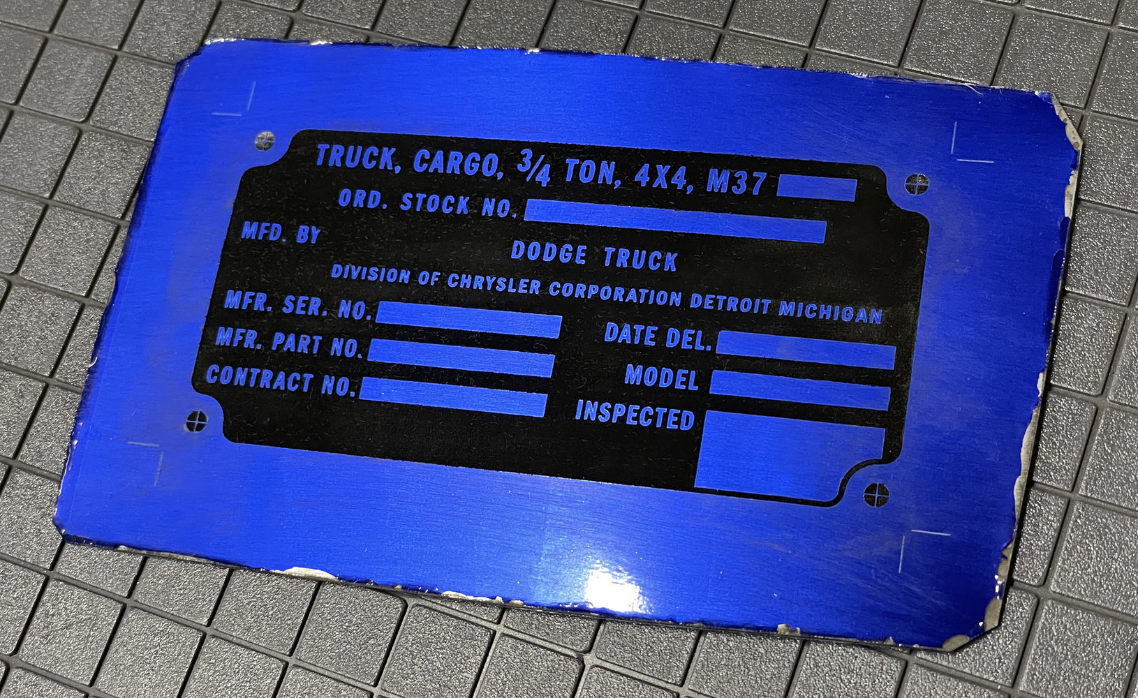

Next, I chemically darkened the etched area with Aluminum Black from Birchwood Casey.
Soaking the plate in acetone for a few minutes loosened the photoresist and allowed it to be brushed off easily with a soft brush. I then trimmed the edges to the cut lines with my latest tool, a 12-inch shear.
Here's the end result so far. The etching leaves the letters slightly raised, like the original data plates. I'll punch the rivet holes later with my Roper-Whitney punch set instead of drilling them. I'll use a 3/32" number and letter punch set to add the serial number and other data. I'll probably make a couple of extra plates in case I mess things up when I'm punching the data onto the plate.
I'm sure that with practice I could streamline the process and improve my success rate, but I've got too many other things on my bucket list for the time being.
By the way, the ID plate is mounted on the glove compartment door, which isn't exactly a secure location, as the door is easily removed, but the vehicle's serial number is also stamped permanently in large characters on the frame of the vehicle, so the serial number on this little plate is really just for convenience.

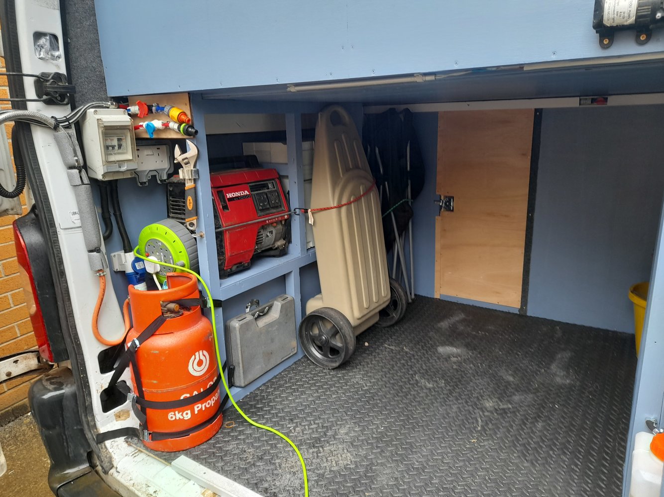

Can we have some pictures please?I've been plugging away on my camper conversion - nearly there now, thankfully.
Over the last weekends, I've got the sliding side door, bed area and above the sofa window apertures cut & the windows fitted. All 3 open (2 sliding, one top hinged) and the living area ones have built in blinds and flyscreens.
My Ferroli boiler is mounted and plumbed in, and seems to work well in brief tests. It's mounted on the inside of the ns rear barn door, and the flue stows next to it. In use, open the door, pop the flue on, switch on the gas and water valves and you're good to go. The Shurflo fresh water pump is pressure triggered, and so is the boiler - so open the hot water tap & both kick in on demand. I've also added a H&C fittings at the rear by the boiler as well.
Latest work has been to cut-down the over-large roof rack the can came with, retaining the 3 main crossbars. I've then made some L brackets by cutting up some offcuts of Galv Unistrut I had lying about, to bolt to the remaining crossbars to carry the Fiamma F45i Awning brackets, so I now also gave the awning mounted.
Last job today has been to cut down the new sponge & memory foam mattress to fit. The mattress is a standard double (1900mmm x 1350mm), but the across-the-van bed area is 1840mm x 1350mm so I've had to cut down & shape the mattress - overall I'm pretty happy with the result.
I've booked the camper for its Maiden voyage next weekend - away mountain biking with some friends about 100 mile or so away. There's still fiddly bits & bobs to do and no doubt I'll find some niggles (& I've done nothing mechanical / body-wise bar getting the cam & aux belt done after buying the bare van yet)... but it's great to have it at the stage where I can use it.

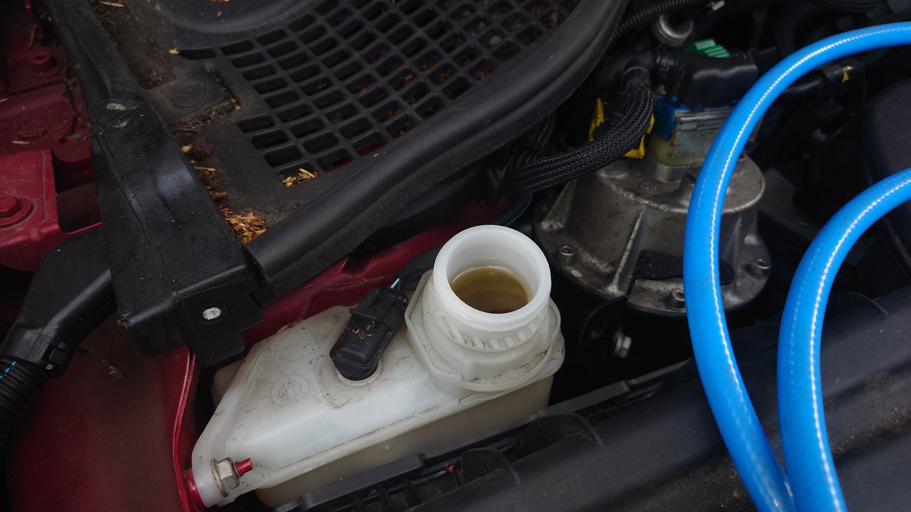

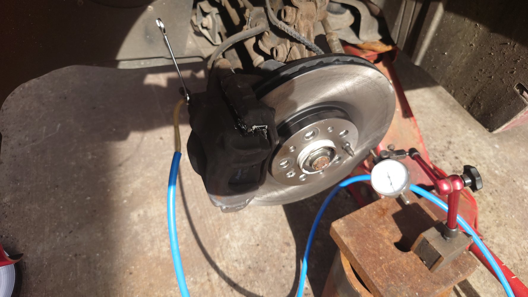

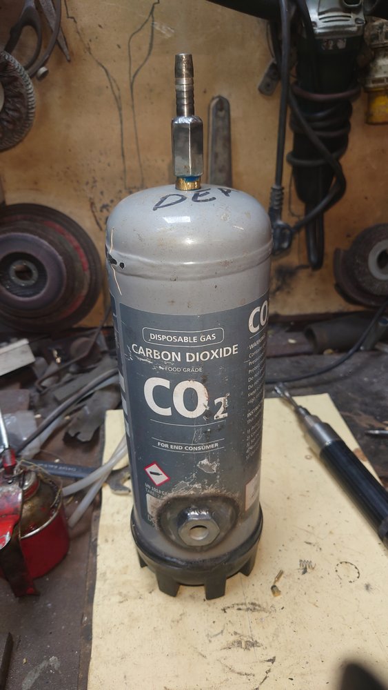

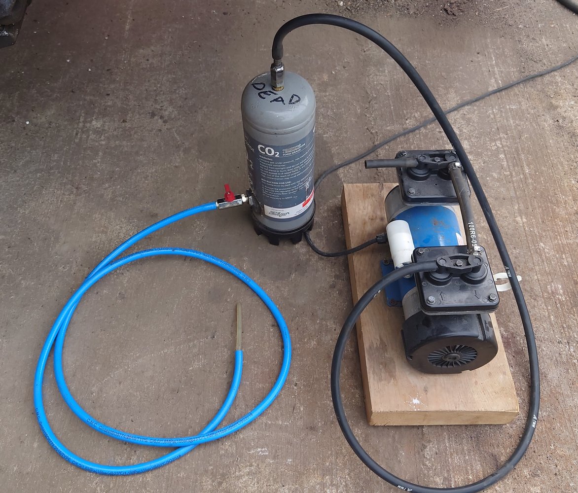

Is it any more effective to bleed under vacuum than pressure bleed brakes ?Today I made a brake bleeding tool from scrap or repurposed stuff.
I was doing a brake service on the bosses car and the brake fluid was due a change.
I was on my own and as brakes are getting more and more complicated to bleed, especially if they get air in the system and as I already had a vacuum pump and a small CO2 bottle that @Onoff gave me I thought I'd make a vacuum bleeder kit.
I removed the valve and tapped a 10mm coupler to suit the M10 x 1mm thread on the valve.
Then welded a boss for a ball valve and hose tail low down.
Initially I was just going to use it to suck the old fluid out of the reservoir.
but it was able to draw the new fluid through the brake calipers without any issues.
I won't use it much, but I will probably also use it for the odd oil change instead of having to use the manual vacuum pump.
I'll need to make an adapter for that but that's a job for another day.

Yep, I know I have the lpg stickers "somewhere" (which means I need to buy another oneThat looks good . don't forget the carrying gas warning label /sticker and one for the heater fuel too on the outside rear door ..
I looked into stickers right away & Evilbay came up with the goods.Think if is just a flammable liquid one
