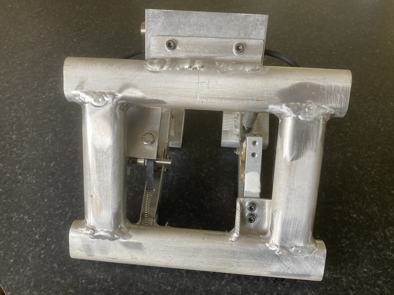

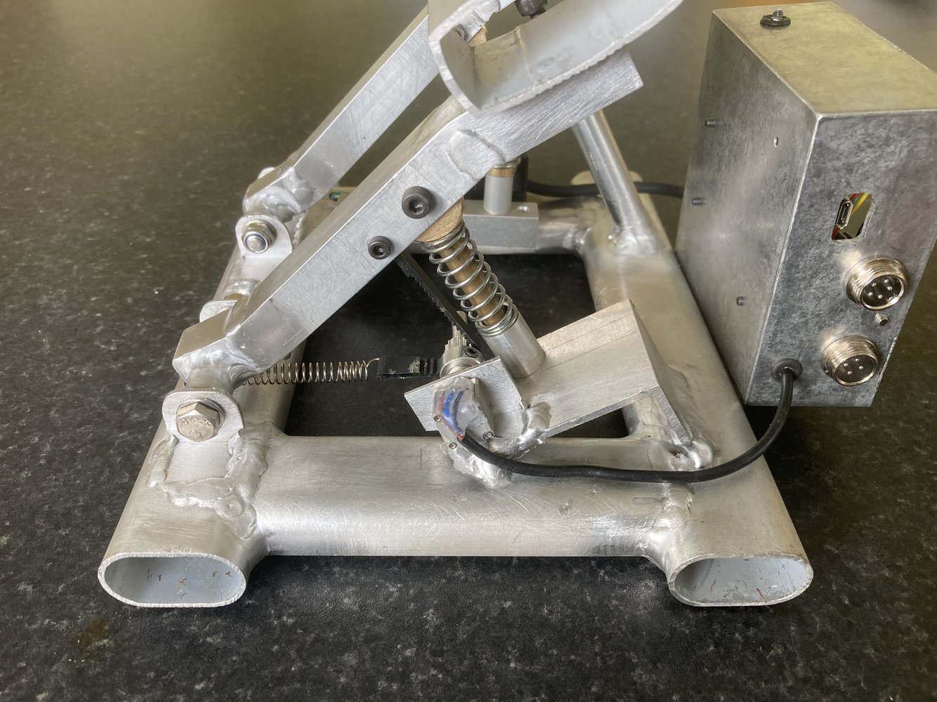

(Look away now if disturbed by shoddy welding).

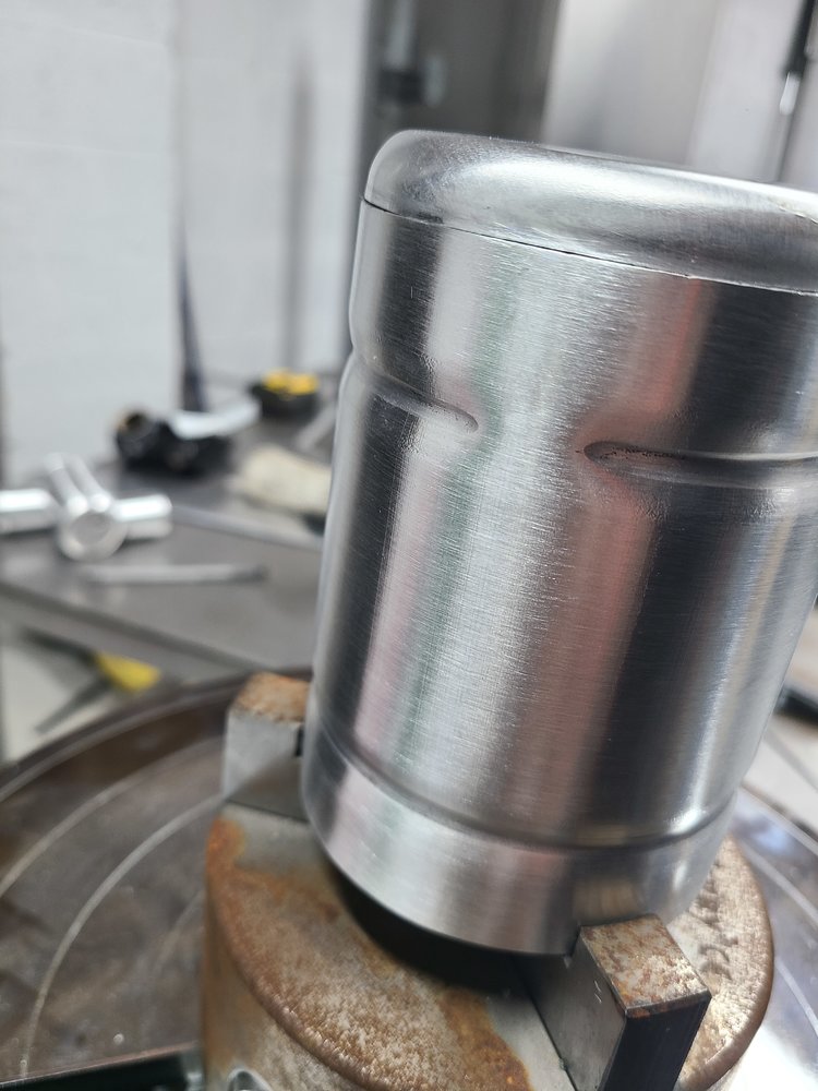

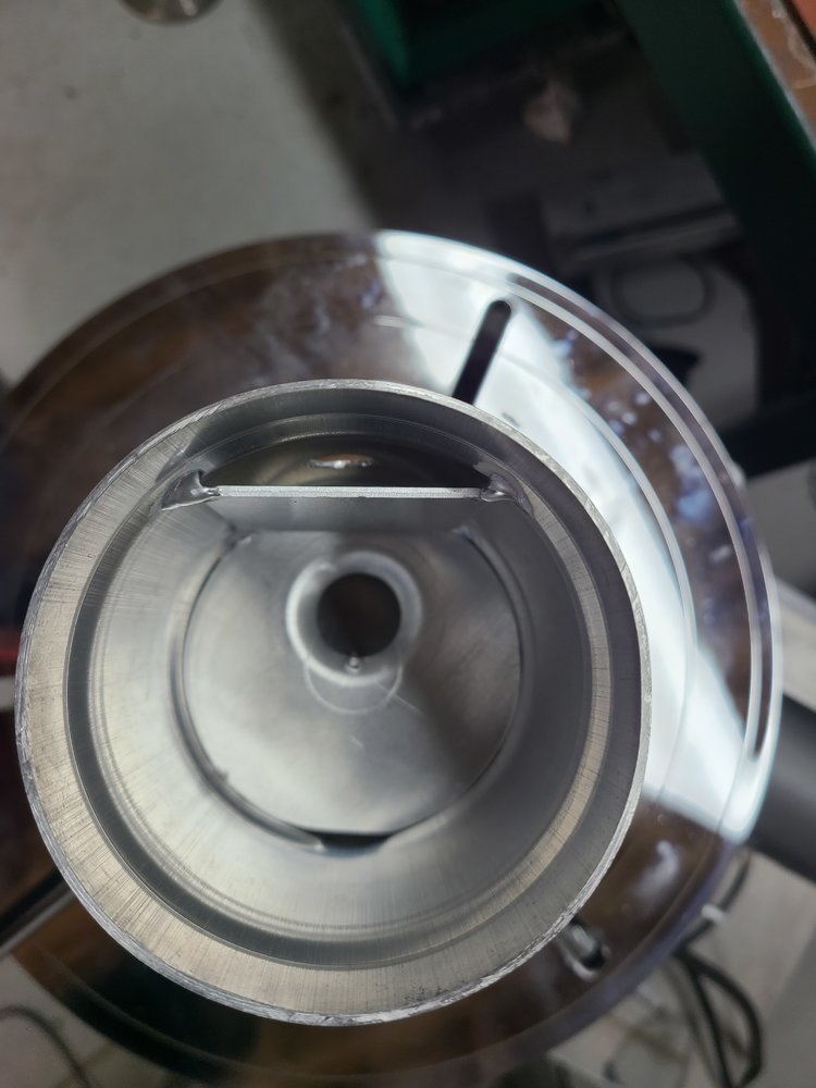

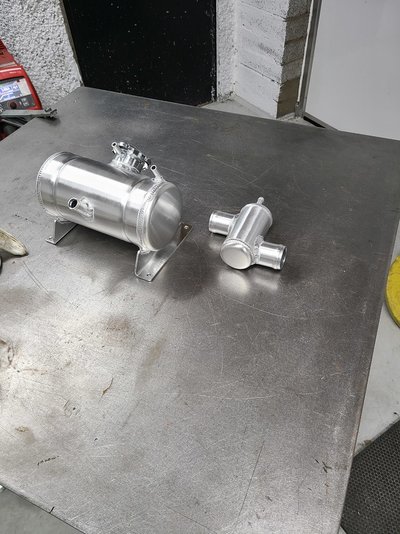

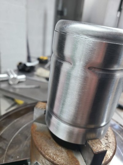

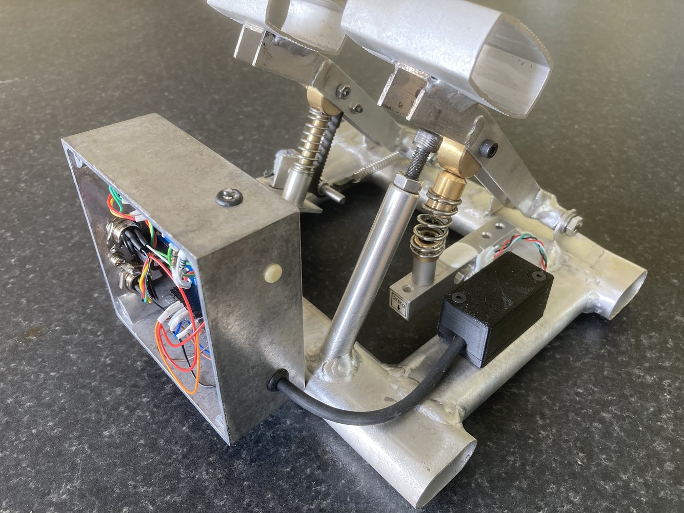

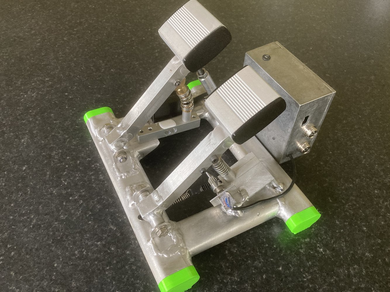

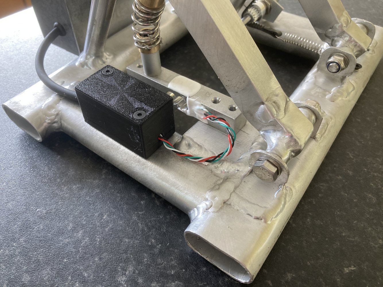

Did you design the load cell yourself or pinch it off a bathroom scales?Practicing my aluminium TIG (goodness knows I need it!) to make some pedals for a car racing computer game. (Look away now if disturbed by shoddy welding).
The metal was mostly 1.5mm wall extrusion from an old ladder. It had been anodised, but I stripped it with with caustic soda. It wasn't the nicest stuff to weld, but that's it - I'm out of excuses.
View attachment 453543View attachment 453541
With the addition of some 3D printed end caps in PETG and some feet in TPU
The 'brake' pedal uses a load cell and the 'accellerator' pedal uses a pot. Electronics is all handled by an Arduino Leonardo. The sockets on the side are for a force-feedback steering wheel. Windows recognise the whole thing as a USB game controller so it's 'plug and play'.
No, it’s an arduino thing: load cell, amplifier and ADC £4.49!Did you design the load cell yourself or pinch it off a bathroom scales?
