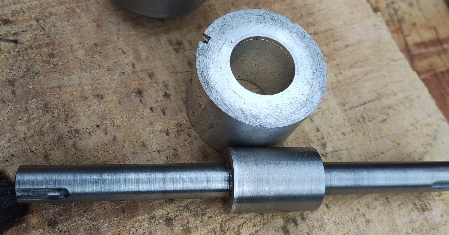

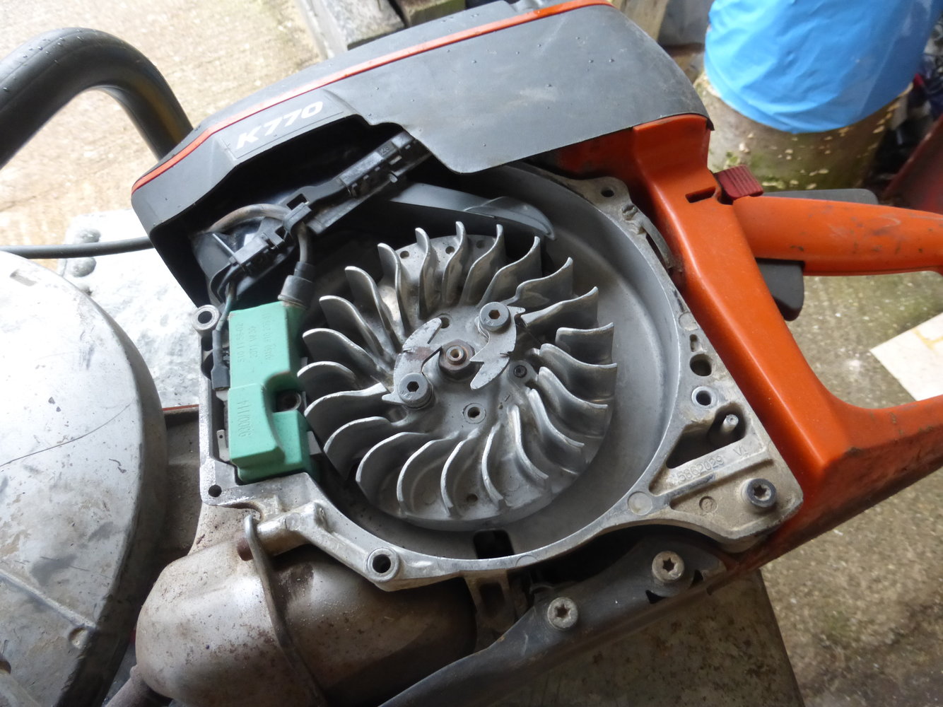

Press ?A stuck shrink fit. The alu part had sharp turned corners which were deburred but probably needed a chamfer . It was only a tiny bit undersize by 0.02mm which I would have thought not enough on 23mm. Anyway it stuck.
Its only gone in 2mm. Can I get the bast thing off? No. Not without making too much noise for tonight.
My soft lead drift has a nice deep imprint with machining lines and also mushroomed out the copper tube of the other end!
Tomorrow I will try with the sledge.
