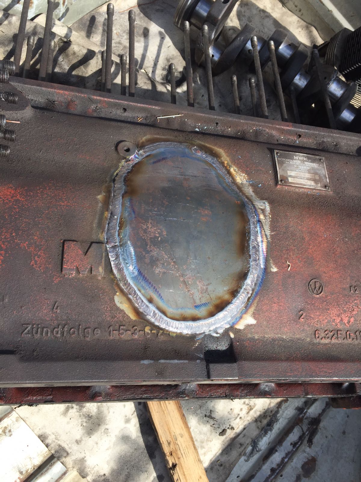

Repaired an old tractor block...
What filler wire did you useRepaired an old tractor block...View attachment 140744
I have used silicone bronze on a smaller repairIt’s a multi pass weld, Its a mixture of copper, steel and 316 stainless...
They need a good polishing to show them up properlyShe must be inverted John....I see no raspberry ripples. LOL![]()
In this case the rod came trough the block, pity I didn’t take more pictures of the job before/after. The cast was an interesting cast iron mixture, it welded ok with preheat with almost no cracking - credit to German quality castings !I have used silicone bronze on a smaller repair
When I first looked at the picture I thought it was a patch let into the block but I've realised it's a surface mounted patch, how thick?Repaired an old tractor block...View attachment 140744
15mm plate... it’s a 6 cyl tractor engine...they are working these really hard over here !
