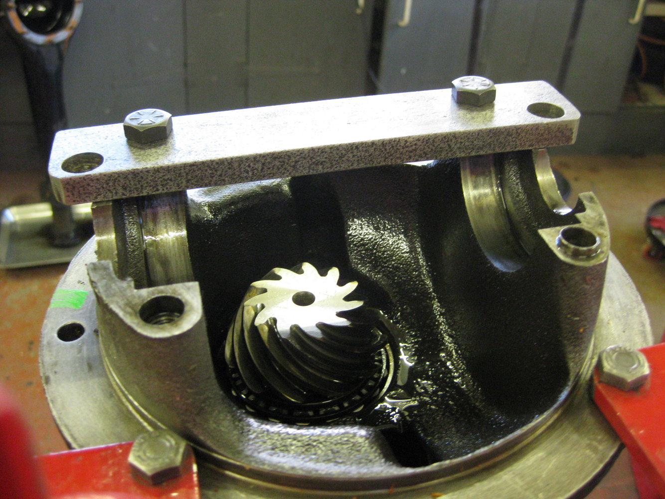

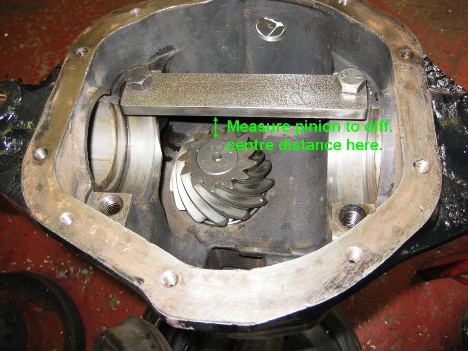

I have had quite a few customers want me to change the ratio on their differentials. This requires setting the pinion depth. I 3D printed pinion depth measuring tool I made based on drawings of an "official" one from the 90s. Next step is to get it made from a solid piece of steel, it's going to be expensive right?
What degree of accuracy do you need to work to when setting it up? Are the two bearing surfaces in line and you just need the height from their surfaces? If so would a peice of gauge plate lain across the bearing surfaces and a depth micrometer for measuring the pinion height suffice?I have had quite a few customers want me to change the ratio on their differentials. This requires setting the pinion depth. I 3D printed pinion depth measuring tool I made based on drawings of an "official" one from the 90s. Next step is to get it made from a solid piece of steel, it's going to be expensive right?
Which is why I asked how accurate it needed to be.The measurement required is from the bottom of the bearing surfaces to the pinion. I suppose it could be done with gauge plate but then you'd need to measure the distance of the bottom of the gauge plate to the bottom of the bearing surfaces
I've just read the other thread on cost of bespoke part. Cheaper way would be just have a piece of precision ground round bar across the bearing surfaces and measure the gap with feeler gauges.I see what you're saying. But the bearing surfaces are circular. So laying a flat plate across it you need to know the distance of from the cord of the circle where it rests to the bottom of the circle. This of course can be calculated but is likely to introduce error. I have no idea how accurate it needs to be, the purpose of this measurement is to calculate a pinion shim size which are available in 0.05mm graduations. I may be getting the wrong end of the stick, if you can't tell, I'm new to this

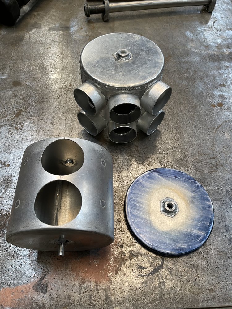

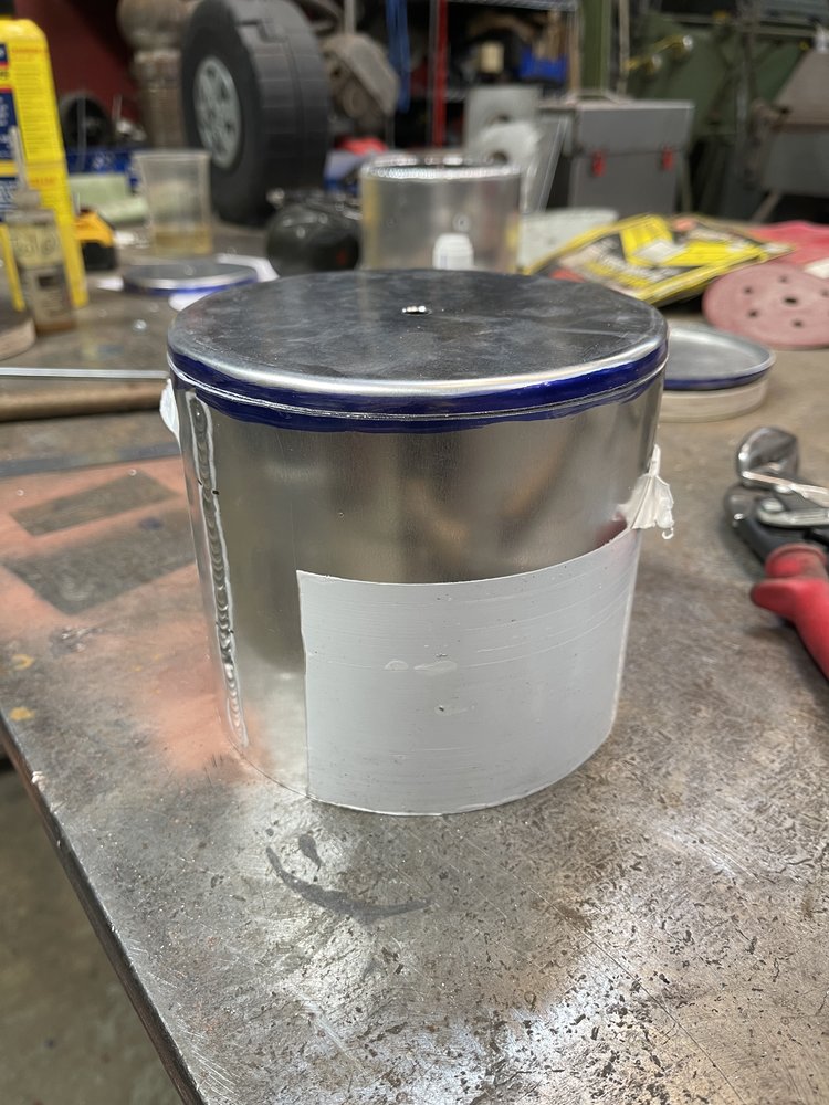

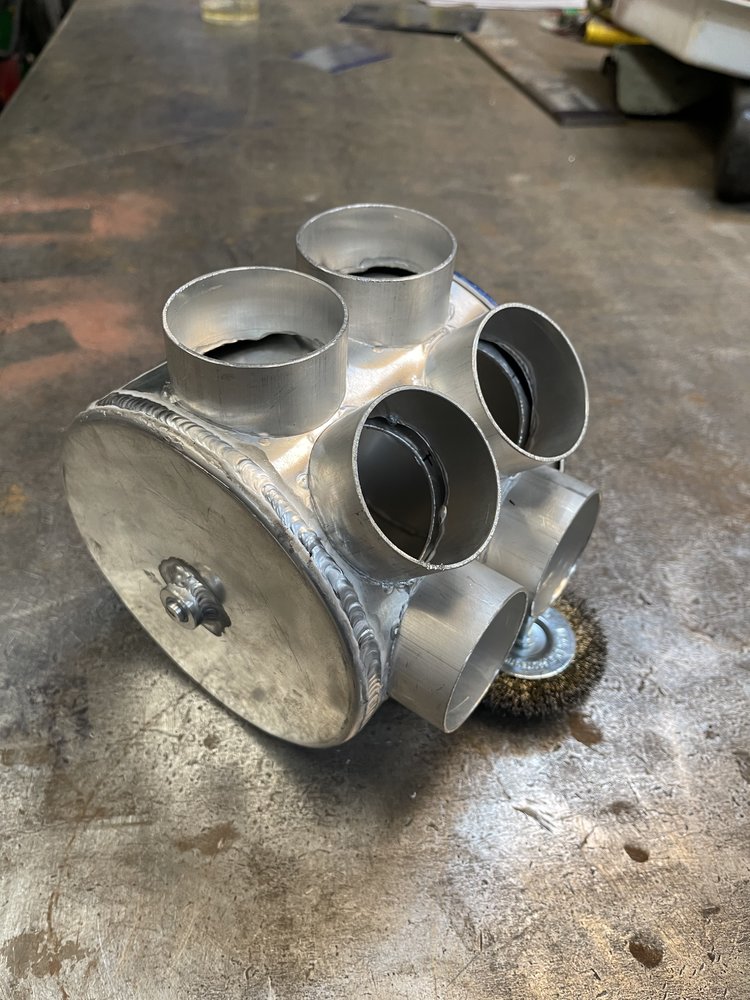

very project binky!!! nice!Over the last few days I’ve been faffing about with bits of aluminium making hvac manifold.
I’ve still got to add the inlet pipe on the end and a lever for the centre drum so it can rotate between demist, dash & footwell.
Very Binky indeed.very project binky!!! nice!
