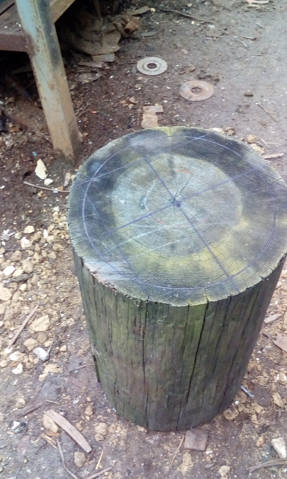

One of those been meaning to knock up for ages

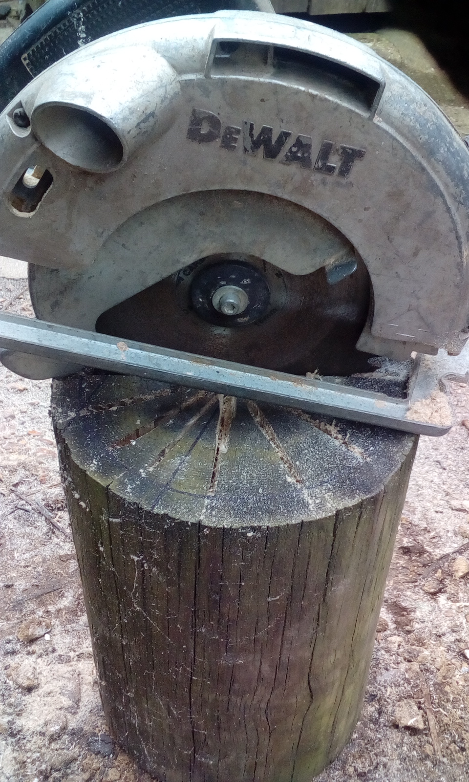

First up one bit of old tele pole thats been laying in the garden since god knows

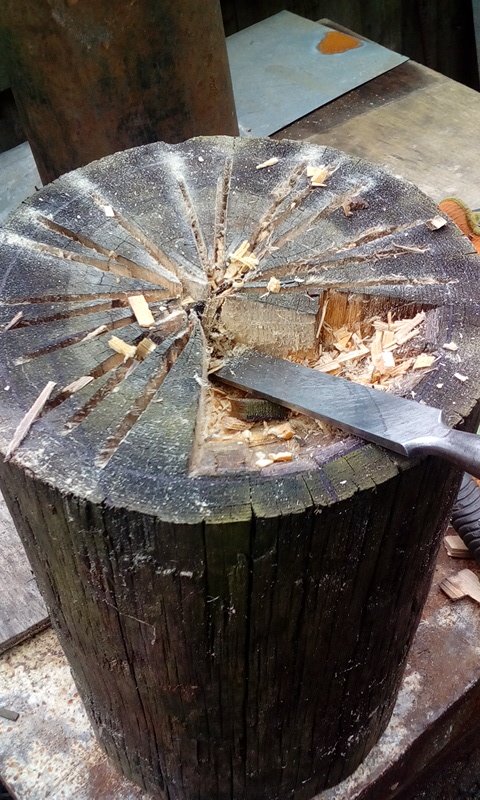

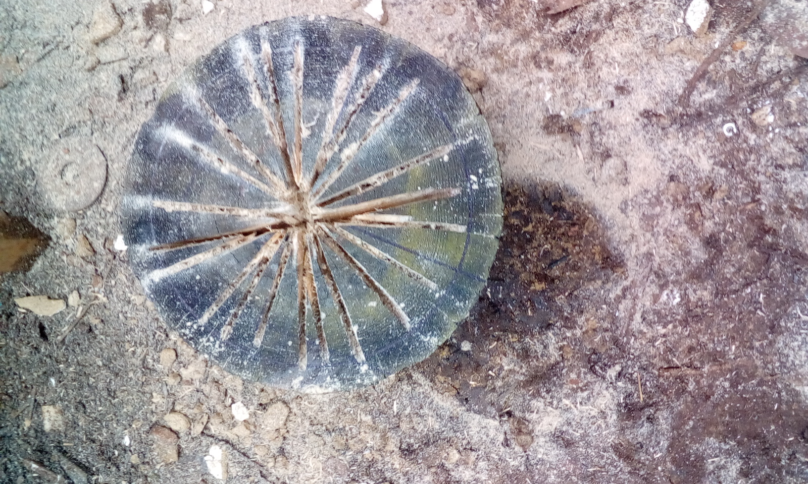

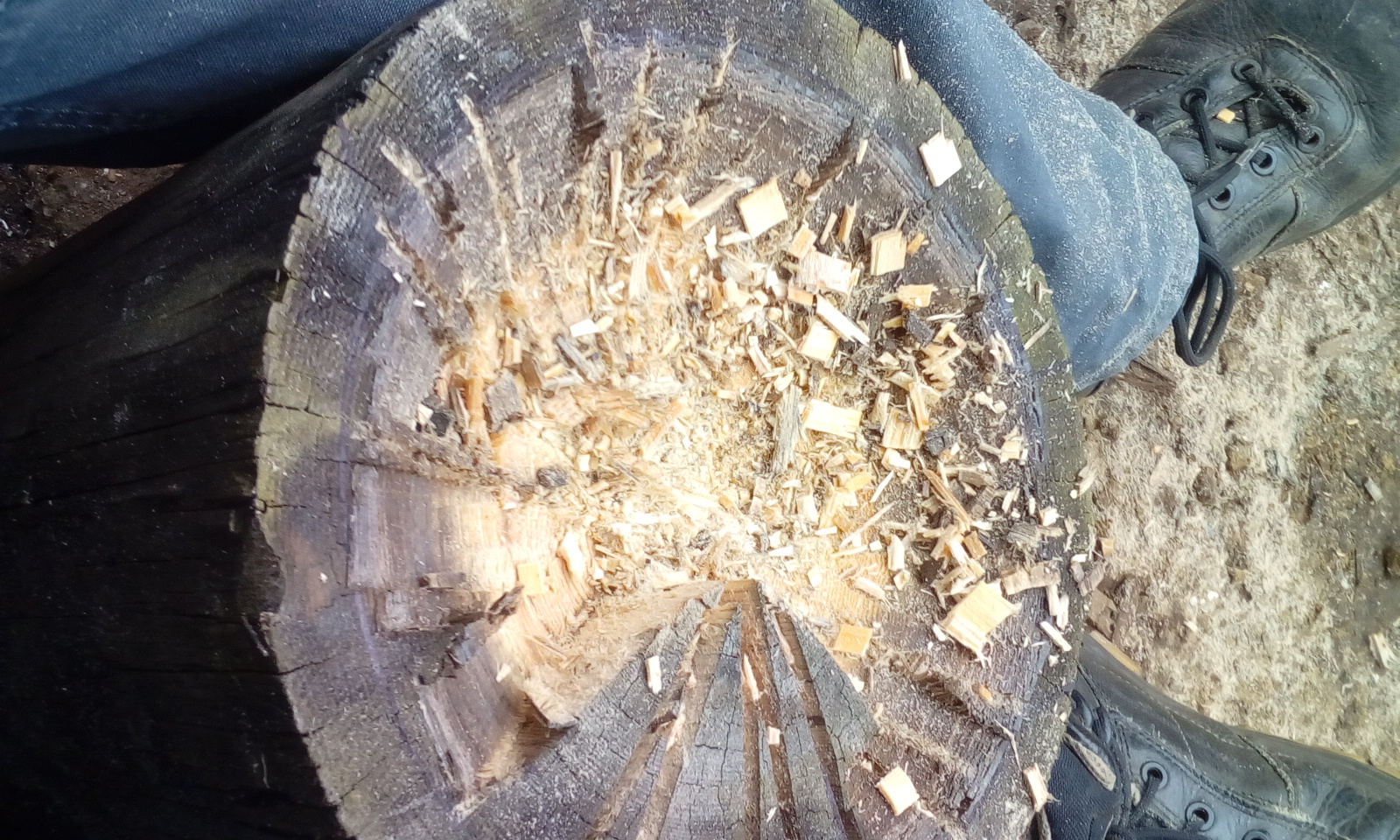

mark a centre(ish) then make cuts with the circular saw
Till you end up with this

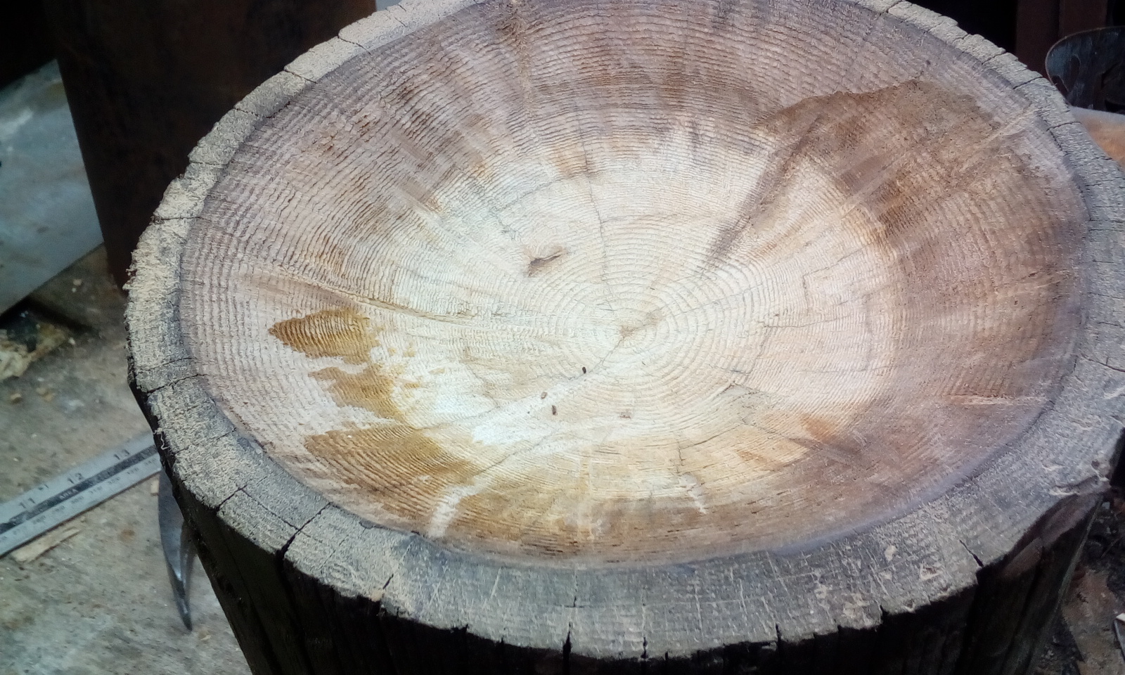

Then its out with the chisel and chip away

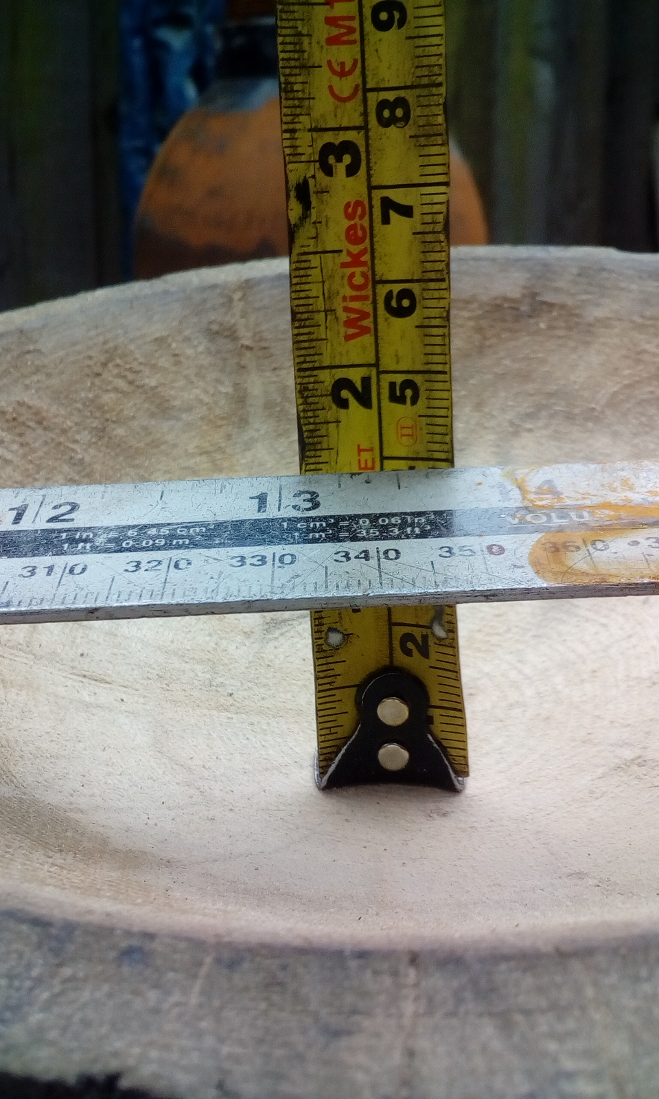

The thing was quite wet but i ended up with this

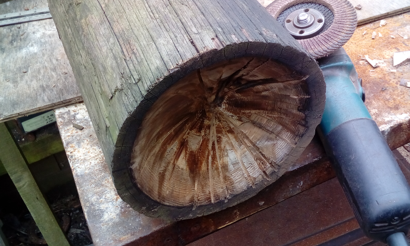

Attacked it with the angle grinder 1st with standard metal disc then with a 40 grit flap disc
Which bought me to this
Bit shallow than i intended but hey ho

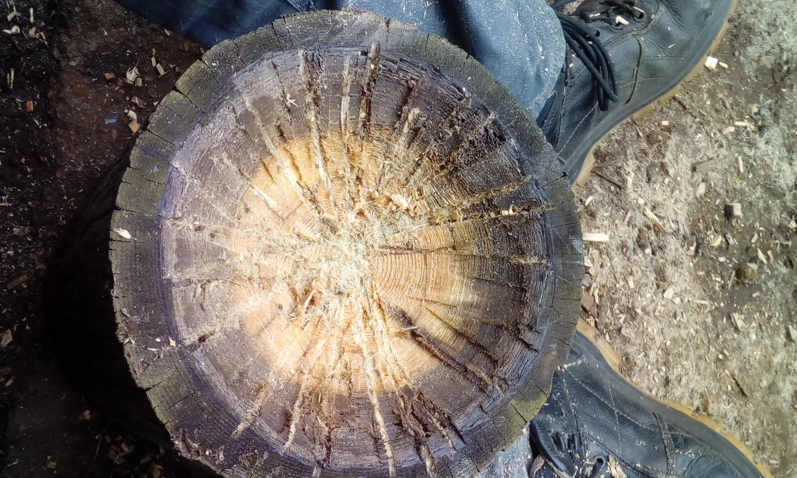

Gave it a rub with some 80 grit also put the torch on it to burn some on the nasty stuff,these thing are literally soaked in bituminous paint,boy did it smoke and stink
Few rubs with some 80 grit and i'm left with this

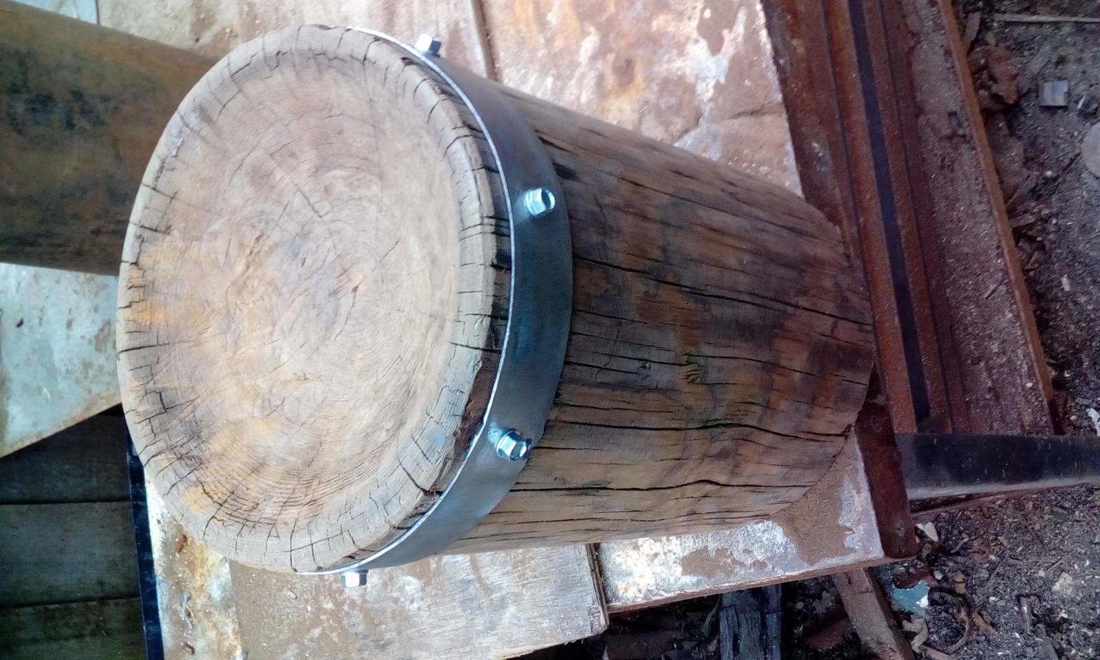

The steel band is around it because those edges look a bit dodgy it'll need a few whacks with the hammer to harden the surface etc
thats as far as i got for an hour or so
I'm undecided whether to make a small stand for it OR make something so it can sit over my homemade anvil,slap some paint on the steel might even varnish or stain the rest of it,not the bowl area of course

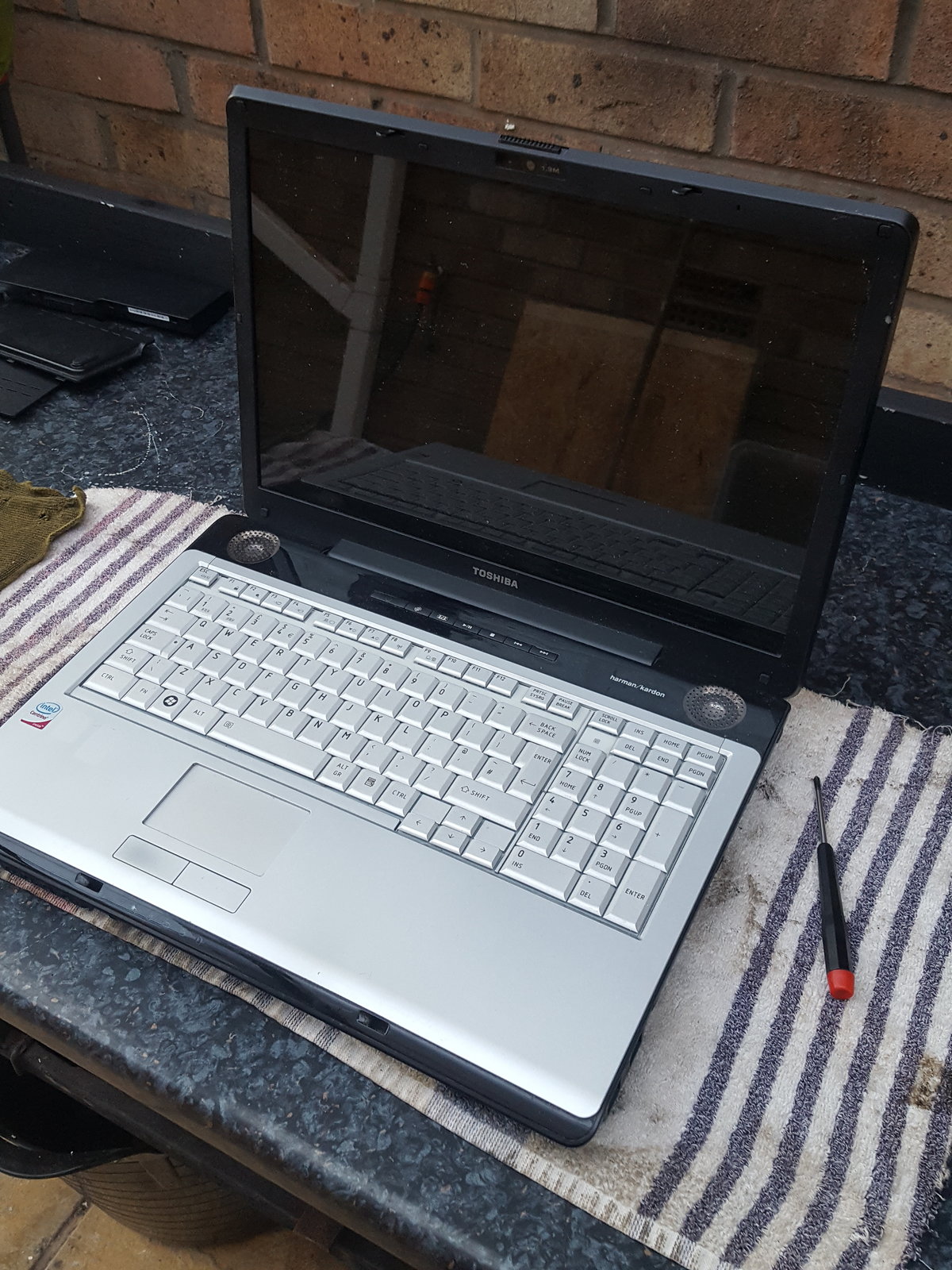

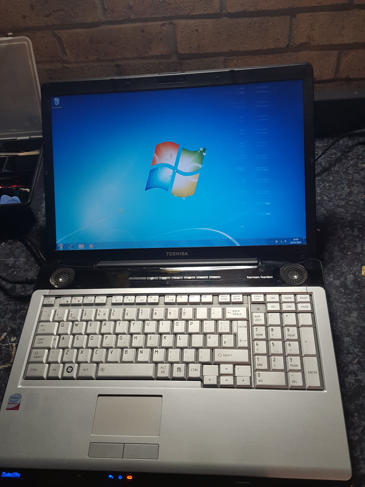

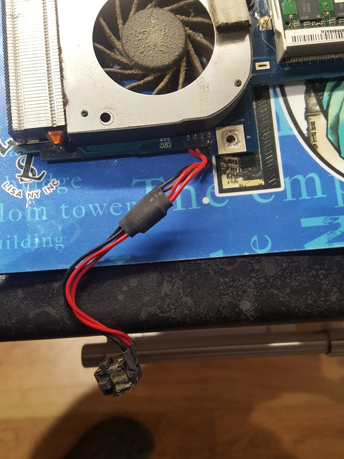

Well done, I had a Tosh Satellite very similar to that, only no H&K audio which took four or five years of on site abuse before the screen hinges gave in.Not today but yesterday a power Jack fix on a laptop took a couple of hours but I was not rushing and there was a beer or 2 inc in that time scaleView attachment 136167 View attachment 136168 View attachment 136169 View attachment 136170 and yes it's was a nice easy one for a change I like to the ones With a cable on much easyer but will say the taking apart the laptop as it was an older one was harder than some of the newer stuff
all fixed for the sum of £3.99 for the part
They have given it some stick already and its still holding fast so they are pleased and so am I
