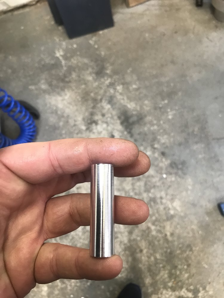

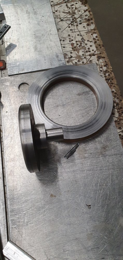

Had a near miss this morning a tiny bit of rolled 1.5 mm thick by 8 mm dia & 11 mm wide decided to unroll and come off the lifting arm's yolk pin when my 60kg electric wheelchair was about to get hoisted up and put in the back of my Turismo , resulting in the spreader / hoisting bar with the lifting straps on it connected to the wheel chair ...... falling off the hoist arm and landing on top of the wheel chair with a loud bang .
I spent a few icy minutes trying top refit it and get it back to a sound wiorking state but it came adrift again . so I turned up a stainless steel cylinder 8 mm OD x 6,38 mm ID by 11.5 mm long using a 35 mm long knob end of scrap 25 mm in diameter
I thank god I had the sense to put the diesel heater in the mancupboard or I'd have been far too cold to stand at the lathe and turn the bush up as it was minus 2 oC with a strong bone chilling breeze blowing .
The picture is of the failed part that could have had serious consequences for me such as causing the 60 kg electric wheel chair to fall out the back of the cargo area on my legs if it had failed when it was 620 mm up at the cargo bed level .
Ruler is in mm . I haven't a clue as to why it opened up along its split , the stainless steel ferrule I've made & fitted should sort it permanently and safely .
