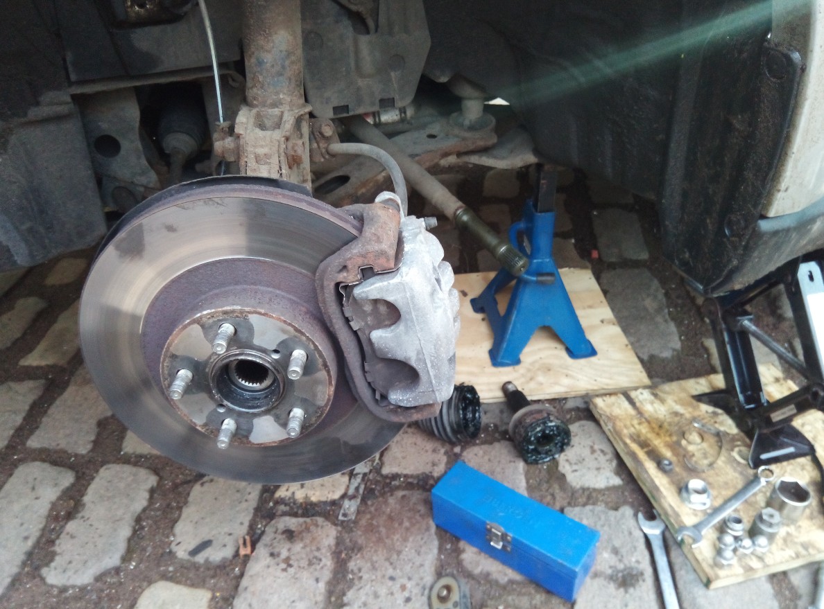

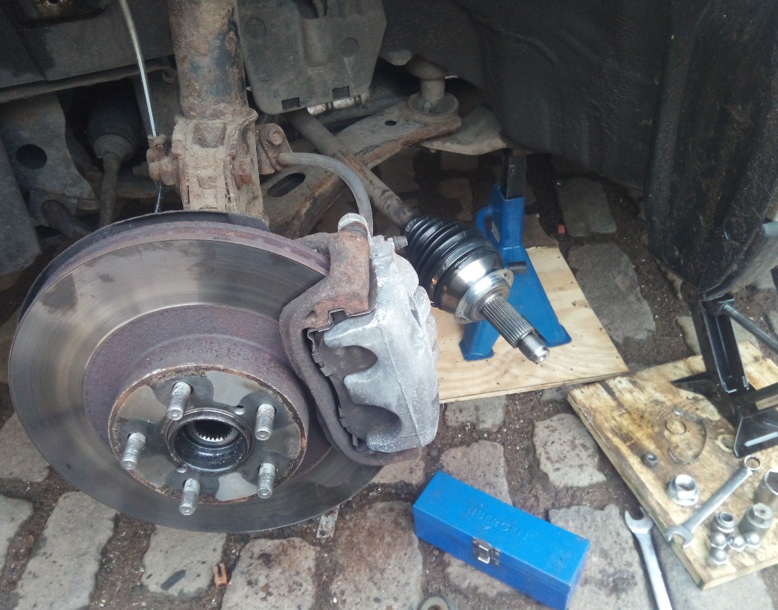

Yes but the other alternative of the driveshaft coming loose would have been more of a pain somewhere else which would be worse than the backThat is just what you need to cure a sore back..............struggling with CV Joints

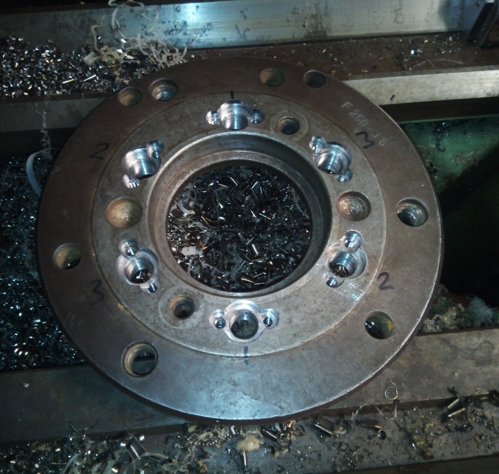

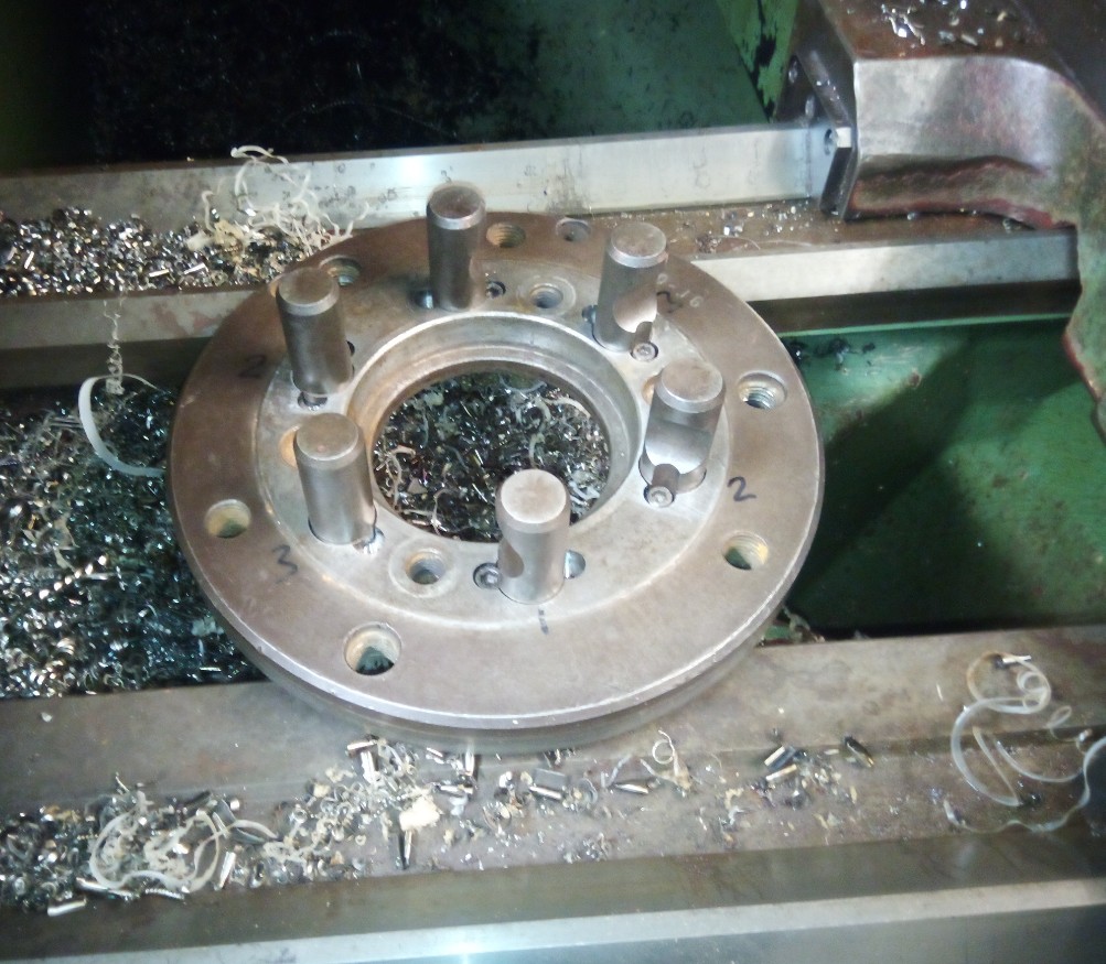

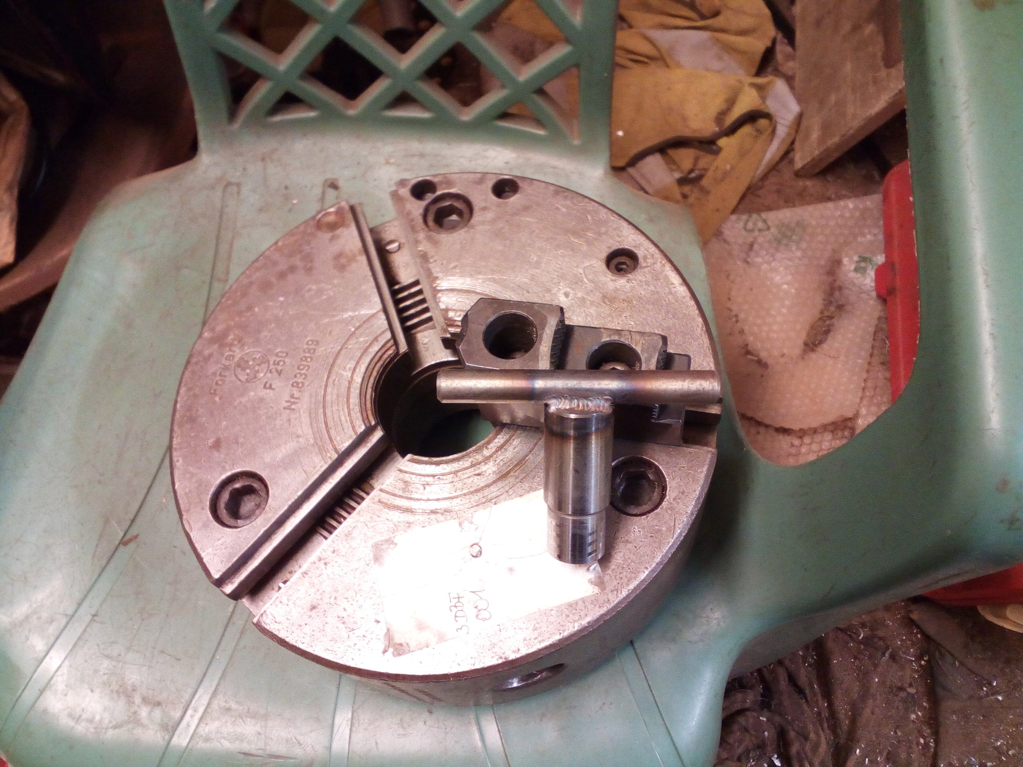

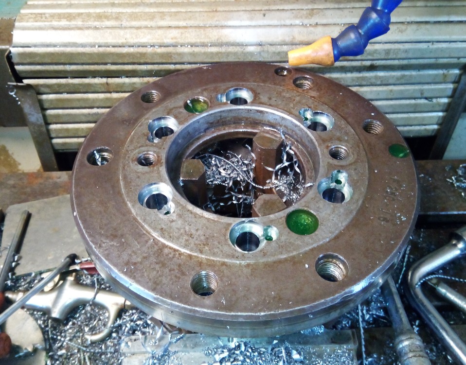

Got the video of the chuck uploaded, showing the key I made.
About 8 full turns of the key for full in or out of the jaws, once released you slide to the position you want and then adjust back with the key to tighten. Makes life very easy as you do not have problems with swarf clogging the scroll and you can adjust from full dia to min dia way quicker than you could with a conventional scroll chuck.
When the teeth are released from the jaws you slide them but there is a pall that clicks into the teeth so they automatically align where the chucks teeth will be when you re-engage them. So basically all that is needed is that you push each jaw in to the same position, much like you would do on a standard serrated jaw hydraulic chuck for a CNC.How do you get it centralised??
You got itLocking screw holes are the wrong side of the pins?
