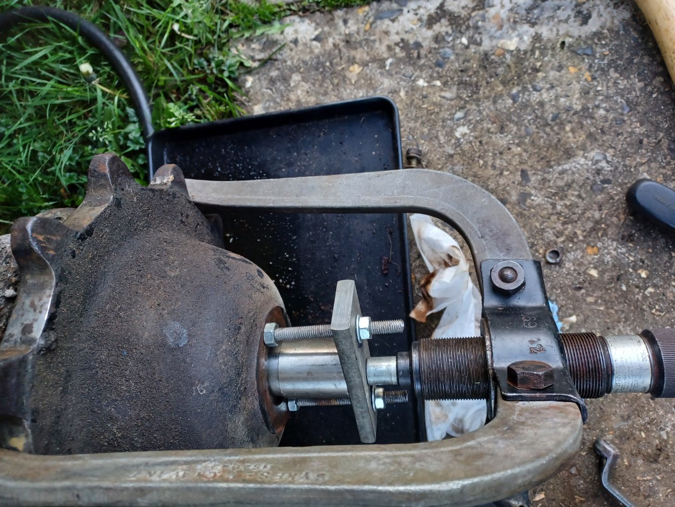

pretty sure its the end of the shaft as its threaded right to the endThat isn't a washer is it?
Theres very little room behind but could 15mm in there should be strongI like the plate behind method at this point as I can't see all the details.
What's you thoughts on explosives ?
Yeah im starting to think 10 tons is nowhere near enough and wondering if its worth the effort for a tiny drip , not even sure i will be able to easily get at the seal. Just dont want to give in without a fightI don't know about your one but normally those sprockets are on tapered shafts. Which is good and bad news, the good news is that once cracked it will just fall off and the bad news it takes an incredible amount of pressure to crack them.
If you start using heat, your going to have to continue until it's off, as the heat may very well smoke the seal.Yeah im starting to think 10 tons is nowhere near enough and wondering if its worth the effort for a tiny drip , not even sure i will be able to easily get at the seal. Just dont want to give in without a fight
I found it works well on ATMsTell me more of this explosive method have you a proven record of success ?![]()
It would have been handy if they had drilled the holes straight but im not kidding one is about 15 degrees off parallel , I guess i could make a big slide hammer to suit . Do you think it would do any harm to the motor though ?Looking at the sprocket I would say the two bolt holes for the retaining plate are used to bolt a gurt slide hammer to. Shock can sometimes be better than grunt.

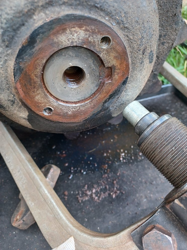

heres a better view , keyed shaft no idea if parallel 99.9% sure it will be
im going to get some of this on the way home as its supposed to be very good , cheapest place to get was WickesThe rust does look very dry, I'm sure you have been, but soak with more penetrating oil and mildly tapping it both directions will help to break up any rust bond.
Get the puller back on, then also mildly tapping sprocket from the back at several points.
It looks to me just a shaft with a keyway could be tapered but I dont think it is at the key looks parallel tooWorth running a wire brush around the whole area - it might hilight if it's a single piece or if there's a collar / locking ring that's not obvious?
Any info online / on owners forums / workshop manuals that show how it goes together & comes apart?
Clutches on many classic brit bikes are on a tapered shaft.
To remove them the extractor screws onto the clutch (sprocket in your case) and a central bolt tightens onto the shaft.
Put the extractor under tension then use a medium (or FBH) hammer on the central bolt to shock the clutch off the taper.
Try something similar on yours, find or make an extractor (use the tapped threads or a 3 legged puller etc) to put tension on the assembly then use various hammers to shock it loose.
Actually yeah I do have an air hammer pretty sure it has an attachment like a hammer too so worth a thoughtdo you have an air hammer? opr maybe a big sds drill?
it's surprising how effective an air hammer is (no idea if an SDS will do much but it's worth a try)
if you're feeling strong a decent big hammer in each hand battering both sides at the same time works well

Design your puller to keep the ram's seal far enough away....Heat will also have the seal out of the SP ram on the puller being used in the picture - don't ask me how I know this...!![]()
