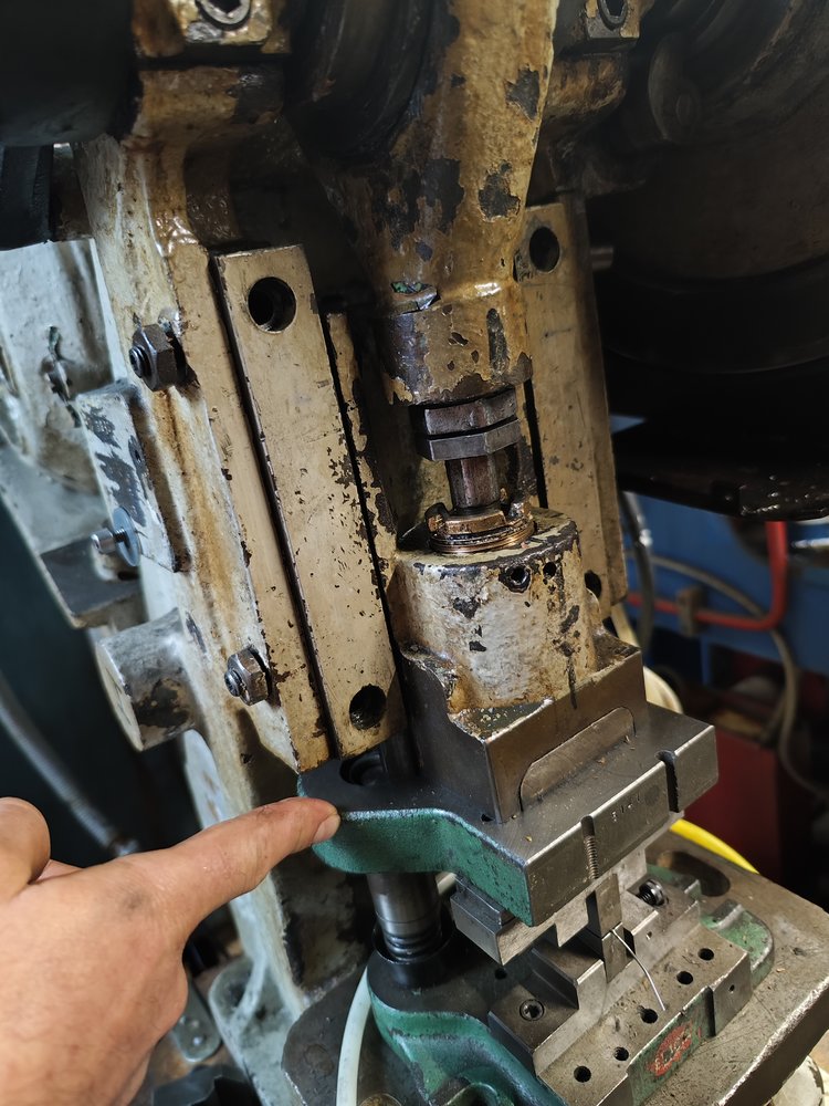

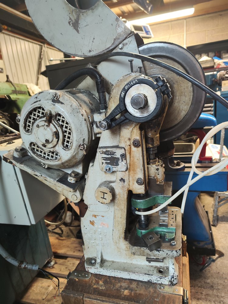

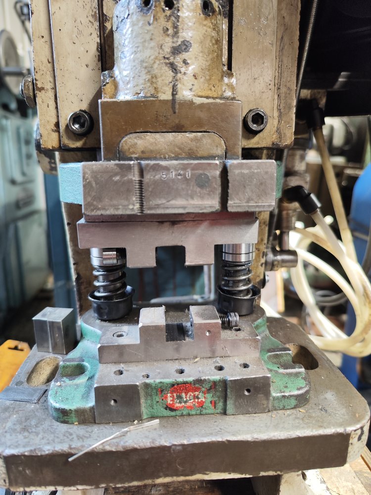

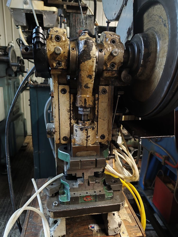

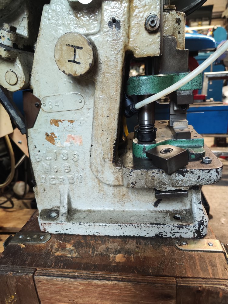

I recently bought a little punch press / power press / mechanical press and it appears that it is stuck in the downward position. The flywheel cannot be turned in the direction it needs to turn. The flywheel can be turned backwards, but it appears that a clutch type of device just makes the flywheel 'freewheel' backwards so it does not relieve the pressure/make the ram go upwards.
It is a Bliss No 8 benchtop press.
It will be worth saying that I know very little about punch/mechanical presses but it appears to me that it is stuck in the downward position with a lot of force.
Things I have tried:

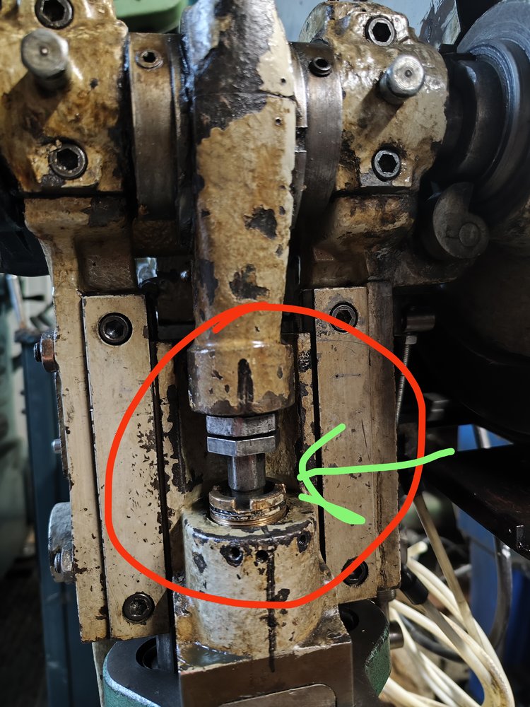

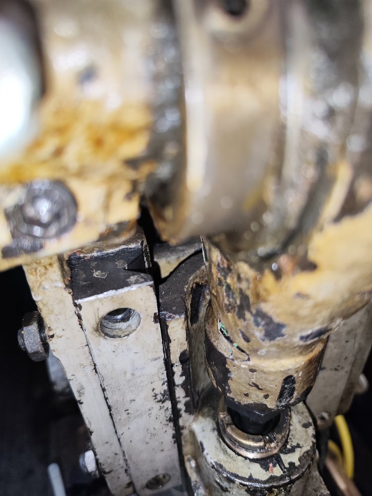

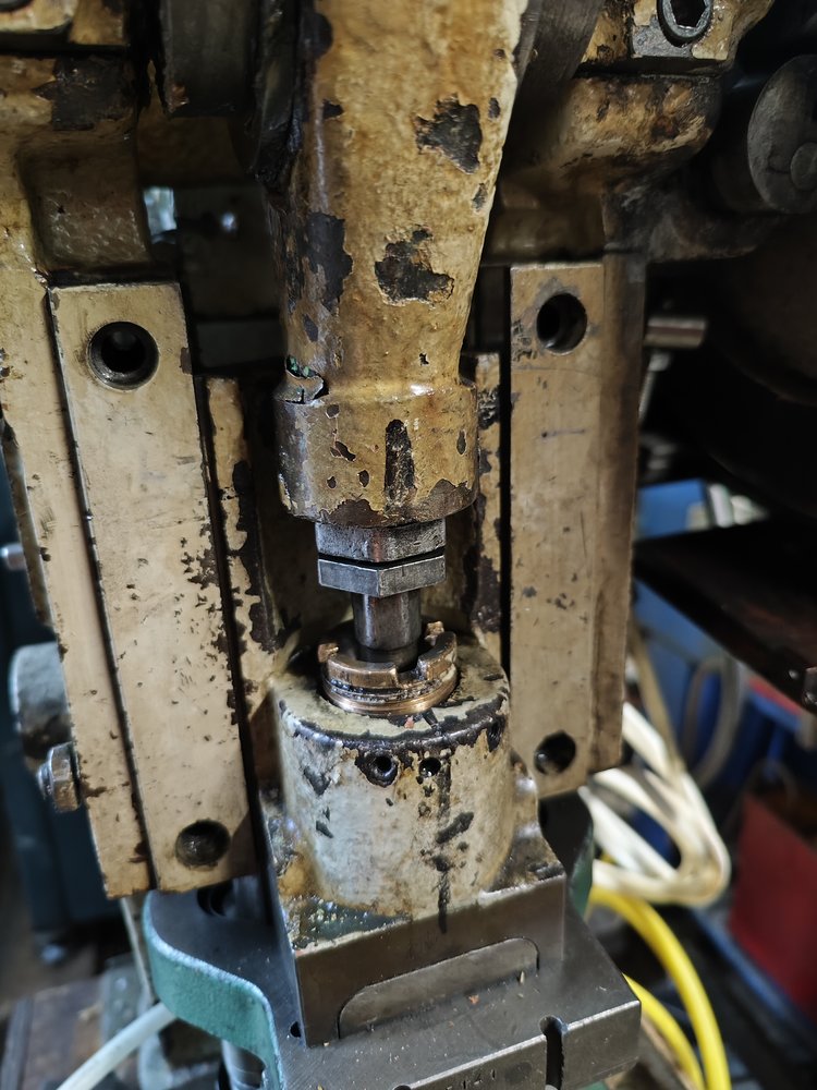

1. I loosened the two nuts (circled in red) which I assume are used to hold the depth adjuster 'bolt' (green arrow pointing to it).
I managed to get the two nuts loosened but the depth adjuster bolt is solid, probably due to all the pressure still going through it.

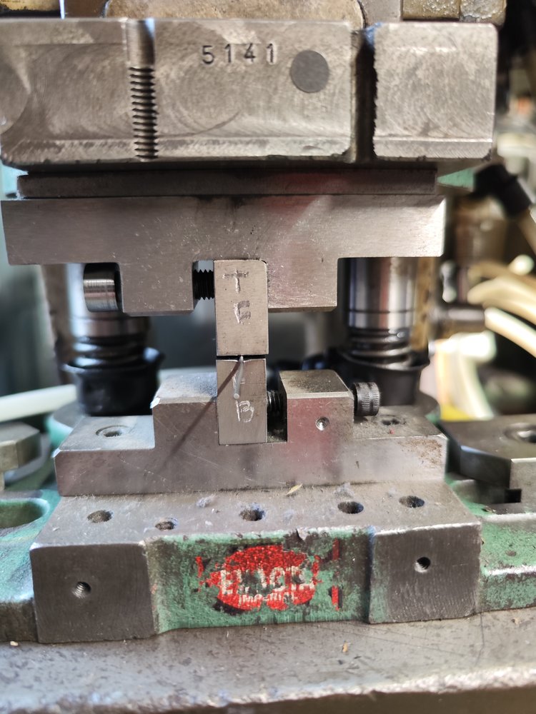

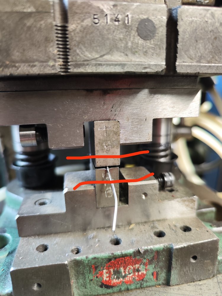

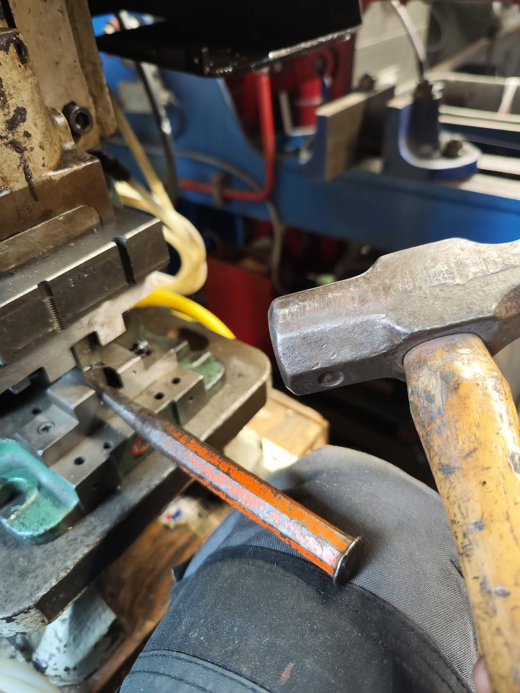

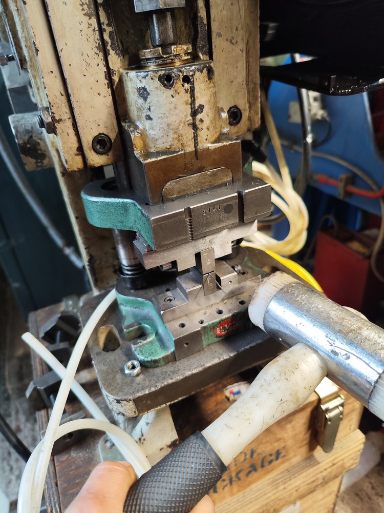

2. I loosened the bottom tool holder / jig or whatever it is called and tried to knock it out with a hammer to relieve the pressure. Once again, it is solid due to the pressure holding it down.
@Arc Tourist and @Beanwood have some experience with presses. Maybe you guys have a few ideas?
What can I try next?
