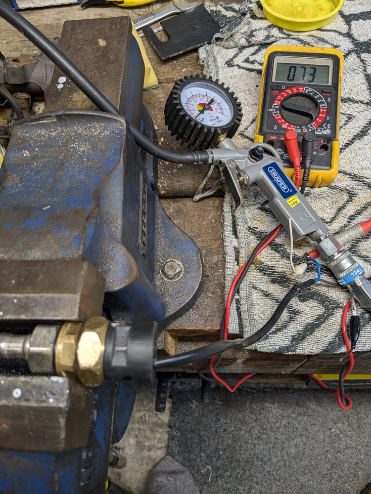

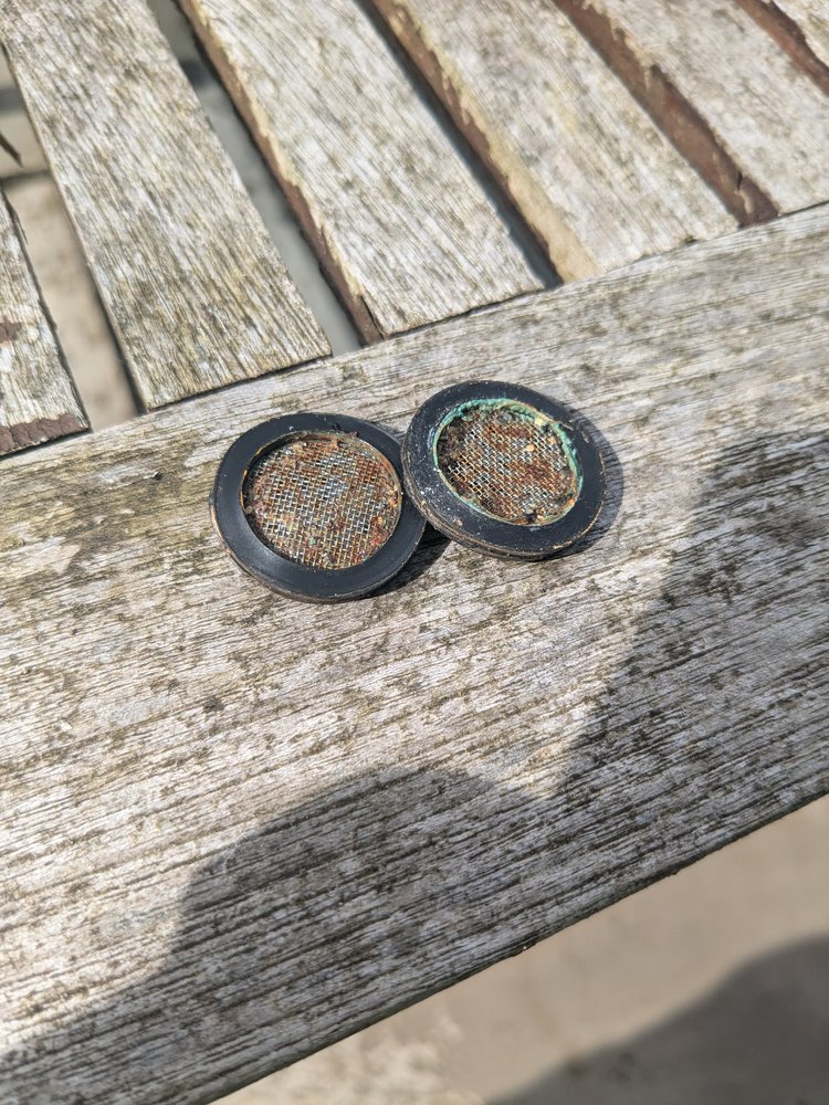

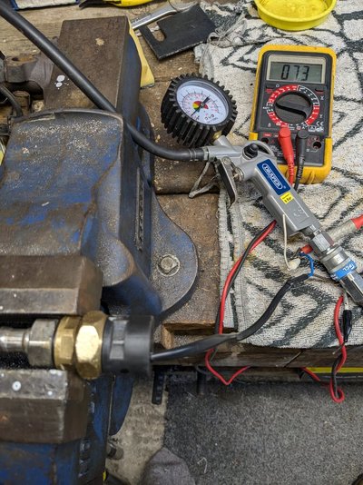

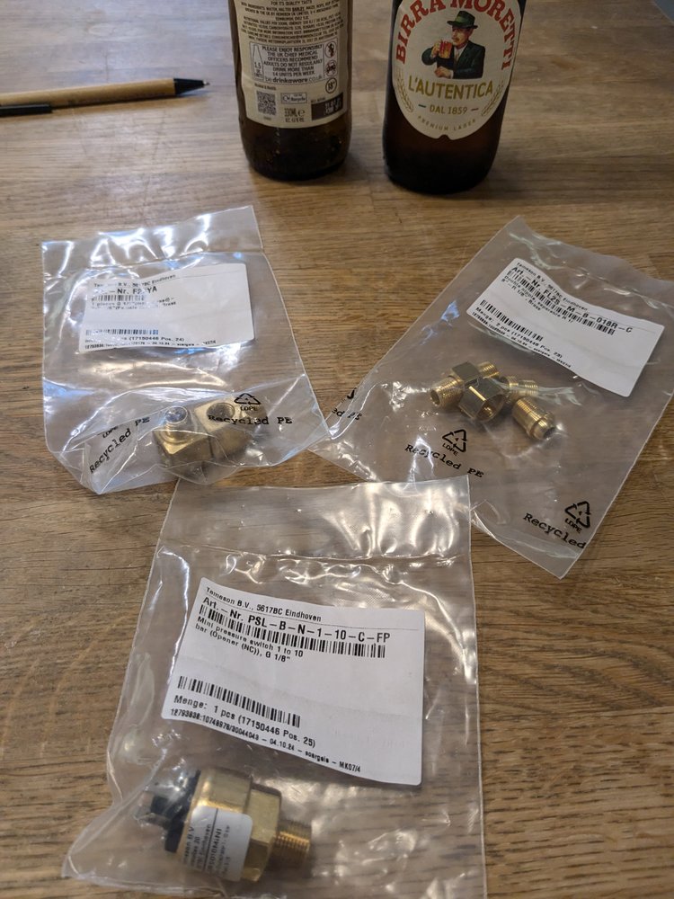

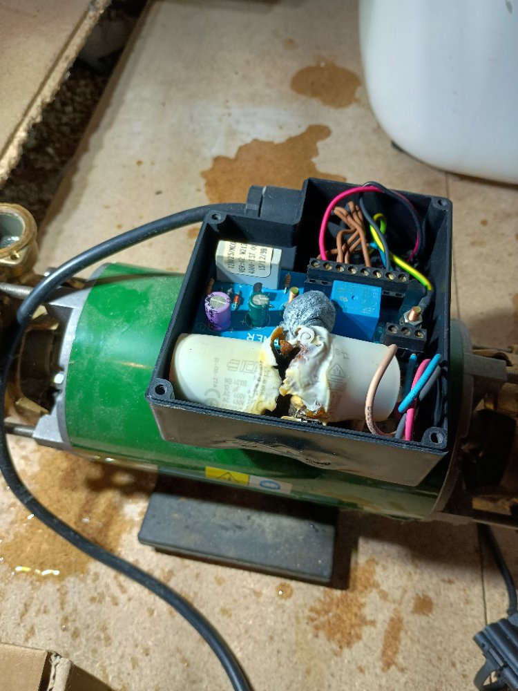

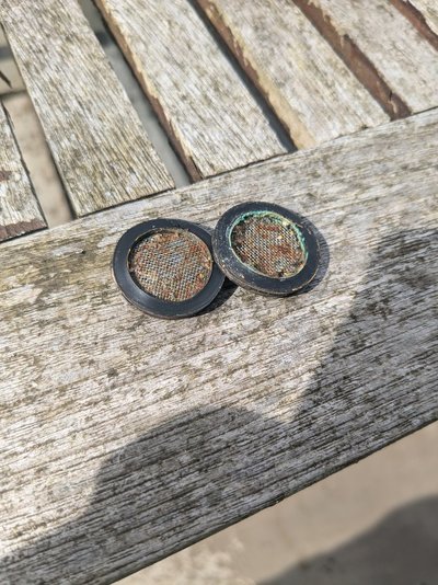

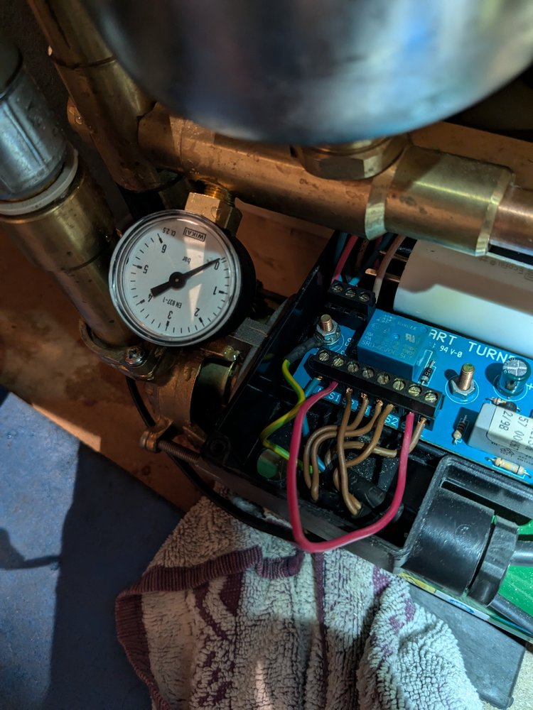

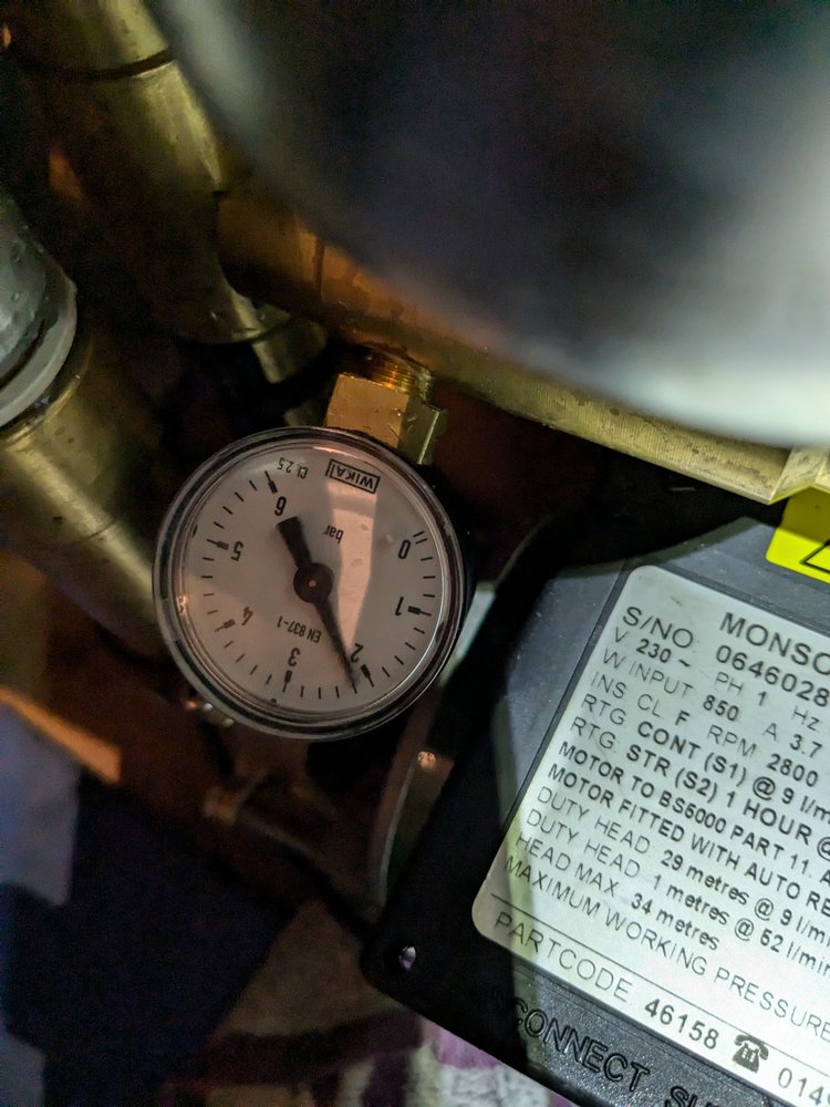

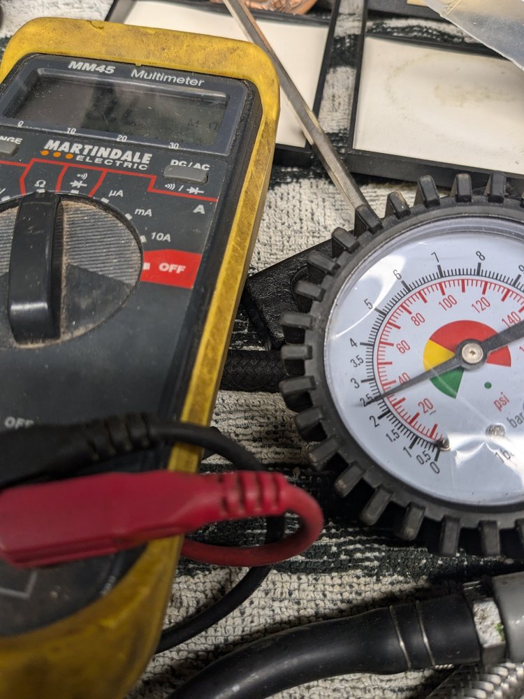

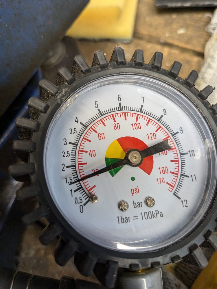

My 3.0 bar negative head shower pump is playing silly ****'s and I can't work out what's wrong with it.
I switched it off and isolated the water to finish some pipework off and when I turned it back on it was dead.
I ended up with a second hand pcb and it will now just cycle off and on when the shower is turned on.
It stays off when the shower is off so it's not leaking pipework etc.
The reed switches are ok, the pressure vessel seems ok and is pumped up to 0.9 bar, could it be a dodgy pressure switch?
They ain't cheap so I don't want to replace it if it's not that!
Help!!!
