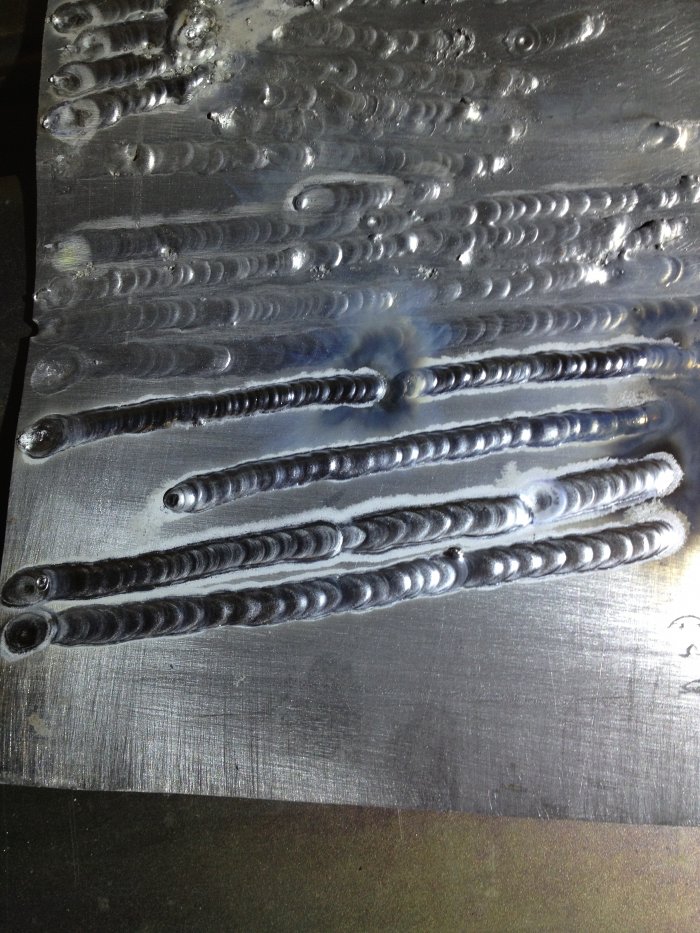

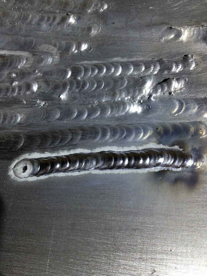

well i just pretty much went through the 3mm at 100amps ahha with a 2.4 on footpedal
on 3mm alloy i am set at 145amp max to start with but i use a foot pedal and allways have to start backing off after a few inches of welding.
when the aluminium gets hot you will find you have to back of on the pedal.
