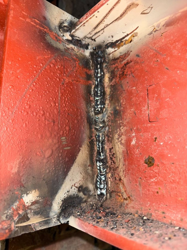

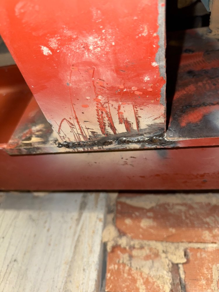

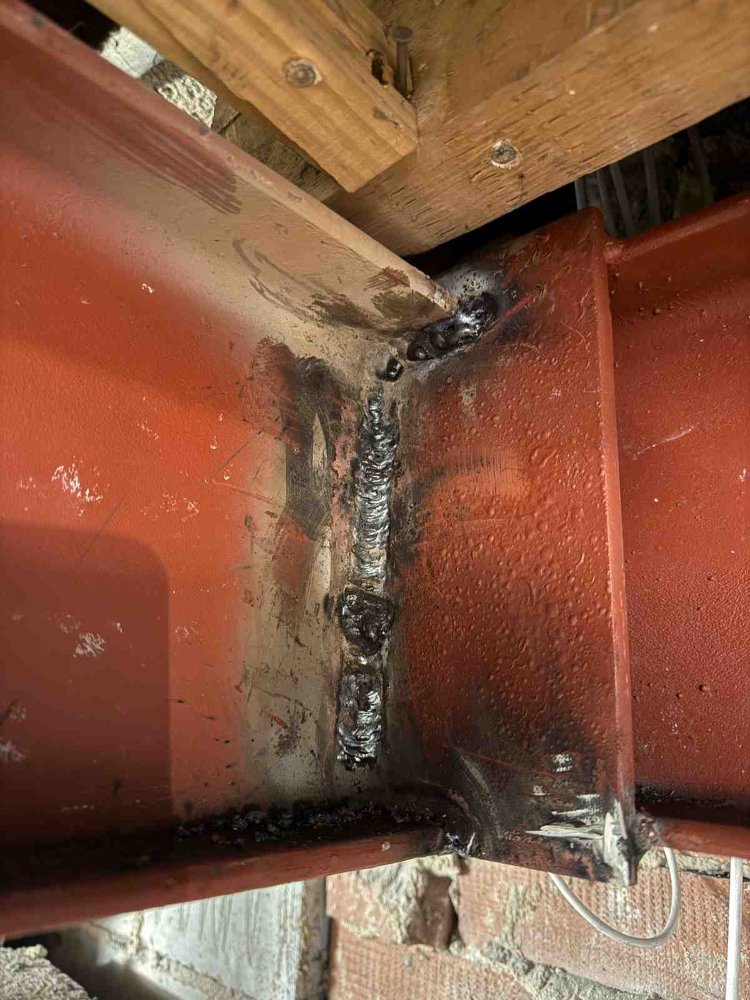

I’m new here and would really appreciate some urgent advice regarding a residential weld on my project.

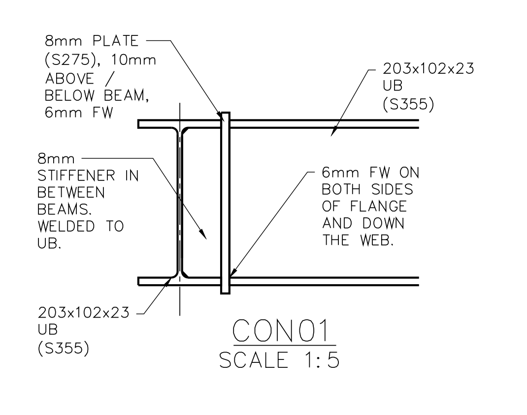

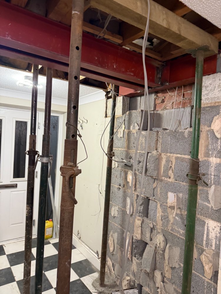

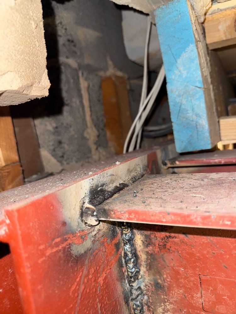

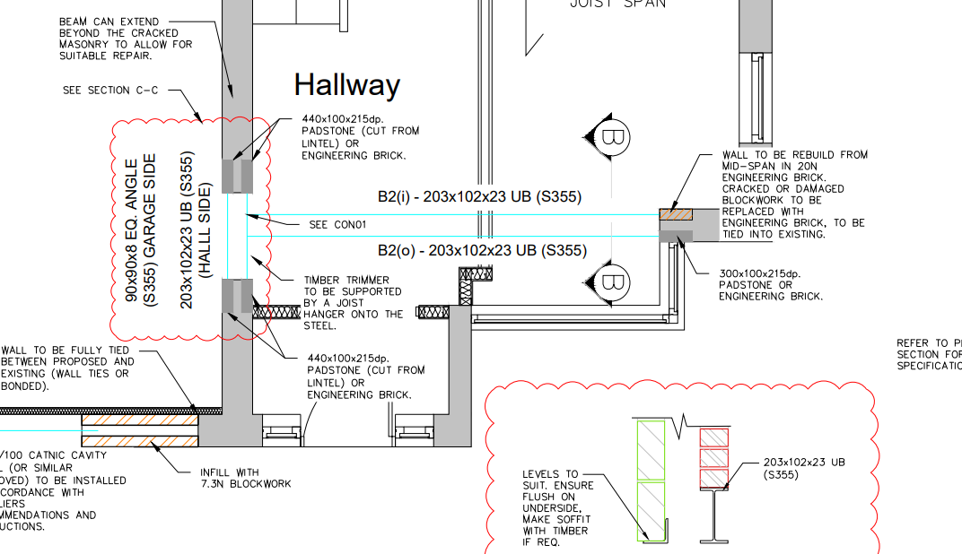

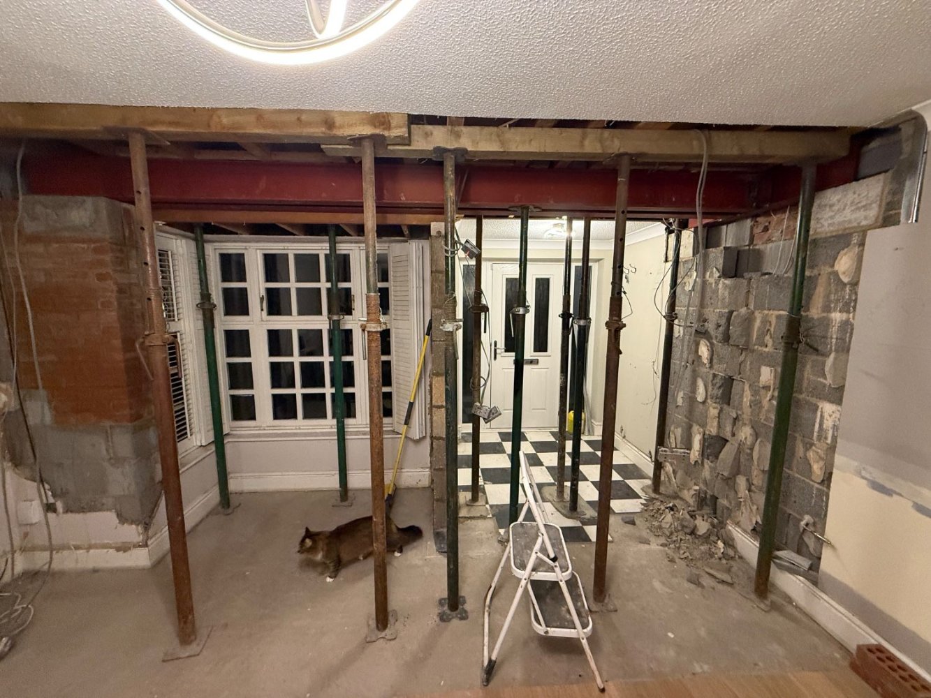

Our builder, who has been good up to now - brought in a welder today to join two steel beams (one supporting the inner leaf and one supporting the outer leaf) onto another steel using a welded plate. I’ve attached some photos along with the structural engineer’s details for reference.
Unfortunately, I wasn’t home when the welder arrived; otherwise, I would have asked questions on the spot. Now that I’ve seen it, I’m concerned about the quality of the work and its structural integrity - although I’m not a welding expert, something doesn’t look right to me. The Acrow props are still in place.
My main concerns are:

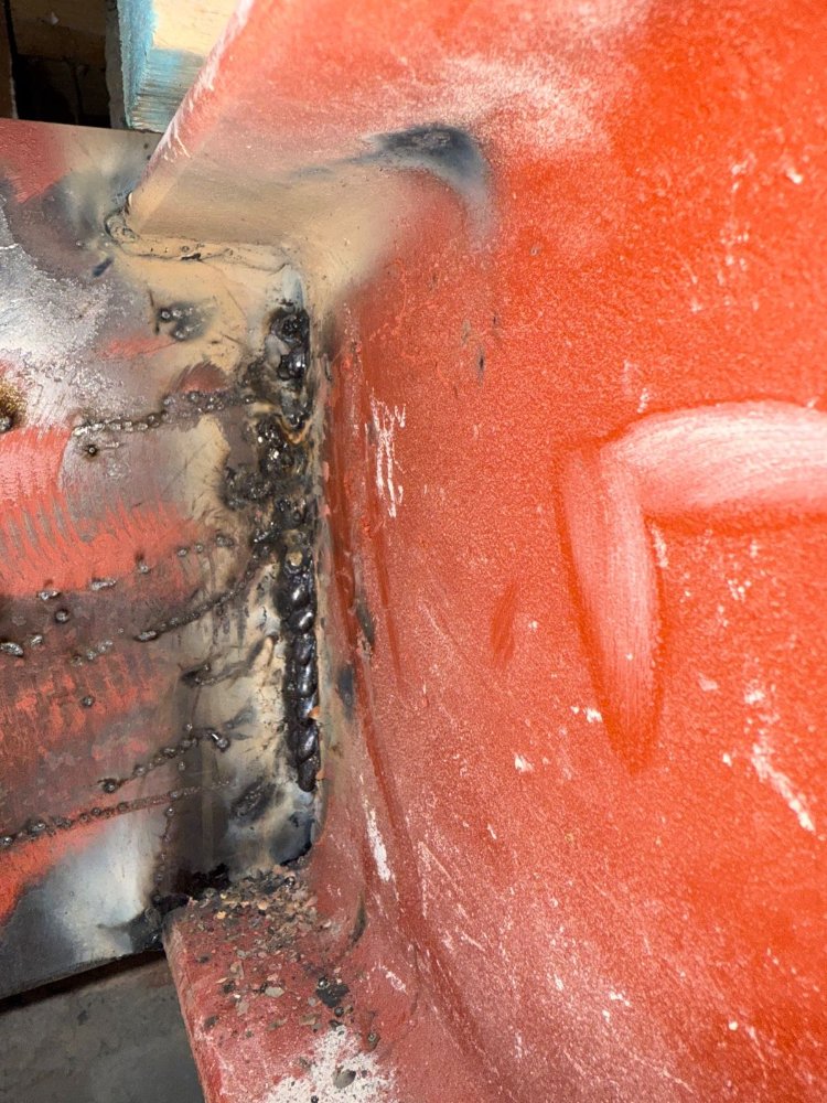

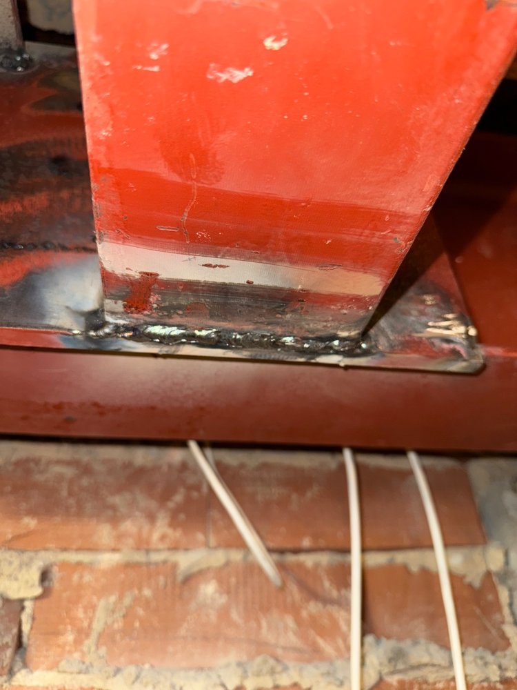

- The welder hasn’t ground the primer at all. I’m worried about how well a fillet weld can bond through primer, and whether porosity could be an issue now that the paint has been burnt off instead of properly cleaned.
- Some welds appear to be “sitting on top” of the steel rather than blending into it, which makes me question the fusion.
- There’s a huge amount of spatter. It almost looks like someone practising, which doesn’t fill me with confidence about the welder’s competence.
- The structural engineer specified 6mm fillet welds, but what’s been done looks very inconsistent.
Before I push this further, I’d really value the opinion of people who actually know what they’re looking at. Do I have legitimate cause for concern here?
