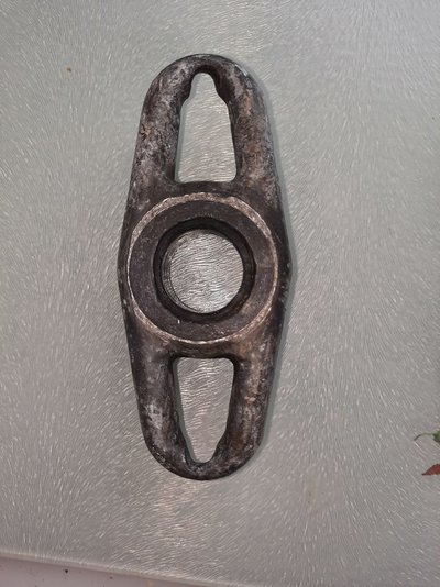

Hello, I'm investigating the possibility of casting an unavailable piece for my boat that is badly worn. I've cast a few simple things and thought it might be simple enough to cast at home. It's about 100cm/4" and takes a fair amount of load, especially when the boom slams across accidentally... Any suggestions as to a suitable grade of aluminium to cast - AB2 has been suggested in an international group I'm in and it looks suitable, but as always, sourcing small quantities is not so easy (ebay usually delivers - at a premium) - any idea where I could try for a kilo or two of something suitable? Many thanks.
