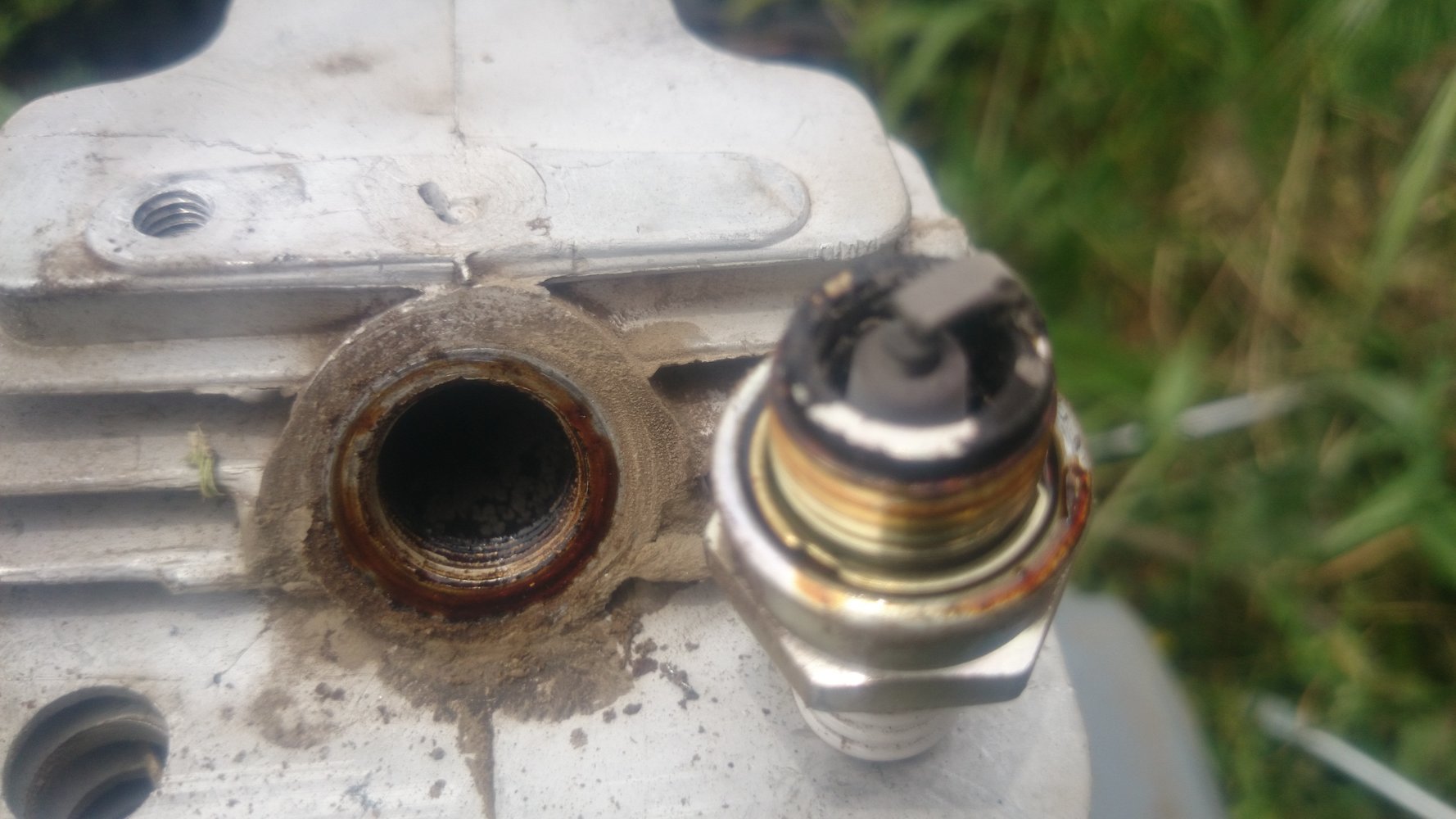

Just a thought: On more than one occasion, I found that the gasket sealing the primer bulb had shrunk, creating an air leak that prevented the primer bulb from pulling enough vacuum to refill the bulb with fuel when released. In my cases, a new gasket fixed the primer problem. Of course, there could be other issues as well.The primer bulb is fine. It has a plastic disc thing that covers the air intake for a choke; flip it closed for choke and open for run.
If the mixture is correct it should be a milk chocolate light brown .Here's the spark plug:
There are a couple of tiny scratches I can see in the cylinder opposite the exhaust port but it all looks pretty good to my uninformed eye.
I gave the exhaust a good soak and shake in some diesel/petrol mix I happen to have a few gallons of. A little muck came out, though rather less than I expected after the hours this thing has done. It's firing now cold with no choke but not quite catching. I think you're right, @DAPPH, it's a bit rich really. I'll give the filter foam another swill out in hot water with a dash of fairy to make sure there's no oil in it.
Looks more gray to me.If the mixture is correct it should be a milk chocolate light brown .

It's full of oily gungy black soot inside the threaded neck , cleaning the air filter will have helped for a while ,hence the weaker burn greyish colour present .Looks more gray to me.
