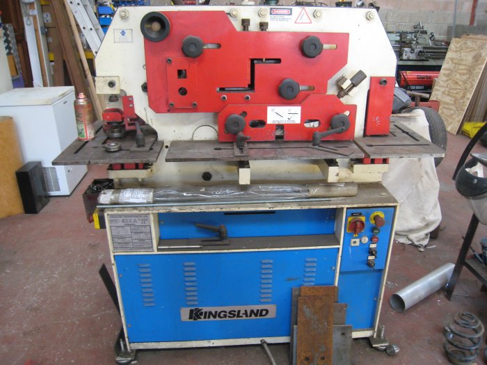

Hi,
Nice work! sorry for the newbie question....but how did you make the little threads and how did you cut the holes and shape the sheet steel like that?
Cheers,
Paul.
Hi Paul, By the little threads do you mean the boss that the fairing fixes too? if so I cut a piece of 12mm round bar and bored a hole 5mm and tapped it M6, the holes in the sheet I punched then cut the main shape with a guillotine and shaped the rest with a fibre disc in the grinder. "a wee bit of sheet metal milling as I call it!"
