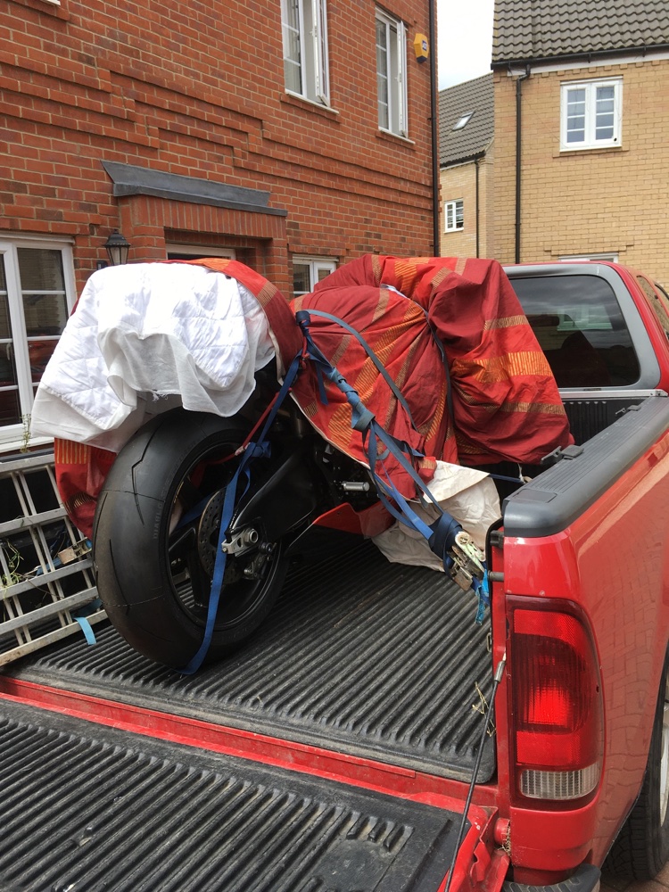

Ive always used two straps at the front, usually around the forkleg just above the lowest front yoke if I can get to it without plastics in the way and pulled down to load the front suspension up, front wheel hoop anchored the van but more recently overcentre front wheel hoop as pete describes, and a strap over the rear with a bit of padding & over the seat to lightly load the back down against the rear suspension. The very best van I owned for bike moving was a mk1 T35 renault master van, as it was fwd, the rear floor was so low it was at ankle height and you could just use a bit of wood or even bounce the front wheel in.
I have a bike trailer because my current master is rwd and too high to load easily into, and its a similar story on the trailer securing things, with the usual expectation the straps will want to flail round and need tying up before they flap and damage the bike in motion. It has a pivot on the axle and the drawbar stays on the car/van and the front of the trailer unbolts from the drawbar so that you undo a pin at the front and the whole trailer tips into a ramp you just wheel the bike up, and it rocks overcentre as you push and goes level so no need for a loading ramp.
Any real distance and I'd rather be loading into a box trailer or even better a van because you can periodically glance at it for reassurance. I lost a exhaust silencer once going 400km in a day with the open trailer, and various small bits, I tend to take mirrors etc off on a long trip now if its on the open trailer. I get the sensation a bike's getting shook round more on bumps and sproingy trailer suspension that it was designed for too.
