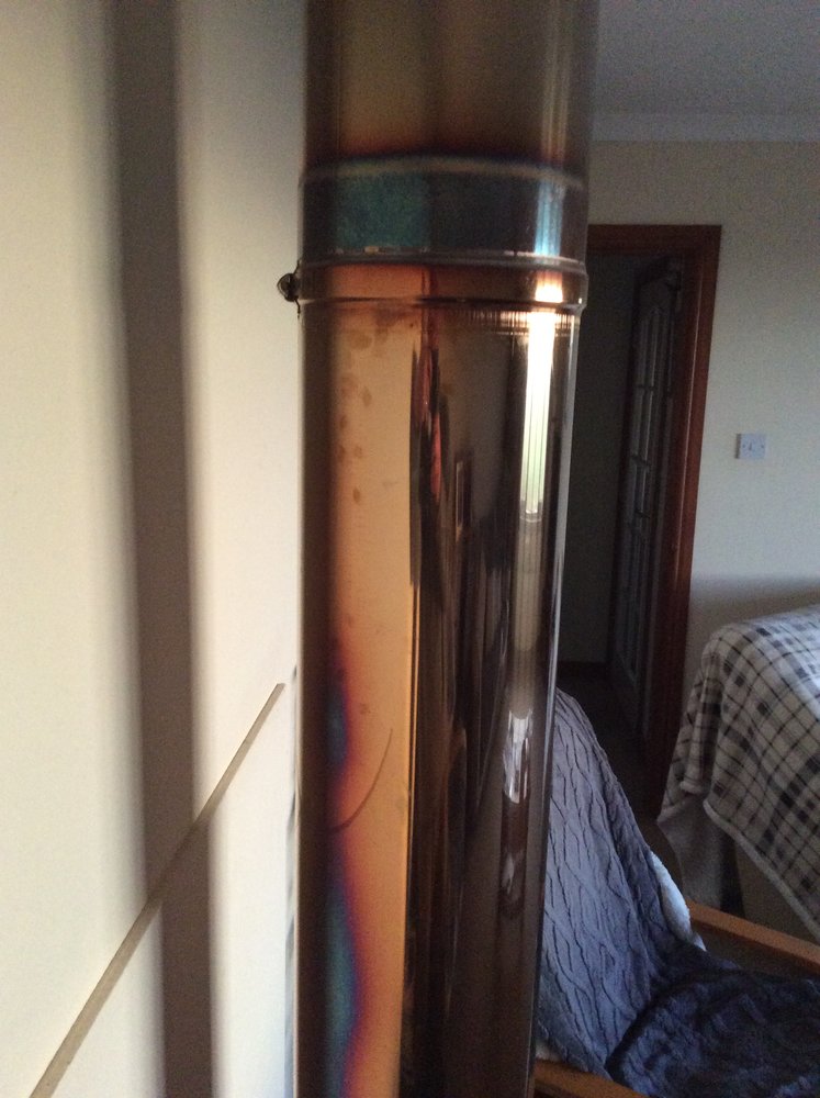

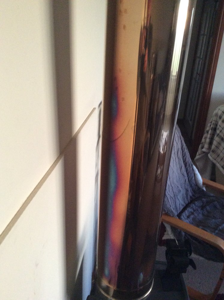

I used single skin in the living room and swapped to twin wall below the ceiling. Never thought of checking it for failure in the loft!This is what happens when your double skinned flue pipe fails. Luckily Mrs Micmac was only burning old knitting wool and was present when it happened. The ones in the loft appear to be ok. Will take it all down and inspect the insides of all the pipes. Won’t be until the warmer weather comes though

How did it fail ?
From what I understand not all twin wall is equal and some of the quality varies quite a bit!Haven’t taken it to bits yet, I presume the internal wall has failed somehow. When you prod the external wall of the flue pipe there is no resistance.

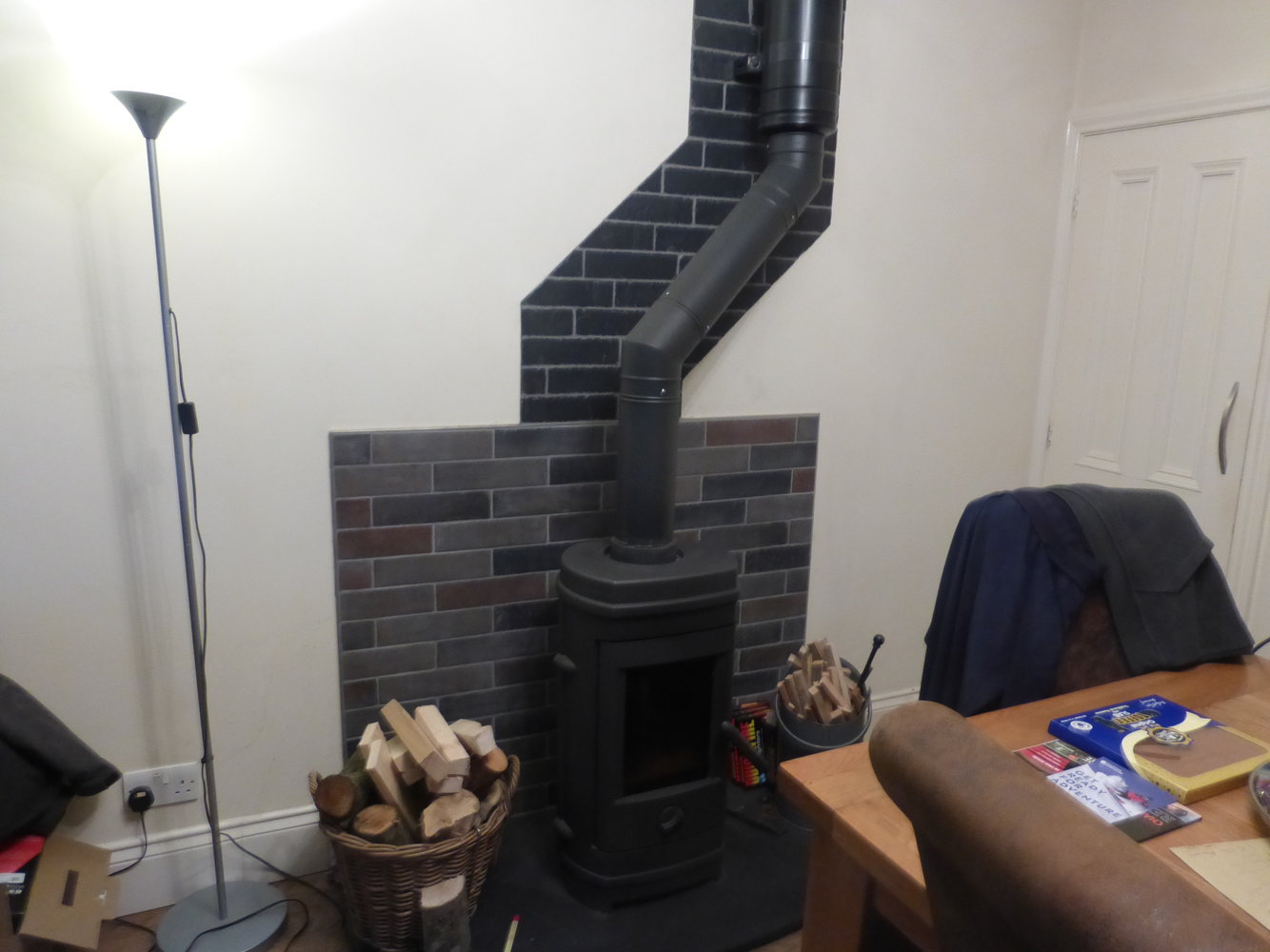

wasn't so keen at first ,but looks quiet industrial
I dont recall the make, it was nearly 20 years ago it was installed. I do remember the flue wasn’t cheapFrom what I understand not all twin wall is equal and some of the quality varies quite a bit!

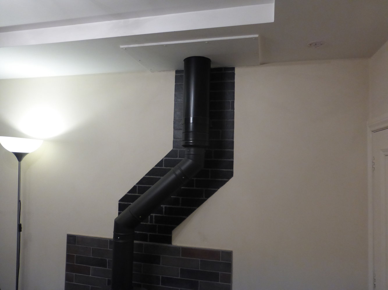

I like the black flue and the tiles behind. SWMBO mentioned something like what you have have thereI've a Scania silencer sat at the top mine as the flue goes through a void between the ceiling and the old chimney breast above
regs said it had to be sowasn't so keen at first ,but looks quiet industrial
now I rarely give it a second thought . The fires an Invicta and was bigger than needed but what the hell .
Thats probably why its failed then!I dont recall the make, it was nearly 20 years ago it was installed. I do remember the flue wasn’t cheap
I just checked my receipt email for mine and is Schiedel. been in for 18 years without issue, though single wall first section.Thats probably why its failed then!
