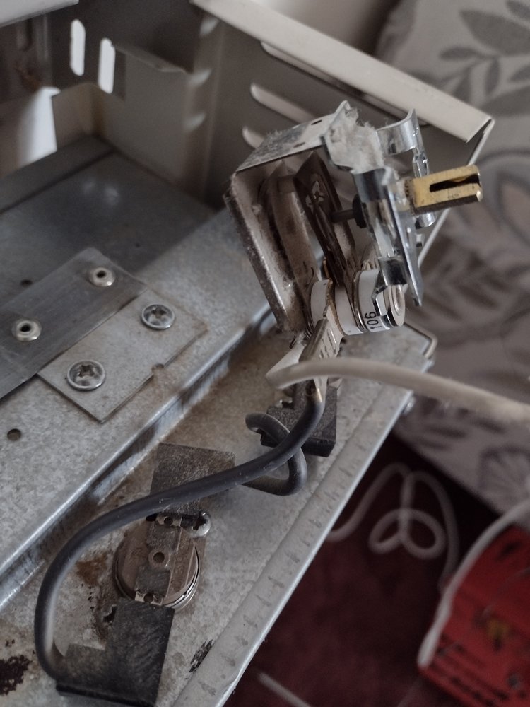

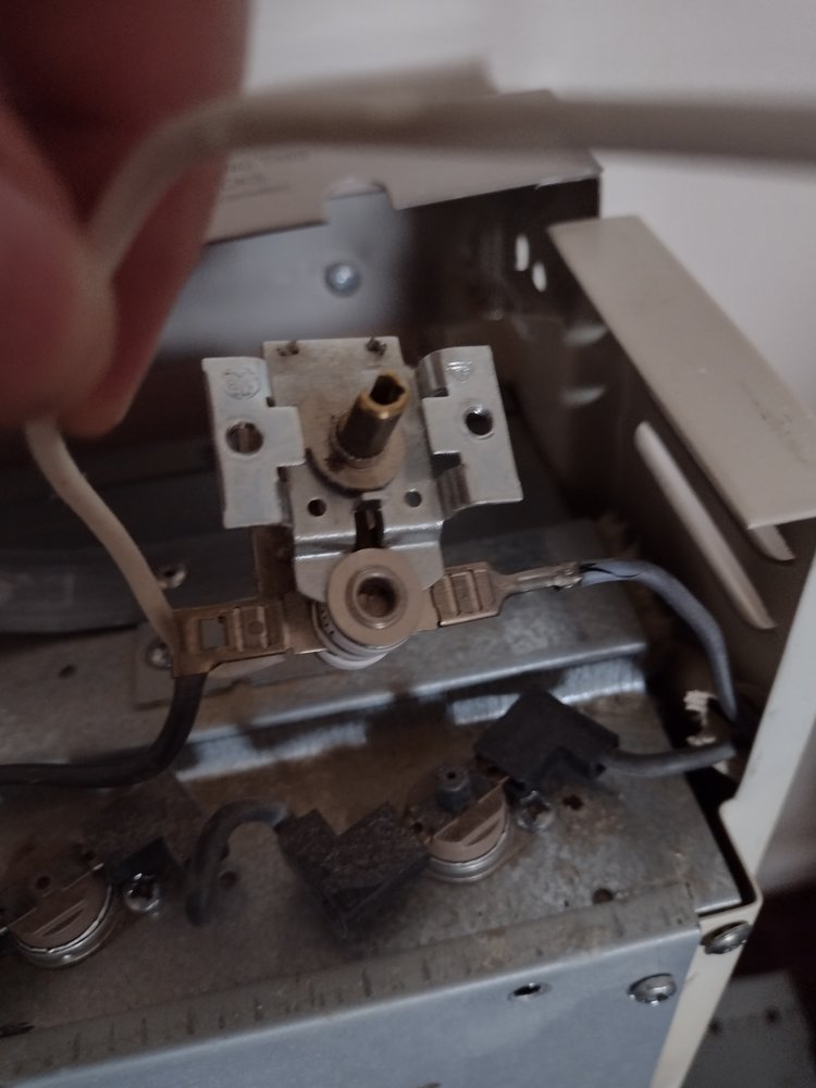

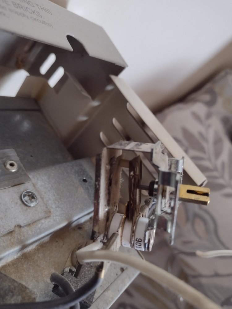

yeah just joined the black wires togehter? mines a bit fierce full on ...if i could do high /low it would do4 out of my 6 have that part missing now! they are just on full!
very low heat regardless of input settingis it not working at all?
I had to bypass a thermal fuse in one of mine too. but they all still work a year onvery low heat regardless of input setting
im gonna "hotwire" to the normal mains later to confirm all elements are ok , i think they are
no it would be off completlywouldnt work at all if the thermal fuse had gone right?
