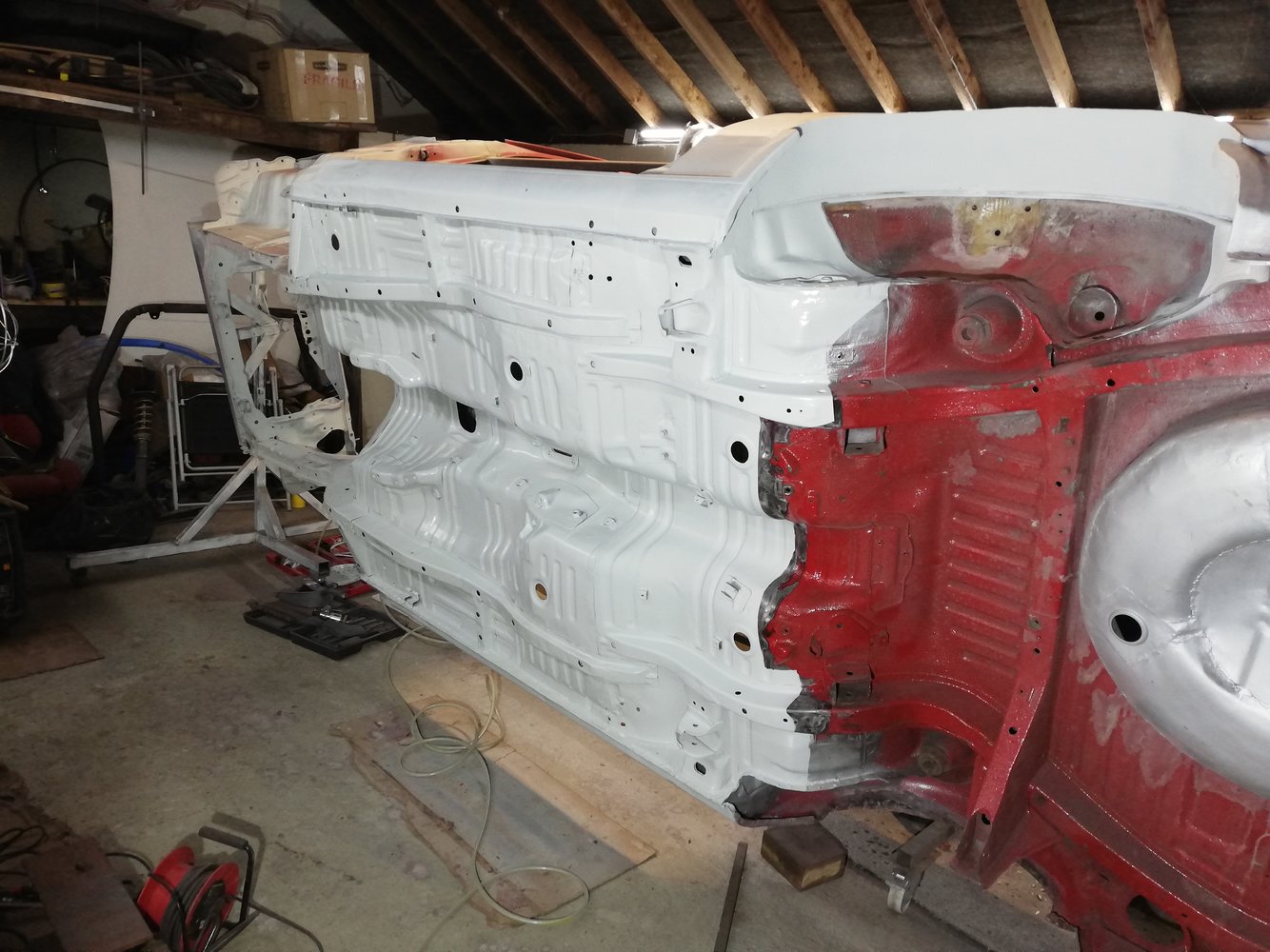

Is stone-chipping the whole of the underside of a car restoration the preferred route? I was considering just doing the inner arches and inner wing areas in Gravitex as they would be subjected to the brunt of anything that is flung off the wheels.... Maybe also the lowest edges of the sills. I believe Gravitex can be over painted with body colour...
As regards noise, dynamax or similar on the inside of the floor/quarters/doors etc.
Any pointers would help please, as I've just done the underside in 2k epoxy and am still within the window for over painting without having to scuff it up first
