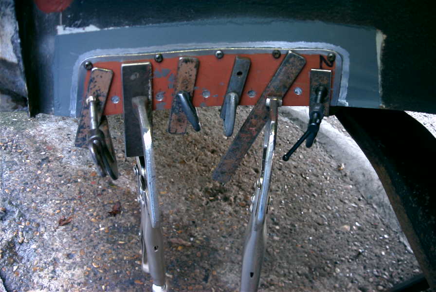

Red Astra by ben a.k.a me, on FlickrFair comment...
- It's an old Cebora Turbo 130, modded to a Eurotorch
- 0.6 wire
- Hobbyweld 5 welding gas
- welder is set to the minimum setting which is 30A I think
- the wire speed is about a 3rd of the way up which works fine on the bench (at least). I'm a bit unsure about setting wire speed thb
That's pretty much as good as it gets in the car plating game. I've had lots of practice at this as my welding career started around the same time the caverliers, astras and escorts were beginning to rot. I can tell you though I have packed that game in and I don't miss it one bit. I've only got the scars to show for it as it never gets any more fun.I use 0.8mm wire in my rtech 180, I used to use a snap on 130 (same as yours I think) same sort of gas I think but mine is from Adams. I tend to always use 0.8mm as I found out with most small welders it feeds so much better, even on 0.6mm I tended not to use the min setting as you have to spend too long in one spot forming a puddle.
I'm certainly not the neatest welder, but the pen is decent and with a grind it soon clears up.

I use .8 for most thingsI'm prepared to give 0.8 a bash. So why does everywhere (else) say "use 0.6 for cars" then?

At least just doing for a hobby you can walk away from it when you've had enough, I wont touch a paid for car welding job at all now.Well it's a preference thing really and both have there pros and cons. .6 requires a lower current to burn with which is always a plus on thin stuff but the down side is the thinner you go the less fill your putting in and in that game you do need to get that fill in quick and release before the point of burn through. .8 gives that extra fill needed but like I say it's needs a little more current to weld it. Me personally I get on best with .6 for thin car plating keeping the current as low as I can and spotting it in. But you should now try .8 as your not getting on with .6 this may work for you.I'm prepared to give 0.8 a bash. So why does everywhere (else) say "use 0.6 for cars" then?

Update - I now have 0.8 installed (after also needing to replace the spool assembly on the Cebora welder - another story). Somewhat counter intuitively it's much nicer to weld with. I have the wire speed almost down as far as it will go but, so far, it doesn't blow holes anything like as easily. Weird![]()
