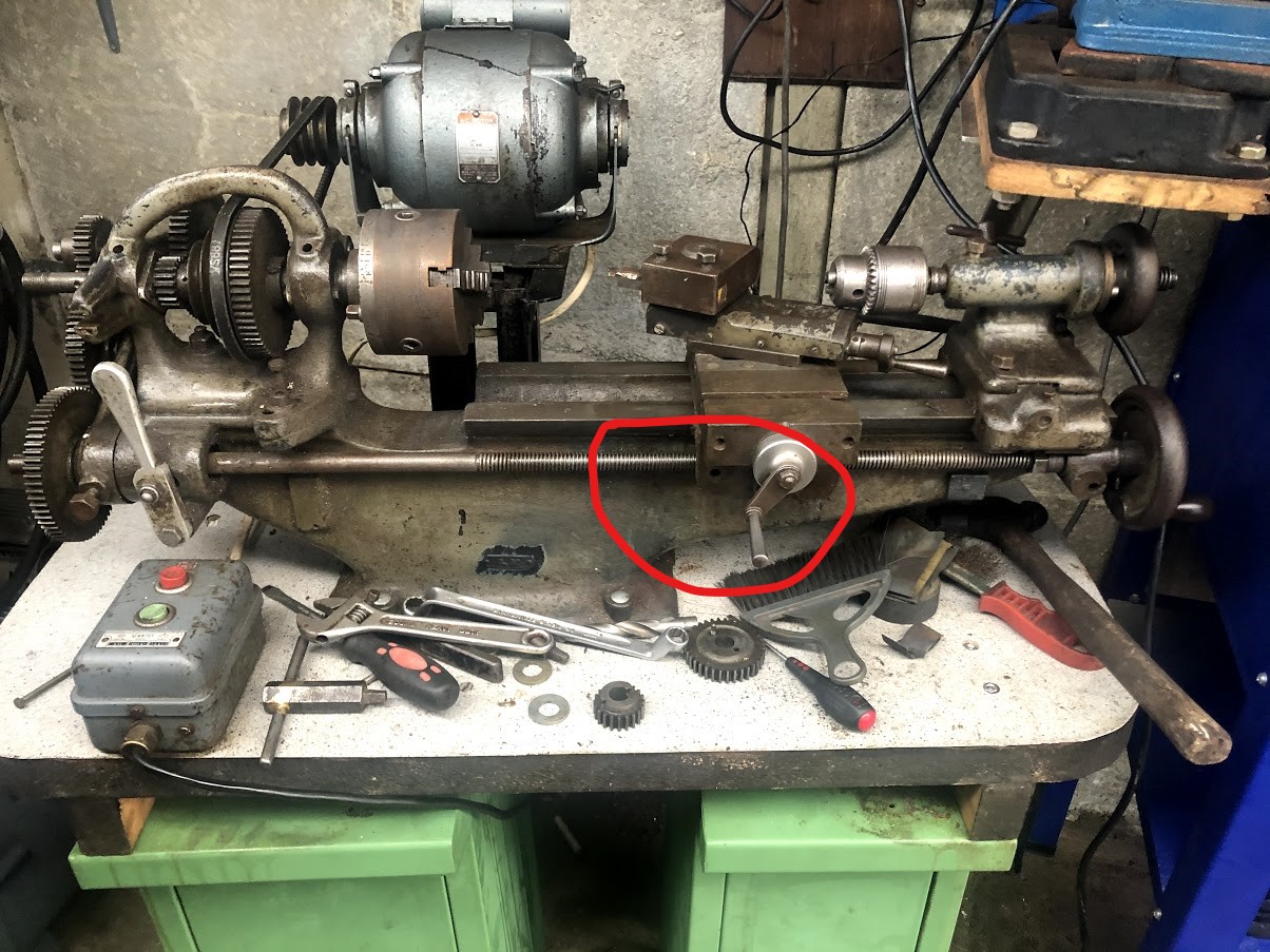

Hang on you've got a gear mounted to the back-gear sliding shaft end. You don't put a gear on there...
He is not the first one to do it on a Drummond though. See:
https://forum.canadianwoodworking.c...ge-power-tools/1302879-drummond-b-restoration
It may have been a modification that someone invented. The standard fine feeds on the data plate above are not all that fine so the additional reduction, if it could be made to work, would certainly have benefits.
