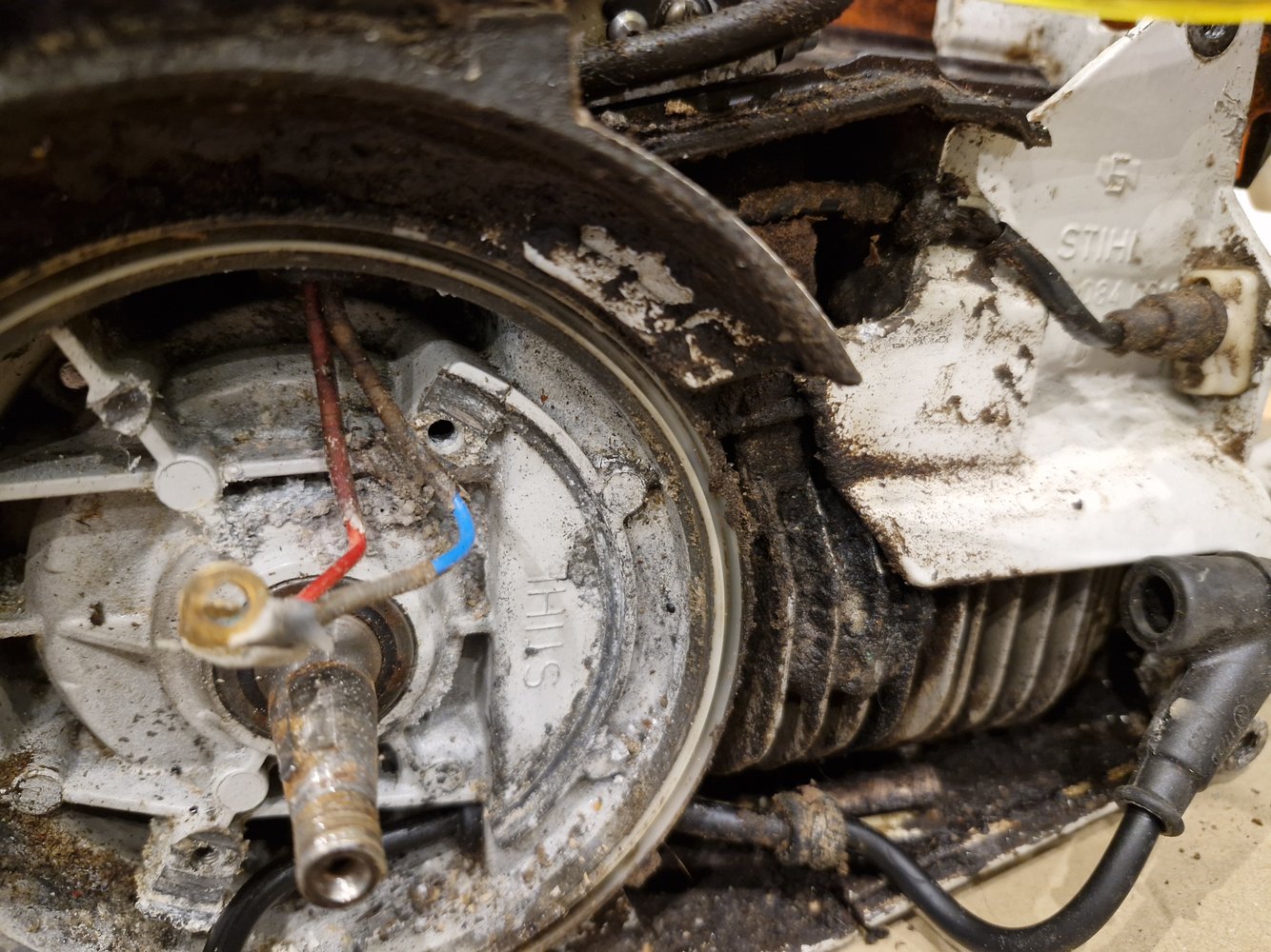

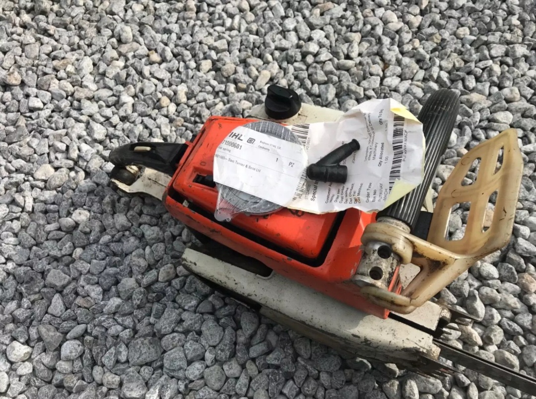

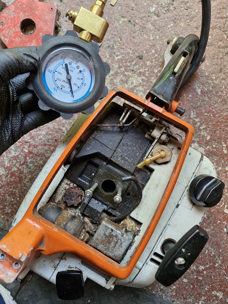

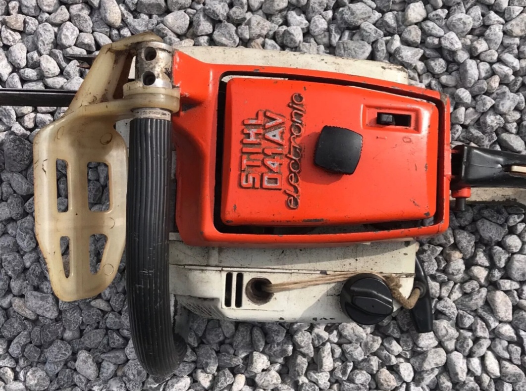

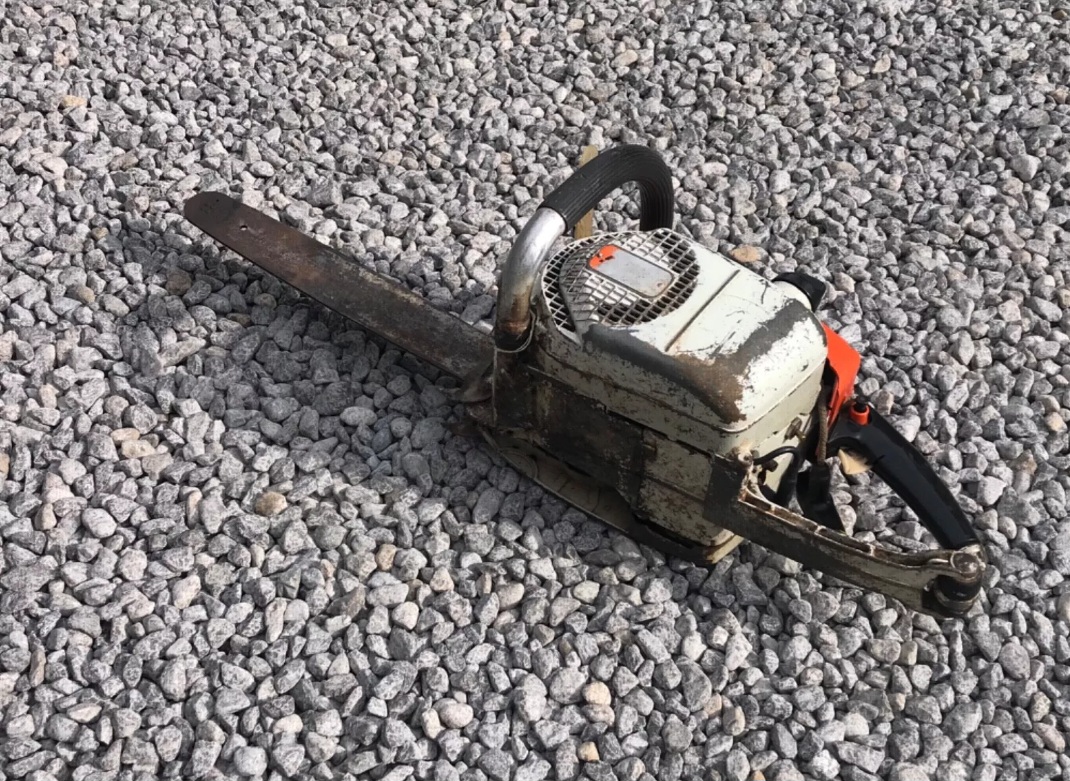

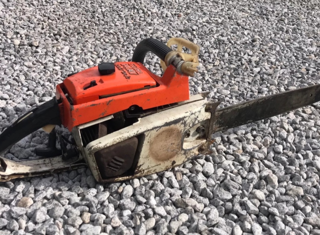

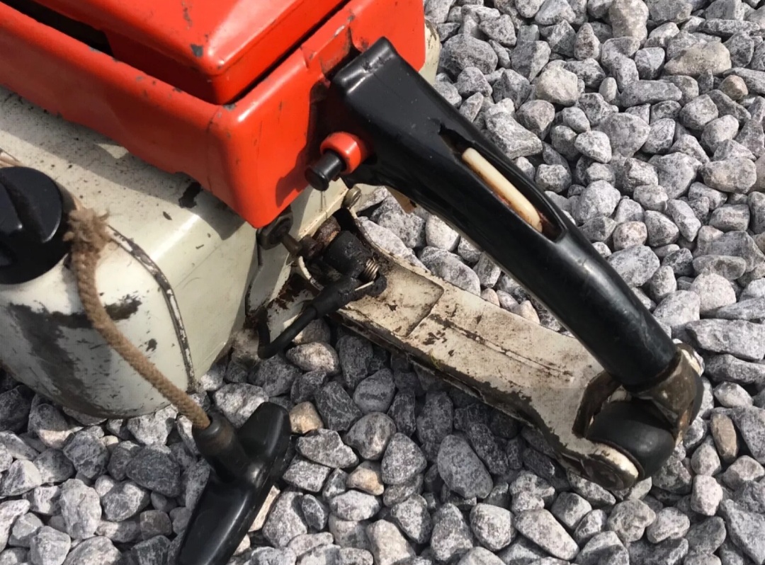

Admittedly it's not actually a barn find but that sounds much more interesting than an ebay spares or repair purchase under the influence of alcohol as I plunge ever deeper into the Stihl rabbit hole.
This saw is an early 041av Electronic saw which turned up yesterday and clearly has been laying unused for many years.
The plan is to just see if I can get it running first and us it some on my current tree cutting project at my house.

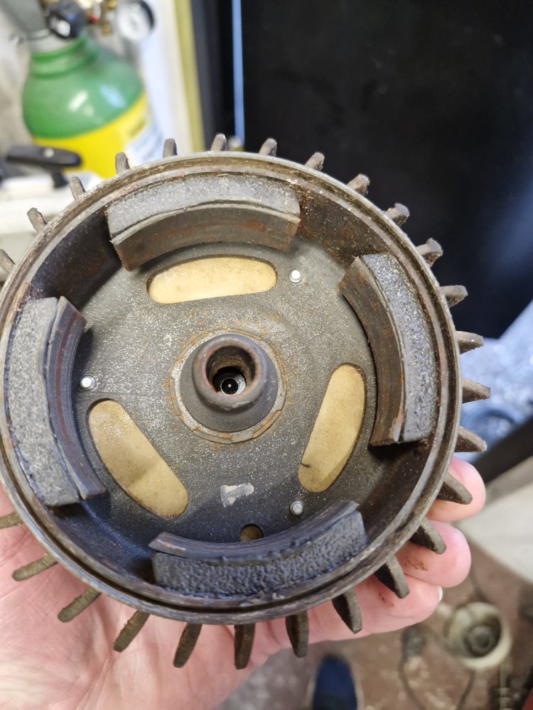

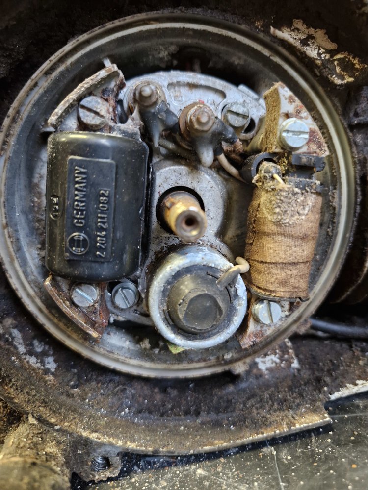

So last night I determined the engine isn't seized and the new recoil spring supplied was quite useless as it is incorrect and the original wasn't broken anyway.

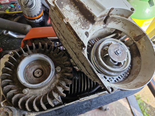

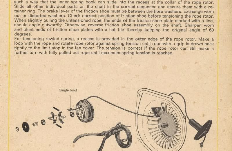

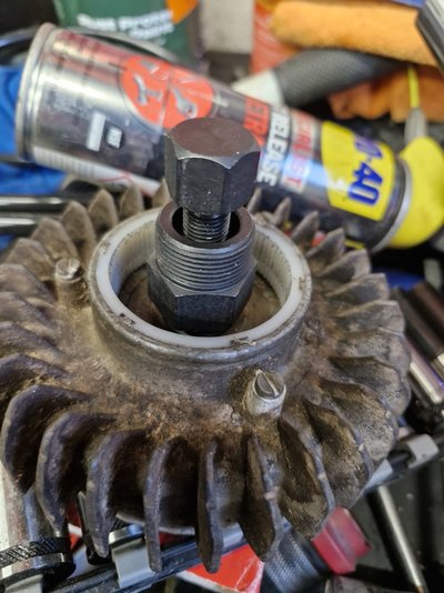

Replacing the pull cord appears simple in principle but it's the early style friction plate recoil on this saw:

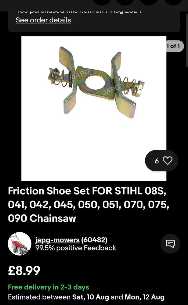

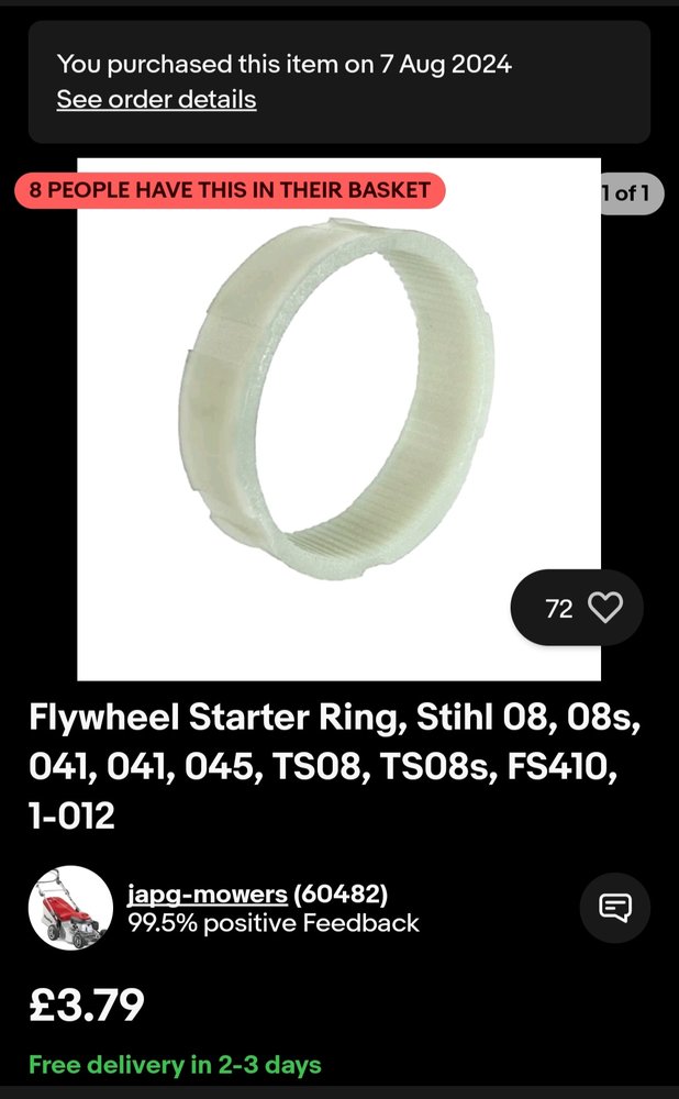

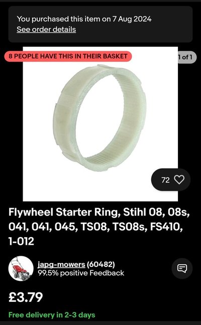

Long story short I got it to turn over a couple of times before the recoil slipped again so I ordered new inexpensive replacement parts from ebay will be here in a few days.
