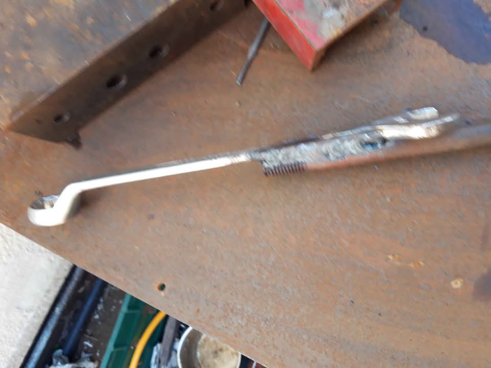

I am, yes.I take it your stick welding it ?
I'm not sure how to weld a pad then grind it back to use as a heat source to be honest. Also, I have no equipment to heat the plate with at the moment.is access the reason for not preheat, or lack of gas? could you weld a pad, then quickly grind it back, using that as a heat source?
i think the suggestion is to weld the joint, then quickly grind it out and weld it agian while its still hot...may require welding smaller sections at a timeI'm not sure how to weld a pad then grind it back to use as a heat source to be honest. Also, I have no equipment to heat the plate with at the moment.
mild steel plate 30mm thick. I have tried 3.2mm rods, mild steel - non-marked, and esab 6013 3.2mm mild steel.Shouldn't crack. What rods are you using?
What is the plate...........mild steel or something a bit more exotic?
is the plate clean , plenty of amps , your not picking up dirt ,. is there porosity , is the weld cracking down the center or are you maybe getting cold lapmild steel plate 30mm thick. I have tried 3.2mm rods, mild steel - non-marked, and esab 6013 3.2mm mild steel.
At what ampage?mild steel plate 30mm thick. I have tried 3.2mm rods, mild steel - non-marked, and esab 6013 3.2mm mild steel.
4mm rods around 150-160 amps concentrate most of the heat on the 30mm and flick the puddle onto the 8mm channel, you shouldn't get cracking weld.
It's going to be a 30mm plate in the nearest scrap yard with 50 hammer dents in it if I can't get these welds sorted!Its going to be a great high quality welding bench product.
Listen pal. I just welded a friggin steel bar to a spanner. Surely that puts me in the top tier of welders round here.Its going to be a great high quality welding bench product.
