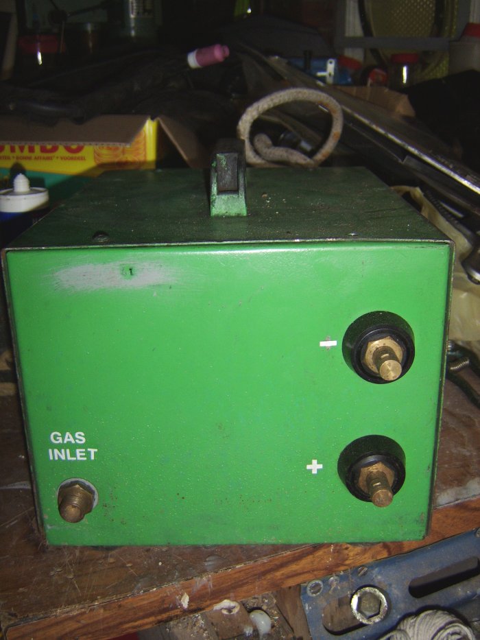

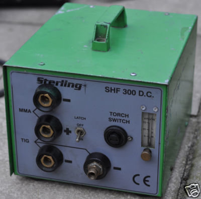

. connected it to the DC output of the stick/ tig set at work (need to build a AC-DC converter for my old air cooled). connections are as followes the inputs on the frount take the output from the welder keep poliraty correct. The torch connects through the gas coupling to the - and the earth connects to the +. the latch switch controls wheather its push and hold to work or push on then push off. the gas connects to the back and there is a flow gauge on the unit.
