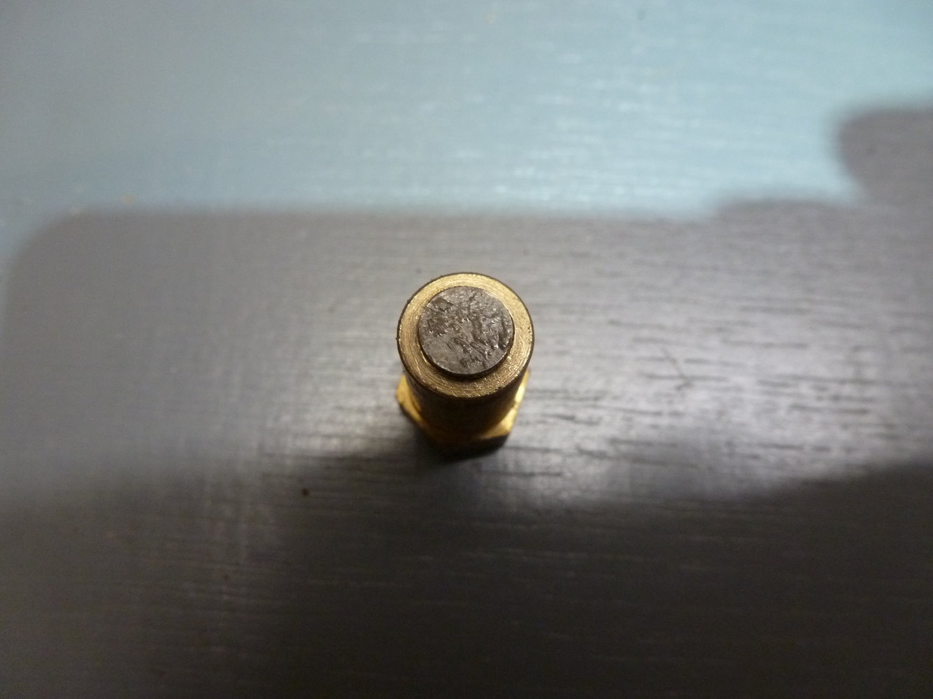

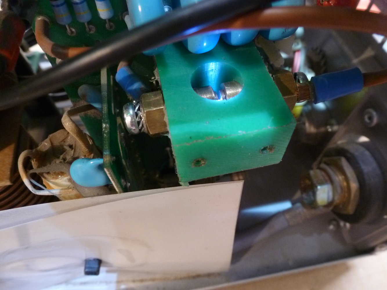

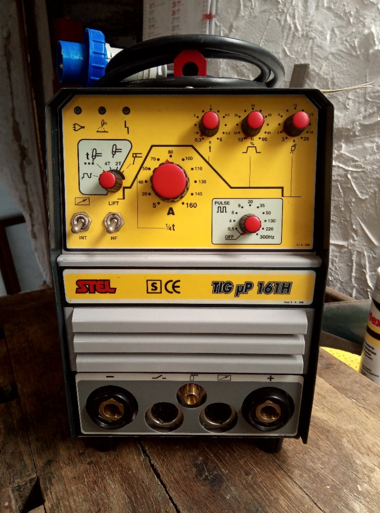

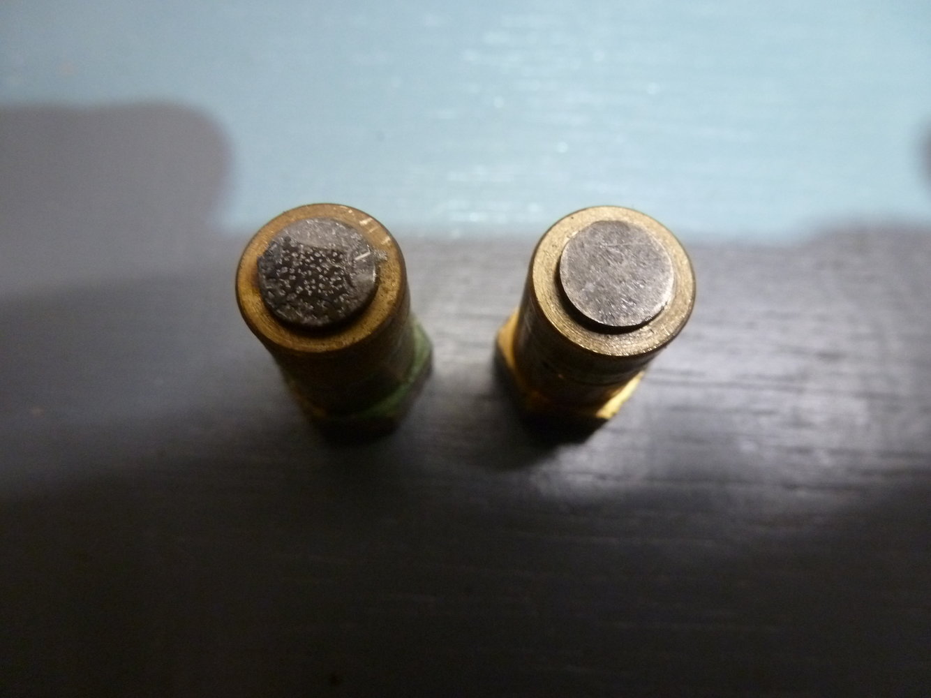

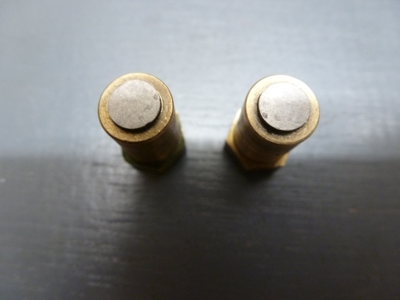

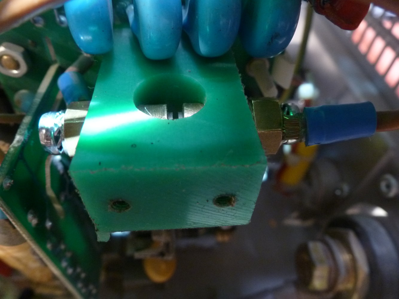

R RichKem New Member Messages 23 Location UK May 31, 2022 #1 A small procedure which will be of interest to anyone who owns a Stel TIG uP 161H welder. 1. Remove the HF electrodes 2. Clean the electrodes with a small file or wet & dry paper 3. Re-install the electrodes 4. Set the HF electrode gap to 0.9mm
