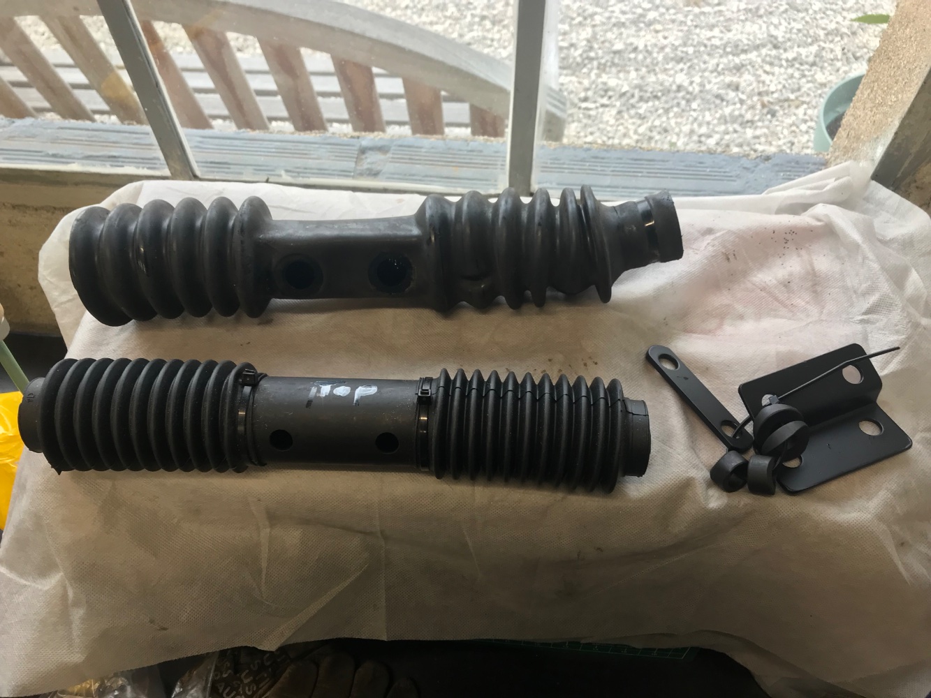

Lengthen the slot, machine it parallel, then make a rectangular spacer giving more contact area. It may make the steering slightly heavier, though.
Not sure about lengthening the slot but the rectangle idea would be worth a go, could even be the one piece with two holes doing the job of both spacers.

I ordered a new gaiter for the rack from a guy in Germany, the original style is still available but is very inflexible, the new one is in three parts - ali centre tube with a replaceable gaiter either end. I didn’t realise when ordering it comes with new spacers as the profile is different to fit the tube, so that’s saved @nickk machining me up some new ones which he’d kindly offered to do.
I'm also happy to machine up some, if you wish.
I was thinking to do them in bronze.
But, if you're sorted, then no need. Offer's there if
