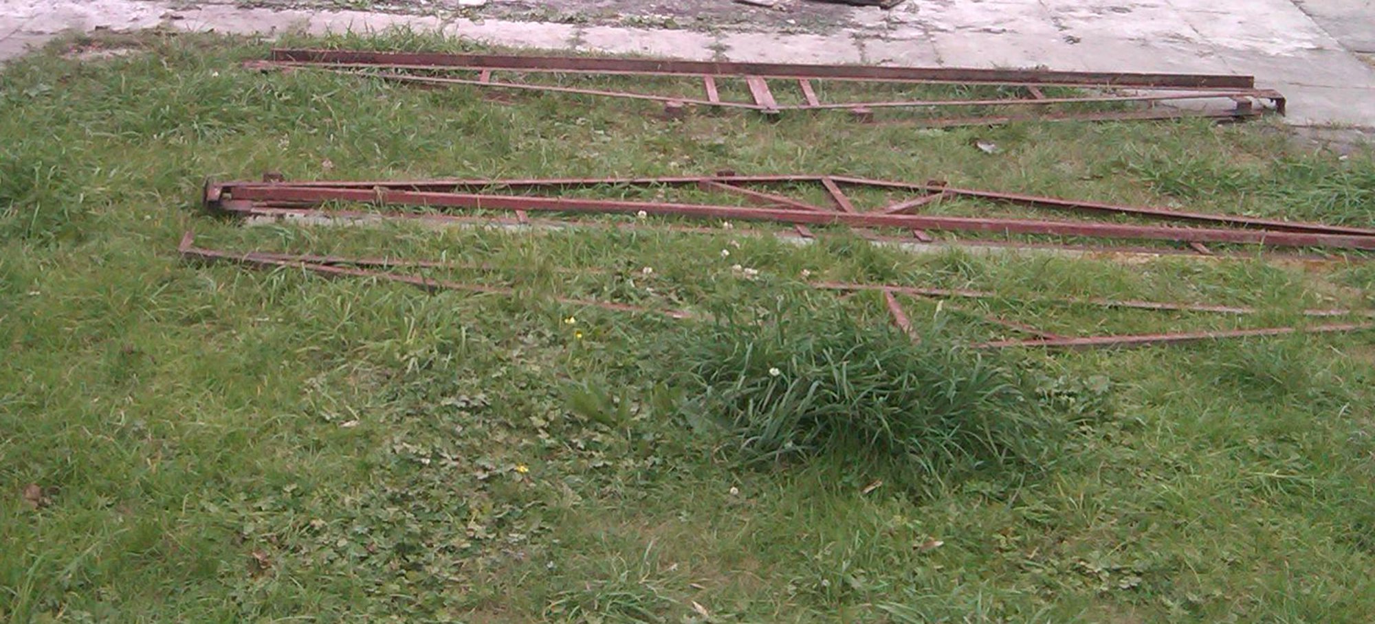

.... So to safeguard against the roof collapsing under a heavy fall of snow, I need to reinforce the angled trusses by building a lattice type support.... Perhaps using 50x50 for the 4 or 6 uprights and angle for everything else?
this one is for a 10ft garage you can build a higher apex if needed
the top one is for apex sides the 2 others are internals 1" angle iron with a concrete shed panels
