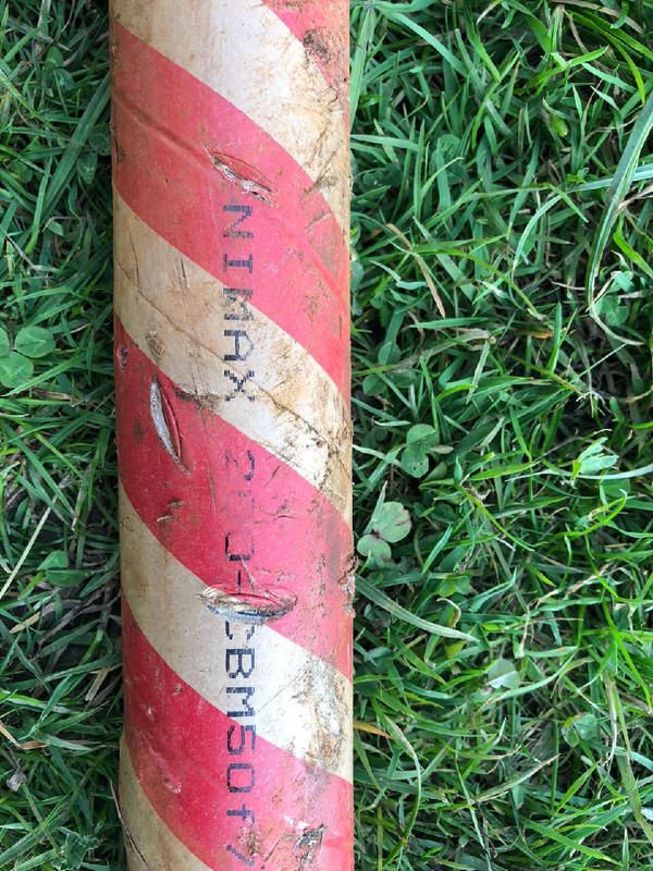

Try a file on the surface, looks like chrome ram rod to me. That generally comes in cardboard tube
This arrived today, I have no idea what grade it is, has a mirror finish so cant be mild? Im assuming it is supplied in the tube, if that helps identify? 600mm long.
Chrome plate ram rod. 20micron is chromeGoogle doesnt throw up much for this
Also has 20micron further down the tube.
Grind the chrome off first where you want to mill. Once you’re under it, like rusty bar, it will just come straight off.You were right, all the round bars are chrome plated. I tried to mill a peice last week and didnt know chrome was that thick, another look I was just breaking through. Chrome does not like milling
Milled some after turning the chrome off, cuts nicely. What would be in the middle?
En8 or en19 most likely en8You were right, all the round bars are chrome plated. I tried to mill a peice last week and didnt know chrome was that thick, another look I was just breaking through. Chrome does not like milling
